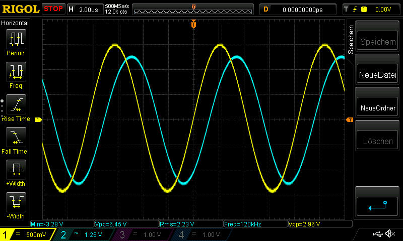

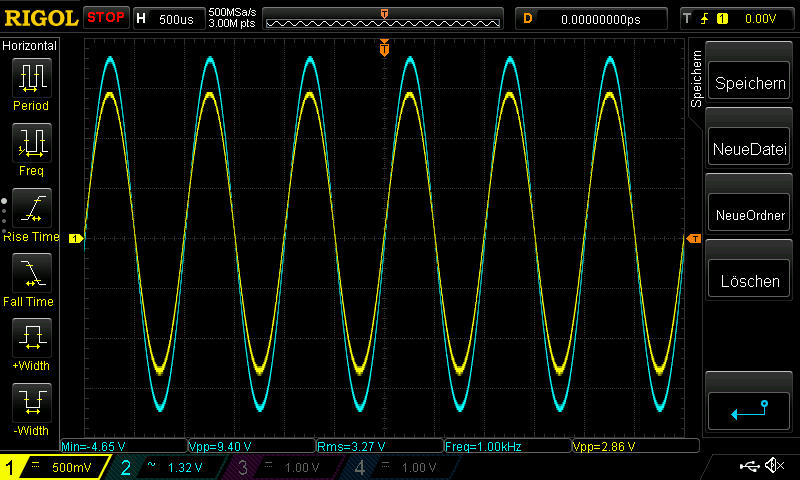

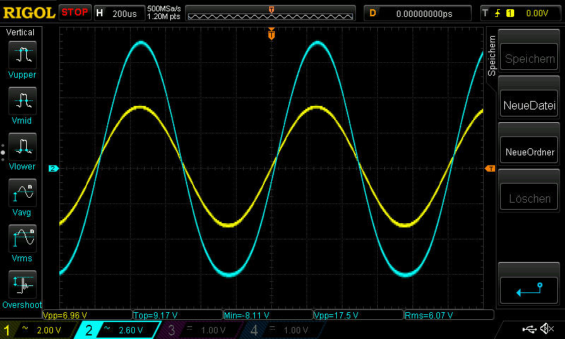

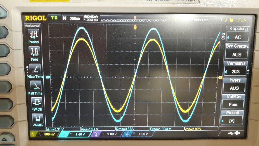

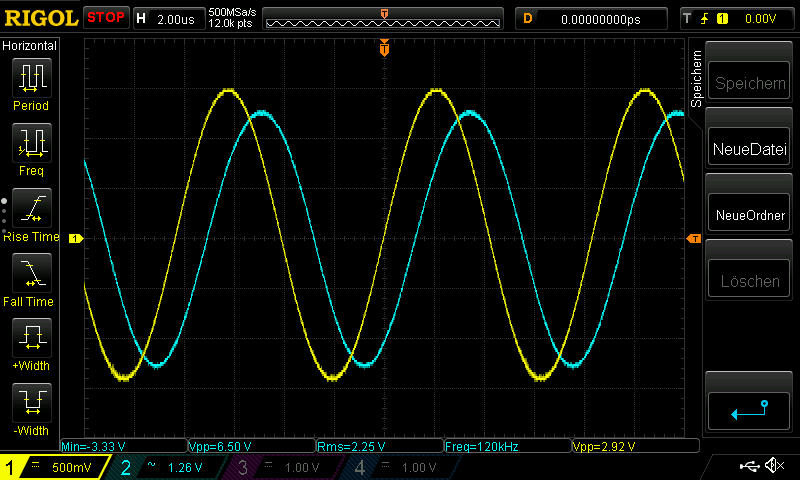

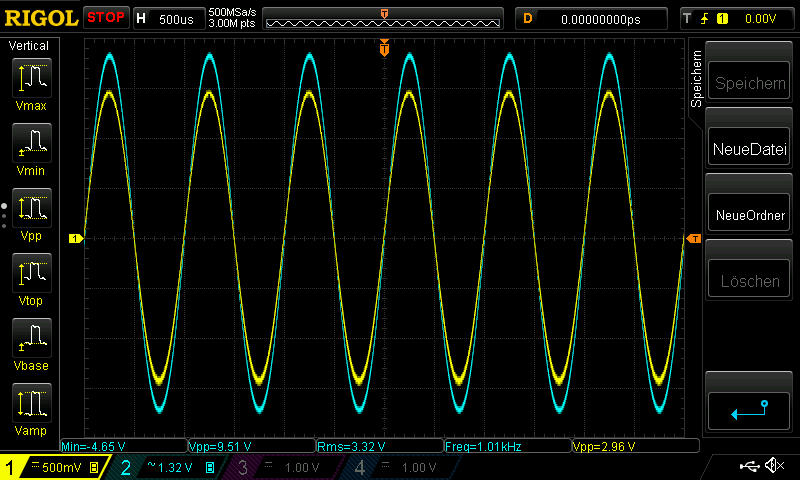

measurements
4R 24Vsupply, 2Amp each side, DC point is set to 12,4V and 12,41V
pic 1 before i got the 10,3dB i need 2400mVrms input to get 9,2WATT
2a_2400mv_in_9w_4r
pic 2 10,3Gain_1Vrms in_4R_fg_Lchanne_2,7WATT
pic 2 10,3Gain_1Vrms in_4R_fg_Rchanne_2,7WATT
fg --> -3dB is at 120khz @4R with 1Vrms input
pic 4 1Vrms in_4R_fg_120khz_Lchannel
pic 5 1Vrms in_4R_fg_120khz_Rchannel
chris
2a_2400mv_in_9w_4r

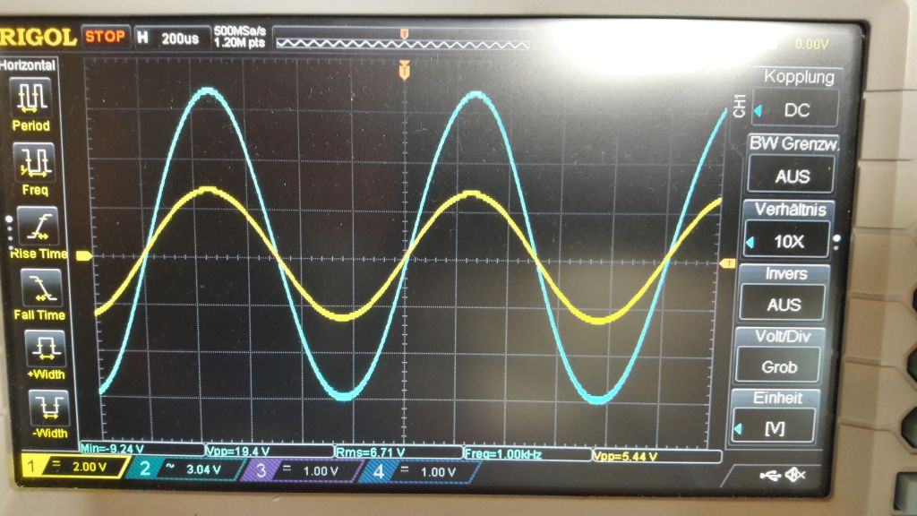

Hi
i am finished with the ACAp_2 with the nearly same setup as the other ACAp to compare just the powermosfets.
zerozone clone pcb
24V 2A bias, DC 12,4V
dale resistors. gain setting 20k to 100k ---> 11,4dB
10pF mica cap // to RF=100k
C3, input cap is 10µF bipolar muse // 1,5µF/63V wima
C2, RLN 1000µ F /16V polymer
C3 Fine gold nichicon 6800µF/35V // 100µF bipolar muse// 1,5µF/63V red WIMA
JFET is a BF245B
ZTX450
gate stopper resistor 120R
without 2k2 resistor i got just 1A - good to know for my preamp idea
with 2k2 i got 1,8A and with 0,47R parallel to both 0,68 ig got finaly 2,03Amps
220R in the drain of the J-FET (surface of the 220R is cracked)
pic 1 is under the pcb...not much room
pic 2 is input 1Vrms at 4R --> gain 11,4dB
pic 3 is the first test into 4R with 1,9Vrms input and i got more then 11WATTwith 2Vrms input i got clipping at the under side...i sea too late that the DC point was not exact setup because i was interested in the max power...re measure again next days...
chris
