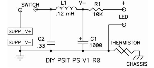

Check out the DIY Sony VFET pt 1 thread, first page. Papa has designed a power supply filter especially for SMPS amps. It is small enough to fit inside an ACA. Details are in the DIY SONY VFET pt 1 document.
https://www.diyaudio.com/forums/att...734-diy-sony-vfet-builders-thread-capture-jpg
In addition to this filter, you could also try adding 1000 uF or 2200 uF to the power input of each channel board, which will improve both stereo separation and lower frequency response.

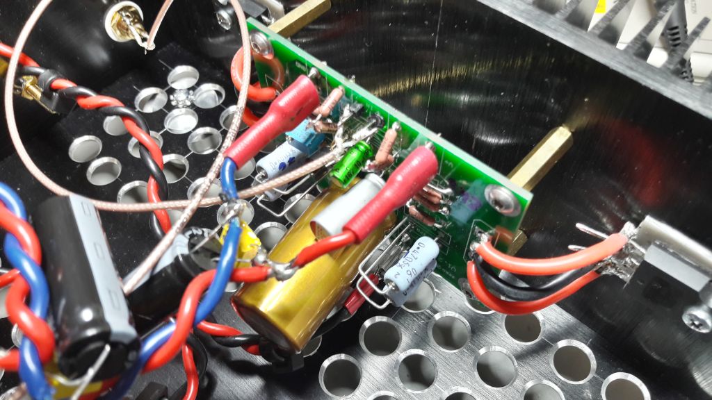

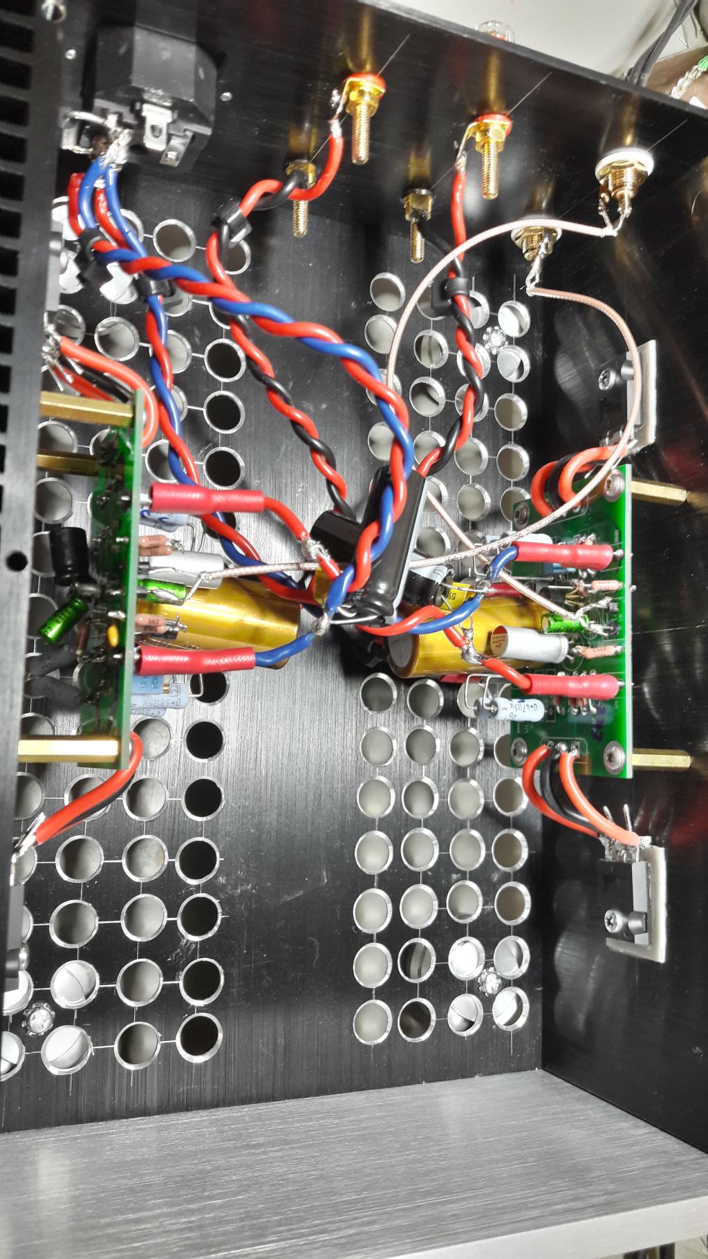

...some pics of my ACAp
i wonder that i have with 1,6A each amp a very nice temp management at my Power fets. after an hour without signal and warming up i got just 59 on each power amp. using a ceramic plate is a good idea.😉
at the 2,3rd pic you will see the correction of idle current and input resistor and my supply caps..its a prototype🙂

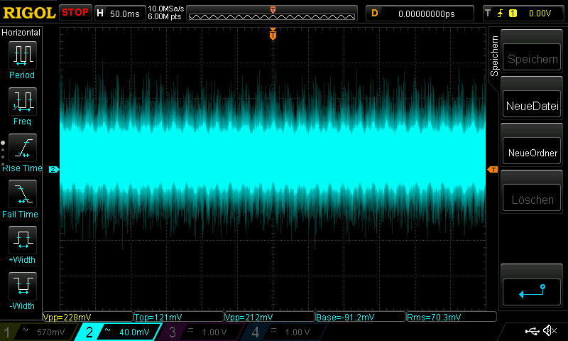

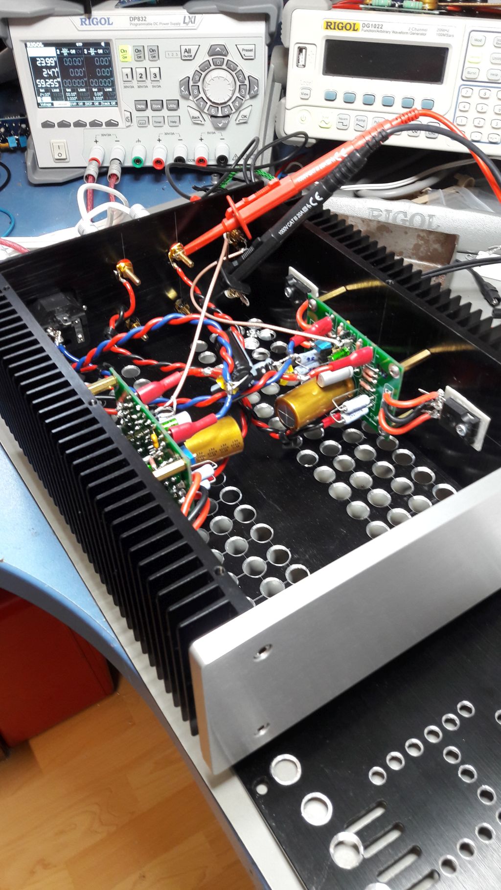

...first step of modification...
Hi
last days i try a bit around of set up my current to get more juice for my 4R 84DB speakers. finally i found a setup with 2,05Amps at each channel and a temperature of the IRFP240 about 75°C!!
. this is the max of my housing setup (55°C) its HOT ! @24V
in my lab i got: 9,2W@ 4R at 2,4Vrms input and no H2 flat of the sine wave...so that´s nice 😀. as you see the gain is to low to reach the max power, RCA deliver normal 2,0Vrms....so i have to pimp this..
as you know from other post i compare this ACA_p with a F5 lateral clone (not matched components) to have a base of my listening sessions.
yesterday i have my first listening session with this HOT monster and i am happy with the result. the ACA plays more forward and more controlled, not so stoic like the F5 but with a but more texture and the singers are a step in front and it feels more realistic...🙂
next step -- filter noise at the supply rail of my SMPS.
as you can see from my measurement at the amp pcb from my LRS 150-24V🙁🙄
chris

Borrow the filter idea from Mr. Pass' DIY VFET Pt.1, it will clean up most of the garbage.
Or invest in a better SMPS and still employ that filter.
You can construct the filter on a small veroboard and the components are rather inexpensive.
