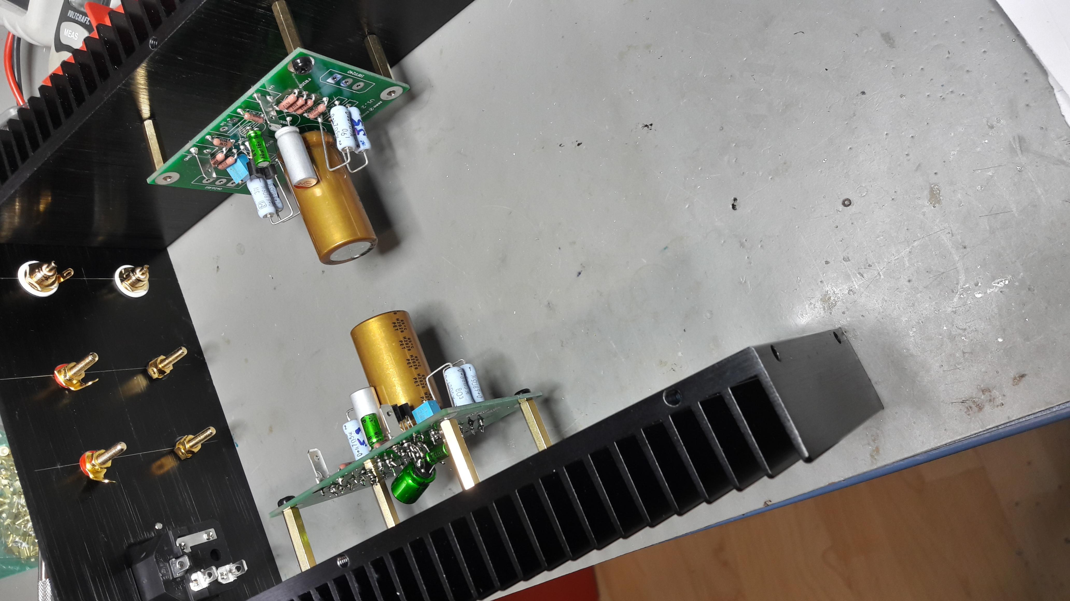

It is really important not to short that steel transformer mounting bolt between the top and bottom plates. That forms a shorted turn around the outside of the toroid. I mount my toroidal transformers with nylon bolts to make sure this never happens.
You can happily keep the 300VA transformer by lifting the top plate of the chassis above the heatsinks with some spacers and longer screws. That will also allow more airflow.

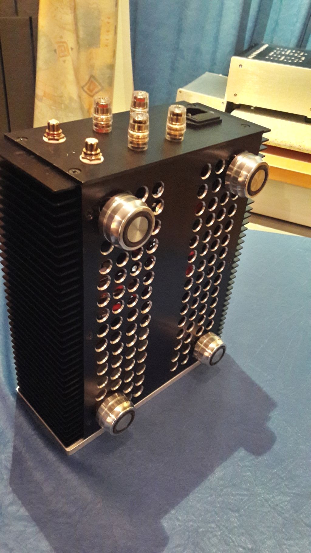

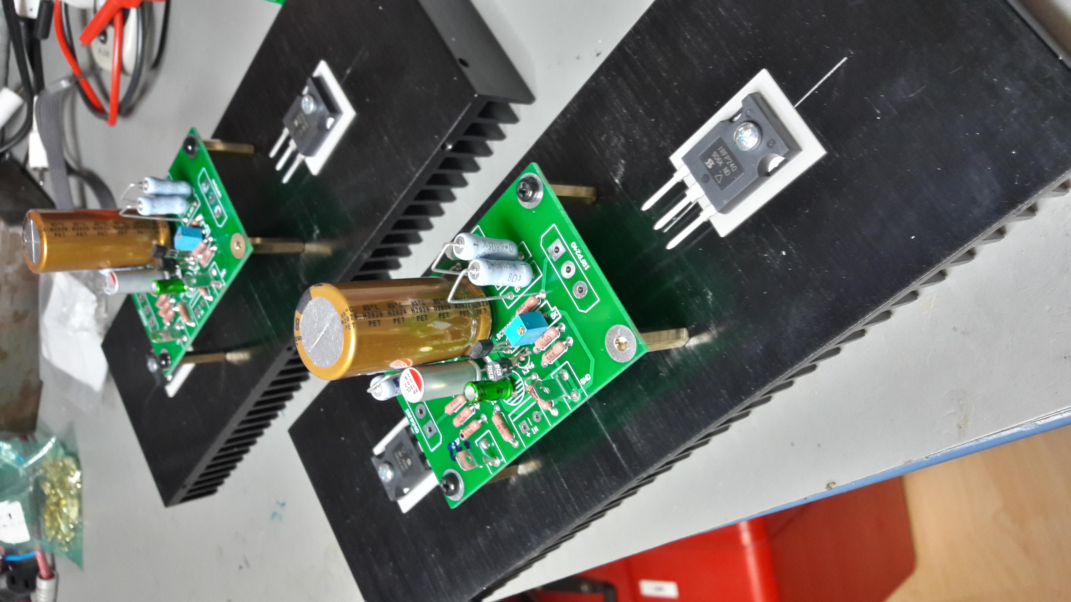

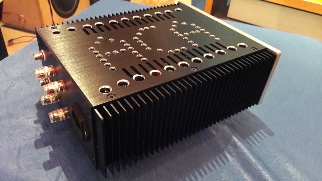

Very nice looking build.![]()
Thank you!
In any case watch out NOT to short the transformer through the bolt against the top lid...
Thank you both for pointing that out. It makes sense, but never would have crossed my mind. If anything else sticks out in the build, please let me know!
I considered using some standoffs to raise the top plate, but in the end decided I would rather keep the chassis tightly enclosed like it's supposed to be and ordered a 200VA model.
