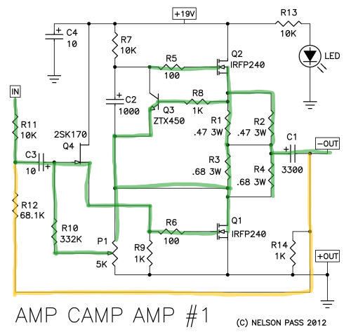

Since R12 is the feedback resistor, it counts as being in the signal path.
As a matter of naming, I use the R16 designation for an extra resistor placed between the (+24V) power rail and C4. This provides extra RC filtering and voltage drop for the drain of Q4. I started with a value of 200Ω for R16, and have used 499Ω for higher voltage power rails. The R16 (68.1k) in the text table looks like the back panel resistor used in some of the bridging modes of operation. I just called it the bridging resistor.
Since C1, the big electrolytic output cap, has a DC voltage across its terminals, it is not necessary to make this a bi-polar. I do prefer the Nichicon KG series for this application, and one could certainly use a larger value ,such as 6800 uF, for entertainment. This has an effect on the bass frequency response, though it is up to the builder to determine what makes the most sense for their speakers. So far, I haven't tried bypassing C1 with a film cap, though others have done so. I suspect that the constant DC offset may negate some of the advantage of a film bypass, but one is certainly welcome to try it anyway.

Since R12 is the feedback resistor, it counts as being in the signal path.... R16, and have used 499Ω for higher voltage power rails...
Ok, so I was off by R12 in my initial guesstimate
How about C1?

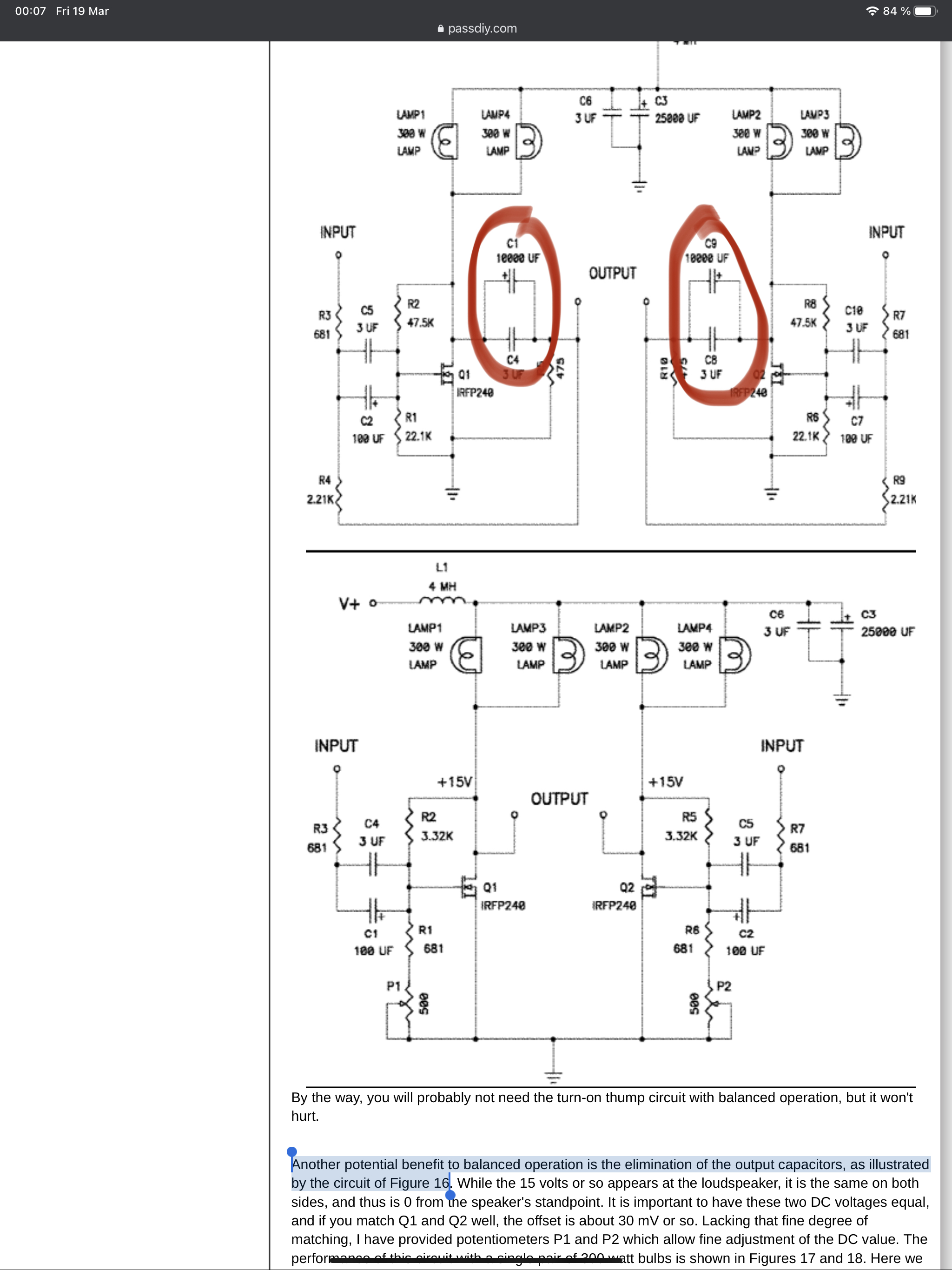

C1 is absolutely necessary, even in bridged mode. It blocks DC voltage from appearing at the output of the amp.How about C1?I would really like to get rid of that output cap. In bridged mode C1 and C3 will be in series and C1 is then negligible - it will still total out below ~10uF. There shouldn't be any DC in bridge mode - but my knowledge is purely theoretical and I might be very wrong??

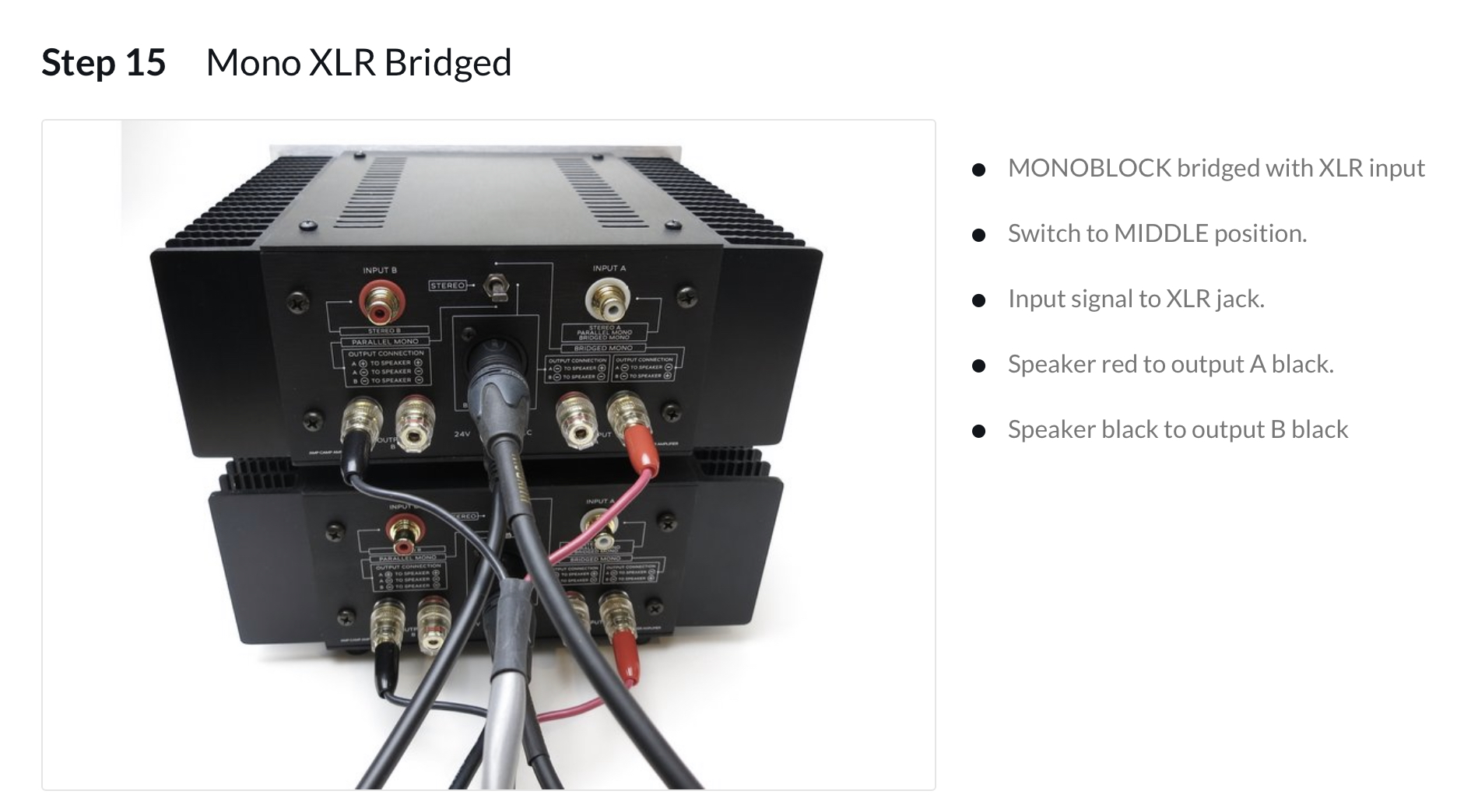

I ment ”Balanced Mono” or ”MONOBLOCK bridged with XLR”. Have a look at the wiring diagram, speakers are connected to OUT- which will BOTH have +12VDC offset and see 0VDC over the speakers. Similar info is mention in Zen Variations I’ve marked them with red. If Nelson Pass can remove coupling caps so can we - right?

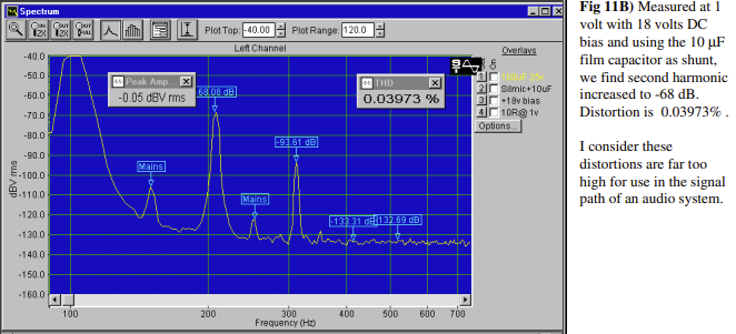

With C1 gone, C3 is not really an issue, although I would still go 470uF and maybe Elna Silmic + film shunt to visit those 2nd Harmonics.
Ok, for this configuration you will need set the DC offset of each amp very carefully to make sure that there is no DC present at the speaker terminals. Make sure the amps have been burned in at final temperature for at least an hour to ensure there is no drift in DC offset.

If you eliminate C1, now you have DC on the feedback loop and DC coming out the input. C3 may be reverse biased depending on how your input source deals with the DC. If your source has an electrolytic cap on it's output, it may also be reverse biased.

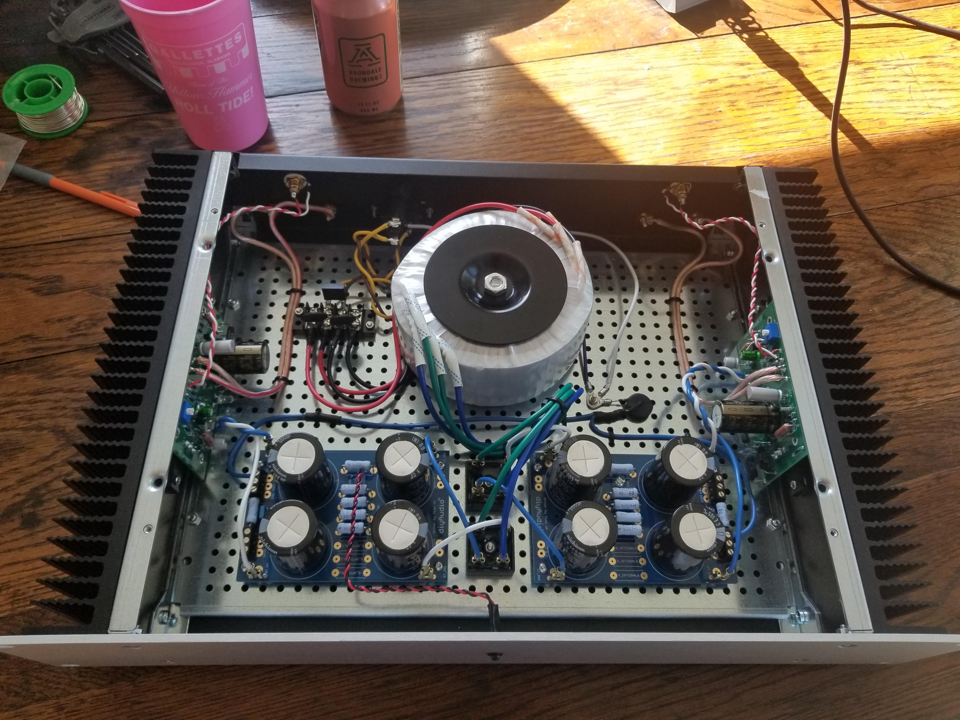

Hey all,
Looking for some advice on my recently completed ACA build. I followed most of the modifications outlined by Tungsten, and am using a dual, single-rail linear supply based off of the DIYA PS board with a 300VA, 20V secondary transformer.
I am getting around 28V on the PS outputs, have set the DC balance to 14V at pin 2 of Q1, and am measuring a 0.192V drop across the PS resistors (4x 0.47 Ohms). I think this equates to 1.63A of current draw per channel at idle, or about 46W per channel. The build is enclosed in a 2U Dissipante chassis, also from the store, and the heat sinks get quite hot after a while - but still cool enough to hold my hand on. Will running the amp at this power level shorten the life of the transistors?
Additionally, the top panel of the chassis doesn't want to close, due to the height of the 300VA transformer sitting on top of the baseplate. Will moving to a 200VA transformer cause any problems? The combined power draw of the 2 channels is about 90W, so I wouldn't think it would be an issue, but I am no expert.
Any insight would be appreciated!

... but still cool enough to hold my hand on. ...
Totally normal.
... Will moving to a 200VA transformer cause any problems? ...
No.
Very nice looking build.
