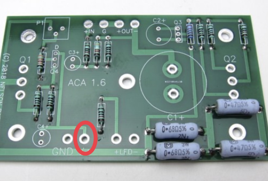

I did cut that trace on one set of 1.6 boards to insert the resistor. When I built up
another set of 1.6 boards, I just soldered the resistor to the drain leg and left the
trace intact. Either way worked fine for me🙂
Ok. Much easier than I thought. I was under the impression I had to cut some traces and risk screwing up.
So, I will solder one end of the 499 ohm resistor to V+, then extend it to connect to the drain on Q4? No traces needing to be cut.
Just making sure so I can easily make the modification.
I snipped the drain leg of Q4 off a bit, and just soldered it to the leg of Q4, then
soldered Q4 into place on the board. Just don't overheat Q4 when soldering the resistor to the end of the leg. If I can find the picture I took of mine, I will post it.

Oh. Makes complete sense. Should be easy to do as I’m not having to modify an already stuffed board.
Thank you so much for clarifying.
Sure!
I can't find the picture I took of the resistor altered leg, but you understand🙂
The only other thing I did was slip a little piece of heatshrink over the leg to make sure it didn't touch the middle leg, but that is not really necessary.

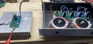

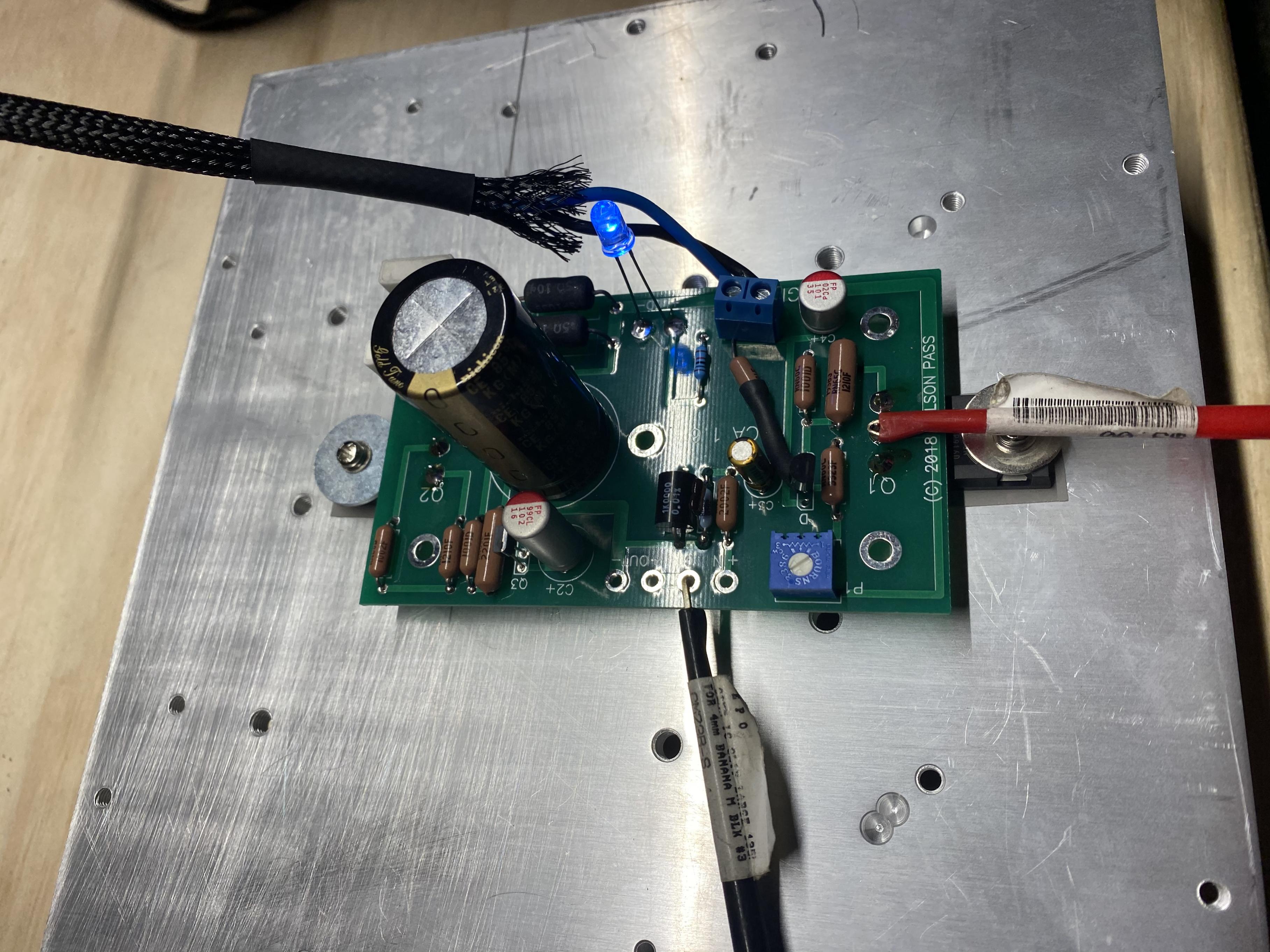

So, here is an update to my attempt at building an external power supply for a pair of amp camps to replace the 24V power supplies.
I am using 4 of Rudi’s CapMX power supply boards with 24V 200va secondaries showing 28V on the rails. I made all the modifications from Tungenstenaudios schematic including the 499 ohm resistor 16 and irfp140s on Q1 and Q2. I’ve tested all 4 boards on a large heatsink and they all test fine. Now I need to try wiring all of them up for a test to see how they sound.
Goal is to cut the heatsinks down but have them at least 40% larger than the aca chassis heatsinks to handle the higher voltages and heat. I biased all the boards to 14V which I hope isn’t too high.
Any more feedback on this build would be great!
