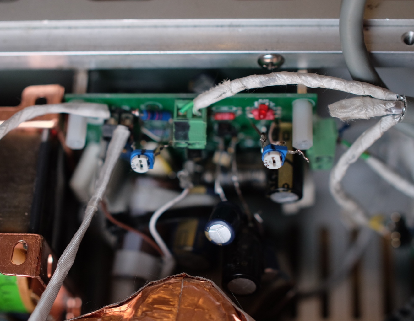

For a while I am listening Semisouth SJEP120R100 in both Q1 and Q2. But still in use the same gate stoppers (R5, R6) value 104 ohm since back then when had used for IRF240.
Yesterday finally, I placed two trimpots instead of R5 and R6 resistor. please close see pic atch. Centered in the middle of image, those small blue color.
One turn, value 200R, lineal. Before power on, I set them at 104R and draw a black marker line on a side of trimpot as a reference.
In picture (after adjustment while listening music), the black line marker is split, value for SemiSouth is different, I find R6=100R and R5=70R.
Den, nice review, thanks for the insight, I have bought CREE C3M0160120D, I will soon compare against the expensive SJEP120R100.

Today I have had hard time in fine tune R6 for Semisouth (Q1), using a much higher precision 10 turns, 100R wirewound pot, let me find 91R as best spot. I can state 89,9 or 91,1 sound worse. This position is signal pass, has great imprint to the final results. So I looked straight to the Charcroft Z-foil resistors catalogue and luckily is available same 91 value!!!
I will buy later, now wants to check out if R5 as 70 ohm is allright, because I have used an small trimpot not reliable, only as coarse setting.
