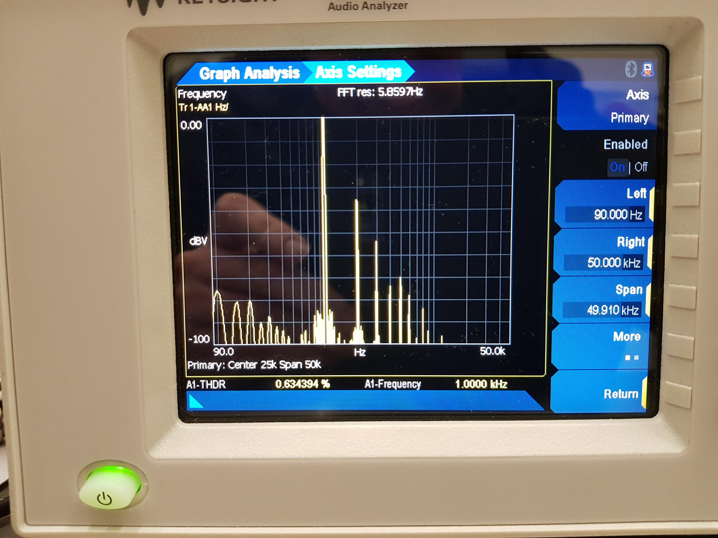

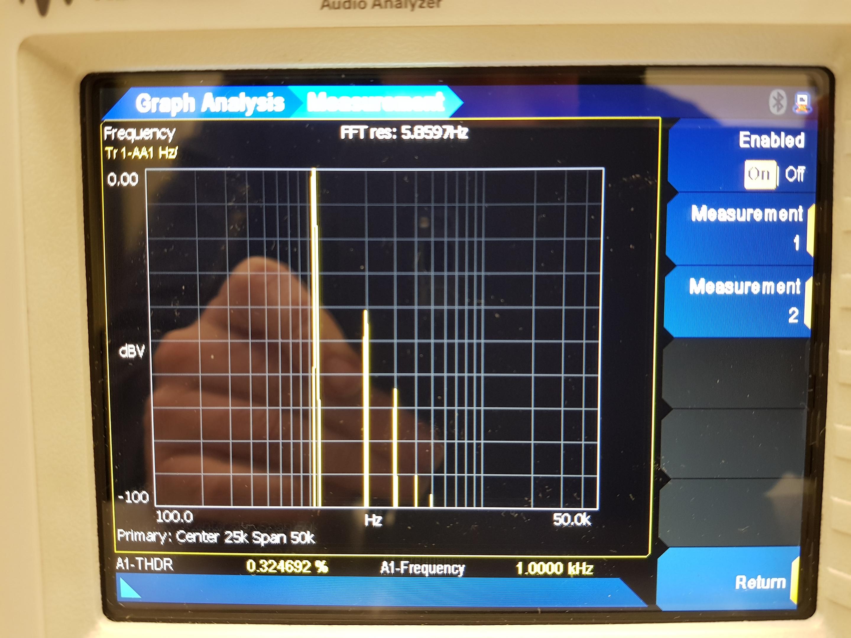

Here is the difference on mine between correct and incorrect grounding of interconnected equipment
This is what want to see. I'll check interconnected equipment's ground. Thank you! 🙂
PS: How do you ground Meanwell itself? This is what I do: Meanwell chassis to safety ground (amp chassis), One output to signal ground, then connect chassis ground to signal ground (I tried this both with/without Thermister, and it seems no difference).

This is how I would do it.
Meanwell chassis physically and electrically isolated from the amp chassis. Mains earth connected to the meanwell chassis.
Powersupply neutral is connected to the amp chassis via the standoffs on amp pcb.
On my ACA pcb, 0V is connected to the heatsink via pcb through the standoffs. The heatsink should then be electrically connected to the rest of the chassis.
Mains earth and PSU 0V are completely isolated (no connection).
I did find one potential issue on my amp chassis. I have the original monoblock chassis.
The small issue is that the chassis is painted steel, in order to get shielding of the whole chassis you need to remove paint on the chassis where the bolts connect the chassis to the heatsink.
So you could be either picking up radiated mains noise because of poor shielding of the chassis or it could be conducted via the interconnected equipment through interconnect cables then amplified through the amp.
My gut says if it's -100dB it probably isn't a ground loop problem but it's worth making everything that should be electrically connected nice and tight (also removing paint or using star washers to achieve this)

ACA with CREE C3M0160120D
Still cooking these CREE C3M0160120D silicon parts, but sounding promising. I am using them for both Q1 & Q2. Very clear sound, still working on getting a way of describing the difference from the IRFP044's that I had previously. The bass seems to be less than the 044's, but well articulated. The different sounds seem to have greater separation than before, no mushing of the individual component sound boundaries if that makes any sense? Mid-range and highs crystalline without harshness. Have lowered my voltage rails to 24.4 volts from the previous 29+.
I have the bias on the drain of Q1 set to 13.3 volts. Presently I am using 500 ohms for R5 & R6, but may lower them to 300 ohms to see if it remains stable. The amp biases much easier with the silicon parts than it did with the 044's, less jumpy on the meter.
The amp gain is less than it was with the 044's, maybe lost a quarter of the gain, but I noticed this loss even on the 29+ rails, so it a factor apart from the lower running voltage. I have less feedback, using a 332K resistor for R12.
Will see how the sound changes as the parts get broken in, and let you know🙂
