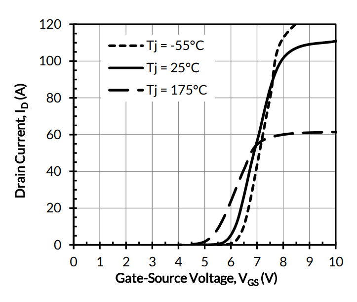

Because their transconductance dIout/dVin is not constant unless Iout > 10 amperes, which is well outside the range of standard bias currents in audio gear, and well outside the range of standard heat dissipation capability of audio enclosures. It's laughably beyond the max possible current of the ACA power supply and howlingly beyond the max possible dissipation of the ACA heatsinks and chassis.
Here's the transconductance plot from the manufacturer's datasheet

But at least you now know the answer to the question "What device has the lowest Ciss for a reasonable transconductance and power capability?"
It's a known LDMOS transistor for Ham Radio Homebrew actually. If this part is known to handle high VSWR - i.e. mismatched antenna or feedline - that mean it translates into outstanding bass performance and subwoofer control?

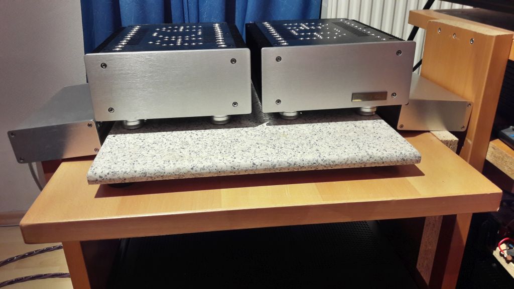

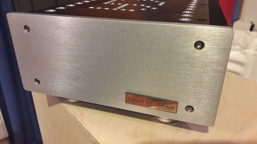

Hi
here are some impression about my 2nd ACAp.😀
about the golden sticker : i got this from my brother in 1990 if i start with audio. it was a motivation but i did nearly nothing.🙄
now audio DIY its like a drug🙂
chris

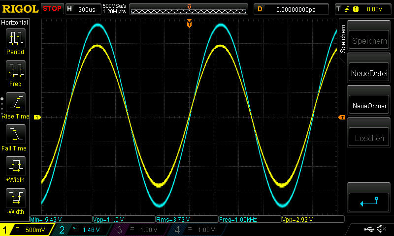

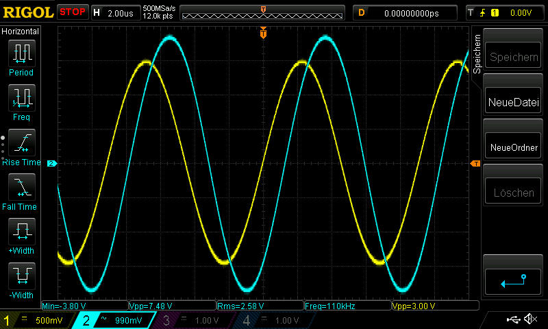

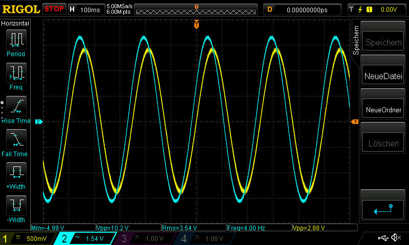

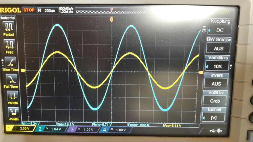

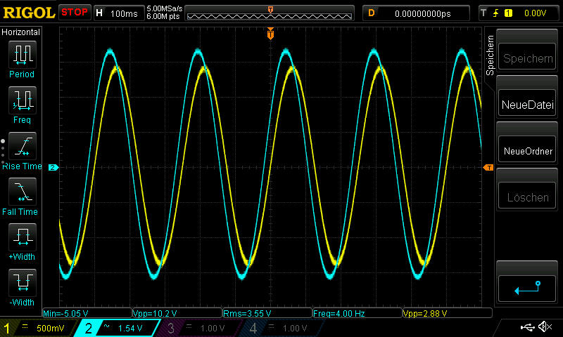

...measurements
i try different frequencies, e.g. 4HZ and try to get the fg = 110k Hz
i use 1Vrms input to look at the output.
finally i get with 1900mVrms in about 11,6Watt into 4R.😎

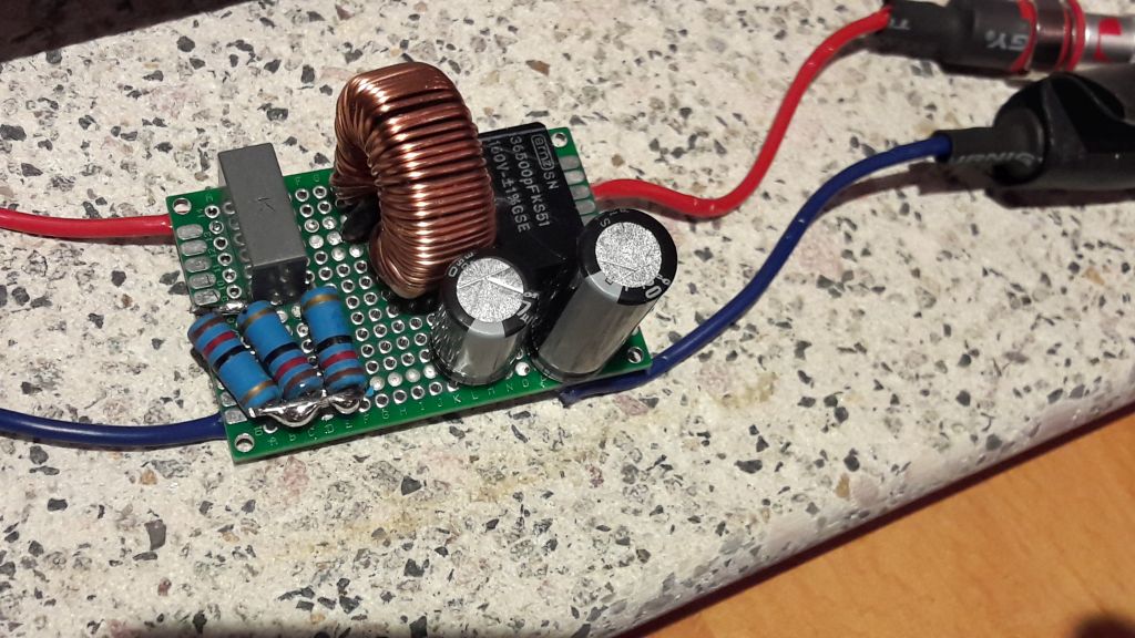

smps filter
I tried the different amps an before i made a sound explanation i want to clarify about the first filter with my setup and the updated version:
please use the bigger coil then 40µH...its definitive better. i used 100µH not at the pic.
Cin -L-Cout filter
on the pic you can see that at the input i used after the Cin 220nF KEMET -grey -3 parallel resistors which i had in my "waste" box. 3//12R = 4R
then i use a 100µH coil (not at this pic)
at Cout i use
36pF black
820µ/50V ruby
+ new - 22µF/400V ruby
