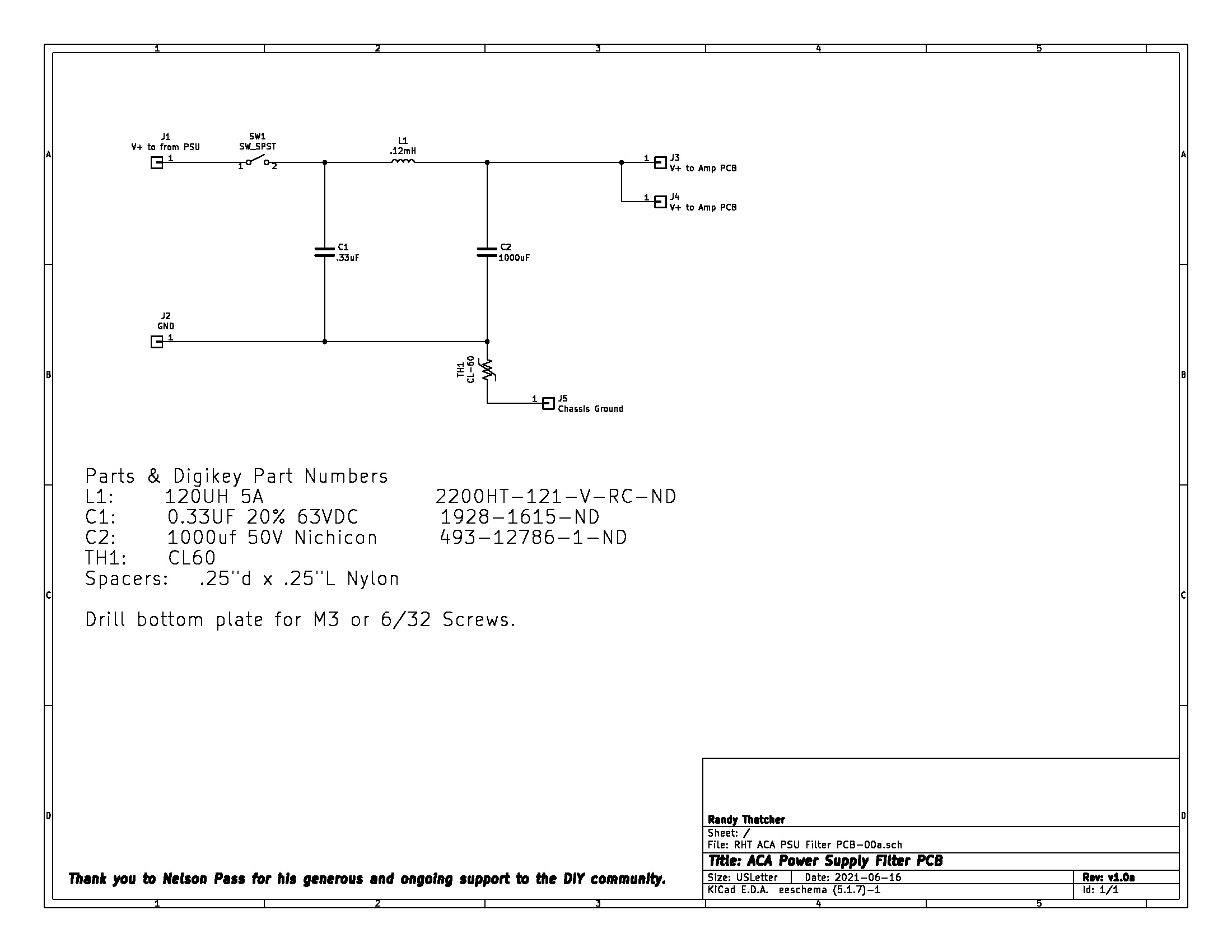

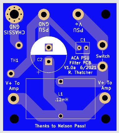

I'm thinking to fab some PSU Filter boards inspired by the newest VFET design for a pair of ACA monos I'm building soon.
This is a 45x40mm PCB. It will require drilling the bottom of the ACA chassis.
Idea is to run PSU+ and GND to the board. Then a pair of wires to the switch. Then one wire with V+ to each amp PCB (one per side of this PCB).
Comments?

I suggest you wait until the other half of the VFET lottery has completed, just to see whether the N-VFET amp uses a different PSU filter than the first-to-be-released P-VFET amp. If it is different then you'll have to decide whether you want to copy the P-VFET-PSU-filter, or copy the N-VFET-PSU-filter.
And perhaps it might be possible for you to lay out a super-duper-universal-VFET-filter PCB, which includes both designs. Perhaps as PCB options with wire jumpers or something.
The big improvement is going to come from building monoblocks. That way you get a separate power supply for each channel, and get to choose how to bridge the two boards in each amp to best suit your speakers.
The filter boards are a nice extra. A simple CLC, so no need to over-think the issue. The basic design as used by the VFET lottery amp will be fine. If you choose to increase the second C , that can make sense as well. The inductor will reduce the startup current into any bulk capacitance you may add.

Nelson Pass just revealed that he has revised the SMPS filter for his Sony VFET DIY amplifier kit. This apparently was necessary to accommodate the N-channel VFET boards, coming soon. See post #1538 in the Sony VFET Builders Thread (here)
You may want to include the same modifications in your PCB, that he has included in his.
I don't think he has posted a schematic or a photo of the board yet.
Maybe a parts list update ?
