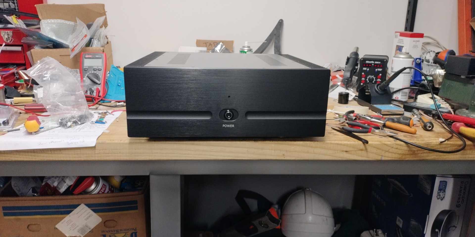

Just want to thank everyone here on this page as finally got my project all done and even with some test speakers sounding really good. Thanks for all your guys help can't wait for the next project.

Hello @Robstr556Just want to thank everyone here on this page as finally got my project all done and even with some test speakers sounding really good. Thanks for all your guys help can't wait for the next project.
Very nice work 👍
Can I please ask you where you bought your enclosure, looks great. Maybe a link ?
Cheers
Eric
