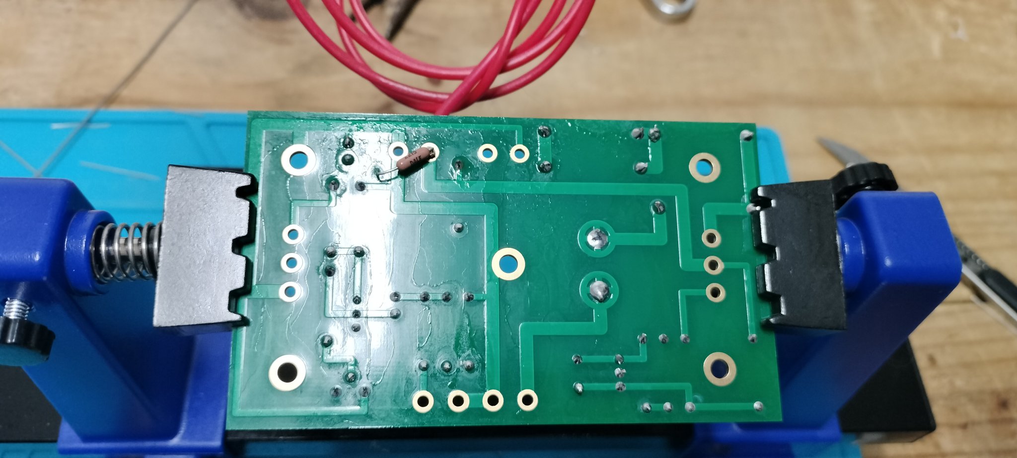

I found the thread related to the trace cut and installation at R16. The below picture appears to be the preferred installation location. I will be doing the trace cut before installing anything on the board. It appears that I just need to cut through the trace on top, but I want to confirm. And then in this picture how is the resistor locked in place? Is it just the solder? Or do I need to drill two holes through the two ends created by the trace cut so that it is locked in place like the other components?
No holes are necessary. Maybe a drop of super glue could be convenient to hold the part in place while soldering.

why a hole? you can cut the track and pull it off with a carpet knife. then solder the resistor at the joints where you should.

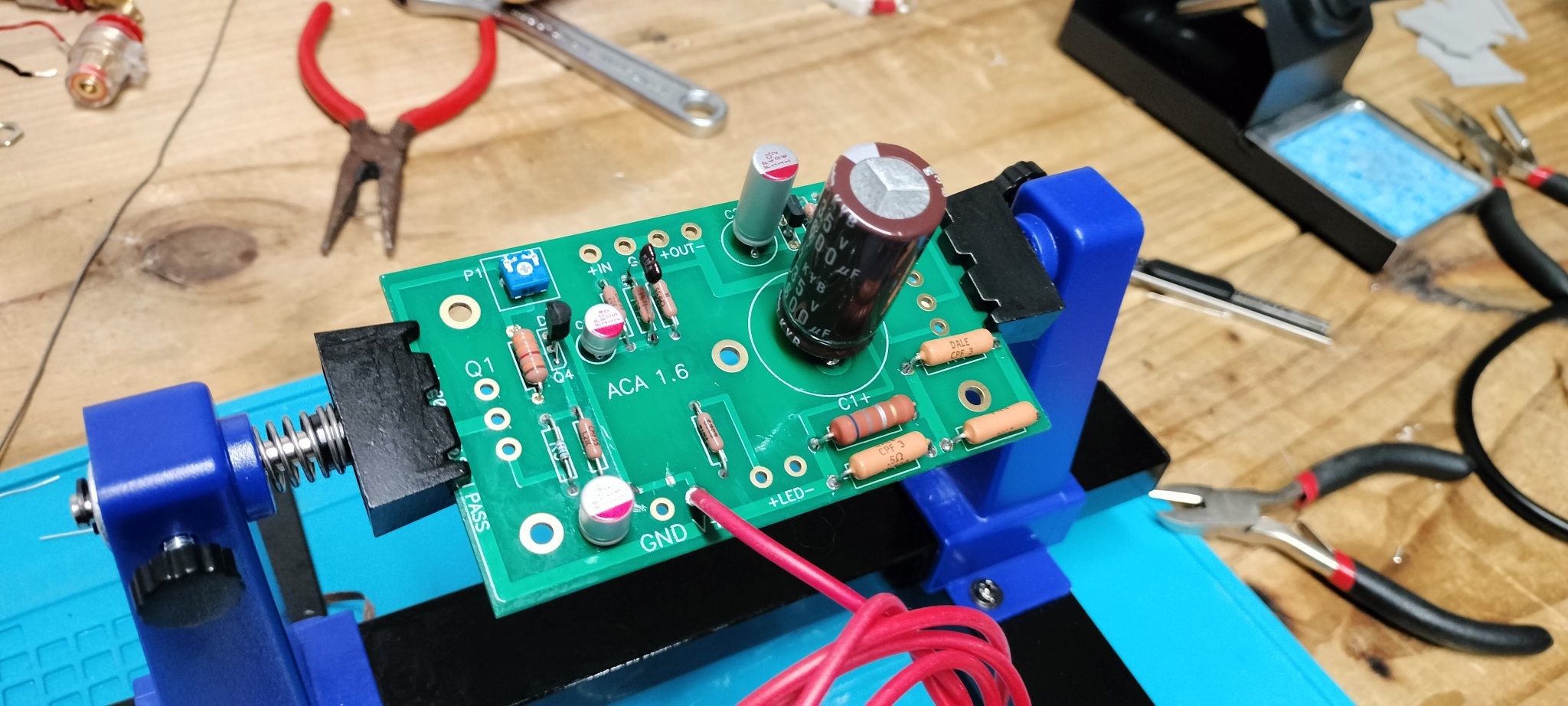

First one completed just waiting on materials for mounting to heatsink. Can't wait to hear once completed.
- ACA amp with premium parts
