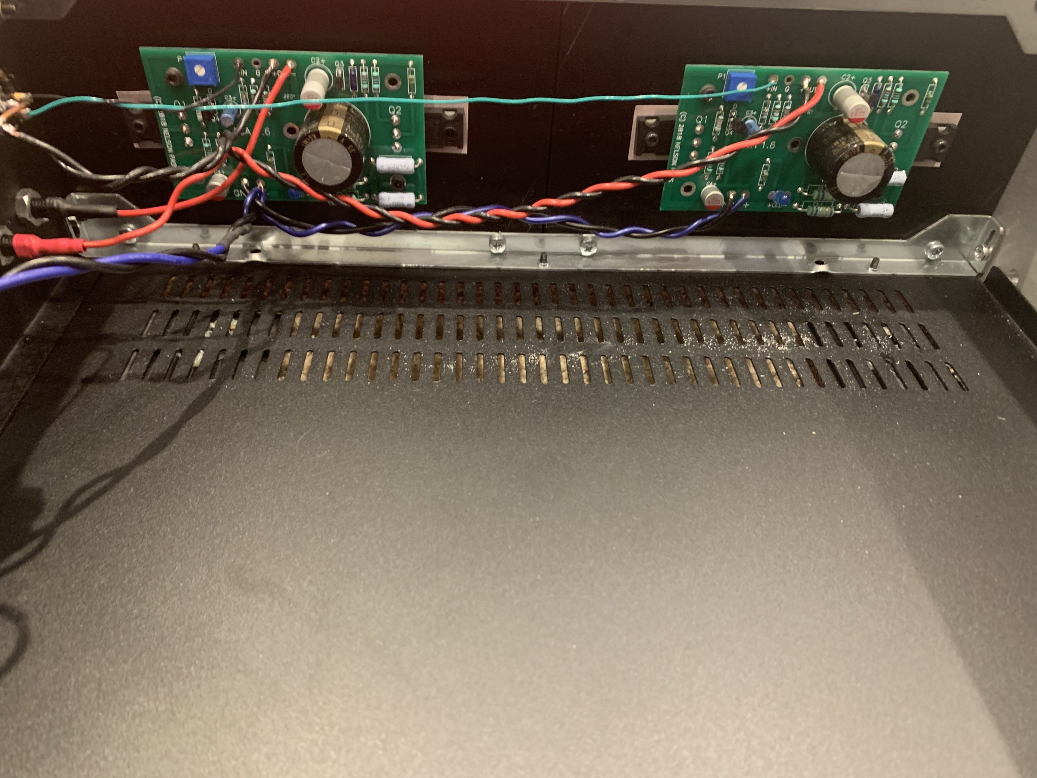

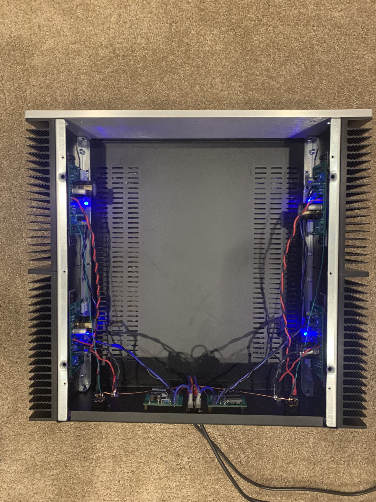

An interesting issue is the mechanical work needed to support a linear supply and transformer in the ACA chassis, given that there is no internal baseplate as in the Deluxe DIY Audio chassis. The bottom plate is a bit flimsy, and you may need to beef it up with a sandwiched metal plate under the PS which bridges the width of the chassis, or perhaps using strips of .090 aluminum to provide stiffening of the bottom plate.
The chassis pictured above is a Modushop product; it probably included a baseplate which was not included in the initial build.
Certainly in cases where there is not an internal baseplate, it might be advisable to install some reinforcement to support the weight of the transformer.

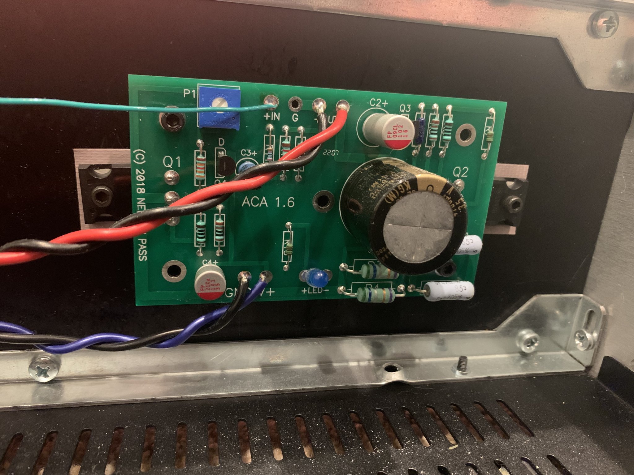

This my current board, it's been a year since I built it a bit rusted. Does it need modification to run 30V secondaries? I would need 2 universal power supply boards for B+ railI am not aware of any kits to assemble a linear power supply. These tend to be very custom affairs.

The ACA boards would be best if modified to include R16, since I don't see any evidence of its installation. This requires making a careful cut in one of the traces on the board. There are quite a few pictures of how that was done in this thread. This is also one of the changes that makes the ACA sound a little better, as it filters the power going to Q4. If you do not feel comfortable making that modification, that's Ok, but 30V may be too much for the JFet to handle. Reduce the rail voltage to 26V with a different power transformer.

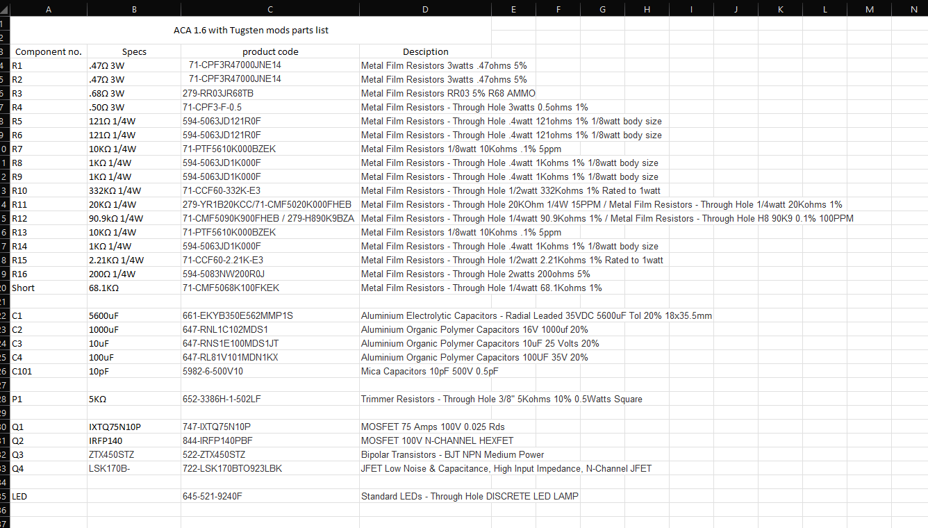

Hi All, After discussion with Tungstenaudio over some parts. I have put together a parts list of materials from mouser please review and let me know your thoughts as trying to get this right before ordering everything. Apologies if a bit of a beginner question for you guys. I have also added a spec sheet from what threads i have checked out.
If it is all good this should help out some of the guys as a starting point for ordering parts to do a ACA Tungsten style amp
Thanks Rob
Thanks Rob
