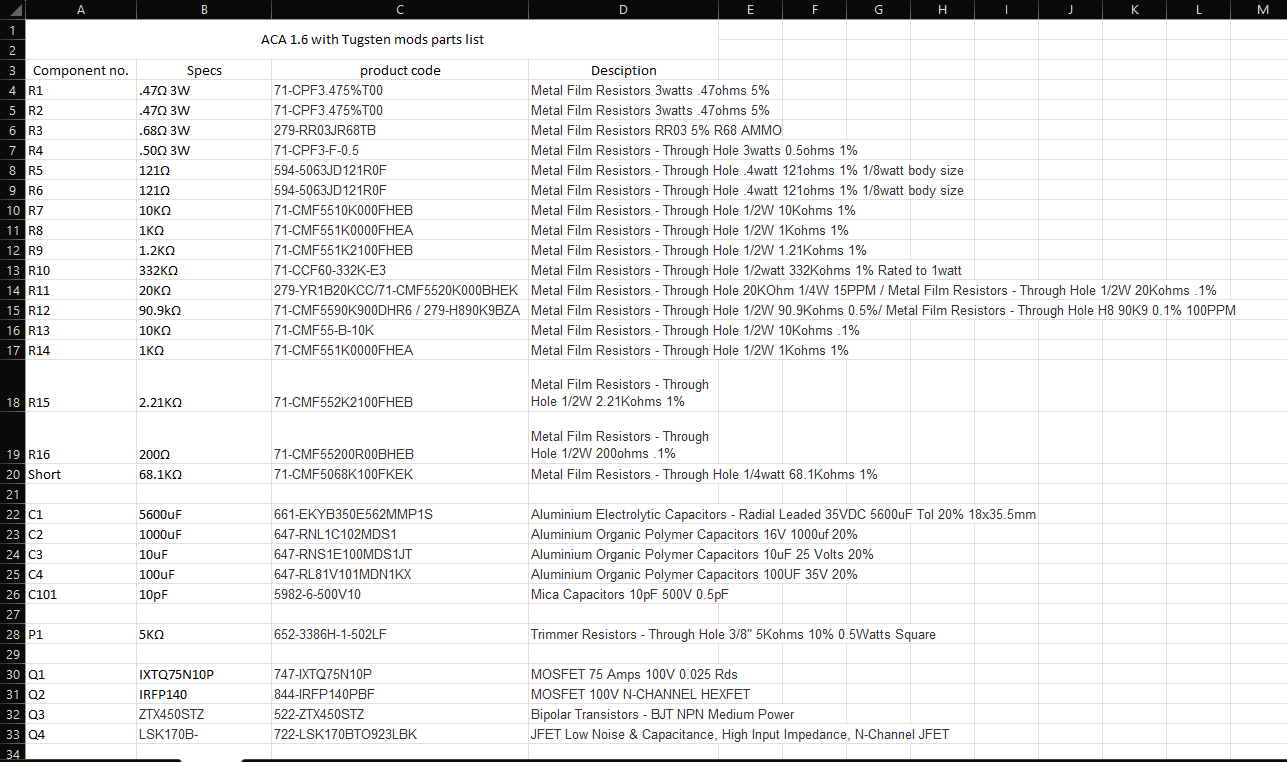

With regards to the list of components that Rob proposed in #1419:
I have come to prefer the Vishay CMF55 series of 1/4W, 1% metal film resistors for general use in my hand made amplifiers.
Example p/n would be CMF551K2100FHEB for the 1.2k component needed at R9 to support the Vgs needed at Q1.
Another common p/n would be CMF551K0000FHEA used at a couple locations.

That sounds like a good explanation. I have come to prefer the IRFP140 at Q2, though others have used the now rare FQH44N10.
For Q1 I recommend the IXTQ75N10P as a readily available part. Again, the FQH44N10 works here as well if one already has a stash.
A clean linear power supply is of course very important as well. I like the Antek AS-3224 with separate CRCRC or CRCLC filtration for each channel. Final voltage at the Drain of Q2 is just under 30V; Drain voltage at Q1 is about 15.5V.

Which mosfet for Q1 and Q2 are better, the IRFP048 or IRF140's? Can either one be used without matching ?
Is the addition of r16 only for using a higher supply voltage ?
I had trouble finding a .5 ohm 3W resistor for R4. I was able to find a 2 ohm 2W 5% resistor though tp use in parallel with R4. Is that close enough tolerance ?
Seems the Nichicon KG series is now obsolete and hard to find ? I substituted with Nichicon UKA series audio grade cap ?
After all the mods are made does the bias voltage still get set at 12vdc per the guide ?
Are the heatsinks on the standard ACA kits adequate if the supply voltages are increased ?

For Q1, the best of the available parts is the IXTQ75N10P.
For Q2, I prefer the IRFP140, though the IRFP048 would also work.
R16 helps filter the voltage at the drain of Q3.
The best voltage to set at the Drain of Q1 is half the supply voltage plus 0.5V.
Each channel should have a separate power supply, whether that is a brick SMPS or separate power transformer winding + CRC(RC) filter.

I saw in one of your posts talking about needing additional 1 volt Vgs for the IXTQ75N10P. Do I need to make other resistor tweaks to get the IXTQ75N10P/IRFP048 combo working with the stock 24 volt SMPS supply ? Are these mosfets drop in replacements for the stock mosfets ?

Finished building and testing the first of my two ACA+(Tungsten Mods) amps today. Q1 is a IRFP140 and Q2 is a IXTQ75N10P. Set to 12.3 volts. Will tweak that a bit more as the amp burn in some. Sound quality is absolutely amazing ! Far exceeded my expectations.
Finished the second amp this afternoon. WOW ! These amps are outstanding in bridged mono mode. I'm hearing details in the music I've never heard before. Many thanks to Tungsten and the forum for excellent tech support !
Are you doing one power supply per monoblock or two?Finished the second amp this afternoon. WOW ! These amps are outstanding in bridged mono mode. I'm hearing details in the music I've never heard before. Many thanks to Tungsten and the forum for excellent tech support !
One 24 volt 5A SMPS power brick per monoblock. The one that came with the kit. I may try surplus linear power supplies next to see if there is any improvement in sound quality. However, these amps sound very impressive !
I've also installed a 150K 1/4 watt resistor for R13 to dim the led's. They were way too bright at night.
My system consists of a pair of Zu DW 6 floor standing speakers at 95db/m. A Wiim pro plus streamer DAC. An old Sony CD transport using optical out into the Wiim. A Schiit Skoll phono pre and a vintage B&O Beogram 1602 turntable. DIY Mogami interconnect (W2893) cables and speaker (W3103) cables.
