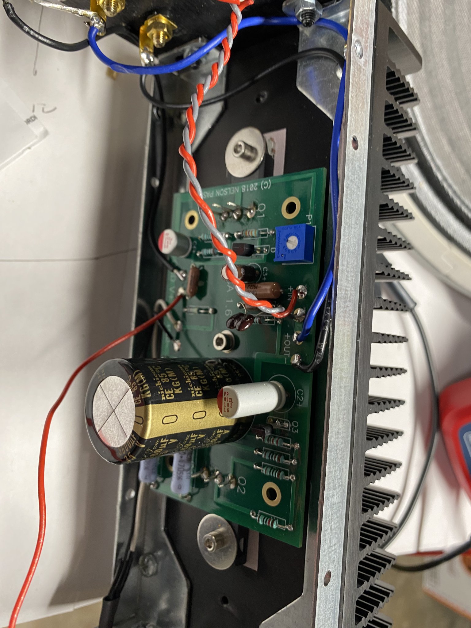

Help with ACA build.
I finally finished up my ACA with premium parts last night. I had completed the PCBs 4 months ago and then life got in the way. Anyway, when I powered it on I got what sounds like an electronic fart, which I think is normal, but have very low volume. For testing purposes I have a Korg B1 as the pre and Sonos port for streaming and Lii F15 speakers which are very efficient. With the Korg turned all the way up I can hear the music but just loud enough for very close listening. Clearly something is not right. I took resistance measurements based up the ACA build guide and most of them are low. Both PCBs test similarly so whatever error I made appears to be consistent. I printed out the ACA guide and wrote in the measurements. I am hoping I get input as to how to diagnose my build issue.

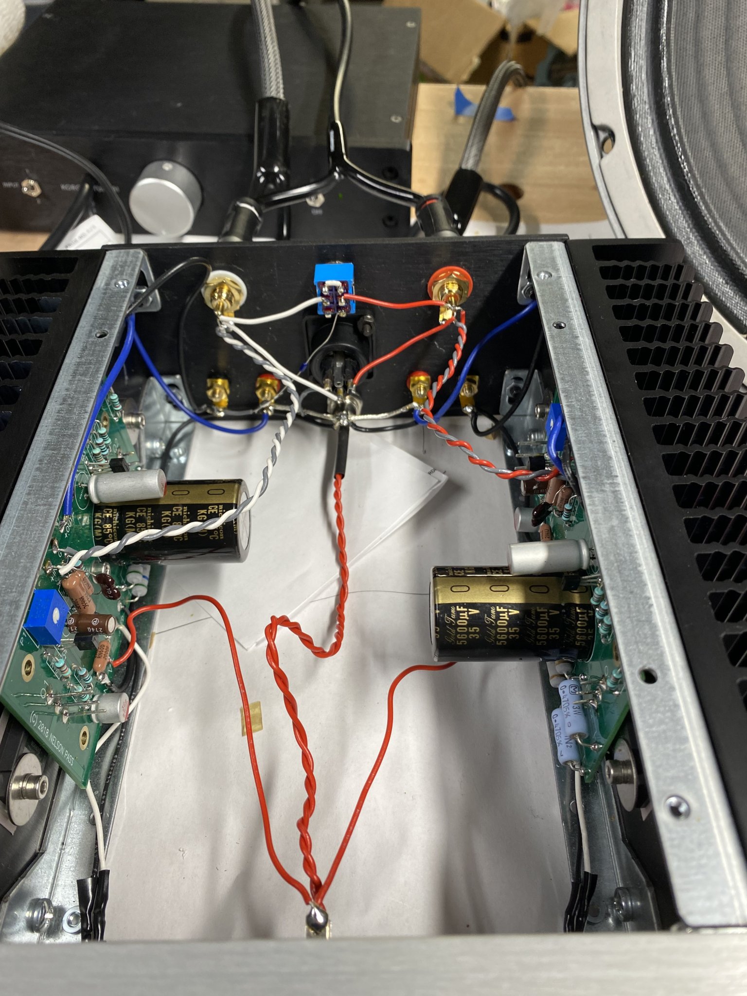

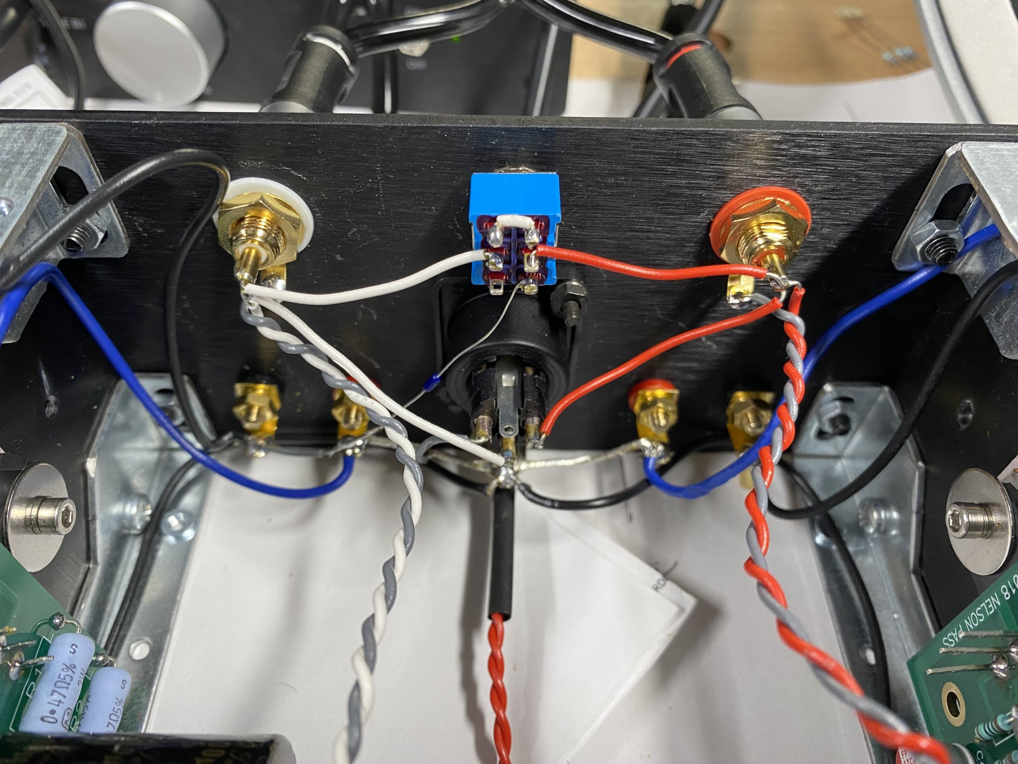

^ I don't have all the resistor values memorized, but assuming a few missing k's ... that looks fine. Just double check the values against the schematics. Post exactly what mods you made.
There's so many things that can lead to what you're describing. Next thing is to post a set of really good pics of both completed boards and all your wiring.
In the interim... to rule out some of the easy stuff, I'd recommend checking to make sure the full input signal is reaching the amplifier boards. The "mode" switch along with input wiring trips up a lot of people... and those switches can melt. Check both RCAs and the XLR and check it with the switch in the appropriate operating setting for each. Also... just to rule out the obvious... the Sonos is sending a full signal, yes? No digital attenuation?
I assume everything in the guide went to plan through the initial power up etc., yes?

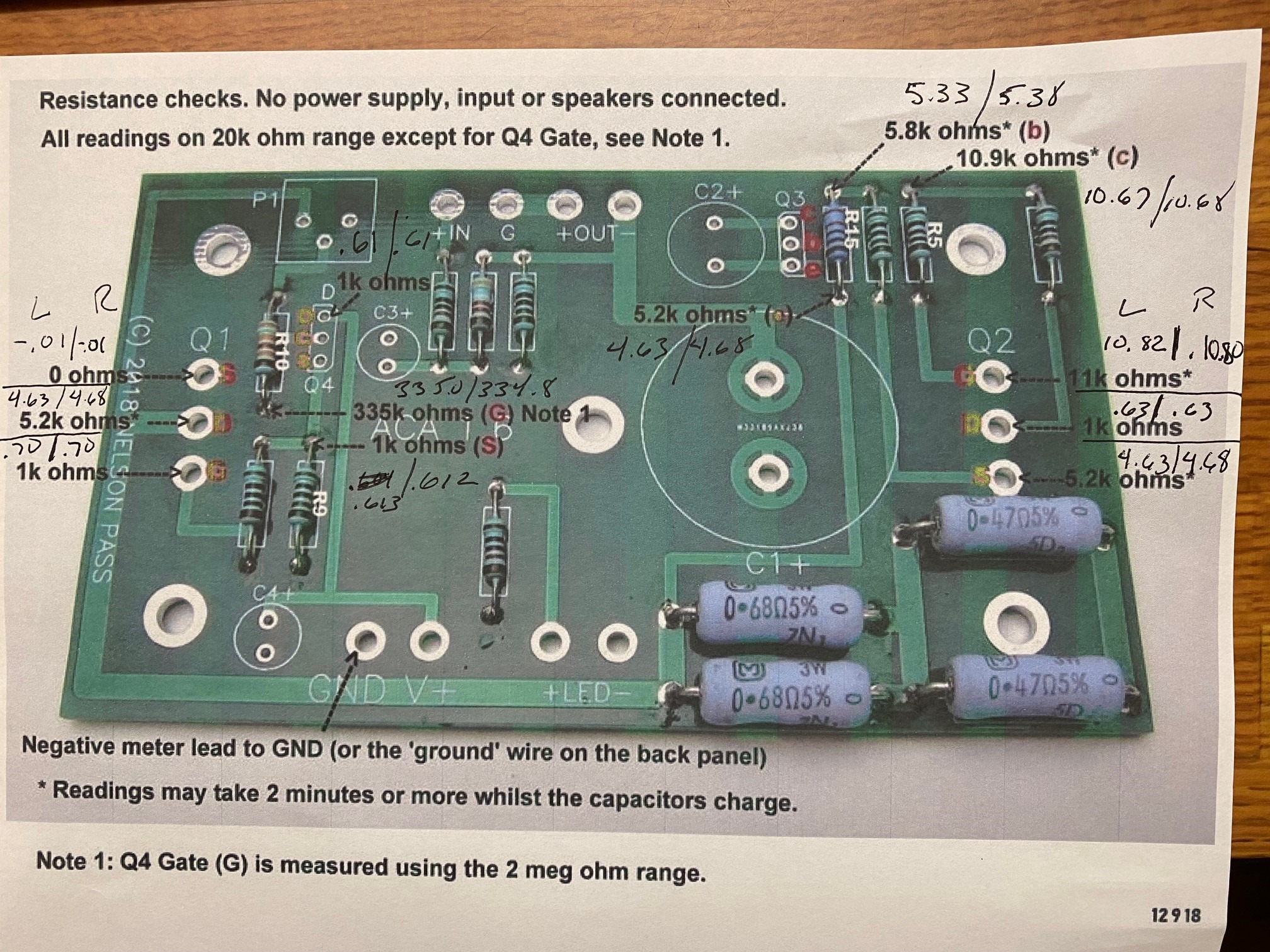

I second what IAMH said. The correctness of the build needs to be verified.
Some useful voltage measurements (both channels):
1. Power supply voltage at board when turned on.
2. Voltage drop across resistor R9.
3. Voltage drop across resistor R2.
4. Voltage at pad between R2 and R4 relative to Ground.

I am not sure I did this correctly. Had the ground probe connected to the ground wire at back of unit and used the other probe to connect at the below points. Voltage drop was done by touching the resistor on both sides.
1. Power supply voltage at board when turned on. 23.93 for each PCB
2. Voltage drop across resistor R9. 5.7 to 5.17 and 5.06 to 4.2 (Clearly a problem)
3. Voltage drop across resistor R2. 12.86 to 12.49. 12.98 to 12.62
4. Voltage at pad between R2 and R4 relative to Ground.R4 was 12.49 and 12.60. Taken by connecting to right side of R4 resister next to R2. Suspect that is not what you were asking for. Not sure what you meant by pad.
Will put together a parts list of premium parts tomorrow and re-review the PCB for the parts i soldered to the board. Been 4 months since I did this so I want to recheck everything.

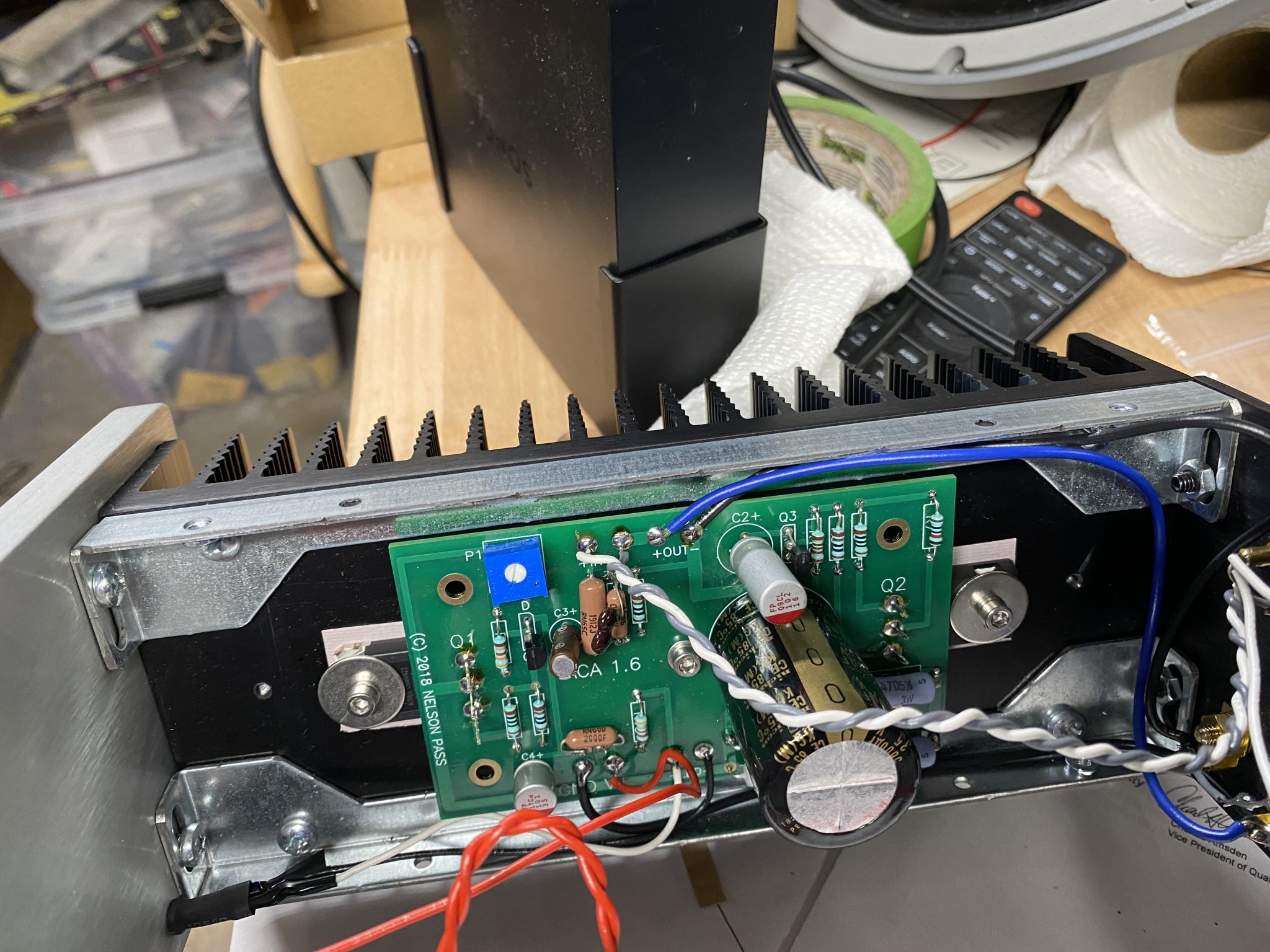

Pics of build below:

Voltage drop
R9 L: 395.7 R: 389.0
R2 L: 5.28 R: 5.17
Voltage between R2 and R4:
L: 12.73
R: 12.84
R2 L: 5.28 R: 5.17
L: 12.73
R: 12.84
Always include unit of measure! Volt? milliVolt?
The Voltage drop numbers look mixed up. Assuming the R9 numbers are mV and the R2 numbers are V, the numbers as shown do not make sense. They do make more sense if they were reversed.
If R2 Voltage drops were 396mV and 389mV, then Iq was approximately .39V/.235 Ohm=1.66A, which is reasonable.
If R9 Voltage drops were 5.28V and 5.17V, they were a bit high, but perhaps not unreasonable.
This is all assuming the numbers were mixed up and reversed. So please check those measurements.
The Voltages between at the point between R2 and R4 appear reasonable.
