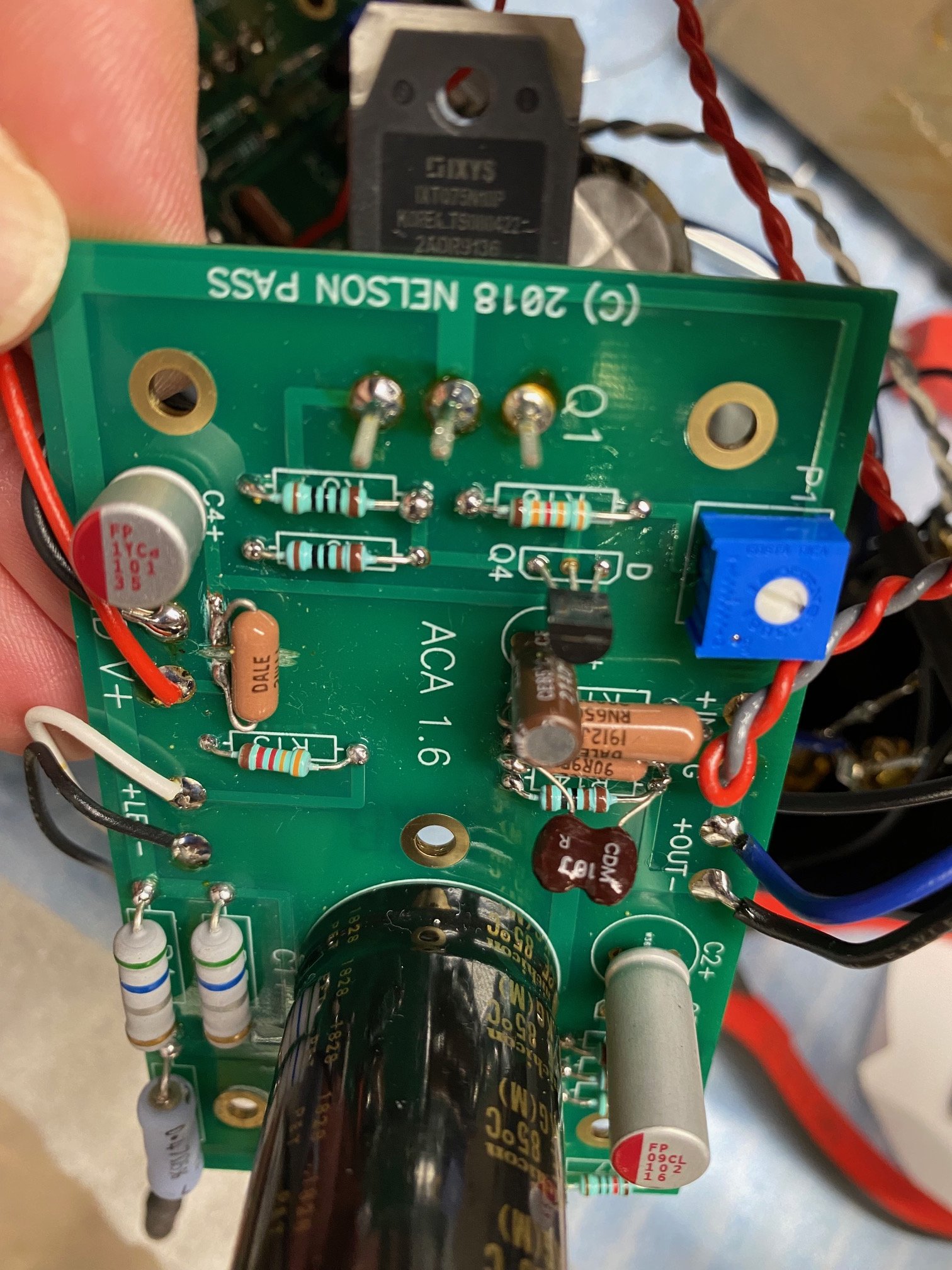

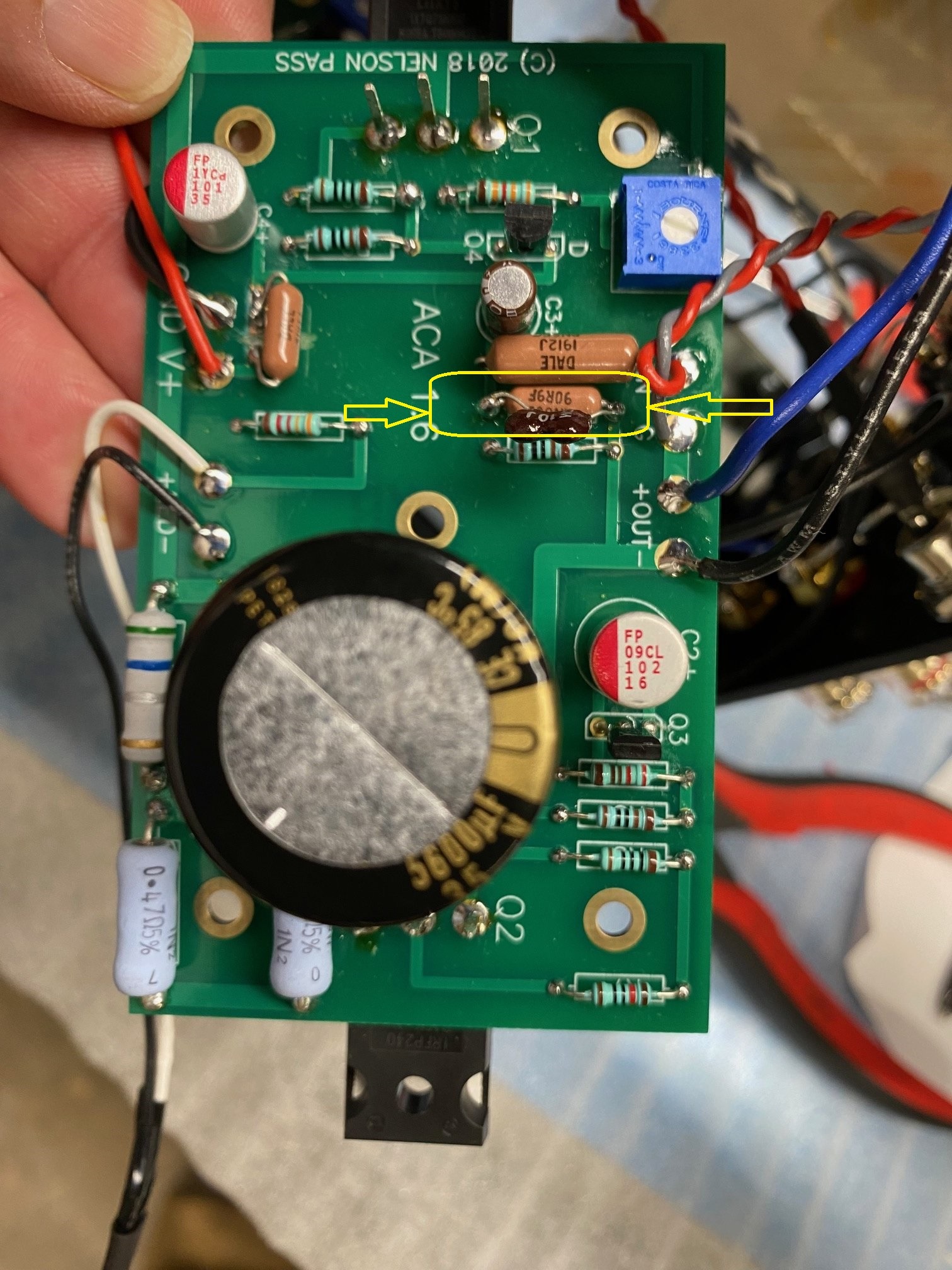

Here are the substitutions on the PCB. I believe they are in line with TungstenAudio's recommendations. I have confirmed that these are the actual substitutions on the PCB.
C1: 5600 uF, 35V; Nichicon KG series "Gold Tune" (updated from original upgrades)
C2: 1000 uF, 16V; Nichicon RNL series Aluminum Organic Polymer
C4: 100 uF, 35V; Nichicon RL8 series Aluminum Organic Polymer
R3 & R4 .56 Ohm Resistors (RSF200JR-73-0R56 2W)
R11: 20 kOhm, 1/4W, 1% metal film
R12: 90.9 kOhm, 1/4W, 1% metal film
IXTQ75N10P Mosfet at Q1
On board add-on components
C101: 10 pF, 500V, 5% Silver Mica; added in parallel w/ R12
Off board substitution
Filter drain point of Q4: 68.1 kOhm, 1/4W, 1% metal film.
I still have test the gain on the amplifier. And I need to check the switch, although I am unsure precisely how to do that.

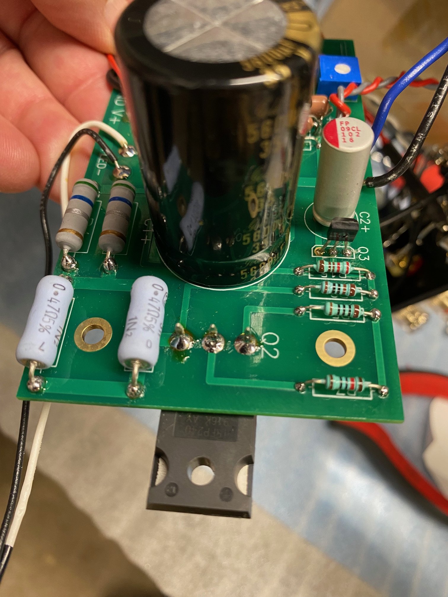

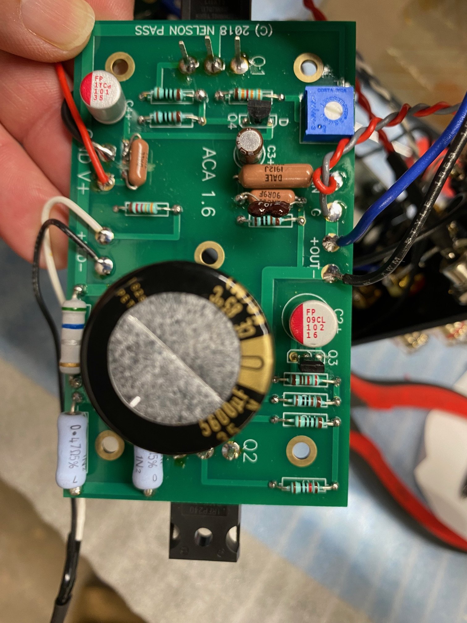

A few close up pictures of one PCB.

Tom,
Is that correct that you have a 68.1K resistor on the drain of Q4? That is way too high of a value. If you are running at 24 volts, a 200 ohm resistor is
plenty for some some filtering to the power supply of Q4, or if you were using a higher voltage like 28 or 30 volts, that resistor will also offer
over-voltage protection for Q4. That high of a value will cause Q4 to not function as it should. If you are using a 24 volt supply, try a 200 ohm resistor
in line with the Q4 drain, and remove that 68.1K resistor.

Good catch. A 68.1k resistor would drop too much voltage, leaving not much for the jfet, close to nothing.
What confuses me now is the voltage drop that was measured across R9 (5.28V left, 5.17V right). That looks unlikely if the jfet was not getting much voltage, so the measurement was most likely not correct.

I see that when I copied and pasted over the parts list I failed to correct the resistor value to what I actually used. I did use a 200 ohm resistor.

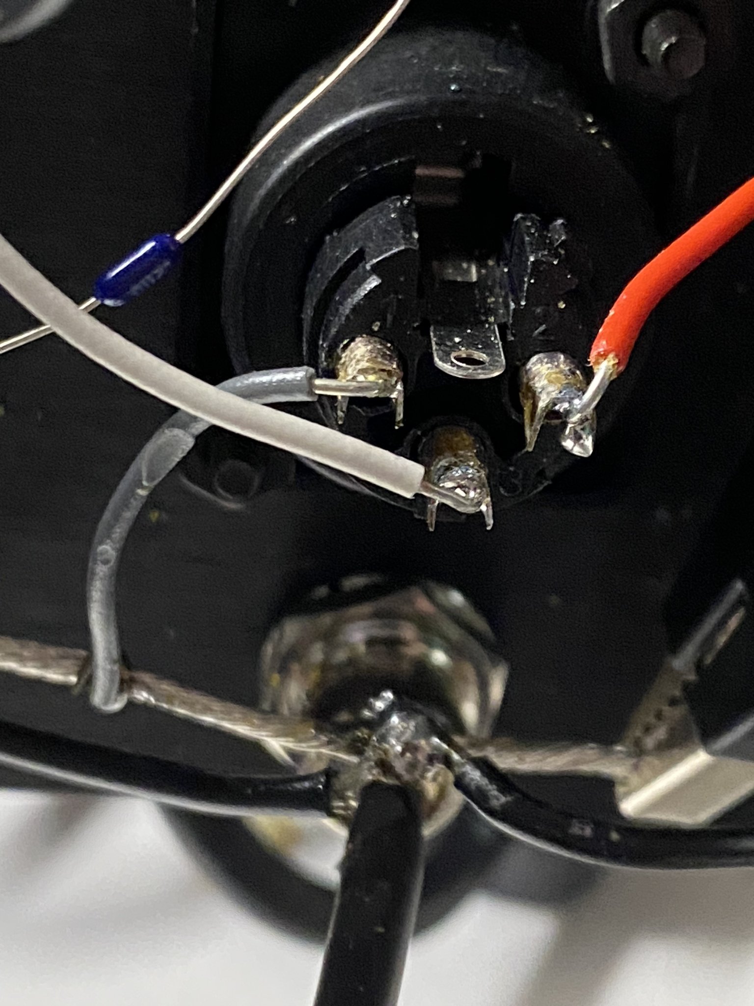

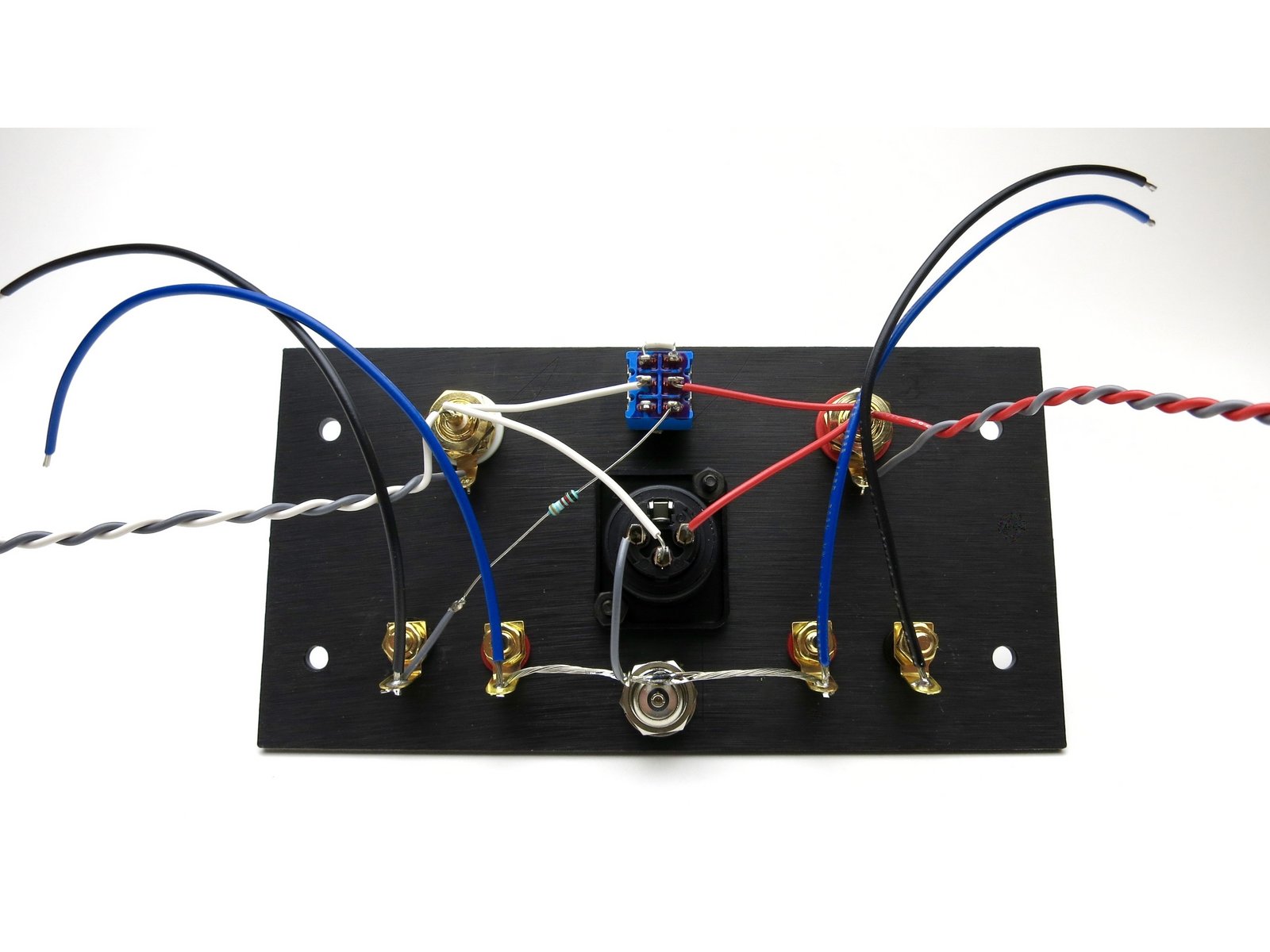

Tom,
Is your ACA version 1.8? Check the wiring on the left channel going to the XLR. The right channel connection looks right, but the left doesn't
look like it is attached to the right place. Should be attached to pin #3.
I may be wrong, but the PCB reflects 1.6 but the kit is the 1.8 version.
Regarding the wiring here is a better pic. I think I have this right. Please see below:

Tom,
Try connecting the second white wire from the positive left RCA down to where you have the gray wire connected to pin 3 of your XLR instead of where
it is currently connected.
I moved the white wire and connected it to where the grey wire is. The left speaker no longer works with the switch in the top and middle locations. In the bottom position neither speaker works.
Tom,
For heavens sake! I was looking at the wiring diagram changes for the 1.8 version, so my apologizes for being of no help!
I have the 1.6 version, but never used the rear switch, so only had the DIY diagram to offer. Will look some more!
TomR, You probably did not confirm resistor values before installing on circuit board.
Check the value of R12:
and Tom, what is the value of your R10. If R10 and R12 got switched you would kill all of your gain
good one Ben...that has got to be it 🙂
