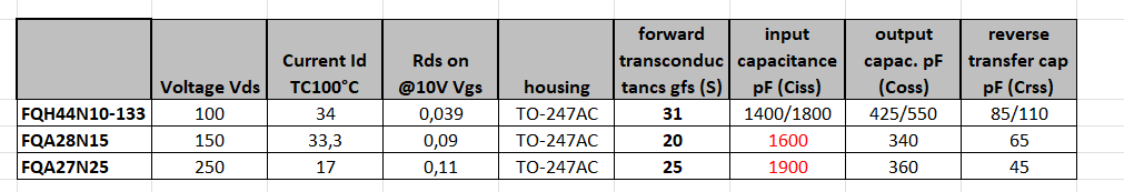

Hi Turion64
you need 1 pcs for 1 channel of 2SK170- normally it is in the store example (aca mini) they are GR rating - means 2-6mA. sould be okay for quad 6-8mA.
MOSFET.
IRFP140 and IRF150 are bit "stronger" - less rdson and more transcundactance -so a little bit more bias current is allowed 😉 .
matching is not needed. i prefer IRFP044N - but i see its sold out.
IRFP150NPBF is a good choice (ZEN mod uses this very often) - is a double IRF240.

The nearly double input capacitance of the IRFP150 will show up as increased THD above 1KHz.
yes...nearly
^ Thanks for good info provided by chermann.
I would like to add that trying different values for the gate stopper resistors is an easy way to tune the sound of the amp for your system. Mosfets with a higher gate capacitance may benefit from a lower value resistor.
