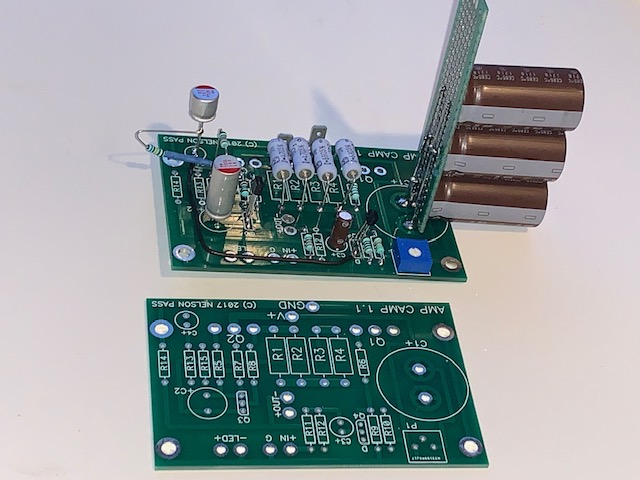

I'm in the process of using the last 4 boards of my stash of ACA 1.1 boards (the ones available at BA '17). I'm waiting on a few things to get a modest heatsink ready temporary use (in photos below), and then the testing begins (spots for a pair of 140s & 240s - for comparison in the ACA, and singles of 250 and two other lower Vgs MOSFETs - to test in my version of Juma's CapMult). Then we'll see how well each one does. Permutations and combinations, so much fun to be had! 🙂
I've modified the circuit board (cut traces) to isolate C4 and Q4 and included R16 and a wire to get the new voltage to Q4. I have also installed pots for R14 (5k) and for R12 (100k fixed + 100k pot). Most of these mods should be visible in photos below. I'll see what a bypass cap does for R12, if it seems useful later in the tuning process. I also have R15 up and easily accessible, so I can change it should I feel a need (I want to measure the current in R15 compared to that of R8 - can you guess why? - answer in PM if you think you do).
I'm using a mix of TungstenAudio's mods with yours, JOIMONFs and a few others, and a few of my own, including a funky vertical triple stack of 1000uF SilmecIIs for C1 (with space for a bypass, to be added/tested later). I also considered a horizontal stack on the sub-board, going cross-ways to the board, with two in the middle and one outboard of each board screw. The primary benefit of the horizontal layout is it allows mounting tabs to be attached to the cap board and connect to the board-mount screws (much more secure and vibration resistant).
I've also been looking at the MoFo, and I am somewhat tempted to try using inductors for the R1-R4 block. Other mods for that version would include putting a small resistor between them and C1 and relocate R15 to the far side of that resistor.
The way JOIMONF is using an inductor for the Rl position (R14 in the ACA 1.6 schematic) is interesting. I would think that one would want to get both the DC resistance correct (the Rl portion, for the tuning of (among other things) H2/H3 balance) and at the same time get the inductance correct (working in cooperation with C1 and the reactance of the specific speaker attached). That would be an interesting thing to try... eventually. While I will be working on tuning R14, the use of an inductor there will have to wait, as we're still using old JBL 2600s (best we have on hand) as our speakers. They will definitely be replaced, in the next few months...

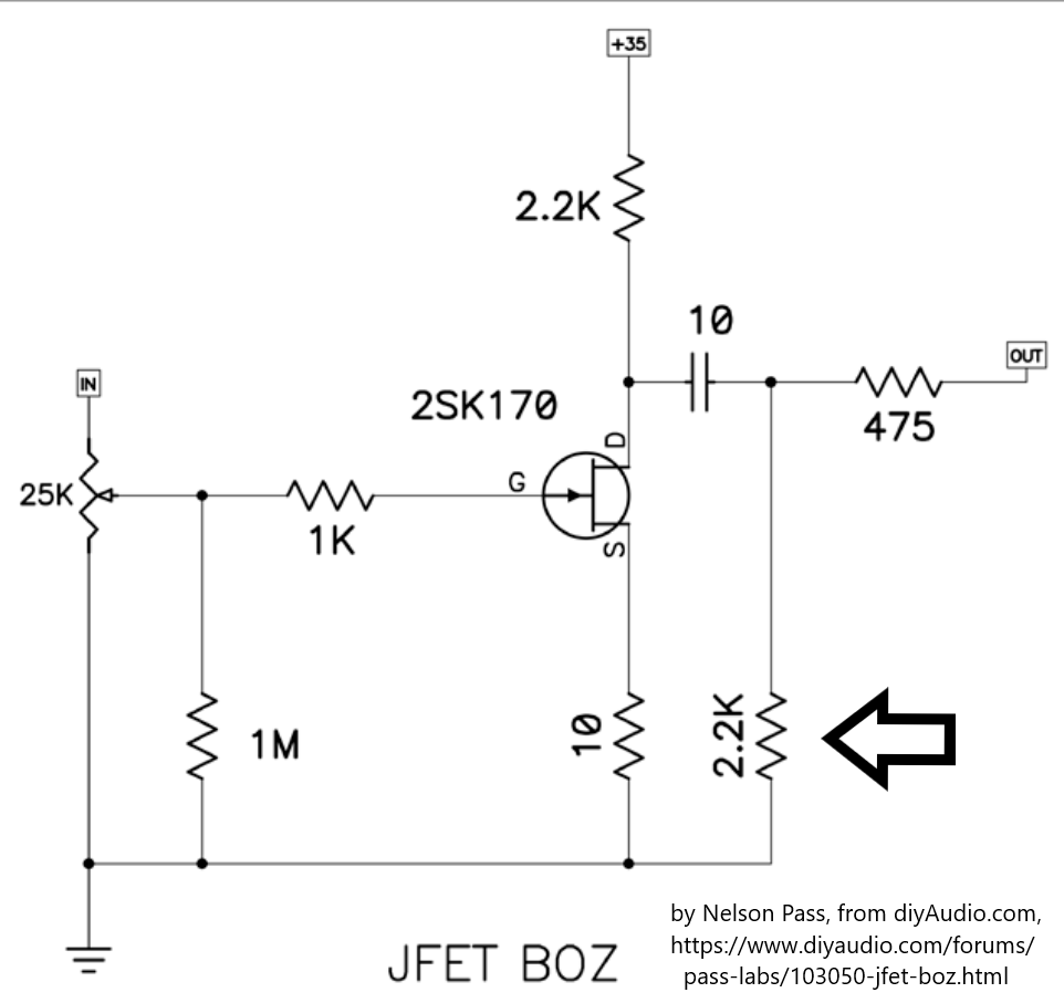

Regarding the Load Resistor:
The initial design from Nelson Pass in the "jfet BOZ" thread (post #2) looked like the attached image. I am including it as I spent quite some time messing with this circuit, with potentiometers in place of nearly every resistor in order to get a better idea how each functions within the circuit. My (sometimes confused) results can be found in the posts starting at 1476 of the thread * Jfet BOZ * (presuming you use 10 posts per page).
What I'm calling the load resistor (Rl) and ACA calls R14 is in this diagram as well (look for the big arrow). It is the 2.2k resistor outside the capacitor, and it does indeed help bleed the capacitor. It also helps to act as a filter, and can help reduce the 3rd harmonic, often at the expense of increasing the 2nd harmonic. It is often used to "tune" an amp to sound more "tube like" or more "solid state" depending on if the listener likes more 2nd or more 3rd harmonic.
Personally, I prefer less of both, and use Rl to minimize THD. There are design parameters for determining a "good" value for Rl (or R14, if you prefer), but the ultimate in fine-tuning (and the ultimate test) is the ear, specifically YOUR ear.
Oh, and the output capacitor and load resistor also interact with the speaker and it's reactance (including any crossovers contained in the box). It can get complex quickly, if you try to accurately model everything in the amp and in the speaker box. Oh, and don't forget the speaker wire, capacitance and a little inductance to go with the minute resistance. Sometimes I envy the ignorant bliss of the consumer-grade people. 🙄 (not really)

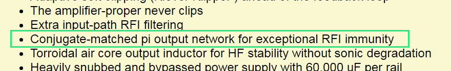

Occasionally you'll find discussions about building a conjugate matching network inside a power amp, at the driving end of the loudspeaker cable. This may be even more fun to explore, as it will depend upon the internal details of the speaker/crossover, and of the cable construction (conductance per unit length, inductance per unit length, capacitance per unit length), and, of course cable length. Lots of parameters to vary, lots of "design knobs" to adjust. Fire up the good old Latin Square Design Of Experiments, or for the extremely brave, Taguchi Methods. Woo hoo.
BTW, here is a pleasant exchange of letters between Bob Pease and myself, talking about the efficacy of Taguchi Methods. Published in Electronic Design magazine.

Hey Eric and TA:
It has been several decades since transistor and FET theory classes, and never took any amplifier classes, that was analog stuff.
Interesting tidbit - I had forgotten that the Collector Resistor in BJT circuits are often called the "load resistor" as well... Sorry if that caused any confusion. To me, anything after the output capacitor is part of the load. In this case R14 also acts as a protection against having no speaker connected.
My presumption was that the Harmonic 2/3 effect was from the RC filter composed of R14 and C1, more than with the speaker, although some interaction (however small) with the speaker does exist. For reasonable values of R14, I would think that the impact on the speaker and crossover would be negligible (1k or more in parallel with 8 ohms...).
Hmmm, turns out the filter formed by C1 and R14 is a High Pass, set (using Papa's values) for a Cut-off frequency of 4.8 E-8[Hz] (per *(Sample)RC Low-pass Filter Design Tool - Result -*). So, that wasn't what I expected. That'll teach me to open my mouth before checking my memory against reality...
Ok, I'm out of ideas. I have seen it change, as I messed with the pot for Rl (in the jfet BOZ thread), and know it impacts performance, specifically H2/H3 performance. But I am now at a loss for the actual mechanism for this effect...
The capacitor blocks DC, and lets (per the math above) anything with even a thought of varying its voltage through. The R14 gives the current an alternative place to go, rather than through Q1, and shunts it to ground (as does the speaker, and more effectively, based on the relative resistances).
But how does this impact the harmonics? It isn't feedback, as it goes to ground, not back to the gate. It doesn't seem to be able to select frequencies to help usher high order harmonics out of the circuit to ground.
All I can come up with (based on the pre-amp, which has some differences) is that the load resistor, well, loads the circuit, and in doing so, alters the way it works. Not on the DC side, but on the small-signal side (if a power amp has a small-signal side)... This was seen by (at ridiculously low values of Rl) eventual attenuation of the output signal (fundamental as well as all harmonics) in the pre-amp circuit.

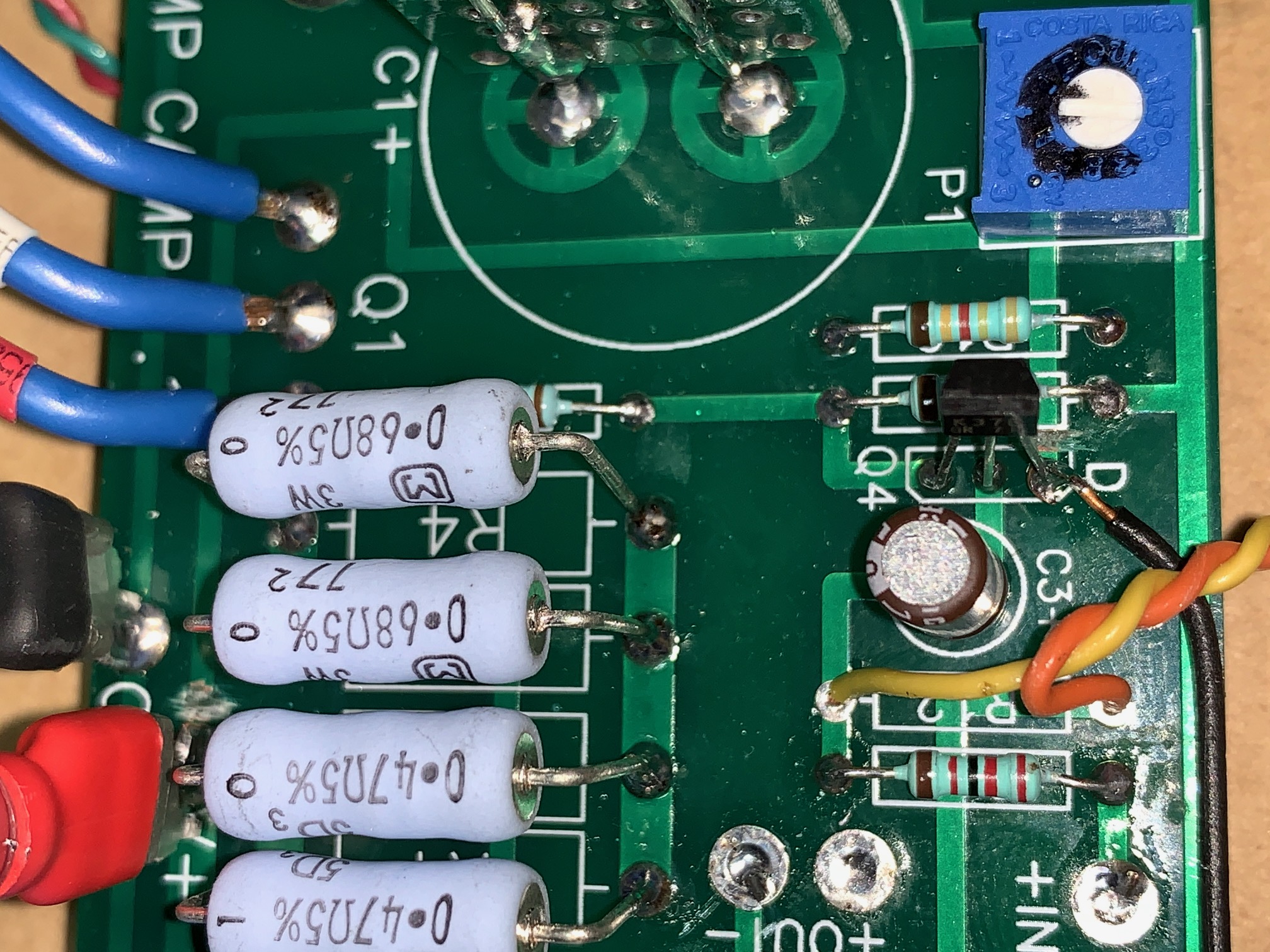

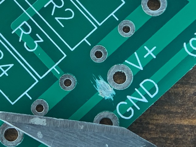

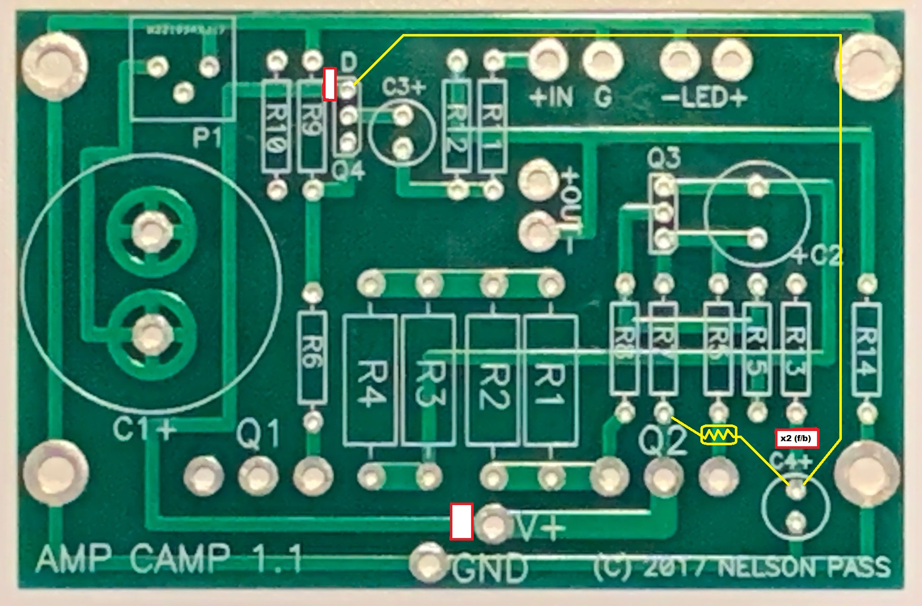

I'm not used to asking for help, but here I go... I had planned an afternoon of fun and experiments with mods to an ACA board, but I can't seem to get it to even start...
I have built up a pair of ACA boards before - the 1.1 boards (c)2017, from BA 2017 - they're downstairs in the family room. This shouldn't be difficult. Yet here I am, with a board that refuses to power up. By that, I mean the MOSFETs are not taking any power. The power supply is registering less than 10mA being consumed.
Here are the measurements so far:
Q2: Vgs = 0.0, VDS = 13v
Q3: all legs show 0v (Vcd, Vbc, Vbe are all 0v)
R7: 13v
P1: 6v
R9: 3v (mA thru Q4)
The voltages across R7 and Rp add up to the source voltage (starting with 19v)
The troubling thing is Vgs for Q2 - that implies a dead short bc on Q3. But the transistor tester gives the same info for the pulled unit as for the unused unit (hFE=171 & Uf=655mV), so (at least in theory) they are both good.
Even with Q3 out, the R7/P1 voltages remain, and imply 1.3mA going thru the capacitor - is that appropriate, or is the cap bad? I tried measuring resistance with Q3 out (between C & E) and got 2.7 ohms. Unfortunately, that is probably related to the capacitor, as it is across those two pins. Any thoughts?

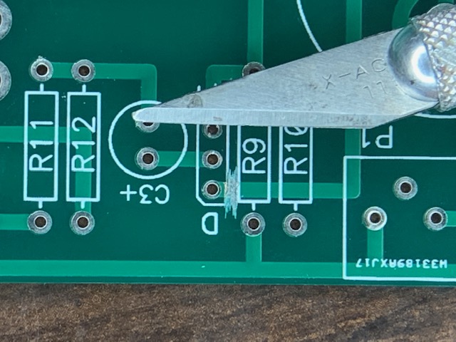

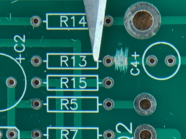

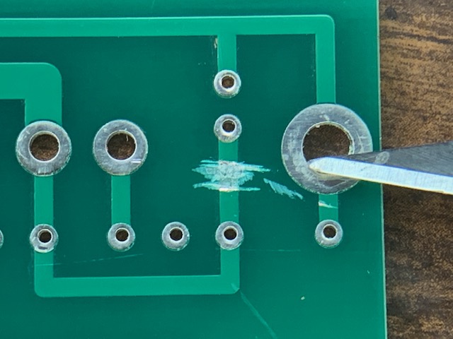

Now for the tough part... I've modified the board. I cut both traces between R13 and C4 (front and back) and the trace that brings power to the drain of Q4. These are the red boxes in the unpopulated board photo. I added a Resistor (R16, 604 ohms to start) from power (at R7) to the +leg of C4, and a jumper wire around to the drain of Q4. These are the yellow lines in the unpopulated board photo. Everything should now be hooked back up the way it was, with R16 to help keep excess voltage from Q4 (as the power supply will be going up once I get it working). The rest of the parts are unchanged, except for R11 & R12, which have nothing to do with the main current path for the MOSFETs.
There is obviously something going wrong with the setup for the constant current source. However, my degree is in digital, not analog, and I don't recall enough classes from <mumble> years ago to be of any real help.
I can get more voltage readings, if that will help. I eyeballed the resistors, and none seem to be off. I even did some in-circuit resistance measurements, and they seem to match what is expected. There are attached images, perhaps they will help as well.

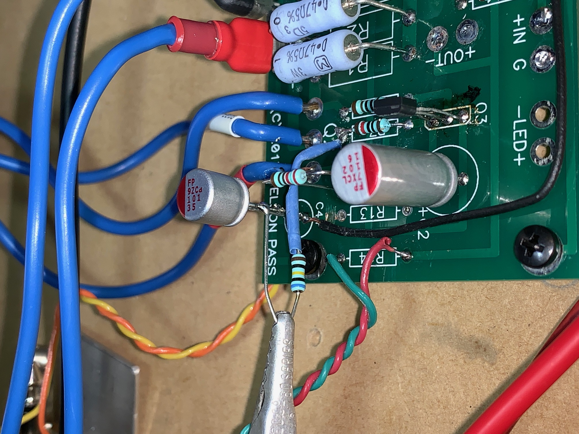

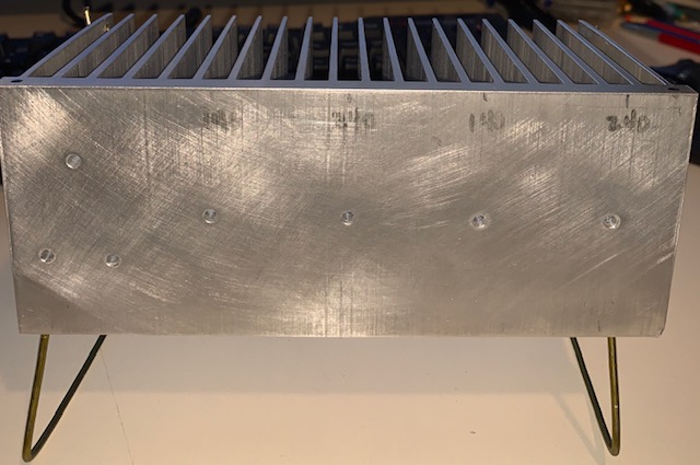

-Note that the MOSFETs are bolted to a heat sink and the wires (with red, white and blue wires/heatshrink) are GDS, like the MOSFETs (as seen from this direction).
-Note that R13 & LED are not populated, and that R14 & 12 are wired to off-board potentiometers.
-Note R15 is waaaaaaaay up in the air, as I wanted to be able to get leads on it easily for voltage measurements.
-Note all three of the images (when expanded) are 'upside down' compared to the copyright lettering at the 'bottom' of the board.
Thoughts, ideas, hints, derisive laughter?

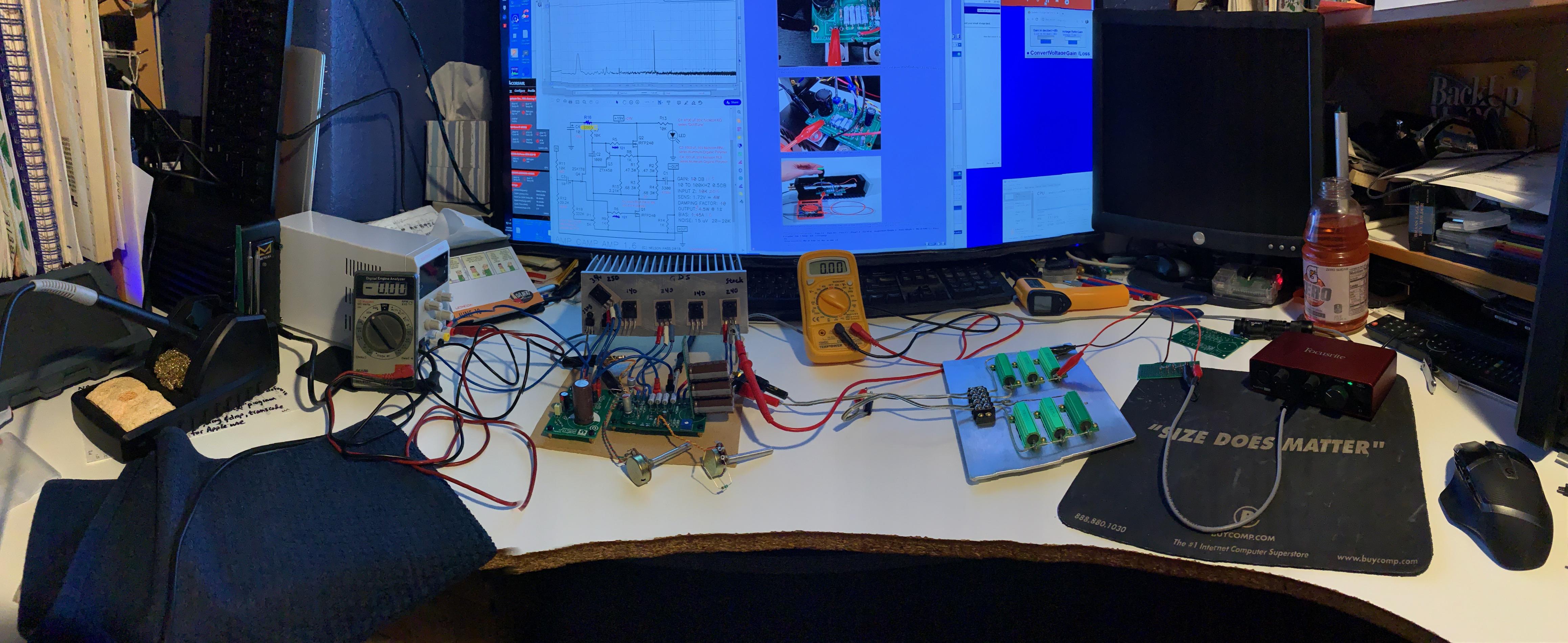

PS - I added an image of the lab setup, showing the heatsink with lots of MOSFET parts to swap out. The cluster of 3 on the left side are for the CapMult, and I confirmed the voltage loss for it matches the Vgs-on for the part. The two smaller parts have a 2V drop for Vgs, but I haven't had a chance to test it out under load to see if that is enough to be effective or not...

It is difficult to tell what is going on based on the photos.
Q3 is part of the current source. Without it to control the Vgs of Q2, it won't function properly. The leakage current through C2 may be within range for the organic polymer cap being used at that location. Check the datasheet to confirm.
The ad hoc connection for R16 looks pretty dodgey. The long jumper wire looks like it could be problematic as well. This version (v1.1) of the ACA board is not as easy to modify as the later version, which is now available in the diyAudio store.

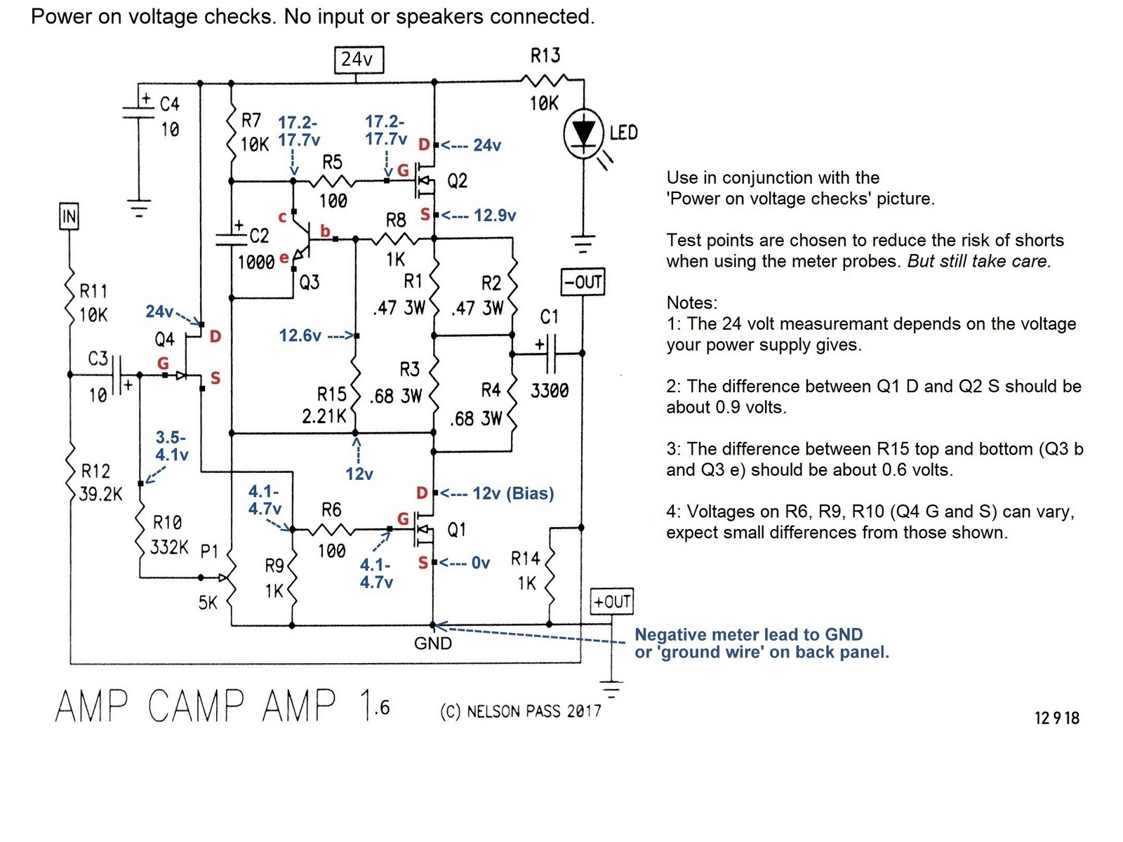

Here is a set of expected voltages for the ACA with a +24V supply, and standard values for R1 – R4. This should give you good targets to shoot for. The Drain of Q4 will of course be lower based on your choice for R16.
Thanks for the reply, TA. Unfortunately, none of those values can be achieved until I get the CCS running (Q3/Q2). The main difference between your drawing of mods and my layout is I didn't get 121 ohms for the MOSFET stoppers.

If Q3 is open circuit (blown), then the voltage split between R7/P1 sets the Vgate of Q2 at about 6 volts, which is where Vsource would be for Q2, absent any voltage across the fractional ohm power resistor block. This leaves the Vgs well below operating range, and Q2 shut off tight. The argument in favor of that is the circuit behaved the same way with the device present as well as absent.
If Q3 is shorted, Vgate for Q2 should see the same value, but now current flows around the capacitor (not sure if that matters). However, Vsource for Q2 now differs by the voltage drop across R8, which is (in series with the power resistor block and Q1) the alternate path for P1. Unfortunately, R9 was showing low 3volt range, so not far enough up to start Q1, so that makes R8/power resistors a dead-end path, no current in R8, no voltage across R8, and Vgs on Q2 is roughly zero. So shorted would show the same response, if my analysis is correct.

I just realized something... There is a remote possibility that at 19v, R16 is limiting the current flow through Q4 to the point that Q1 won't turn on (Vr9 has already been confirmed as being too low, as it measured a little over 3v), and the stoppage is actually in Q1, not the CCS. Both Q1 & Q2 have to be on for any appreciable current to flow. If Q1 is off, we have 19v trying to push through the 5k resistor P1, resulting in what, just under 4mA, right?
Since my voltage across R9 is low, that is certainly part of my problem. R10 along with P1 provide a positive bias to Vgs for Q4, and if the DC current flowing through Q4 is insufficient, it cannot raise Vgate enough over ground to turn Q1 on, and everything grinds to a halt...

The value you've chosen for R16 won't be an issue with a +19V supply. It will simply reduce the Vds of Q4, which still has some headroom. Remember that the P1 adjustment will result in about 4 mA to 4.5 mA of current through Q4. That same current will flow through R16.
At this point it is probably time to verify that the resistors have the correct values, and are making proper connections in the circuit. Do this with the power off. The current source is a simple circuit, meaning that a simple error is probably responsible for the problem.
Thanks for the info on the stopper resistors. I may try something once I get the final speakers designed and built.
Again, the picture was taken with Q3 out, it is normally in. While it was out, it allowed some measurements to be taken with better part-to-part isolation. Sorry for any confusion about Q3.
I pulled each active component, and they all test in my cheap transistor tester to be the same as before they went in, and match the other 3 sets of parts (within a reasonable margin). That seems to indicate the actives are not the problem.
I also checked each resistor visually, and tested them in-circuit (thus the comment about R8 (in conjunction with the power resistors) & R15 being in parallel). Everything seems to be as expected.
That leaves me with two possibilities
- I botched the cutting of traces, which seems unlikely, as I shorted R16 and everything seemed to measure (resistance wise) as expected (point-to-point, based on what is in parallel or series).
- one of the capacitors is having trouble, which might be remotely possible, as I didn't check them before putting them in.
The next step is to pull the caps and check them. If that's not the issue, I will re-attach the damaged traces and see if it starts working again. This has been extraordinarily frustrating, but that's what I get for not measuring, marking and verifying each part.
