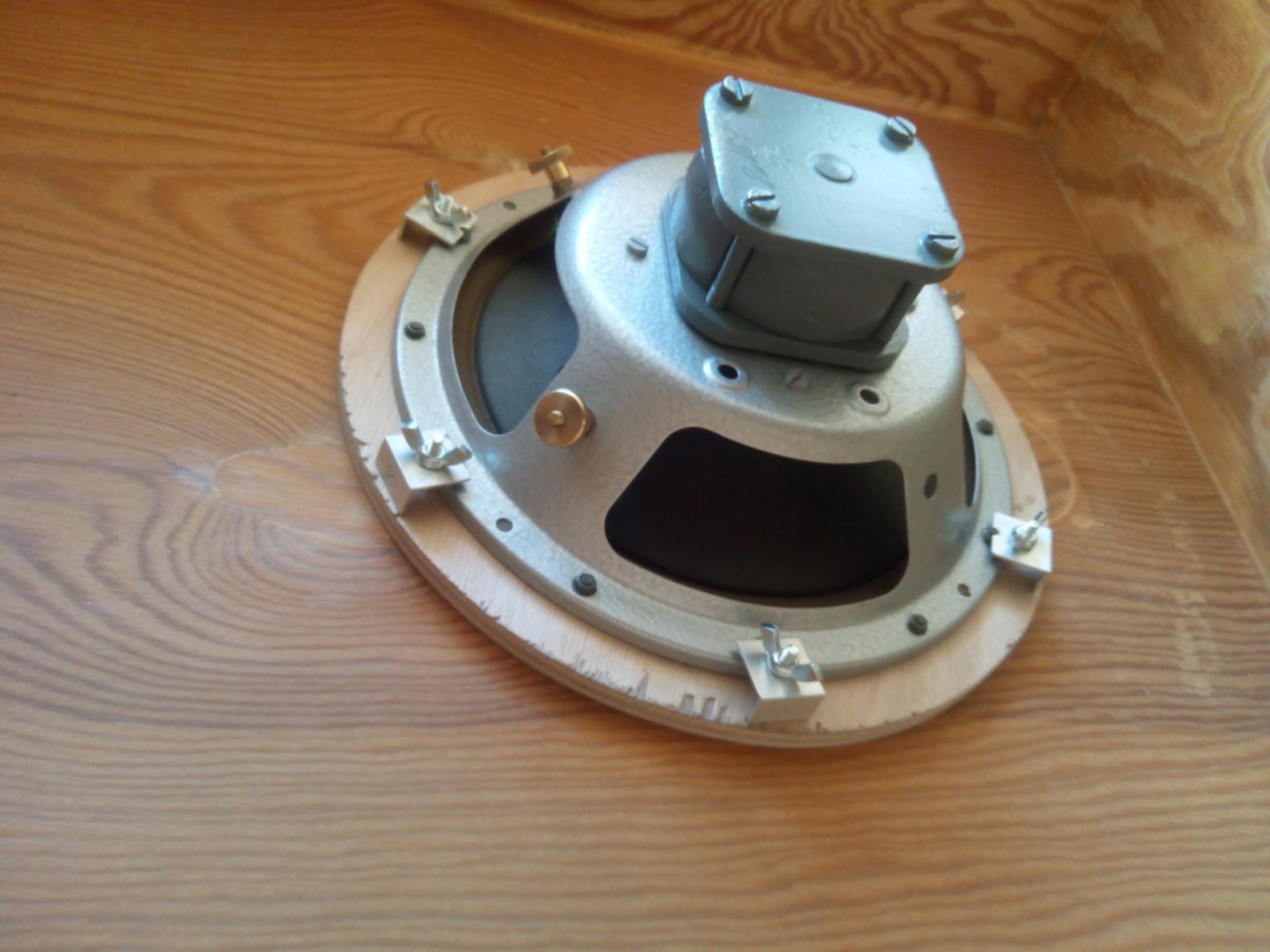

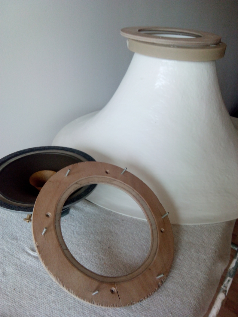

This is my speaker driver, Rullit Classic 8", it has bakelite spider inside, delivers lifelike in low level, so called microdinamic. Then is a resin front horn, great for macrodynamic, one speaker (mono) is enough to fill the room, but for modifications better close the ear to the speaker mouth, and can hear every change. Very sensitive to any capacitance in excess.

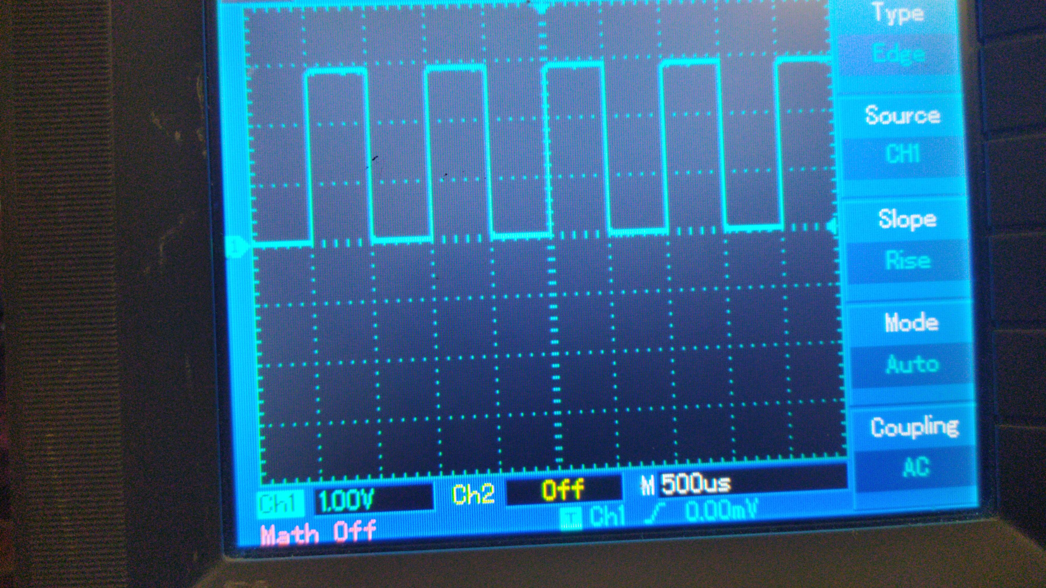

First capture is input square signal 3V./1khz taked from the same oscilloscope. (Not having external signal generator). That should be 1,5Vpp.

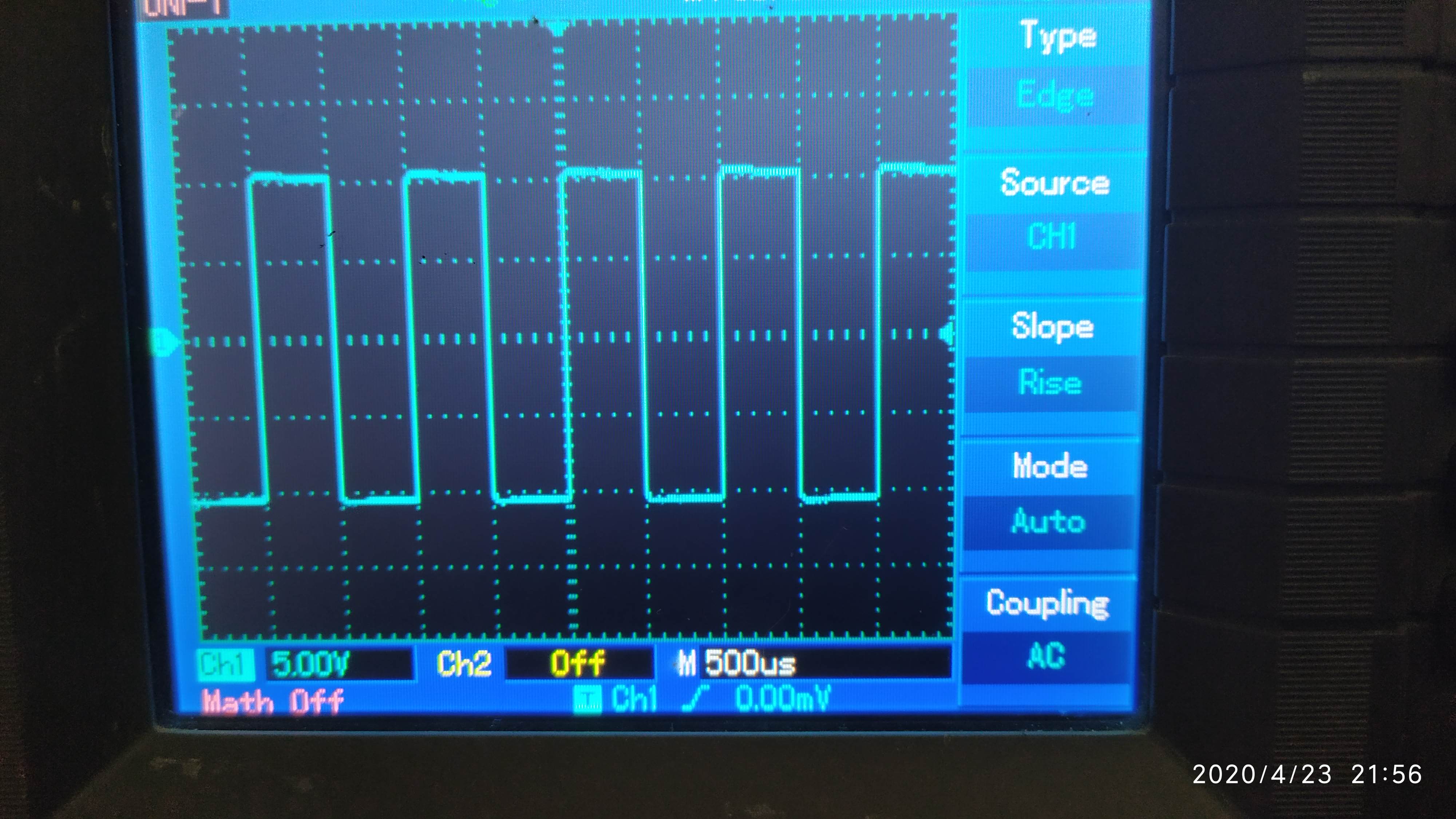

Second pic. is at output, Tungstenaudio mods, 20kohm. input, etc... PCB is from user Rudi here.
5Vpp at 8 ohms 3.125W
A nice10db. amplification (gain 3,3x)

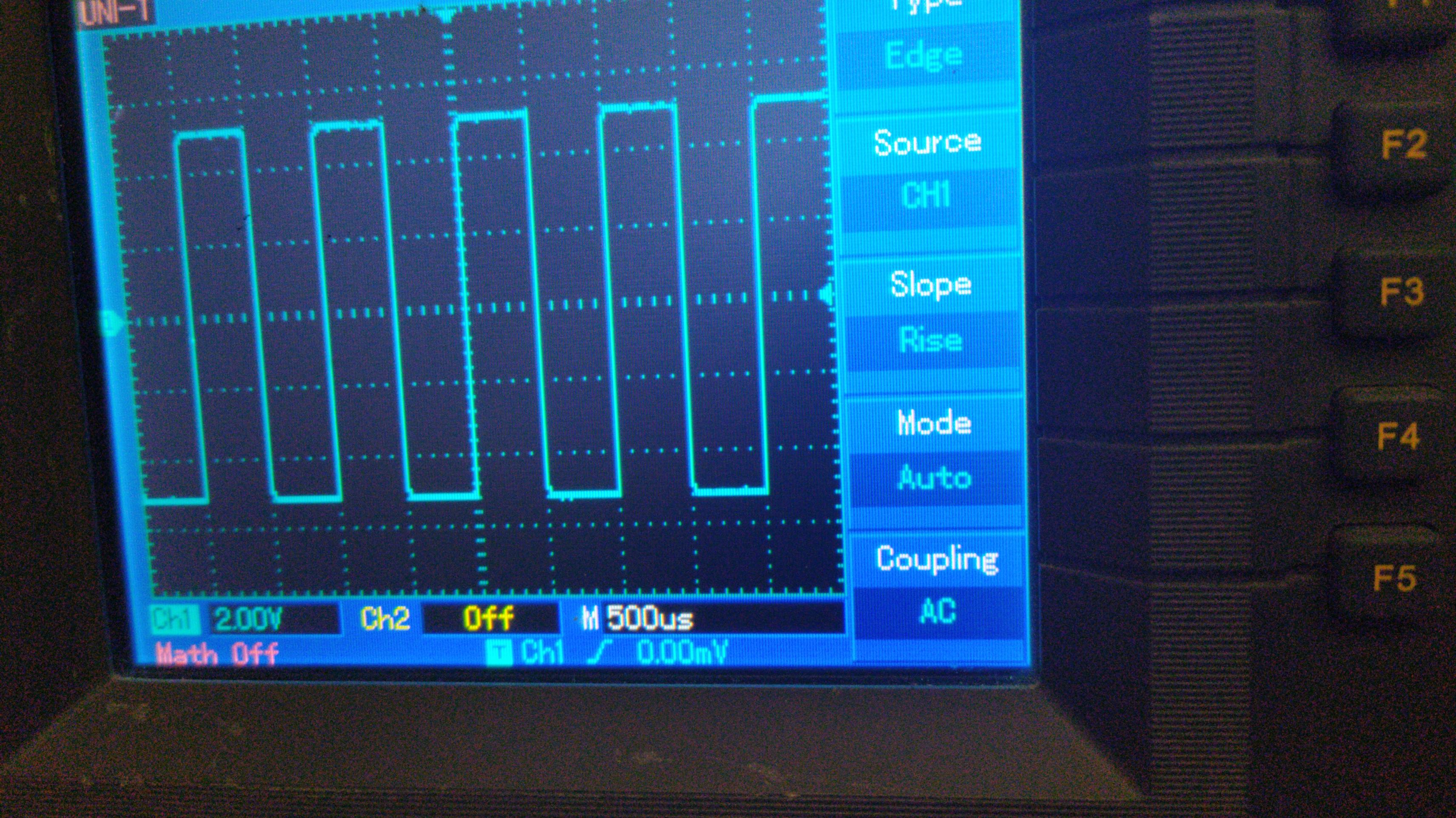

Third pic. that I shoot right now, is my own non feedback version. (And no input resistor).
Seems to have more gain: 10Vpp.

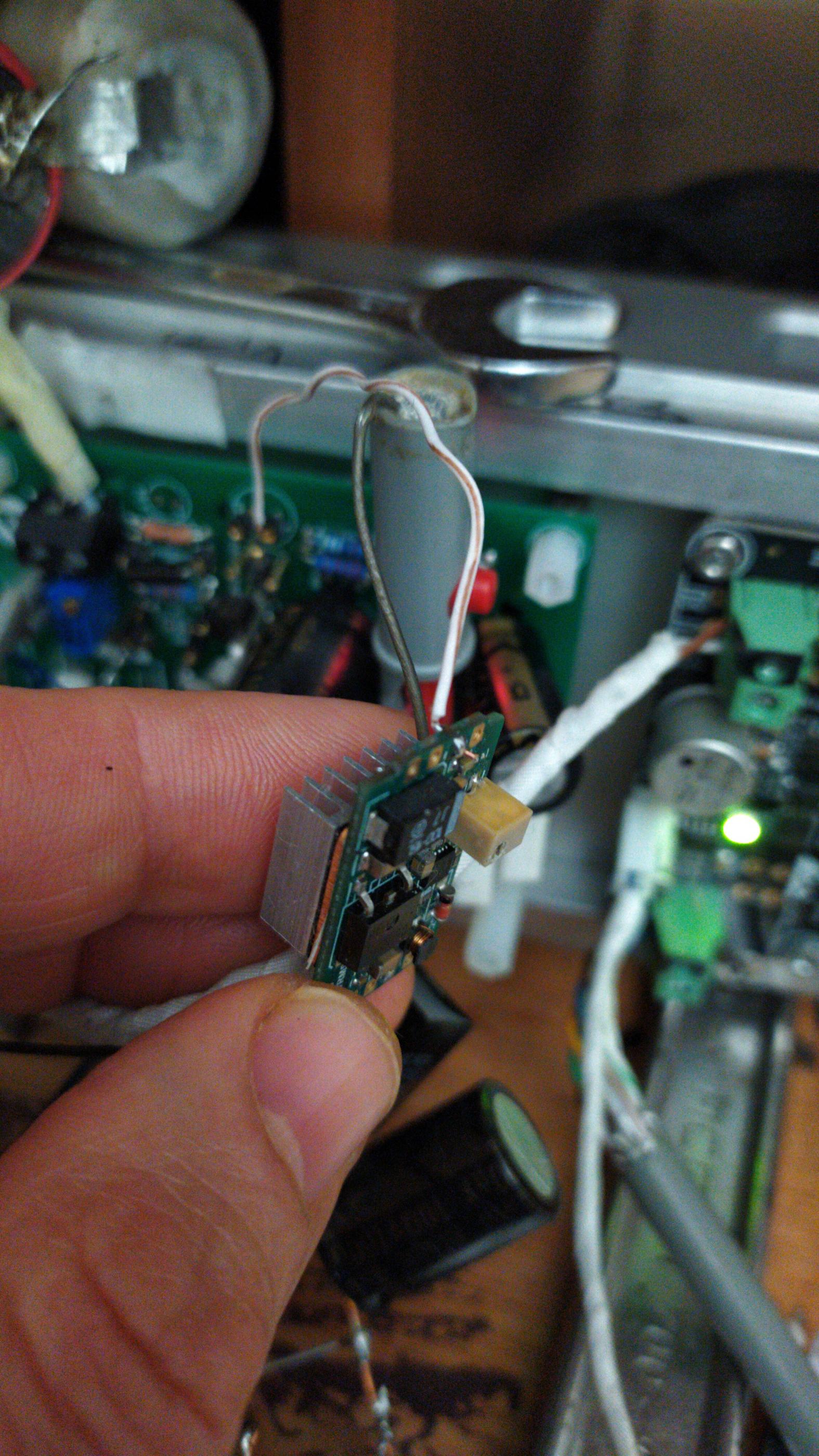

Another premium part I find, a bit tricky not a direct replacement. R16 / 200 ohm and C4/100uF can be substituted for a low noise DC to DC reg. board.
I set troaugh the small trimmer an output 18,7v. to fed the Toshiba 2SK170 transistor.
