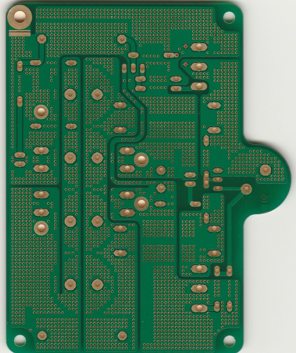

Kokanee, let’s discuss the trace cuts and other aspects of using your boards here. This may help other forum members.
Agreed. I have attached 3 images of the boards I have.

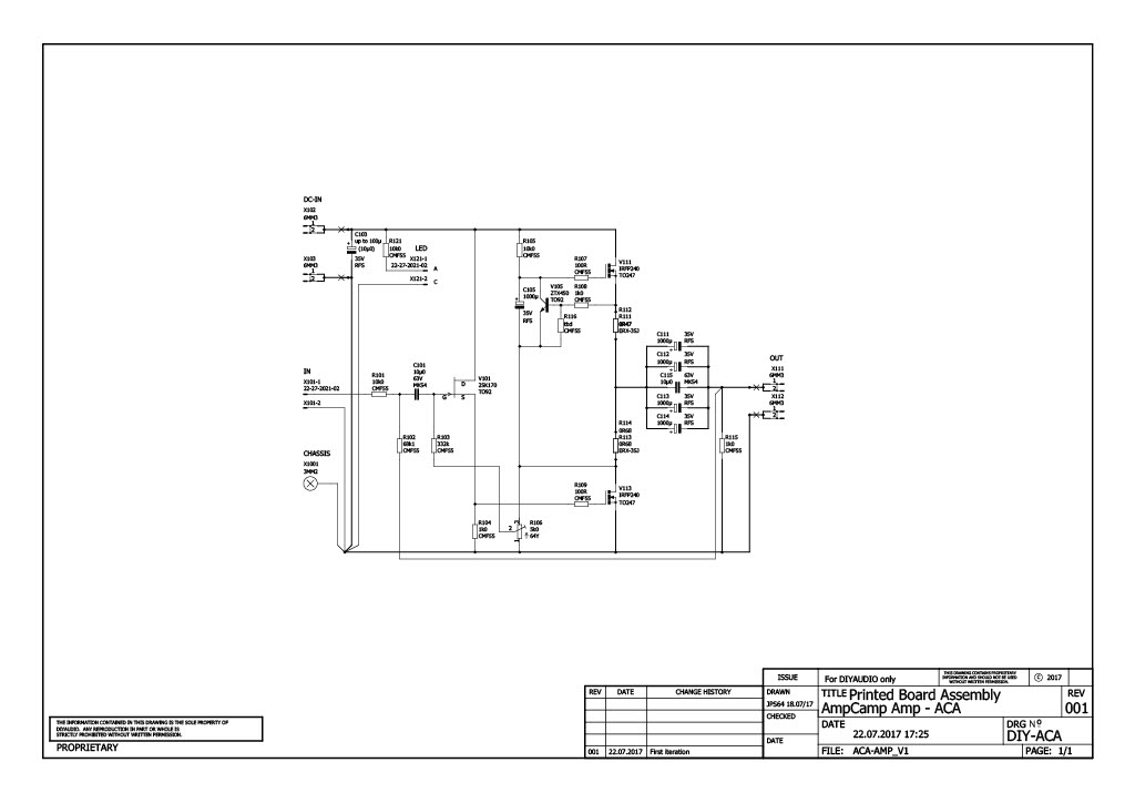

One note before we begin: I read in the ACA thread that the LED was not necessary for a properly functioning amplifier. So, to my untrained eye, can I insert the 499 ohm resistor (call it R16) into the spot for the LED and form the RC filter with C103. Would save a lot of work and worry.
TA, I read your reply to my PM, and the only caveat (I see) to the above is that you quote that a cut needs to be made in a place that leaves C103 connected to the drain of V101. I assume this means directly connected to the drain of the JFET, rather than passing through the resistor first, as you show in your aca16 mod schematic with the 200 ohm resistor.
View attachment ACA-AMP_V1_SCH.pdf

I'm sorry to say that this particular board layout does not offer a reasonable way of inserting the dropping resistor, R16, prior to the positive terminal of C103. There is a rather large power plane which would need to be selectively carved up with an Xacto blade or even a Dremel tool. Since we are looking at the bottom layer, I can only assume that the top layer is similarly arranged, due to the pattern of vias. This layout style is, to be quite frank, a bit of an affectation which offers no real benefit to performance.
Sorry, I guess we were posting at same time.
So choices are to just build and enjoy as a regular stock kit ( 20 V or so). Would you still recommend a linear PS, or power with the wall wart or small smps. It is DIY live & learn as you go. Should be a useful building excercise.

The ACA can still benefit from a good linear power supply. Since it is a single-rail design, a typical transformer with dual secondary windings may be used to build a quasi dual-mono PSU. You could still safely use 18V secondaries to get around 22V to 23V power on the board.

I can see a way to carve up the power plane and use the LED resistor as a substitute for R16. It's more work than I would care to take on, especially since the cuts need to be duplicated on the top side of the board. There is a chance of making the board unusable in the process. Then you need to repeat the process for the second channel.
Thanks but no thanks, I know my limits as a beginner. I try to employ the KISS method whenever possible. I am going to build a PS giving 20 - 24 V, set the bias to around 1/2 of voltage and see what happens.
