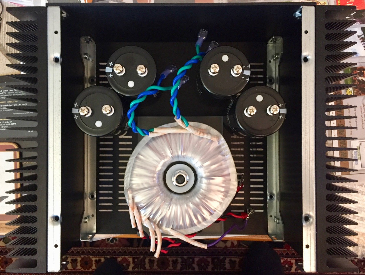

Is there any advantage to using the IRFP140 with higher voltage in a parallel mono setup for 4 ohm speakers? I always thought that for 4 ohm speakers one had to decrease the voltage and increase the current. Am I wrong about that with the ACA? What would be the best current/voltage combination for parallel mono in that situation? I would like to be able to use the ACA chassis from the diyaudio store, would the heatsinks on that chassis limit the current in my build?

As previous posts have mentioned, running the IRFP140 with higher voltage is beneficial. The higher voltage helps (slightly) with improved transconductance, as well as lowered parasitic capacitance. Mainly, the device will be closer to its "sweet spot" of linear operation.
Using the ACA in a parallel mono setup is also beneficial for some types of speakers, including those with lower impedance. In addition to parallel mono, I recommend changing R3 and R4 to 0.56 Ohms in order to increase the bias current. Also change C1 to 4700 uF, Nichicon KG series.
Probably the biggest improvement will be upgrading the power supply to a linear one. I recommend the Antek AS-3222 or AS-3224. This will feed the amp boards with a better supply of clean current. A single stereo chassis can be configured as a dual-mono amp this way, and parallel mono can be configured with a back panel switch with some thought. This has been covered previously in this thread.
The smaller 2U Mini-Dissipante chassis will be difficult to work with, but the 3U Mini-Dissipante chassis is just the right size.
This is what the 3U Mini Dissipante chassis looks like with a 300VA transformer and some bulk capacitance for trial parts placement. This is the 300mm deep version, which should also be sufficient for power dissipation.

Jazzzman, I expect the Dissipante-3U-case (heatsink: 300 x 120 x 40mm) to have a thermal resistance of about 0.5 - 0.6C/W.
As comparison I took a Fischer SK 47 heatsink (the one that I am using).
If your ACA will ever produce 50VA per channel, this will contribute 50 x (0.5 - 0.6) °C to the surrounding temperature (say: 22°C)
and will then result in about 50 - 55°C heatsink-temperature.
This is o.k. - Rudi
