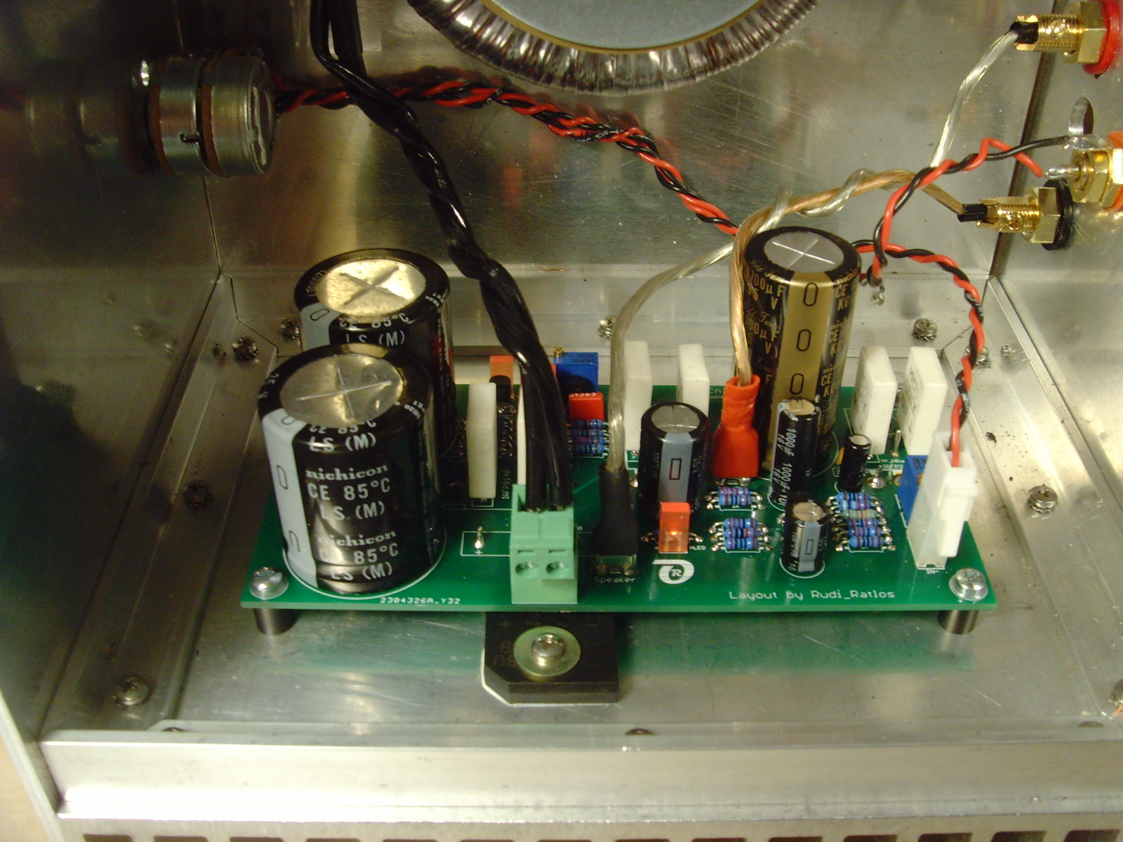

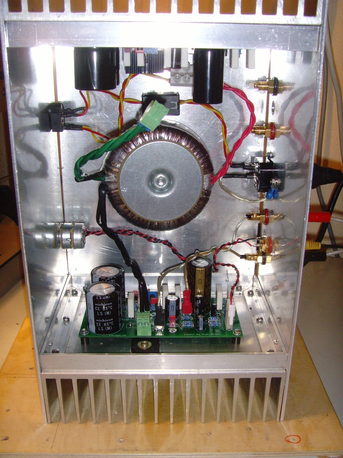

Hi James, find attached a couple of images showing my current ACA (including your recommendations / changes).

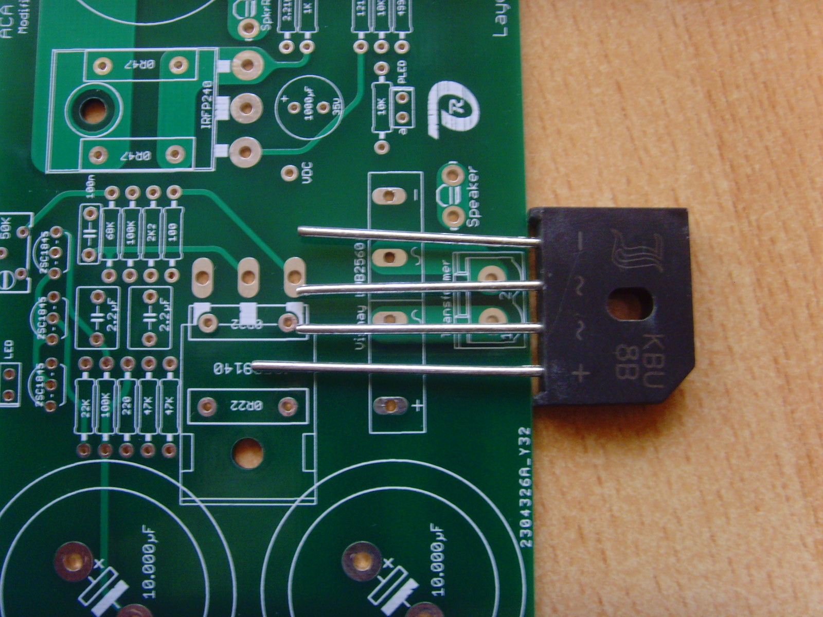

When I started the layout-release shown below, using the Vishay LVB2560 bridge rectifier, I had severe problems concerning the thermal dissipation of the rectifier.
I had to finally replace it with a DIOTEC KBU8B, which has very long legs (see image 3) and does a very good job (0.8V drop per diode) as well.
My current ACA is driven from a 230VAC / 19VAC INDEL toroid with 2 secondaries, each secondary rated at 4.21A and resulting in about 25VDC "quiescent voltage".
It is "powered" from a "JKuetemann CAP-multiplier".
And it sounds: "absolutely great".
I will not try to improve the current scheme ("Never change a winning Team"), but will work on the case from now on.

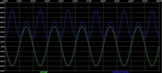

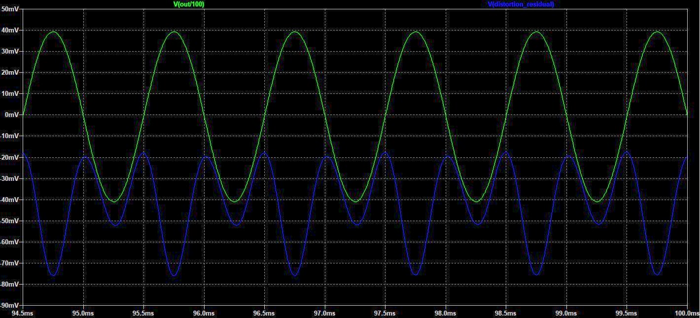

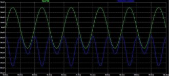

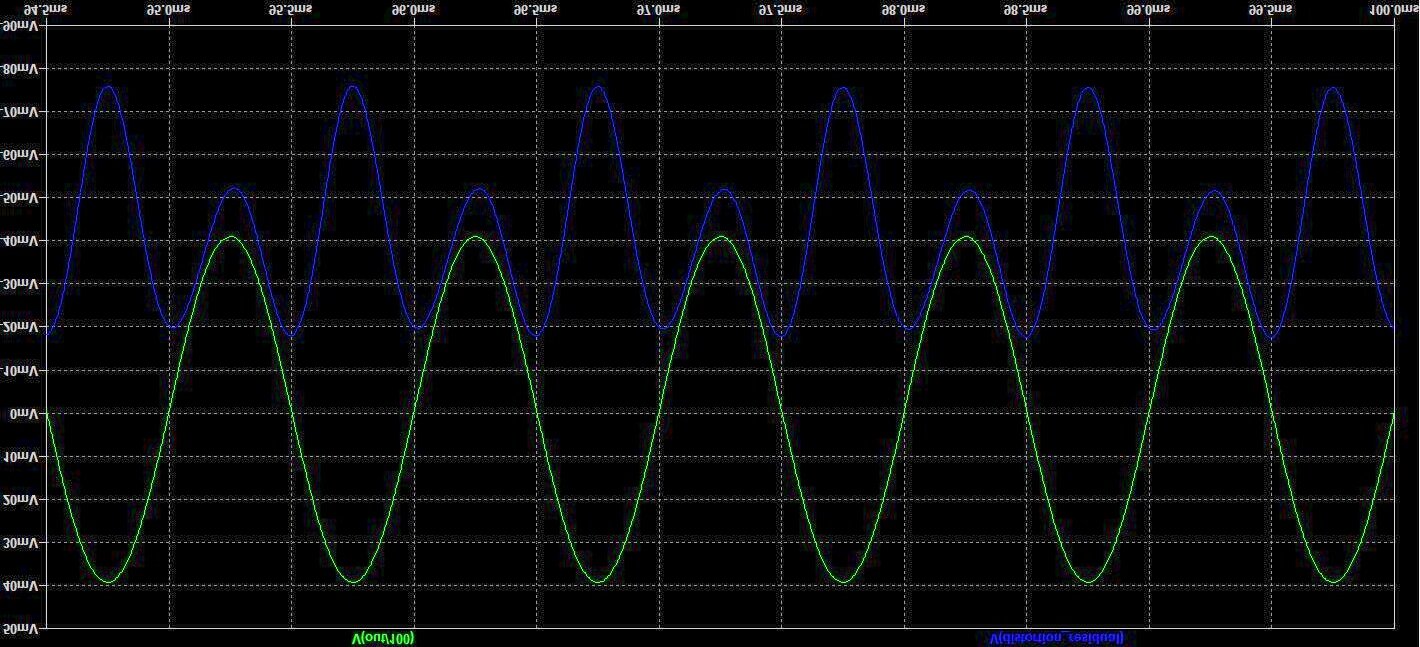

Question to TungstenAudio Post - #171
Your scope shows the same result as my simulation in LT Spice (aca_ltspice.jpg),
indicating a negative H2. (And so do other FW amps I have simulated so far.)
But, the ACA is an inverting amplifier and therefore normally it is recommended
to flip the speaker wires to reestablish the proper absolute phase.
This then results in positive phase H2 (aca_ltspice_flipped.jpg) at the speaker.
Was GND of your measurement setup connected to GND of your ACA ?
^ Yes, as you have guessed, I connected the GND of my test instrumentation to the GND of the ACA. (Red speaker terminal) This was because the HP 339A was also the signal generator.
