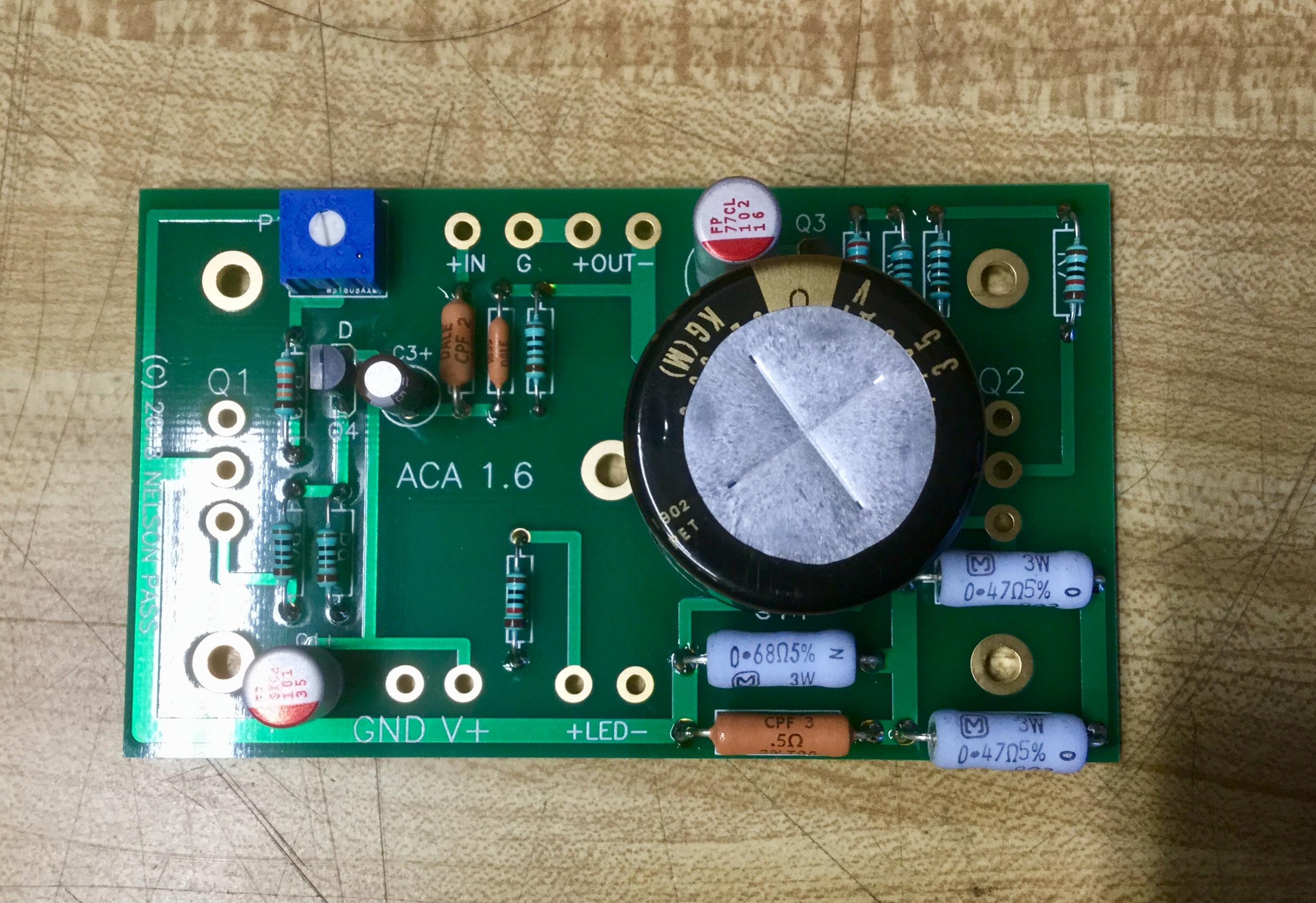

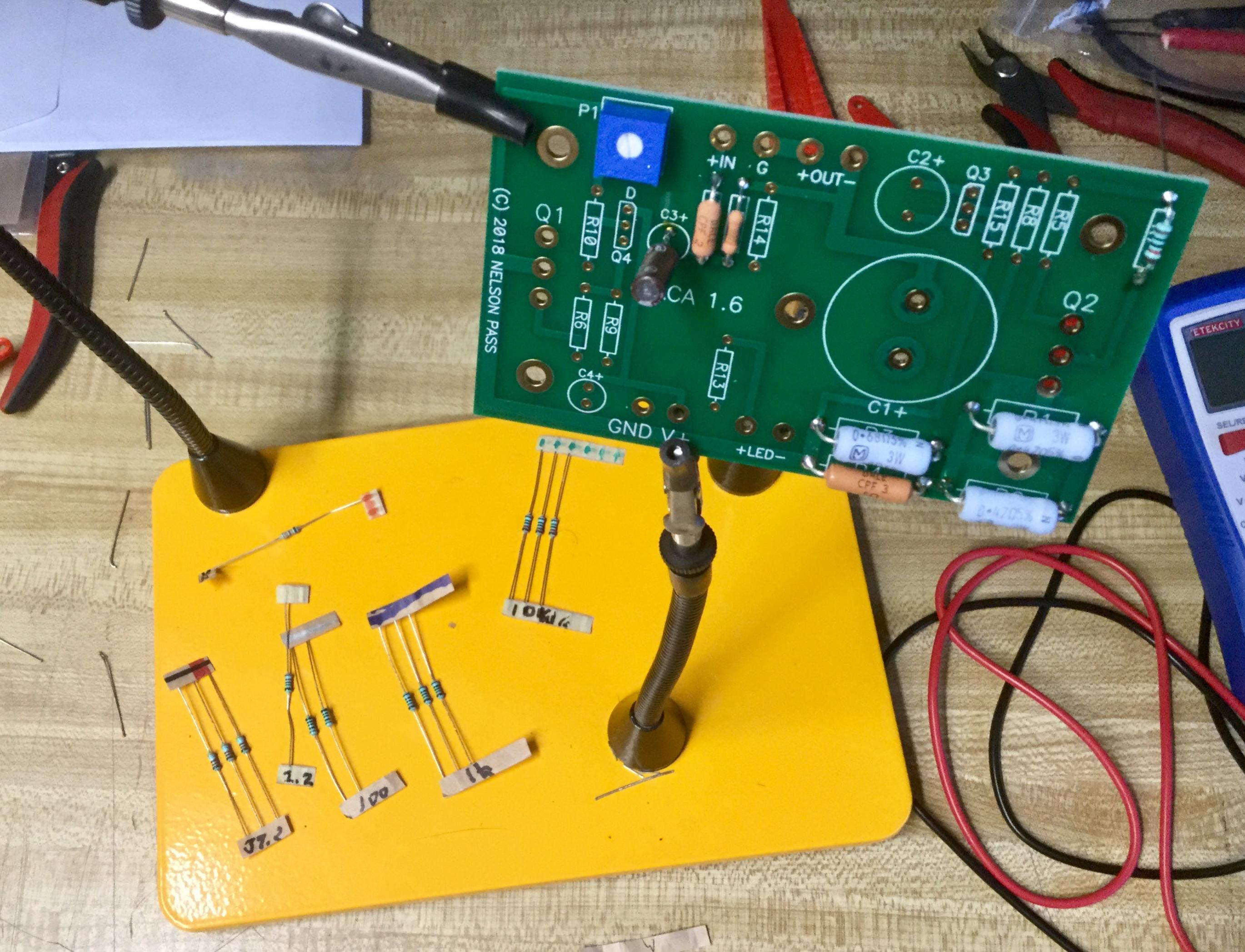

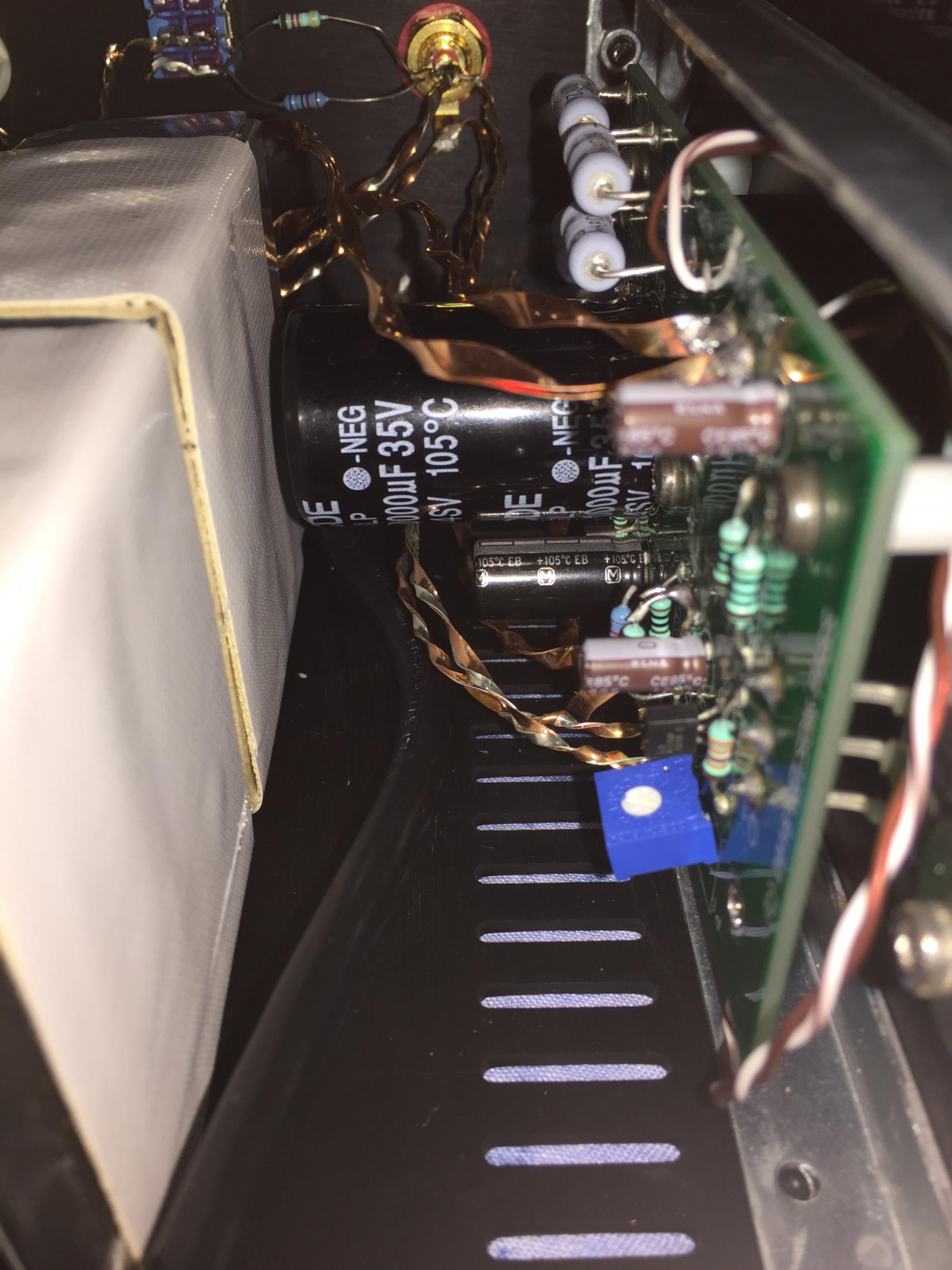

I recently bought a balanced preamp to go with my ACA 1.6. I figured I’d buy another ACA and run them as balanced monoblocks.
After ordering the second amp, I ran across this thread and thought I’d update the second amp with the premium parts. One board finished yesterday and I should have the second board finished this weekend, if my home projects allow.
I’ll listen to the second amp and see if I can hear a difference for the better, comparing the first to the second. If I do, I’ll update the first amp with the premium part changes.

I did. I found a noticeable difference between the two amps- one ACA 1.6 stock and on ACA 1.6 modified following TungstenAudio’s mods. (Post #31, I think).
The modded ACA was more interesting and lively. I could hear more details in the modded amp and easily pick out which channel it was driving. When I played each amp driving both channels, I preferred the modded one.
I bought the parts from Mouser. Maybe $50 total for both amps. The reworking of the first amp was a slight pain, but not too bad. Worth the time and money. I set the bias to 12.4v.
My current set up is high efficiency speakers, a balanced preamp and the ACA monoblocks balanced.
I finally got around to building a 2nd ACA with the modifications suggested by TungstenAudio and the improvement over the stock build is very positive. Next I will modify my original ACA and try the parallel mono configuration - I expect more improvements!
Can someone recommend a source for the 0.5 ohm resistors? For this build I used a parallel 2 ohm resistor because I couldn't find a single 0.5 ohm.
Vishay part# CPF3R50000GNE14
Mouser carries them. There’s more than one was to get the total resistance. A pair of 0.56 Ohm resistors will also do the trick.
