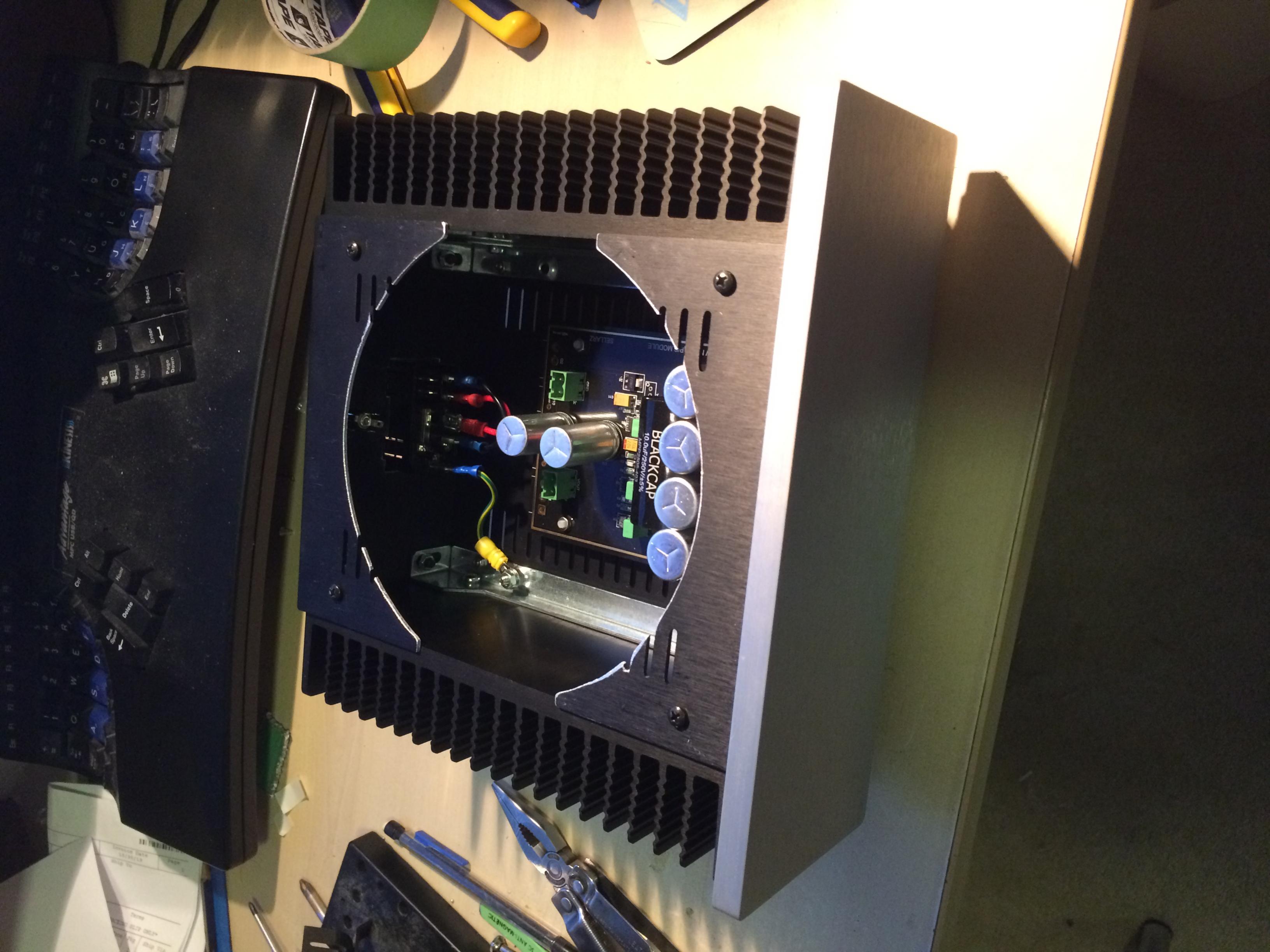

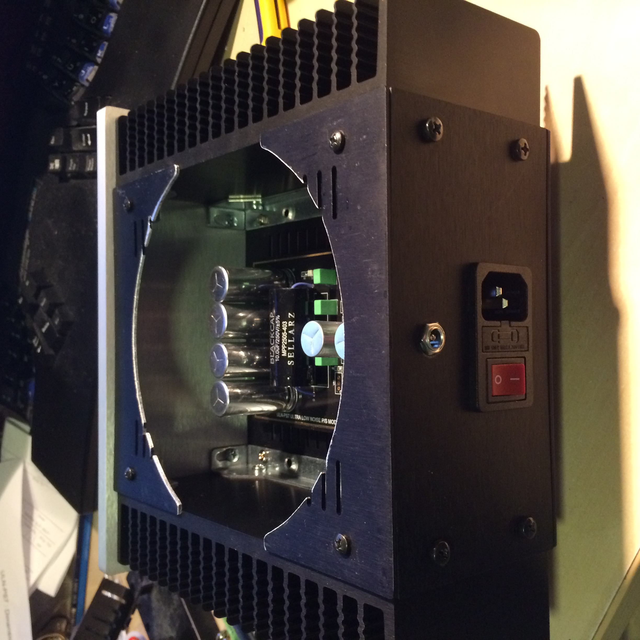

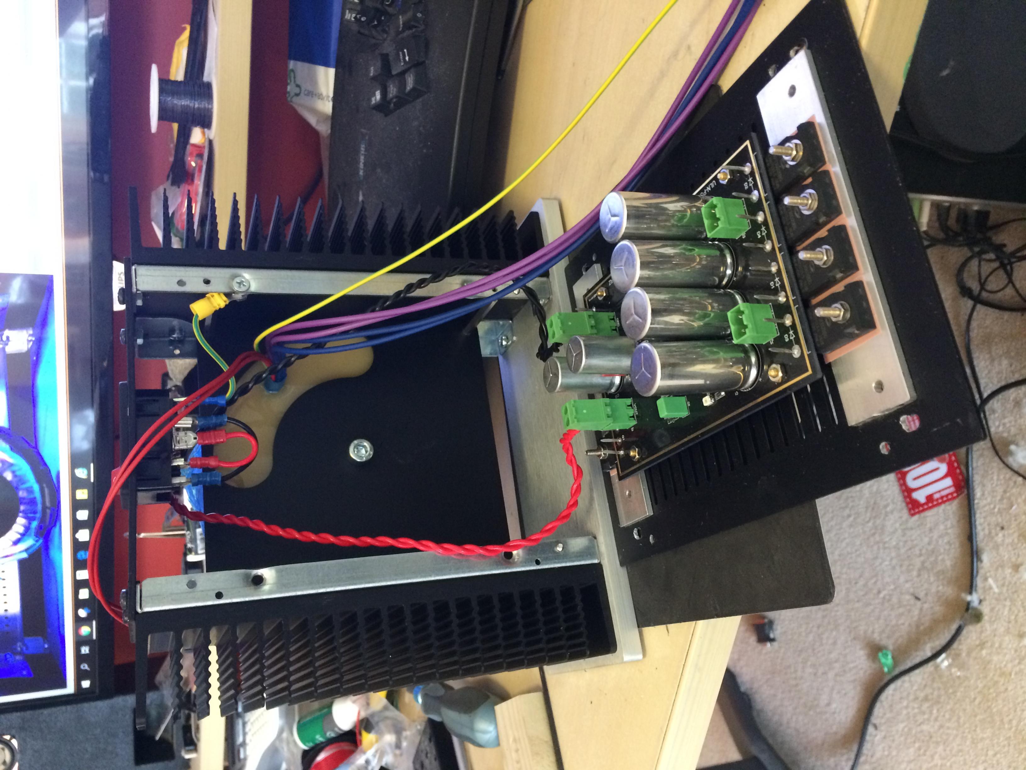

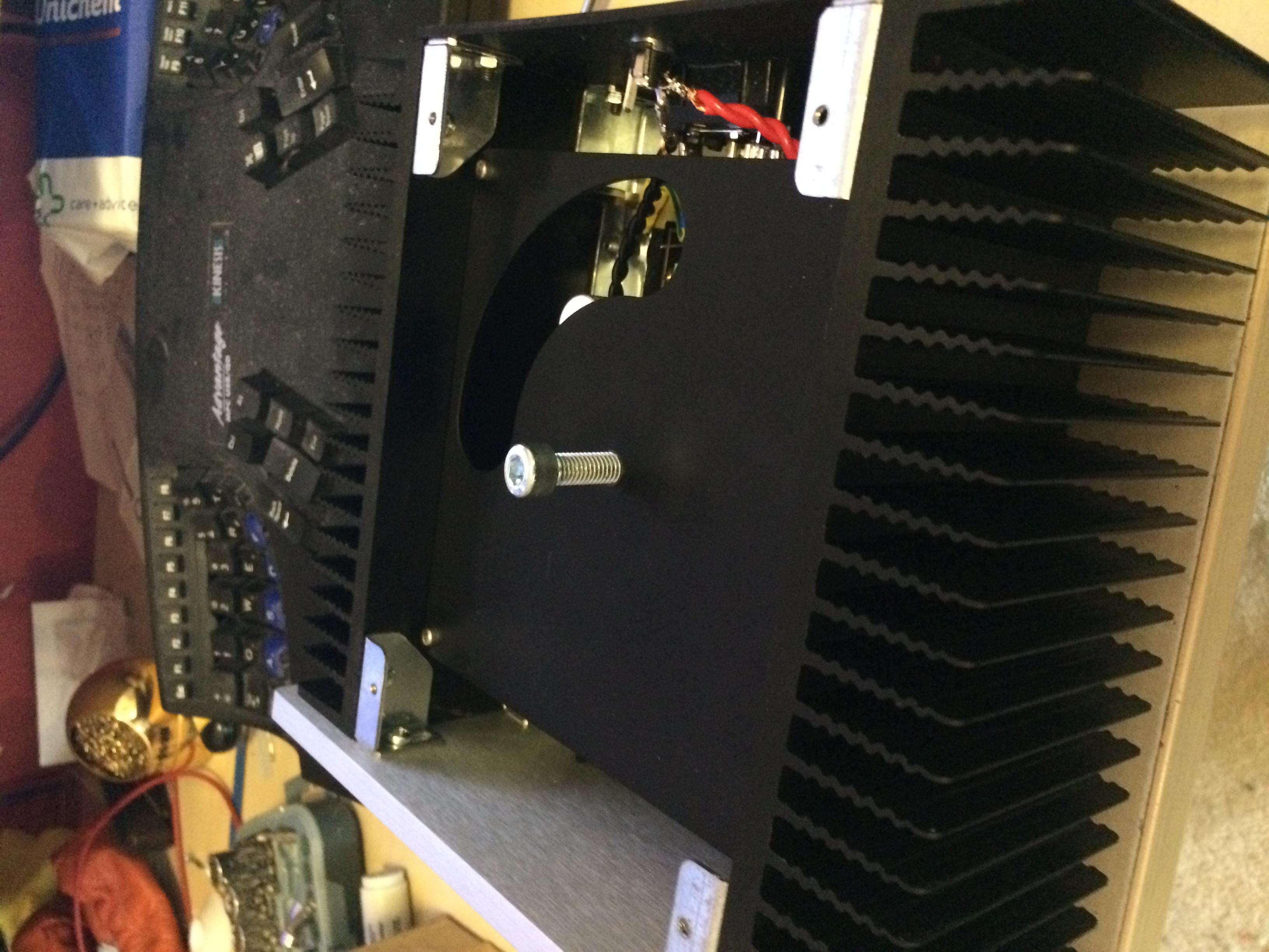

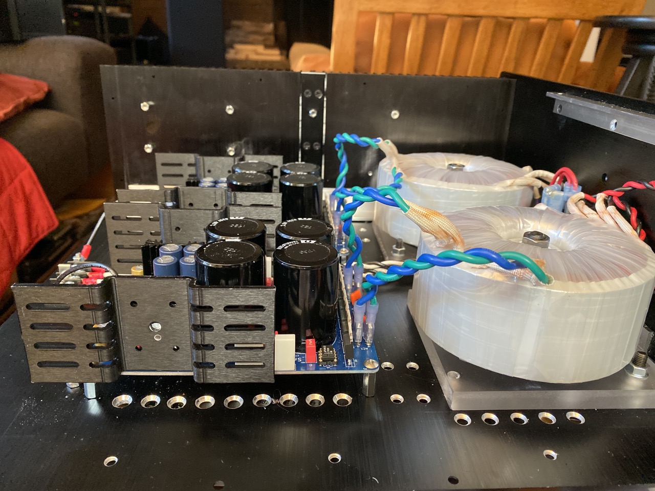

Can you see the plan?
This is coming together now. Horrible wet day outside but I need to go out and get some Ally strip to improve heat sinking from the filter/rectifier board on the base to the sides. Toroids with base plate ordered are the exact same quoted 150mm width as the Mini Dissipante interior space so some minor hole widening of the case brackets may be required once they arrive. Hole cut in the top plate 160mm to give 5mm clearance and ventilation.
Top brackets have been cut short of the top hole but left long enough to suspend the transformer base 20mm below the top leaving 40mm poking through.
I'd have liked to make them handed but I need right angled IEC plugs to get them tucked up tight against the wall. The plugs are handed one direction only so the sockets got placed dead centre.
I plan to run the DC power supply from the DC jack straight down between the AC switch and IEC inlet to keep it very short - or would you make it longer and loop it out and around the AC? I have 10 amp hook up wire for this. I've got yards of adhesive copper strip (bought for wiring EL Wire) I could wrap that around the connector cables and use some shrink tubing would that work as a shield?

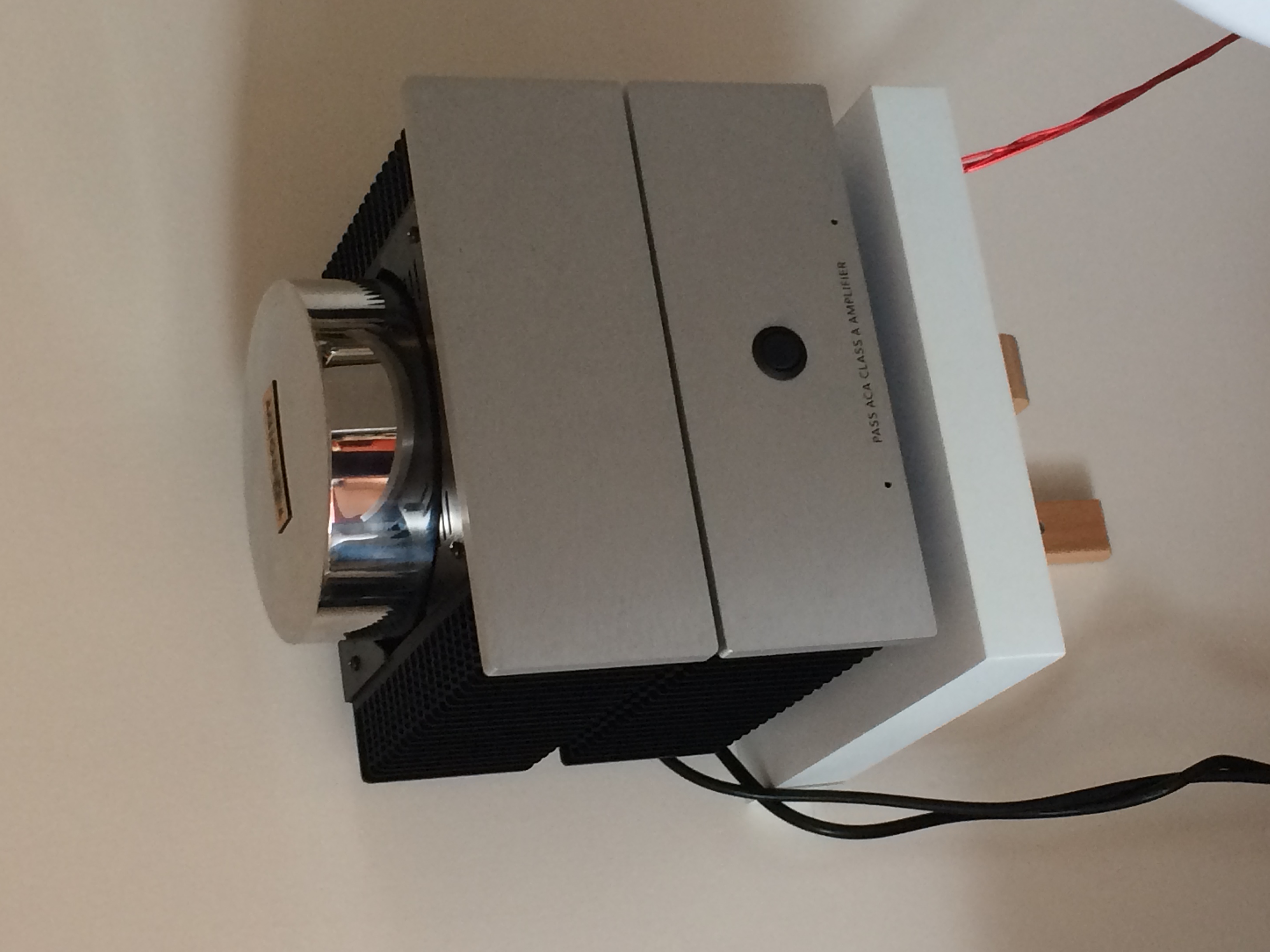

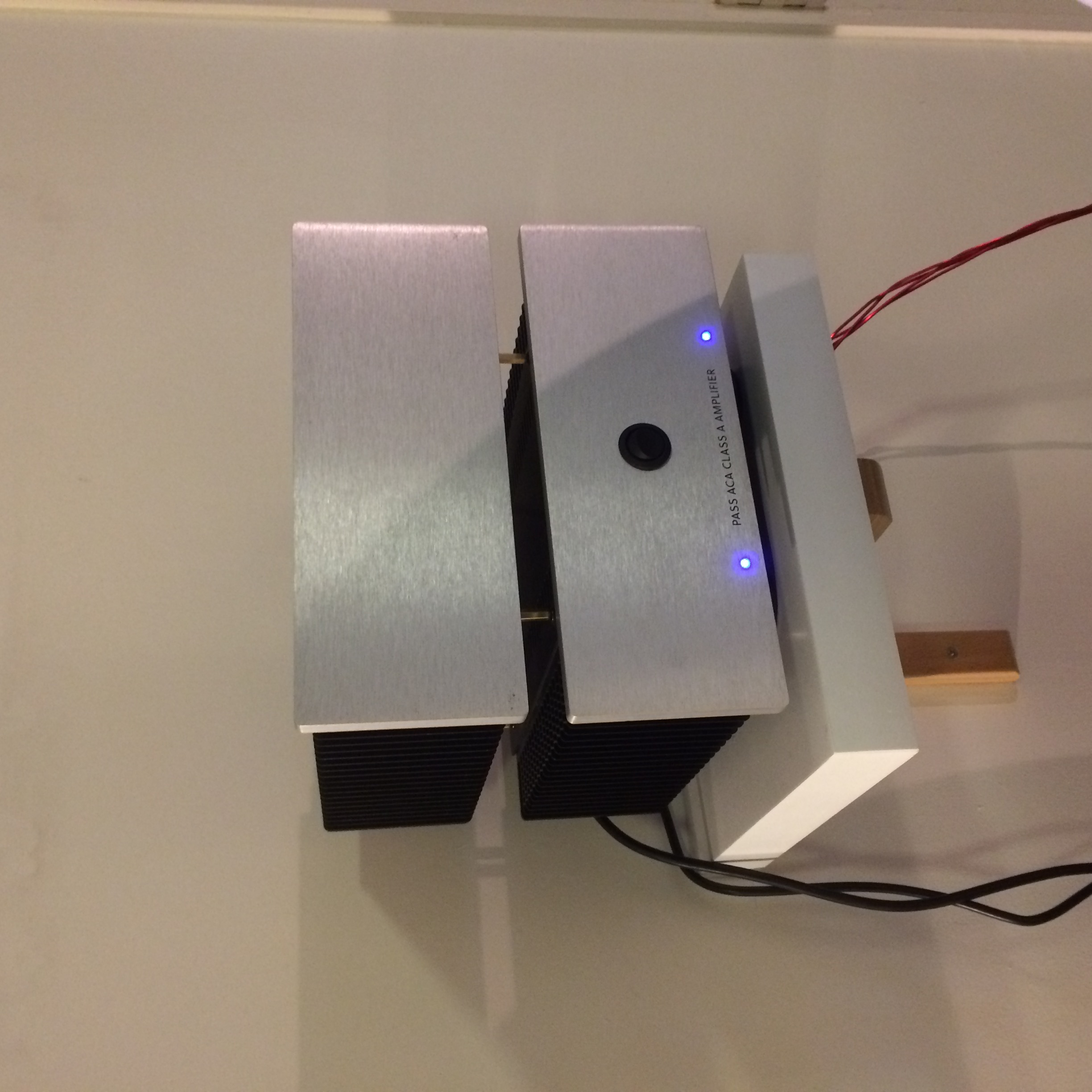

Given how good the ACA sounded as a simple stereo amp, I really wanted to try a pair as bridged mono blocks. Since I had modified the input and feedback resistors, I knew that a different resistor value would be required between channels to make a bridged amp. After some experimentation, I settled on a value of 68.1k from the left (-) output to the right input. My experience plus some other findings on the Pass forums suggest that the standard recommendation of using the same value as the feedback resistor is not the best way to go. For those who wish to bridge the standard configuration amp (v 1.6), I would recommend a value no more than 33k, and preferably 30.1k in order to get more symmetrical response between the two halves of the bridged amp.
As bridged mono, these amps are amazing! As expected, both dynamics and stereo separation improved, but the degree of improvement is both subtle and profound. The enhanced dynamics open a clear window into the details of each recording, without throwing them in your face. The soundstage has improved to the point where, on good recordings, the 3D image is completely separated from the speakers.
Having the pair of bridged ACAmps has induced many extended listening sessions, and revisiting quite a few favorite albums. On many recordings, I'm hearing details that I hadn't heard before, and some of my favorites just beg to be played over and over again. This quality is a testament to the simple and elegant circuit design, which responds well to careful device selection.
Though the improved dynamics have been quite satisfying at my usual listening levels, the medium efficiency of the old Vandersteens still has me running the amps close to flat-out much of the time. To address what I perceived as a slight upper treble harshness, I eventually added a 10 pF Silver Mica cap in parallel with the 90.9k feedback resistor on each board. While the effect of this is subtle, the ease of presentation makes it worthwhile.
That's all I've done for now. While I originally was thinking of building a linear power supply to replace the SMPS bricks, I'm happy enough with the way things are to start working on other projects. Given the revealing nature of the amps, I'm sufficiently motivated to finally build an improved power supply for the NAC 82. I'm hoping that a DIY version of a dual HiCap DR to replace my single Olive series HiCap will be a worthwhile effort.
As for other NP amps, I already have an F4 clone in the works, and am planning an Aleph J, and even an M2X somewhere down the road. Too much fun!

Big ACA Power Supply
Well got one of a pair of power supplies up and running nicely. I thought I might have damaged one of the pair of filter boards a couple of weeks ago whilst working on it late at night - dumb mistake and magic smoke was released as soon as it was hooked up to an amp. Replacement board on the way. Here's the picks of the completed one. Two ACA cases bolted together using 10mm standoffs.
That looks like it is coming along nicely. The end result with the chrome cased transformer is quite stunning.
I am curious about the design of the power supply. Is there some sort of capacitance multiplier following the filter caps and discrete rectifier diodes?
Since i'm still learning i bought off the peg on this occassion:
ULN-PS7 Ultra Low Noise, 6.0A High Current Power Supply for High Quality Audio | eBay
You can buy without the heatsink on the listing.
