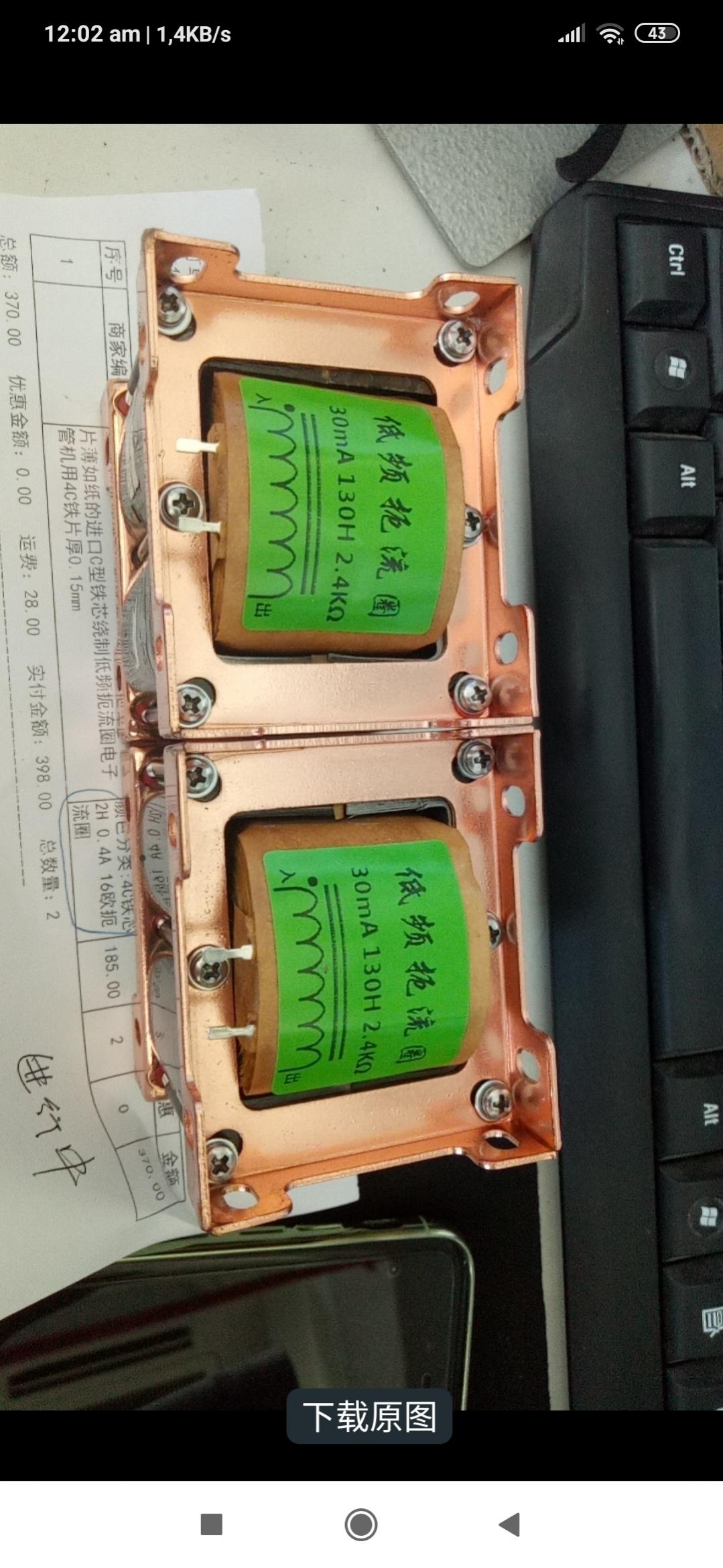

Sorry it was a typo error there, instead 2k49 I should write 2k39, my apologies for that. Lets me insist this set a somewhat damping factor, this value my be optimal for my 8 ohm fullrange only. Pic. below is my 2k4 ohm inductor I got today from manufacturer. I suppose I would place not at PCB board, straigt to the amp. binding posts + and -.After some fine tuning in the power supply (Ubib by Salas), today I took another hearing on R14, as tomorrow I will get quotation for the Anode choke, wanting to be certain, I set a new arrangement, free from variables, I was lucky the magical spot was in the range I expected, the new value 2k49. For my 8 ohm speaker, this is.

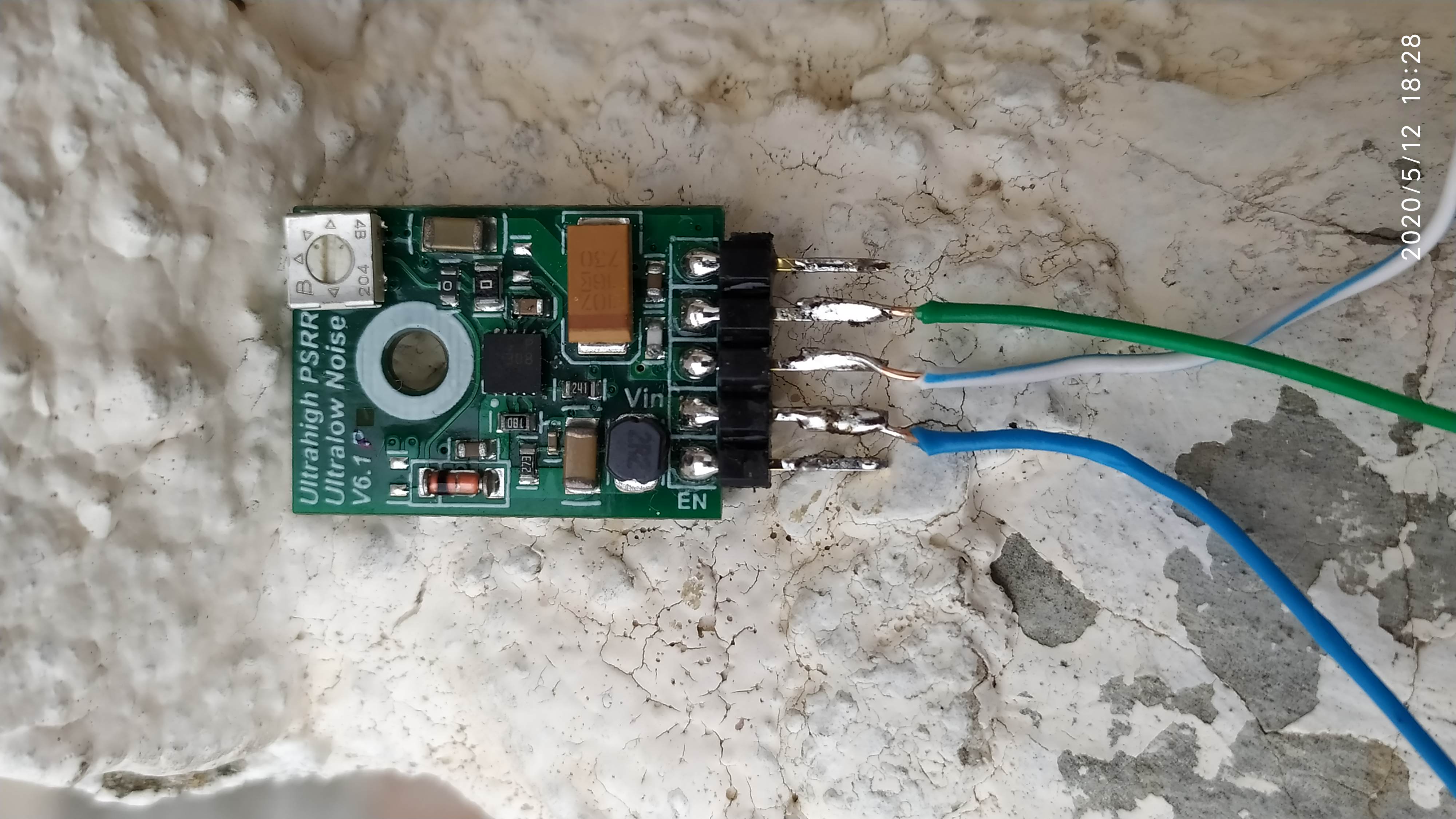

Another premium part I find, a bit tricky not a direct replacement. R16 / 200 ohm and C4/100uF can be substituted for a low noise DC to DC reg. board.
I set troaugh the small trimmer an output 18,7v. to fed the Toshiba 2SK170 transistor.

Which DC-DC are you using?
What voltage is your main PS rail? (29.6V you said?)
This can suit ACA at 23v, as mine. Altrough only rated at 20v, I have not seen any damage. This particular application is no need for heatsink. Ultra low noise 0,8uV.

Same seller has a higher voltage version, that can reach 4-30v. in, and 0,8-24v. out. But at higher noise, 40mV. Still low noise but not the same. Never tried myself. Another caveat, is missing the small potentiometer, just a place for smd solder.

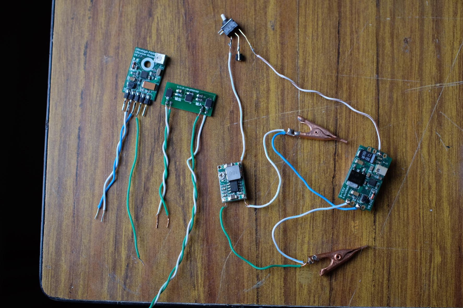

That comment about switching noise led me perform a shootout of different DcDc reg, and lucky Tungstenaudio you do, as a first try after setting arrangement with no variables (same crocs and wiring- please see pic attach) was please to notice the small reg in center of image is much better sounding that one on the right posted favourabily two days ago.
Still remain another one (on the left) for comparison, later I will post results again.
The forth in the pic (center left) is a much simple fixed reg to an output 5v. will be interesting to modify as variable, but not sure it's so small, even wiith magnifing lens, not confident in success.
Well is astounding how easy is listen to sound differences between boards, no question the winner in the chart is that below, I shoot as much close I can. Don't wants further reseach on modification other such an small boards. Hopefully I have a pair, so this goes regulated to 18,7v to rhe ACA amp, powering a true Toshiba 2sk170, not this fakes that Reihard-Germany sell as original (or beware midleman)
