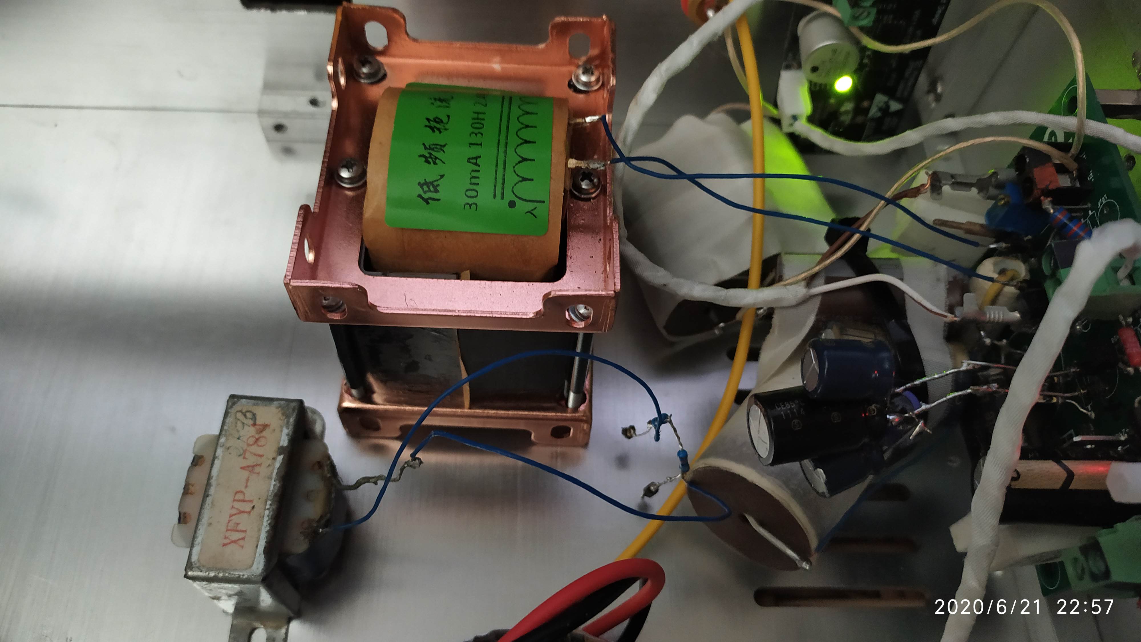

Today I heard for first time my new choke I custom ordered 2k4 copper resistance inductor.
Not being scarce, I asked for best core material, and got 4C amorfe core. See photo atch. below is big one compared to permalloy on the left. And glad I do, since first listen I noticed big difference, for the better of course, then took back and forth several times, to take account why. Less sibilance in vocals and much more dynamic uncongested sound. Using amorfe core is bulky and expensive, but shares how much potential is concealed below the humble 1k R14 resistor.
