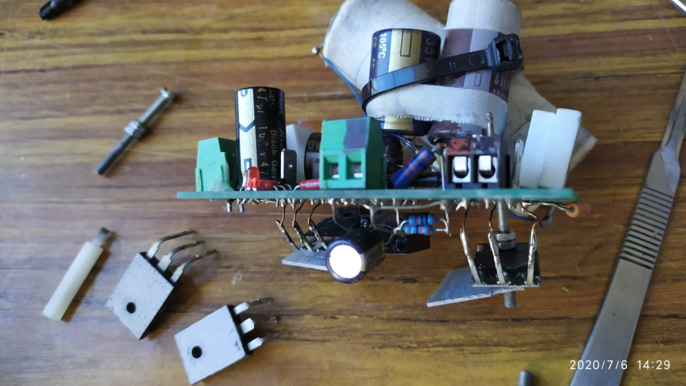

Just wanted to try my remaining Semisouth SJEP120R100 as Q2 in the meantime I assemble the left channel, I am astounded how much is improvement, as a shunt this NOS Jfet also provides much benefit, when music gets louder mantains the same open field projection signature as do in smooth passages. Timbricaly less distortion. Very impressive
still cold, burned in almost one hour. Not having on hand any more powerful mosfet to compare, I have only a chance for tomorrow to try: Fairchild FQH44N10. Will be that compatible for only 23v psupply? Hope no smoke or burn.
Maybe the CREE Wolfspeed C2M0280120D would be nice to try. Some folks have used them in their Pass F2.

Thanks Erik, I will buy C2M0280120D to try as Q2 and then share here.
Thanks Den for confirm, tomorrow I will safety place 44N10 as Q2 to compare against Semisouth. I will left 2 days for settlement.
Is nice to know you have also 44N10 for comparison, please post results anytime you may try, against Mosfet IRPF series.
Den, are you doing? you are dealing like me with same Aca PCB with centered mosfet pins just in middle of the board, also a hole to screw the mosfet?
Today I confirmed IRPF240 as Q2, has a similar degradation as in Q1 (already reported), as a Q2 is unable to manage the bass frequencies, almost muted them, remaining a shade, around midbass, which is unfocused and without detail. Damage is overall, high frequencies have a harsh timbre not pleasant.
Of course this is after hearing 44N10 as Q2. I can't praise high enough that so called 'enhancement mode power mosfet' all I can read in their specifications sheet is right: ''This advanced MOSFET technology has been especially
