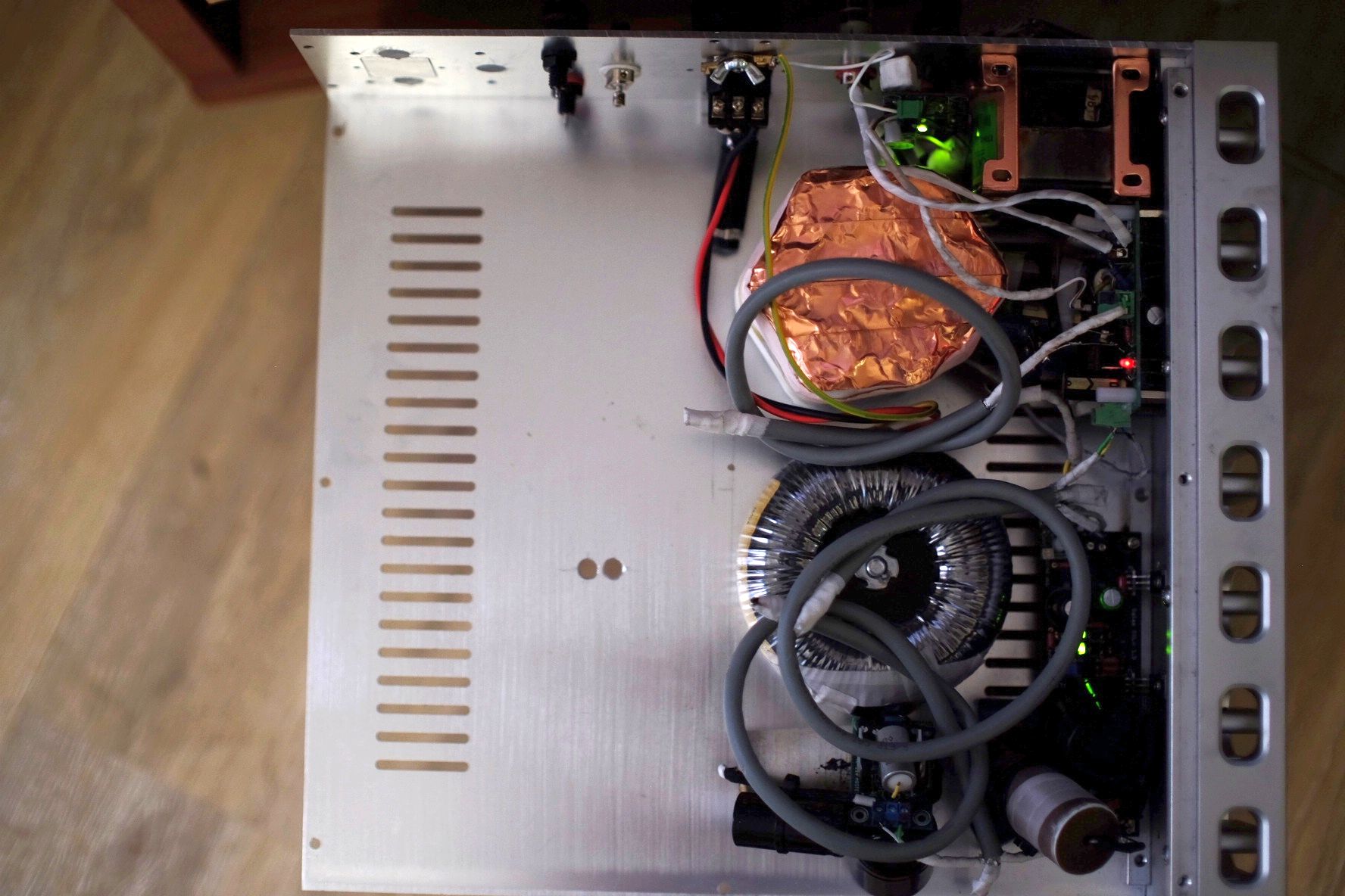

Thought I would share some pics of my ACA 18 "Premium" Parts build. This my first build since I built my Hafler DH-101 more years ago than I care to remember...
Photos from my wondrous little Fujifilm X100F, shot with available light and/or TTL fill. These photos also show the Nichicon Gold Tune cap at C1 and the aluminum organic polymer Nichicon caps at C2 and C4 per Tungsten's recommendations.
Single board close up...still have to get in the 10pF silver mica bypass cap for R12 that James (TungstenAudio) recommends.
Rear of the stuffed boards
Rear panel connector assembly...
More pics to follow as I wire everything up...

So...I've run across a perplexing problem. I'm wiring the rear panel before soldering the various wires to the boards, and....the resistor that goes from the lower right terminal on the switch to an input RCA jack in versions 1.6, Batch 3 as shown here:
However, in the new wiring diagam for version 1.8, the 68.1K resistor that James recommended goes from the lower right terminal on the switch goes to the left channel negative binding post output (see part of wiring schematic for version 1.8 highlighed by red box as shown).
Is this correct?
One of the issues that I have is that the 68.1k Ohm Resistor that James specified...does not reach from the lower right terminal on the switch to the lug on the binding post.
Is this correct or mis-drawn? I'm confused because the resistor connects from the switch to an input in the earlier version, but to an output in version 1.8.
And...the other thing I find confusing is that the rationale for changing this resistor connecting the switch from an input connection to an output connection is not specified, either (at least that I could find).
Any help folks can provide most welcome as I am presently actively wiring up my ACA '18.

Yes.
This first diagram is the Batch 3 version wiring diagram for ACA 16. Note the bridging resistor is connected from the lower right terminal on the switch to the right channel RCA input.
The second diagram is the ACA 18 wiring diagram. Note that the 68.1K Ohm bridging resistor (shown here as the original 39k resistor) is connected from the lower right switch terminal to...the left channel negative binding post (output).

So....what I don't understand is why the bridging resistor that was originally connected from the lower right switch terminal to the input of the R channel RCA in ACA 16 is now connected to the Negative Output of the L channel (speaker binding post) in ACA 18.
And...the specified resistor does not reach from the negative binding post to the lower right switch terminal, either...
Wiring diagram for ACA 16 Batch 3:
Wiring Diagram for ACA 18:
I can see both now.
Ok the only difference is the side of the switch the resistor is on.
When the switch is closed it doesn’t matter what side of the switch the resistor is on they will both be connected in the same way.
When the switch is open, the resistor is not part of the circuit in either case so it’s still good.
I am assuming the switch is a dual pole dual throw switch, with the switch operated vertically as installed on the chassis.

Thanks for your reply, however, my questions have still not been answered.
Okay, then why does the V1.8 wiring diagram showing the bridging resistor going to the lower right terminal of the switch when the resistor is way too short to connect to the lower right terninal, but it may be long enough to connect to the lower left terminal?
However, I am still as confused as before. This is because while the new v1.8 wiring diagram depicts wiring changes, the context and rationale of WHY these changes were made relative to V1.6 is not provided. As a result, being a newb, I do not undertand WHY these wiring changes were made.
Coming back to the two wiring diagrams, the bridging resistor is connected to the lower right terminal of the switch (why it's specifically connected on the right side and not the left side terminal, I don't understand, either.)
In version 1.6, this resistor used to be connected to a source signal input to the R(ed) channel.
Now, in version 1.8, now the bridging resistor is connected to the L(eft) channel OUTPUT at the speaker binding post.
My questions is: WHY?
