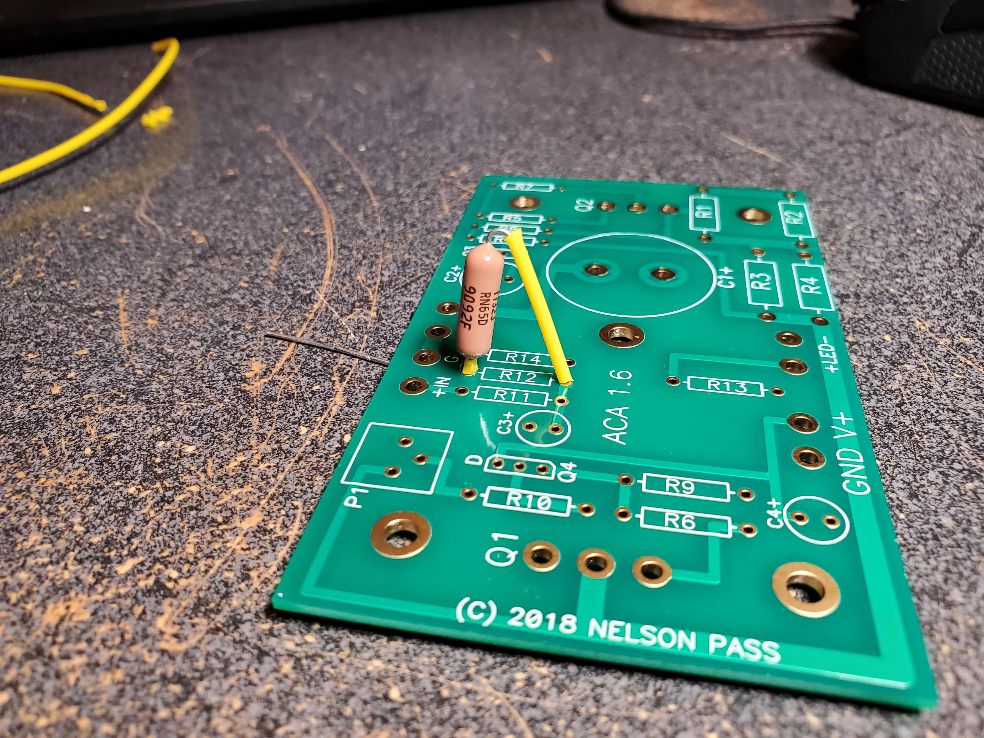

Hi, I finally have all the performance parts for my two Amps. While test fitting I ran into this issue the upgrade for R12 is a Vishay 1/2 watt 90.9k ohms and is a little larger than the pads. I came up with this idea that I have see on older equipment. I figure I will tack on the Mica to the bottom of the board or in between the arch of the Vishay on top. Any thoughts. See Pic.

One problem is that Puma kinda had 2 questions
1. "....Especially as this resistor was originally connected from the switch to a INPUT, and and now it is connected to an OUTPUT."
IMHO this is not a correct analysis, in both 1.6 and 1.8 the resistor is connected between between an output and an input and switched in and out. In the 1.6 we were using just 2 terminals of the switch to connect the resistor into the circuit. The resistor can be on either side of the switch.
The different ways of using the 1.6 as a mono amp required lots of external cable switching.
2. Why can't we hook up the resistor in the 1.8 in either of 2 ways as in the 1.6? Or at least more like the 1.6?
The 1.8 uses 5 terminals of an on-off-on switch to eliminate the need for a lot of the external cables, thus is more complicated. In order to get all the cool hook up options without tons of external cables, the switch has to be used as shown because if it isn't the resistor which is used in the "bridged" function messes up the balanced function as has been mentioned.
Jim was answering question 1 correctly without realizing that the more complicated circuit only works one way as in question 2
Jim 6L6, Pico and I, after tearing our hair as to why, because it is tricky, at least for me, have in the end all explained why the resistor has to be where it is. If you want to have other theories as to how it can be done and still work as it is described on the chassis back panel, this is DIY, you can try them out, but it isn't our job to to evaluate them all. We try to help here in the threads, and maybe there is another way, but what is in the official wiring diagram is the official way that we know works.

Thank you, Variac, for this detailed explanation AND your "very clever" explanation a few posts back explaining why the wiring for V1.8 must be the way it is for all the possible operational configurations (stereo, parallel mono and bridged mono) to work correctly. Your "very clever" explanation was (finally) the explanation that allowed me to figure out and most importantly, understand why the wiring for V1.8 must be made the way it is shown in the diagram.
I'm sorry for all the "confusion" created by my question(s). I really appreciate everyone being so patient with me and helping out by providing all the explanations. Per my original comment 1 you've referenced above: "....Especially as this resistor was originally connected from the switch to a INPUT, and and now it is connected to an OUTPUT.", yes, this is part of the source of the "confusion" about my question but keep in mind....I didn't understand what I was supposed to be doing with respect to WHY the connections are what they are. I was only following the instructions on the wiring diagram, and when looking at the diagram, it appeared to me I was connecting the output one of channel to the input of another, and that was a concern for me. I didn't understand (again, because I have viritually no domain expertise in electronics engineering) that this how the two channels are, in fact, "bridged" together.
This is why I made the comments a few posts back that when changes are made to the circuit topologies as the design evolves over time, it is really helpful to provide an explanation of WHY the changes are made as well as WHAT the changes are.
But I get it now.
Many thanks to Jim, Tungsten, Variac, and Pico for being so patient and helpful. You guys are great.
