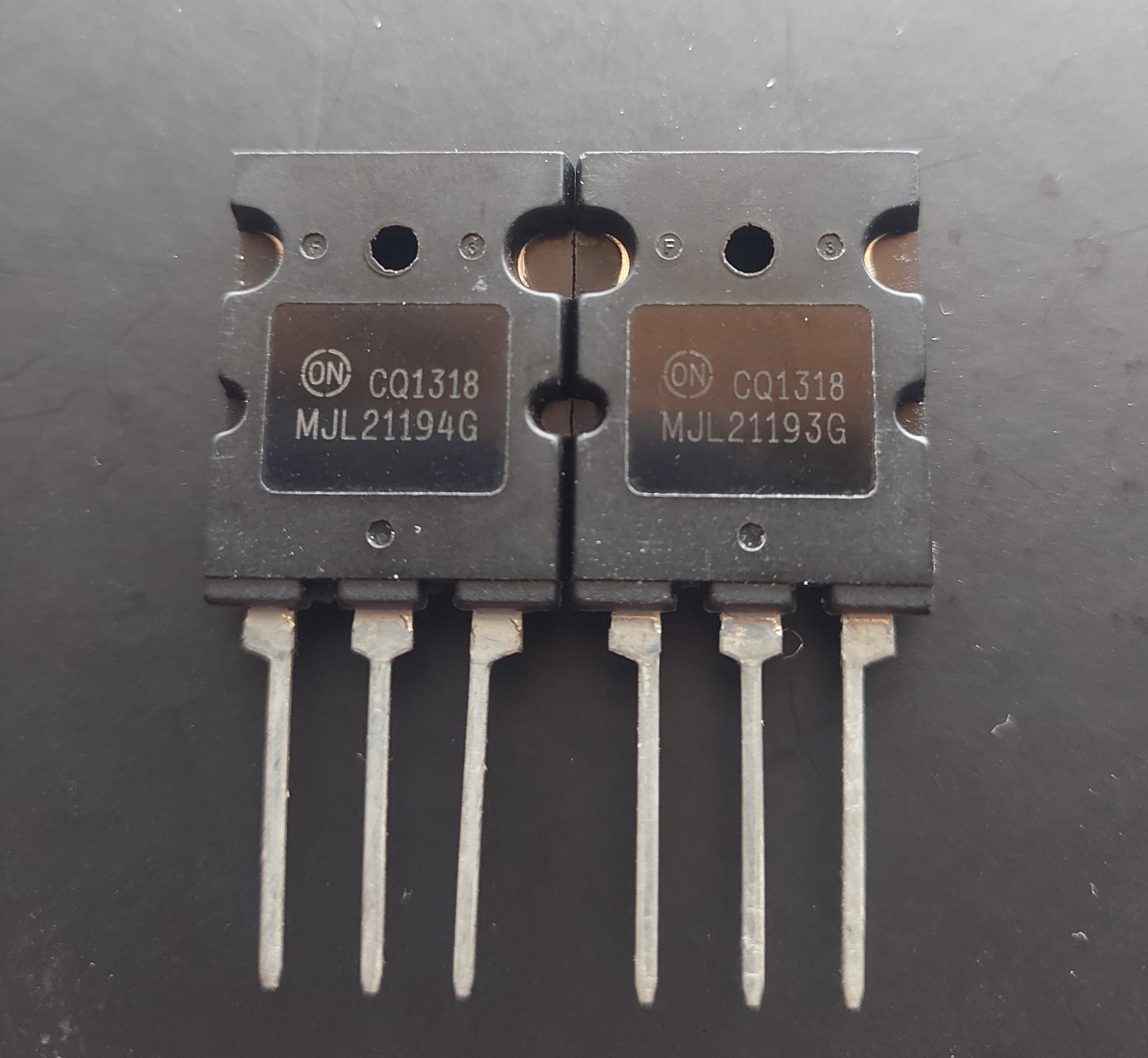

I have MJL 21193G / MJL21194G 10 pair in stock can I use this amp A60 +
Any sound sonic difference.

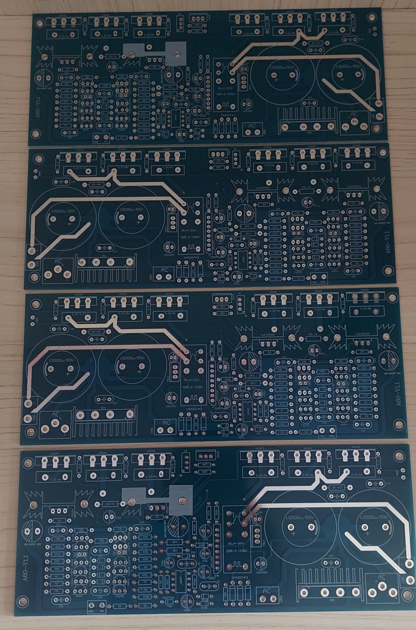

I have built both Dartzeel and A60, several pairs. A60 is incomparably better by both sound quality and measurements. It has great frequency response and almost ideal square wave response over the entire audible region.
If I may suggest you, do as follows:
1. Purchase a smaller A60 without the output transistors and electrolyte capacitors. In China this stuff is 100% fake. I have used Vishays with diameter 30mm. I also used different original output transistors, both On Semi and Toshibas.
A pair of A60 boars without transistors and capacitors cost less than 50 Euro, so there is nothing to regret. You still can de-solder valuable components. (WEILIANG AUDIO A60 power amplifier board price of one pair cost €46.76)
2. Now use two power transformers and two small separate 12V transformers (or one with tw0 12V coils) and that's all.
Somewhere back in the thread I have shown how to connect amplifier without ground loops.
For initial tests you may use smaller heat sink at low bias and if you like the amplifier, buy large heat sinks. If you need more power you still can purchase larger A60+ and re-use valuable capacitors and transistors.
You will end-up with a great amplifier.

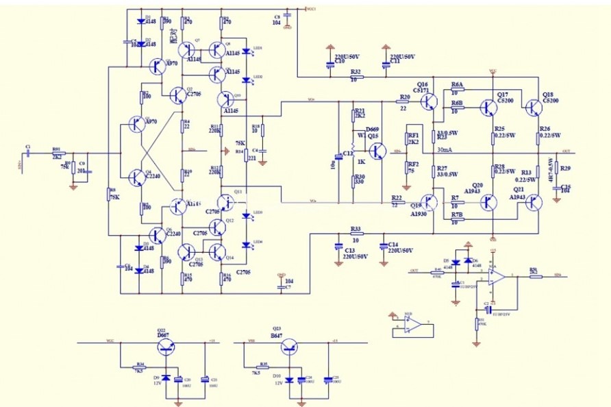

I discover this thread a little late. I bought this amp to test it because it has a current feedback, DC coupling.
2SC5200 / 2SA1943 Module Amplificateur Mono Class AB 250W 4 Ohm

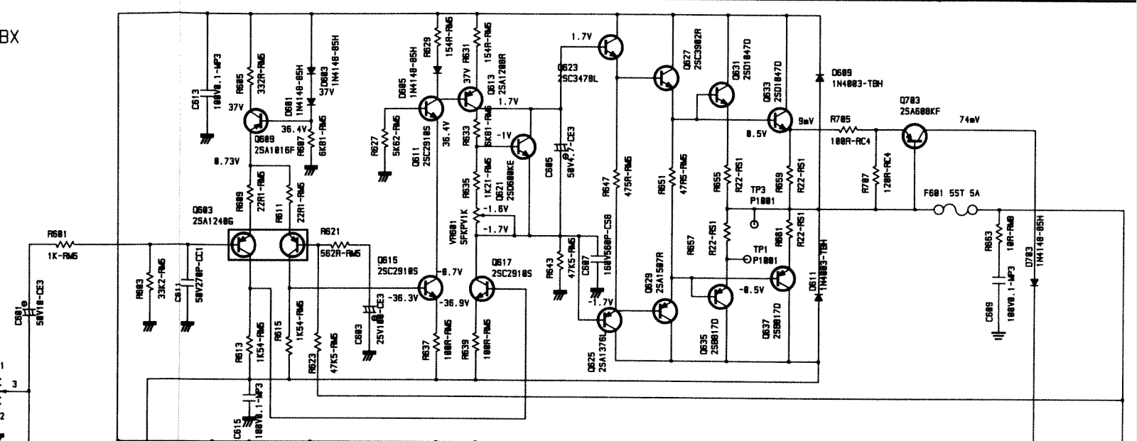

The schematic of the amplifier, miss some functions:
Different to A60 but look to be a clone ?
The problem with the sound, something subjectively wrong with the treble, no clear treble, very curious for this schematic with current feedback and dc coupling.
The transistors in my module are the 2SC945/SA933 2SB646/2SD667, very different from the schematic, not 2SA970/2SC2240... Only the Toshiba C5200/A1943 was keep. I remembered the 2SC945 doesn't sound good in HIFI.
I rebuild the amp with a schematic a little different of my composition and with 2SA921/ SC1880 2SA949/2SC2229 and all are OK now.
It sounds good to my ears now, continue to listen 😉
