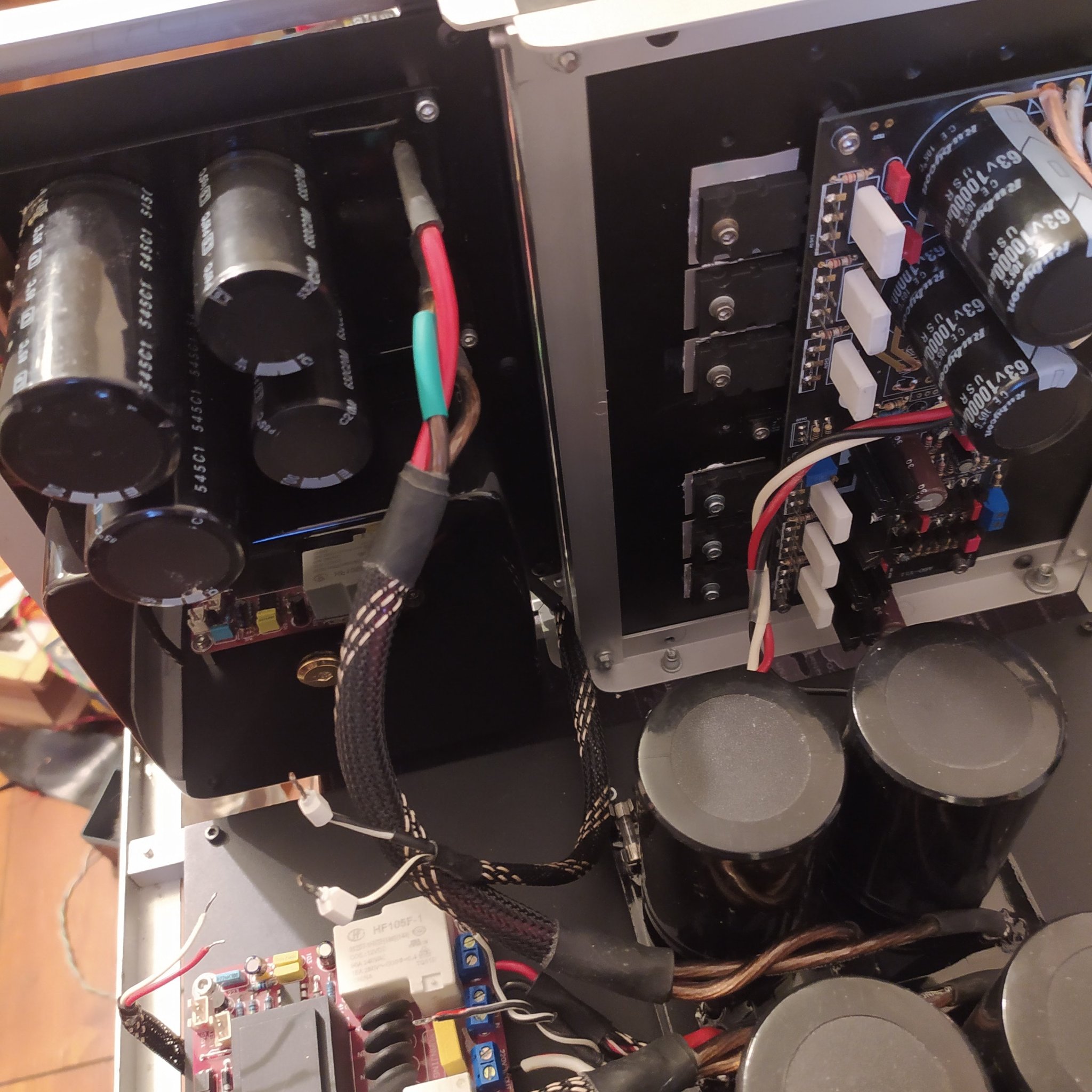

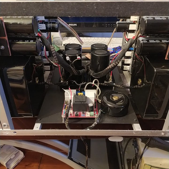

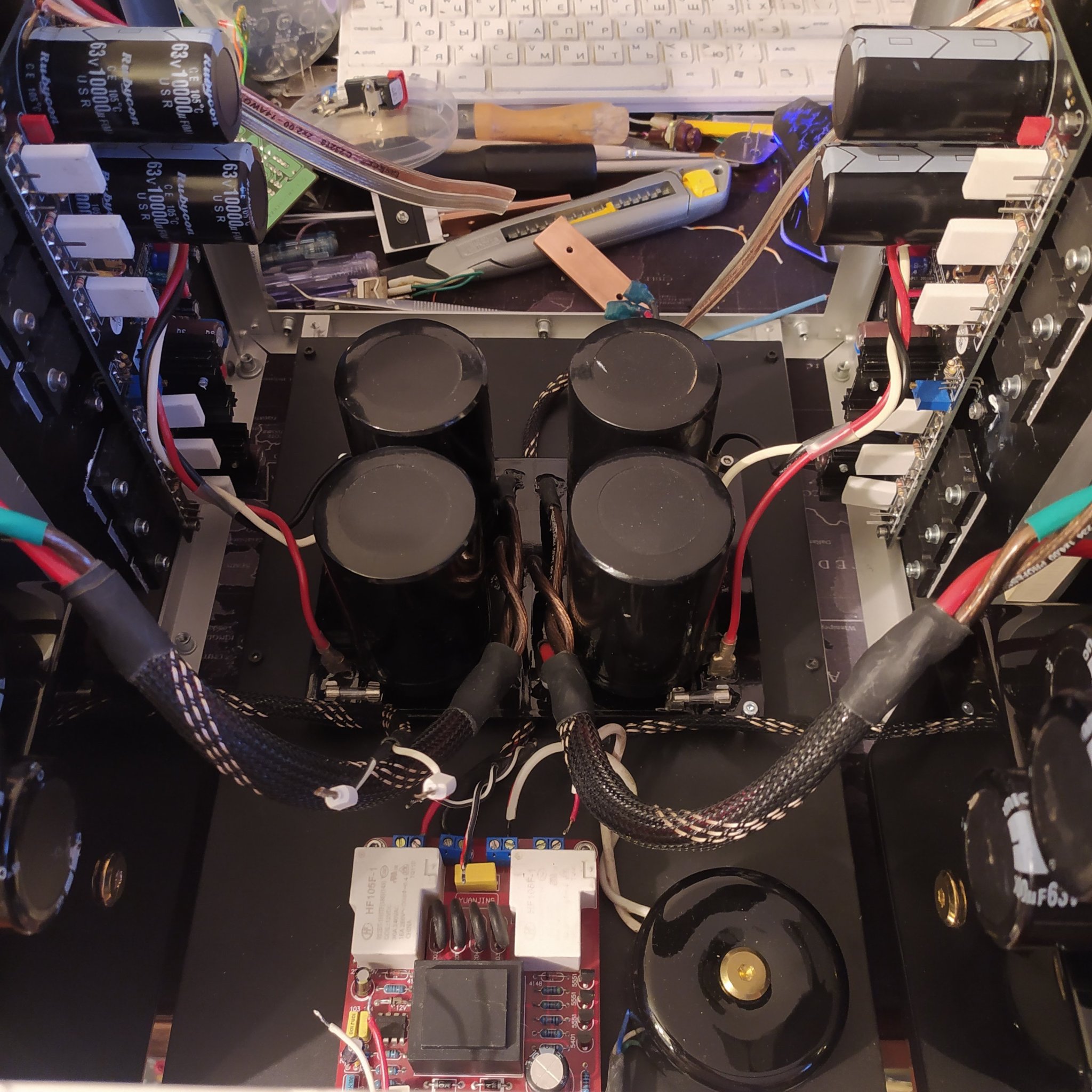

I launched it into the system! I warm up, monitor the currents and heating. The indicators are preconfigured.

The problem with the low-frequency rumble did not bypass me either. 🙁If nothing is connected to the inputs or the inputs are shorted, then there is complete silence in the speakers, but if you connect something or connect two inputs with a RCA cable, then a low-frequency hum immediately appears. Until I figured out what to do about it.😡 Dartzill was silent in this regard. I removed the Dartzilla boards and installed the A60. All connections are exactly the same.
I read the documents from Hifisonix, but I didn’t understand where exactly to put the HBR resistor in the A60😒
I added additional capacitors to the amplifier's power supply to reduce noise. But it turned out that the place where the conductors from these capacitors are connected to the amplifier board is very important. First I connected them in the middle of the board to the +/- 50V tracks and in the ground also in the middle of the board (I have the 16 transistor version). And I also had noise. What was my surprise when I connected the capacitors as close as possible to the power connectors of the board and to the connector for acoustics (ground). Now there is a slight rustle in the high-frequency speaker, if the ear is kept at a distance of 1-5 cm from it. And it seems to me that when I left 8 transistors per channel and replaced the Toshiba 5200/1943 ON MJL 4302/4281, the sound became more bassy, which is important with my heavy Kevlar suspensions. You can also reduce the gain of the amplifier a little by slightly increasing the value of one of the resistors. I reduced it from 30 to 20. And now the volume control on the preamp has become more like the truth (it was excessively loud at the very beginning of the range before). If interested, I'll tell you which resistor.
I have the same boards and I didn’t do anything extra with them. Everything was done with high quality and no extraneous noise. I added capacitors of 24000 per channel, more in the old case. When I built in the new one, I removed them, it makes no difference what is in the bass (30 cm speaker) or in a different range. The board with 3 pairs is wired correctly for power, look for the right place to connect the ground from the external power supply. There is a 47k resistor at the input, no need to change it. The sensitivity of the amplifier corresponds. I serve even from a dac (2v), even from a CD player, the return is the same. I think you need to look in the power supply.:wave2:
Reactions: Berlusconi
Connect the ground inputs of each channel through 10 ohm resistors per chassis. Don't go anywhere else. The earth from the feeder goes to the board in its place. The board is wired correctly. Since there are remote power boards, a loop can form when the cable is connected.🤔
