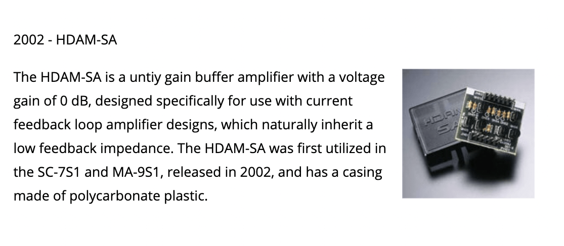

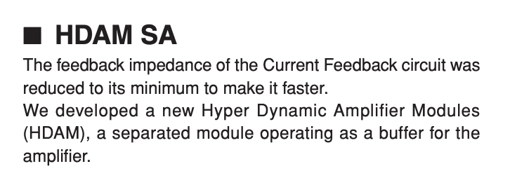

Interesting, so Marantz MA-9S2 is current feedback design.
This actually makes me more interested in hearing A60, since it also has CF.
I wonder do they share similar topology, as a beginner amplifierbuilder i cannot verify is this true or not but it is interesting.

I put information about MA9-S2 because i wanted to see if there would be link between A60 and MA9, shared schematic and other parts (someone with more knowledge would verify is there connection) basically outsourcing knowledge..

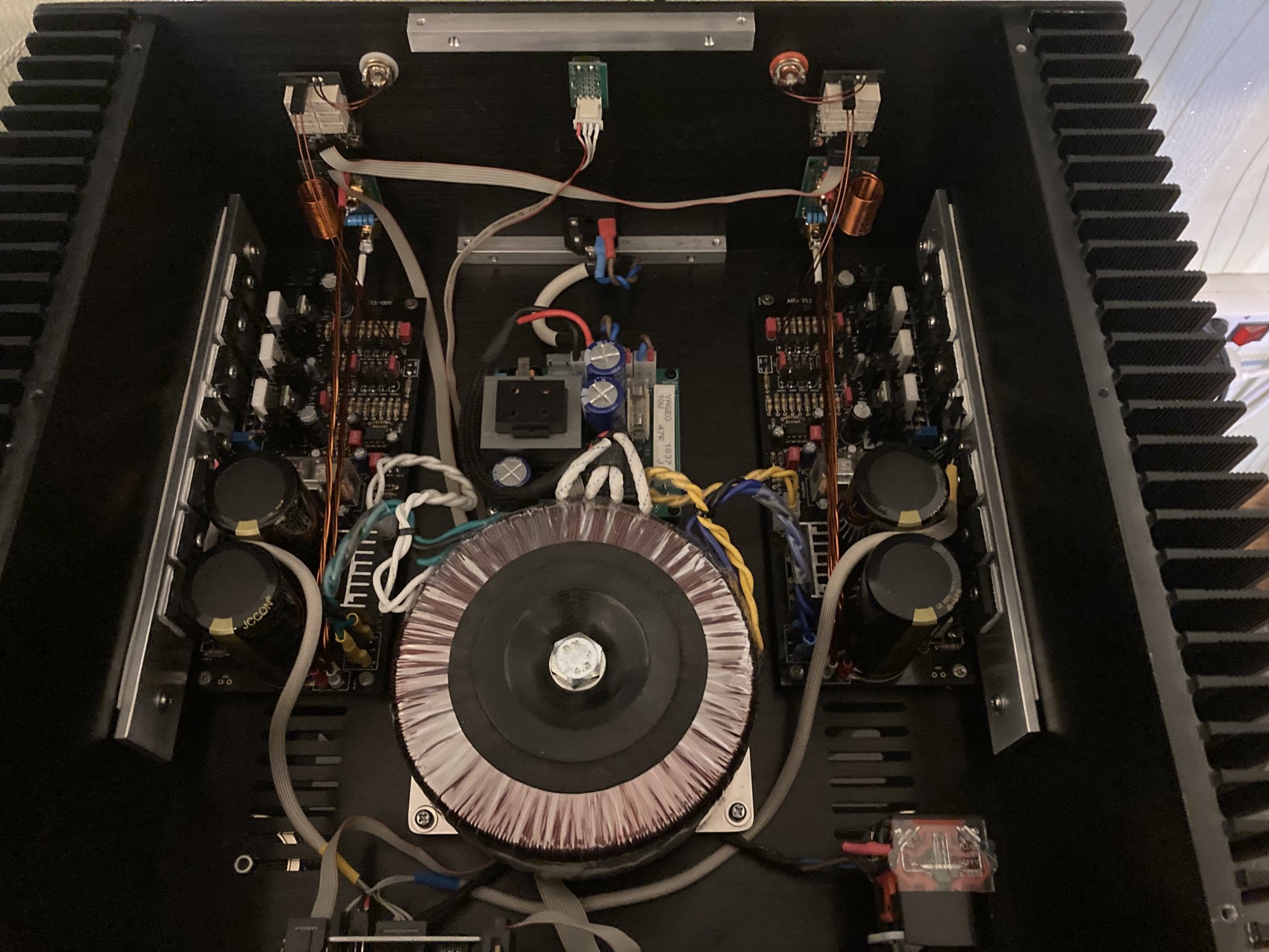

Hello everyone. I want to remove the relay volume control and other gadgets on the A60, there is a preliminary one with the same control and two outputs for 2 amplifiers, the same for Dartzil. I want to leave it only as a power amplifier. But along with it, the temperature protection is also removed. Please advise a simple protection circuit for exceeding the temperature of the outputs, preferably on KSD-0.1 H thermostats (I have them). Maybe like turning on a relay and turning off the power?🙄
Do you have a regulator from Antecom? Is the power supply also from this? So maybe you can leave it in place and buy another one if necessary?
Yes, from him, the whole set. I want to completely remove it, but to make a separate protection for the temperature in it, I need a simple circuit on the thermostat. The A60 will work with a preamplifier, which also includes a kit from Atencom with a display.

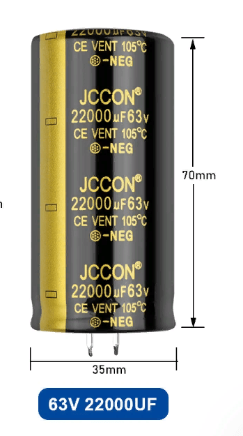

The description for the A60 says up to 2x42V AC. Provide it with good large radiators. If you don’t need more power, buy a 2x33V transformer.
Thanks @Topa41 for this useful link. Also it will be virtually impossible to find an adequate electrolytic capacitor with just 25mm diameter.
@pistollero : Carefully gringo with high voltages, otherwise there will be: Bang! Bang!
https://aliexpress.ru/item/10050020...l.0.0.267a4aa6Djm4oJ&sku_id=12000018558174274 These 22000uFX63v will fit. Size 35x70.
Thanks,https://aliexpress.ru/item/10050020...l.0.0.267a4aa6Djm4oJ&sku_id=12000018558174274 These 22000uFX63v will fit. Size 35x70.
That was my unreliable memory: I was sure that capacitors were just 25 mm. I have measured them right now, in my workshop: 35mm is correct and there must be enough available high voltage alternatives.
