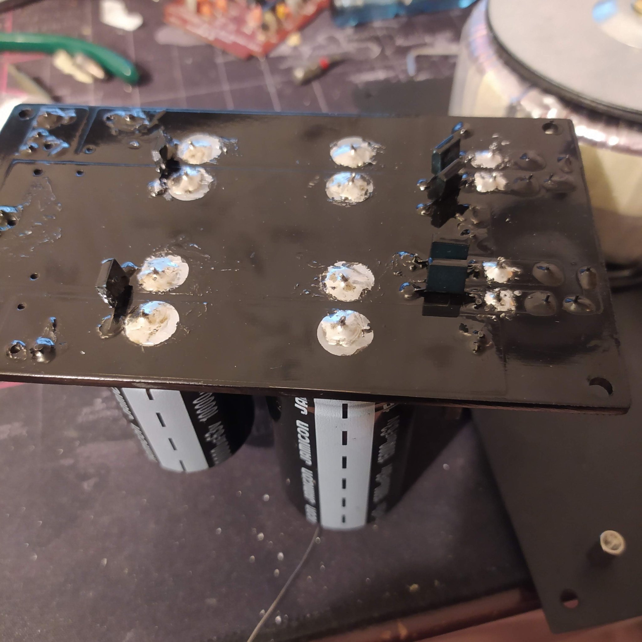

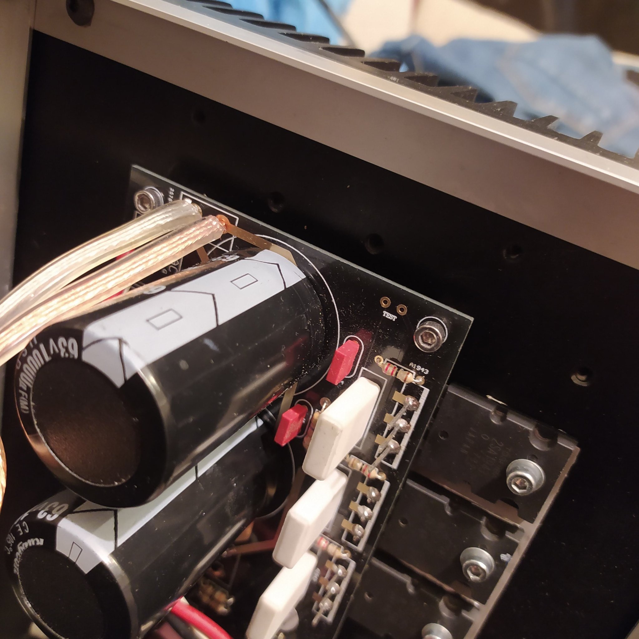

Be careful with that 669 transistor which is soldered upwards. If you plan to install the power transistors below the board, as usual, then you have to re-solder it below, so it will be on the heat sink with the output transistors. That is very important. Based on how the leads of power transistors are bent, I assume you will mount them below the board.
You are bypassing both the on-board power supply and also speaker protection. Is that just temporarry or permanent decision? It would be reasonable to use the speaker protection.

All this is there, but external. I remember about the transistor, thanks.

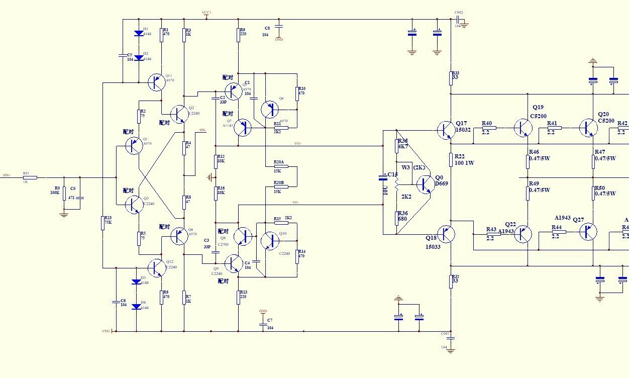

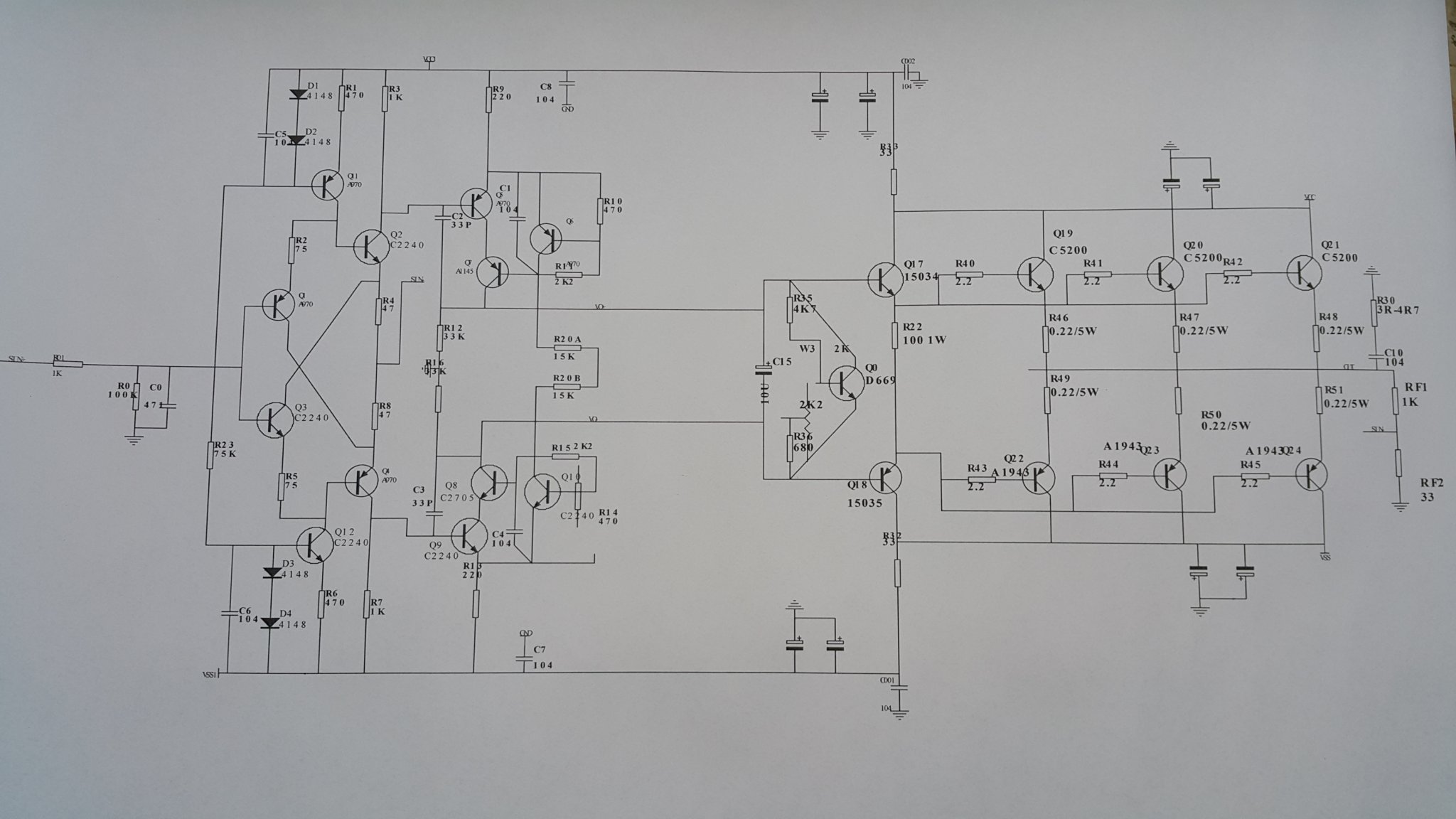

Hello Berlusconi. You mentioned CDIL transistors. Tell me which ones? I have now assembled 2 new boards, in which I myself carefully selected transistors from a large number of them. But there is no time to place them in the case yet. So I haven't listened to both channels on 4281/4302 at the same time yet. As I understand it, these transistors heat the radiator more. I hope it reflects in the sound 🙂
The question of such a plan. Why do some A60 and A60+ circuits have emitter resistors of 0.47 ohm and others of 0.22 ohm? On my 0.22 ohm. Is it reflected in the sound?

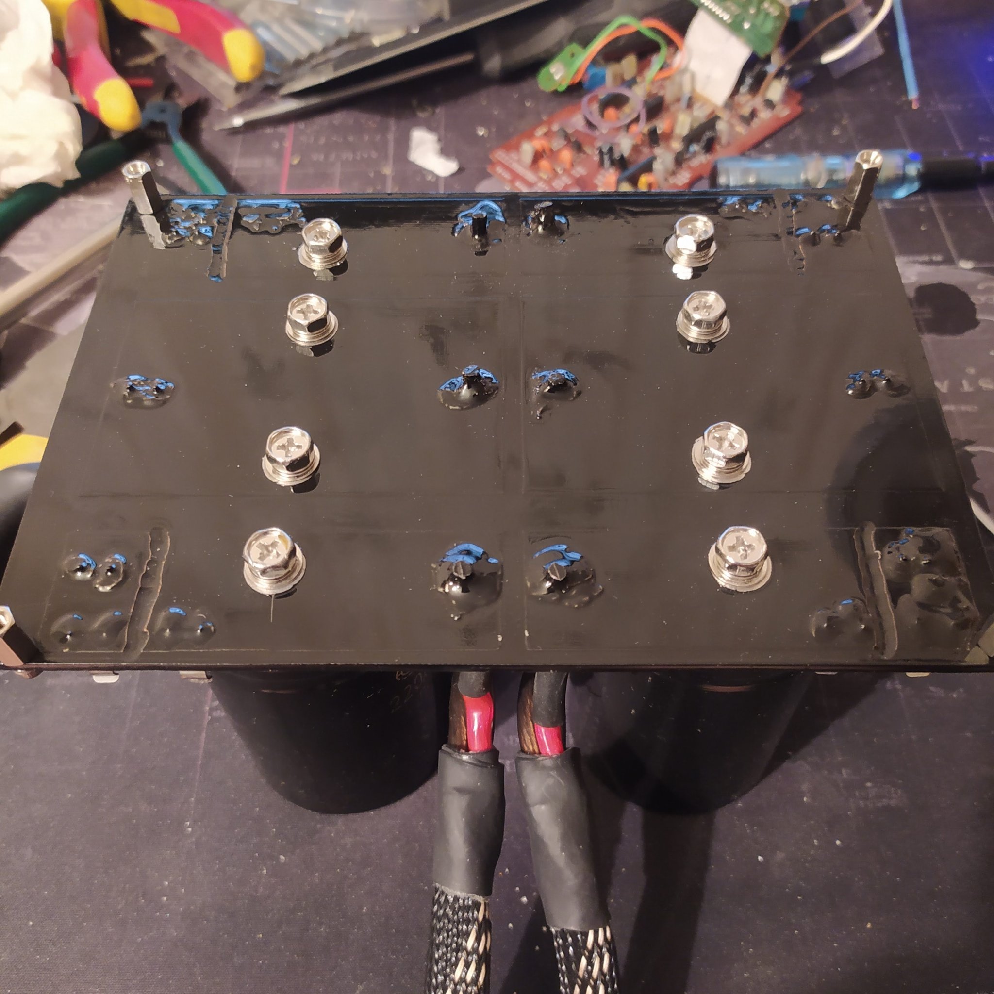

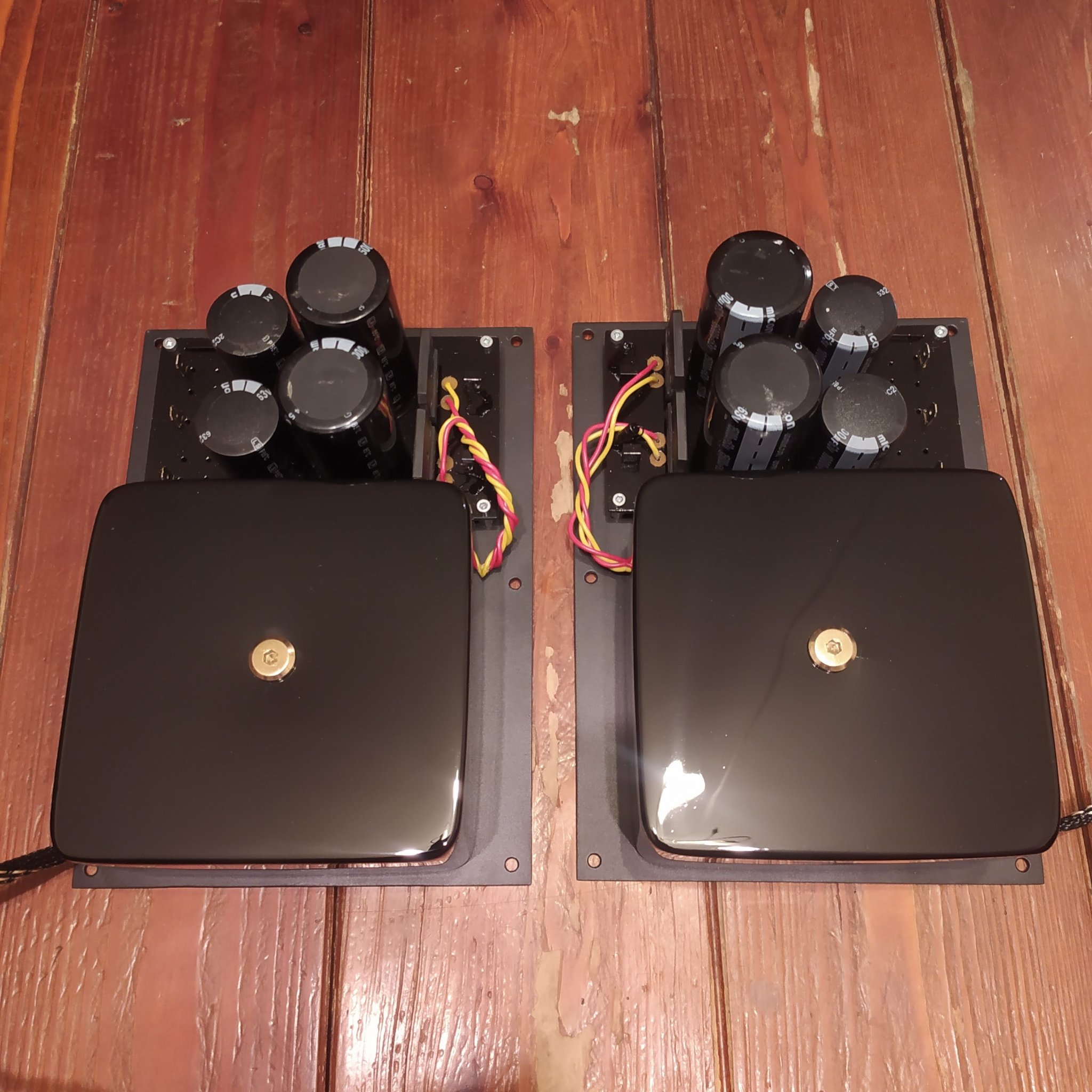

While the issue of anodizing radiators is being resolved, I decided to put in order and bring beauty to what had been in bare metal for many years.
Hi vmk2002!
Sorry for the delayed response.
Here are my substitutes:
2SA970 -- CDIL 2SA970
2SC2240 -- CDIL 2SC2240
2SC2705 -- ISC 2SC3423
2SA1145 -- ISC 22SA1360
MJE15034 – ONS MJE15034
MJE15035 – ONS MJE15035
Output: 2sc/2sa, MJL, NJW
Please note that both CDIL and ISC (Inchange) produce quality replacements
At these terminals you can measure quiescent current with multimeter.
1. Make sure you have no signal at the input.
2. Read the potential across these two points (in mV range)
3. Divide the reading by the value of the emitter resistors (usually 0.25 ohm)
The result is quiescent current in mA.
The reading should be in the range of 20 to 60 mV (! millivolts)
This value is adjusted with the multiturn resistor. Counter-clock direction increases the quiescent current. Adjust carefully with current limiter using incandescent light bulb.
Carefully, otherwise you may blow your amplifier board.
