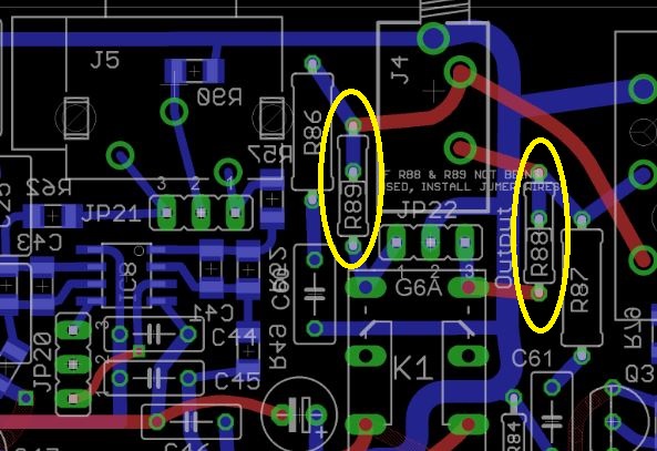

fmcclell - I'm sorry about the delayed reply!
I just realized there is a much easier way to do what you are shooting for. Since you want your pre-amp output to simply be the output of the pot (after the coupling capacitor), you can just connect the pre-amp RCA jacks (via the JP21 connector with R62 and R57 removed) directly to the output of the amp itself. That works because the output stage of the amp is just a 1x current buffer - the output voltage of the entire amp is the same as what is after the pot. Plus it has that DC offset null circuit so you will get the low DC offset, and since it is the output of the amp no problem driving capacitive loads.
But here is the really slick part. You can do what you want to do with just one panel-mounted DPDT switch at this point (or just use two of the 3 poles in that 3PDT you've already ordered). 🙂 The trick is those two jumpers in the "R88" and "R89" positions on either side of the 3.5mm output jack, layout picture below. Those resistor positions are for an optional damping factor resistor on each channel, which is just a resistor in series from the output of the headphone relay to the two output jacks. If not using a damping factor resistor those two are just jumpered across.
So what you can do is first remove those two jumpers. Then run wires from the bottom end of those "R88" and "R89" positions (the end toward the relay) to the center terminals of your DPDT switch. Those lines are the output of the headphone relay, which is the output of the amplifier. Then on one side of the DPDT wire that to the outer two holes of JP21. Remove the R62 and R57 SMD resistors under the board to break the connection to the output of the pre-amp chip, since it won't be used here at all. Those two resistors are used for what we were going to do, add series resistance to the output of the pre-amp chip to isolate output capacitance. But here they work just fine to break the connection between the pre-amp chip and J21 entirely. So when the DPDT is flipped to that side the output of the ODA goes to your pre-amp outs and on to the speakers.
You will also need to add a jumper across the "R90" position on the bottom of the board, if it doesn't already have a zero-ohm resistor in it. That just grounds the ground side of the pre-amp jack. I can't remember if I put a zero ohm resistor there or not on your board, but an easy way to to it is just put solder on both pads and solder the end of a small gauge wire right across them.
Then on the other side of the DPDT switch wire that back to the other two holes in the "R88" and "R89" positions to feed the ODA output back on its way to the headphone output jacks. With the DPDT in that position it is just like having the jumpers in for R88 and R89 again.
You probably won't get any thumps when you toggle the new DPDT switch for speakers/headphone since the DC output on the amp is pretty much nulled out and the circuitry is already thermally stabilized from being on. If you do get a thump for any reason a way around that is turn the ODA off before switching the new DPDT. That will give you the 3 second turn-on delay and accelerated turn-of for either speakers or headphones.
Another reason you probably won't get thumps is R84 and R85, the minimum load resistors I've included in the amp circuit. Those are 2.49K loads on the amp outputs at all times, even when the relay is switched off. That helps prevent DC offset wander during output switching.
Please let me know if this sounds like it will achieve what you are after! It turns out that taking the signal off right after the capacitor would be a bit of work since all the traces are under the PC board. A small wire could be soldered to one leg of the coupling capacitor on each channel, but again since the output stage is a 1x current buffer the output of the amp is the same signal as what is out of the coupling caps.
You won't need the pre-amp chip at all with this method. No SMD chip to change! 🙂 In general though your method for removing those (cut each lead then desolder the lead remnants) works great. I've done that several times over the years. Chip Quick also does a good job.

agdr, Thanks, good to hear from you again -- we were starting to worry 🙂 No worries though, I understand about being busy. Sounds like what you are suggesting should work fine -- I'll have to sketch it up, but should be an easy way to wire in the circuit. I think I had looked at wiring it similar to what you suggested at first, but then started thinking about it and wound up with the other approach. But your suggestion looks like it will be easier to implement and should do everything that I need.
I just got some time tonight and am starting to solder the board. Just came back to the computer to look up where one of the parts goes (R70) as it was not obvious to me from the silkscreen. I remember seeing that you have posted some excellent pics of the assembly that I was going to try to find. That is when I saw your post here. Thanks again. I'll let you know if I have any other problems.
fmcclell - those build photos are in posts #278 - 290, #301, #302, and #368. I have the first part of the #1 post in this thread updated with a bunch of current info like that, if anyone is looking for the links to the Google Drive files and other stuff. 🙂 Keep that "part ID diagram" in mind too out on the Google Drive link. I have a yellow circle around each part and its part number to make it clearer which number goes with what part. The build instructions also call out each part individually.
In case you are still looking for that R70 it mounts on end and is between the relay and the IC11 regulator, right next to that reg chip.
Please do post or PM if any build questions come up!
