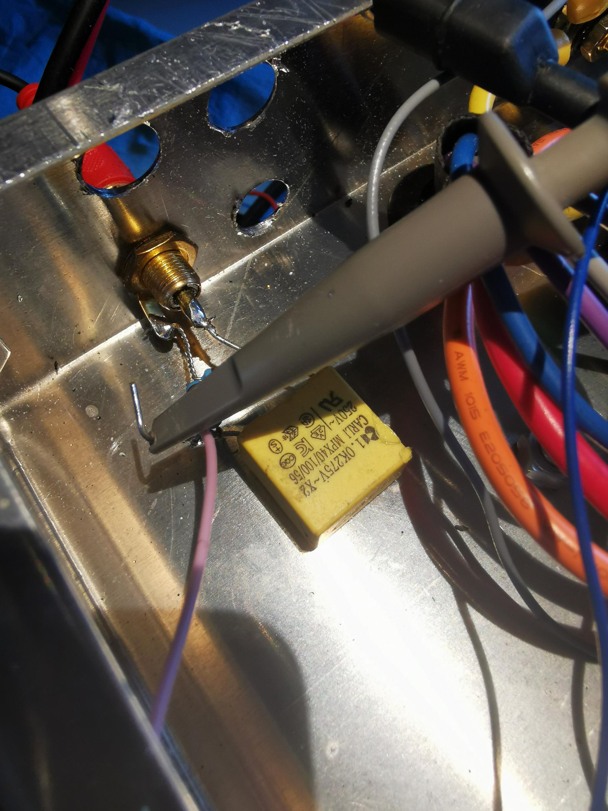

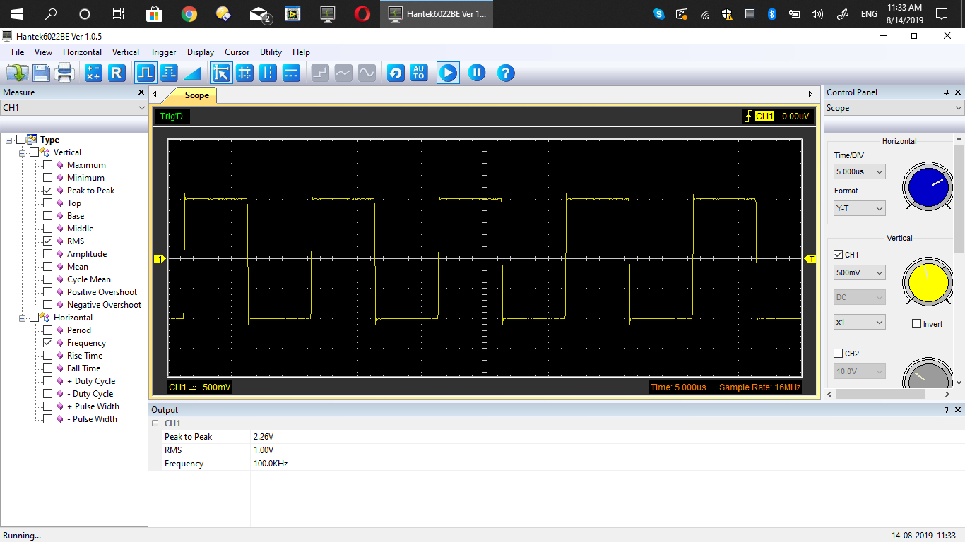

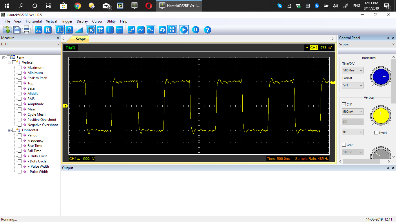

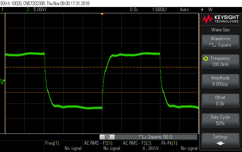

Interesting scope trace for 100kHz through an IT.
Here's my scope trace of 100kHz through a Carli 1uF X2 MKP safety capacitor which I use for coupling.
Also included is a trace at 1MHz.
Not bad for a 50 cent capacitor...

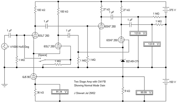

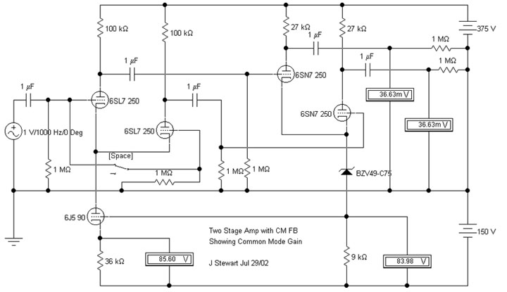

Active CM NFB
Here is a 2-stage diff amp with that cct I referenced. It is NOT DC coupled, but can easily be done. While doing the search I found e few example of DC coupling but not with the active CM NFB.
Stuffing the numbers into the HP67 & turning the crank I see a little better than 70 db CMR. In a practical cct would not be as good, real toobs, resisters & so on are never perfect.
