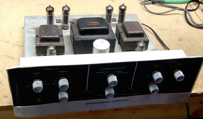

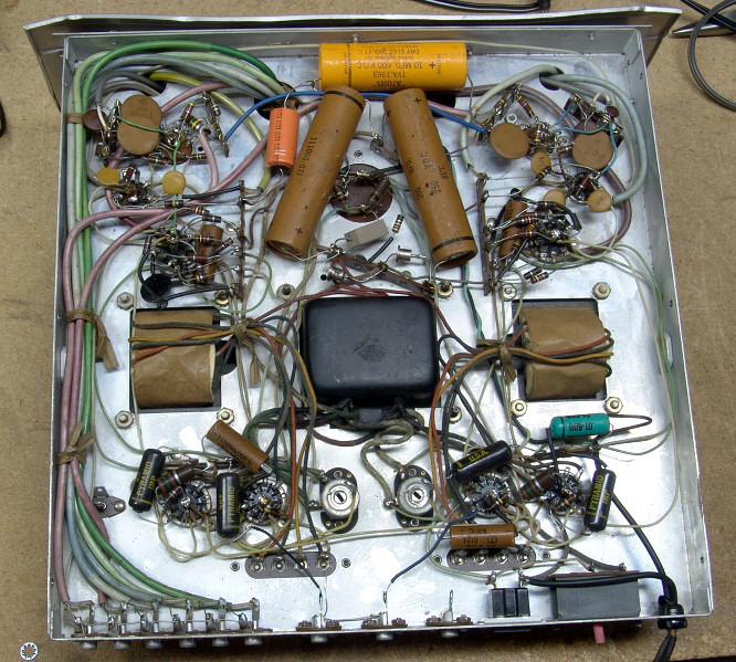

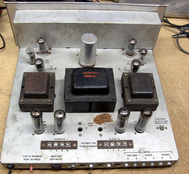

i have stromberg carlson tube amps and a scott lk38 that used ceramic disks as coupling caps and yet sounded so good, why is that?

I worked in cell phone design during the time when the world went through a serious tantalum shortage. We were trying to design out all of the tantalum caps and replace them with ceramic.
The ceramics of the day were junk. Most were highly piezoelectric, bilaterally...vibration made voltage, but varying voltage made sound. These were early TDMA phones where the transmitter is pulsed on and off at an audio rate, and the transmitter drew about an amp of current. The phones ticked and buzzed so much that they were not usable.
Fortunately several ceramic cap suppliers were developing non-piezoelectric high K ceramics. These solved the problem in phones which were the intended market, but this technology has found its way into nearly all of today's ceramic caps. The capacitance VS voltage and C VS Temp curves are often somewhat worse than in the past, and vary with the type of ceramic used. One must study the spec sheet carefully before using these in an audio application.
Most of us avoid sticking ceramics in our tube amps, but look under the hood of your favorite DAC or CD player.
