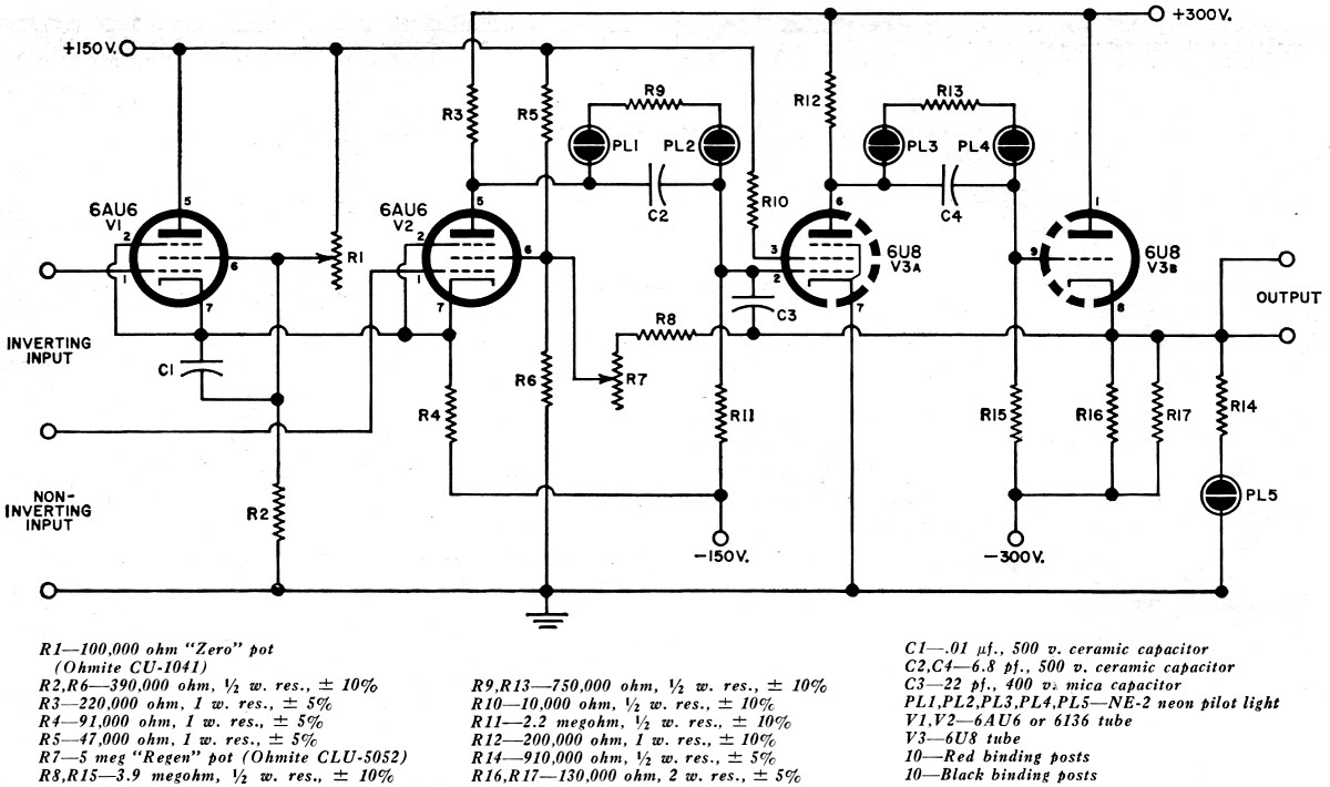

The problem of ridding the circuit of all DC blocking capacitors come down to what else would you use to block the DC? That voltage bias the audio is riding upon from the preceding stage? The only thing I was able to dig up on this is illustrated in the schematic below;
They use a couple of NE-2s to make a floating, 2 pin voltage drop that allows the interstage coupling to land the next stage's grid bias right where it needs to be. I assume that's the only way it could actually work. The pf value capacitor across the Neons suppresses noise, would be my guess?

Realizing it's bad to put a DC bias on the output transformer, perhaps being DC coupled all the way through to the output transformer primary isnt so good as well. But, could it be managed reasonably ; instead of blocking a DC offset, detect it like a speaker protection circuit does in a SS amp. Thanks for any discussion on this.

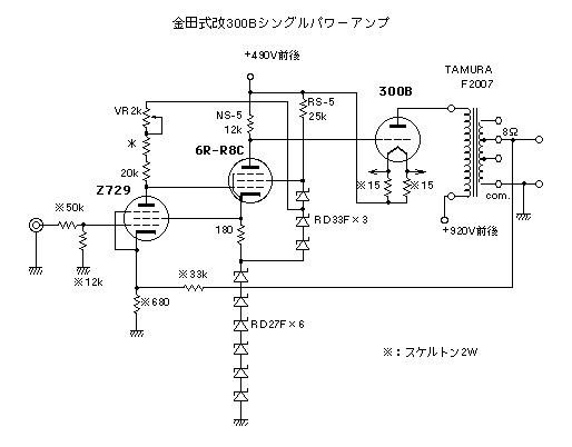

There are many transformer coupled amplifiers. This is what Western Electric generally had in their famous professional equipment.
And several amplifiers used amplifiers where the anode DC of one stage mathes the cathode DC of the next stage. See for instance the Loftin-White designs.
By the way. I also once saw an amplifier that also had NO power supply electrolytics. [Not too hard, it had a shunt power stabilizer and an series choke input. And a rather high tension to start with].
There's lots of ways to design a tube amp without coupling capacitors. The Loftin-White configuration goes back to the early 1930's.
Probably the best way is to have a negative power rail, and couple a preceding anode to the next grid with a resistive divider between anode and negative rail. This lets you bias the grid correctly and only loose a few db of signal. You need an interlock in the power supply, otherwise failure of the negative rail will write off the output tubes.
The trouble is, all the non-cap configurations have severe disadvantages: multiple power rails needed, gas tubes (noisy, short life), and low efficiency, or interstage transformers, which cost money and stuff up the sound. And unless you have high-z loudspeakers, you must have an output transformer. The o/p transformer is always the weakest link in a competently designed amp, not the capacitors. Transformer problems limit the amount of negative feedback that can be used, so operating conditions with direct coupling are not stable. Slight changes in emission in input tubes cause big shifts in output tube conditions. In fact tube manufactures all recommended against DC coupling except for applications (such as analog computers) for which there is no alternative.

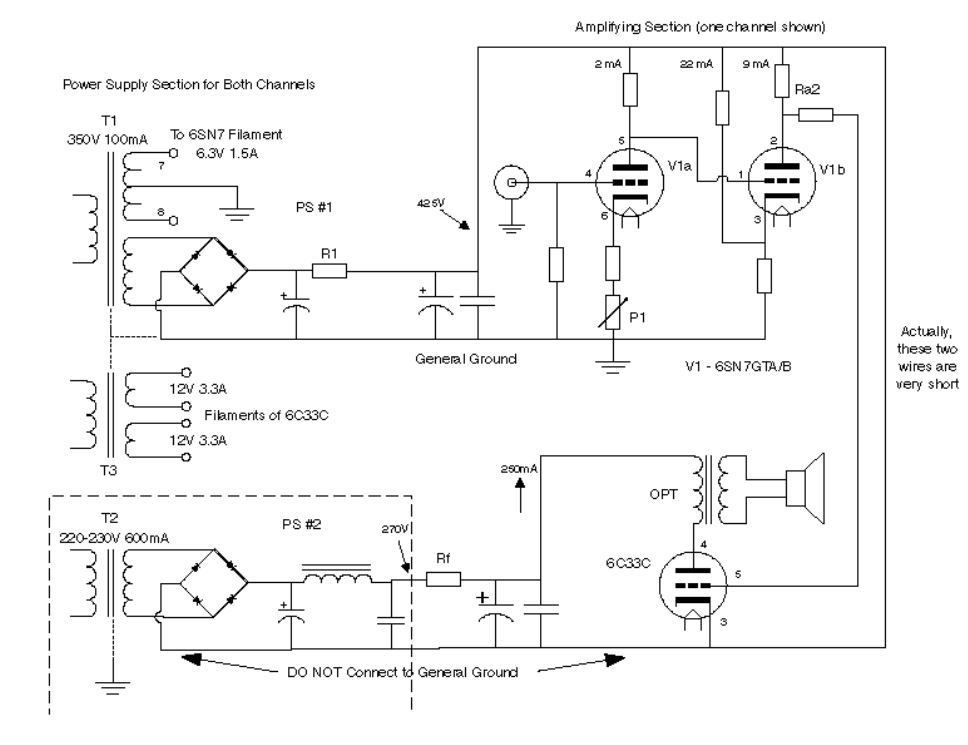

I once built a three stage fully differential push pull amplifier that had no capacitors in the signal path. It worked, and sounded nice but DC offsets are the deal breaker. As tubes age, the line voltage changes, or even the room temperature changes, the DC offset in the input stage may shift by a few millivolts. This is not a problem when there are capacitors in the path, but a DC coupled amp will be horribly out of balance at the output stage from a minor shift in the input stage. I had to adjust the bias on that amp every time I turned it on, and often during use in the summer when our line voltage varied by several volts on a hot day.
I became convinced that no more than two stages should be DC coupled, and the total gain of those two should be just the minimum needed for the task.

My findings are pretty much in line with tubelab's comments, when I was still designing and building PP amps I used dc coupled driver stages which I capacitively coupled to the output stage. Optimizing performance for the available supply voltages and building in tolerance for drift and line voltage variations was quite the task.
As DF96 states, the reason you see comparatively few fully dc coupled designed is the lack of a complementary device and substantially more complex design and power supplies. Have a look at a vintage Tektronix scope vertical amplifier design for examples of a "fully developed" DC coupled amplifier design.

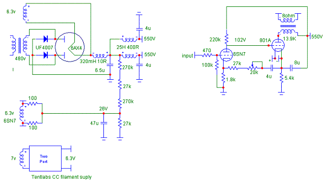

If the definition of "tube amp" includes headphone amps then it's actually easy (except for any large value capacitors in the power supply, of course). The recipe for a single-ended, single-tube headphone amp is simplicity itself:
1) Use an output transformer with about 5k to 10k primary impedance and a secondary impedance that is close to the impedance of your headphones (something like a 50 ohm secondary would work for most).
2) Use a high transconductance, frame grid RF pentode that will have a gain of at least 30 and plate resistance of about 1000 ohms when wired triode. Wire it triode. 12GN7A or 6e5P would work.
3) Use paralleled LEDs to cathode bias the tube. (I ended up preferring the sound of a cathode resistor with bypass capacitor, but maybe I actually like bad 'capacitor sound'.)
4) Regulate the plate supply. Something like 150V to 200V DC that can deliver 100mA or so should work for a stereo amp. (I wound up getting lazy; after trying mine with a choke input passive power supply with RC decoupling I ended up keeping it that way because it's dead quiet and sounds good to me. It even has AC heaters, but I can't hear any hum at all.)
That's a single-stage, single-ended triode, output transformer coupled headphone amp with no coupling capacitors.
