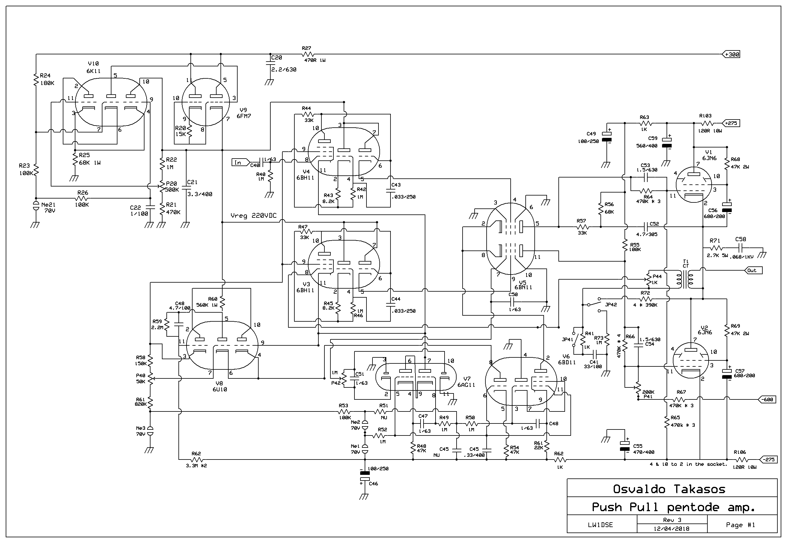

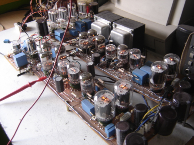

A Tube amp without coupling capacitors? Possible?
This is my project in which actually I'm playing on.

A simple no coupling cap design: Tim Mellow OTL www.mellowacoustics.com/articles/Tim_Mellow_25w_OTL_Tube_amplifier.pdf Take out the 0.1uF coupling C3 and C4 between 1st and 2nd stage Ground C1 and feed the input directly into R2 thereby eliminating C1 and C2 Increases Output impedance and reduces nfb and I am not shure whether I want to feed the audio signal through a 4.7MOhm resistor but nonetheless maybe a starting point ... And it comes with a free DC sevo.
Lower bandwidth than a capacitor.

Wavebourn stated the true problem. If the coupling cap sees a non constant time varying load when driven with real music, it can and will misbehave. This is why different caps will react differently.
In the TSE-II and the UNSET designs the coupling caps see a constant load of 1 MEG OHM in parallel with a few pF of gate capacitance. The fets that follow the coupling cap are chosen and biased such that that capacitance remains constant through the range of signal seen in the amplifier's use.
Frequency response of either design stretches from about 10 Hz to hundreds of KHz except for the OPT which is by far the most dominant pole in the amp, and there is no feedback applied from the OPT's output.
The TSE-II, like the original TSE is a no-feedback design while the UNSET uses local feedback loops around each pentode to emulate triodes. No global feedback is applied.
Enclosing a capacitor inside a feedback loop is another way to bring out it's worst qualities, since correction signals through the cap can be nonlinear.
"Every stick has 2 ends". Yes, feedback around a coupling capacitor increases sharpness of dynamic distortions, but decreases their impact, making recovery faster and percentage of distortions lower. The essence of design of electronics equipment is optimization. There are no "absolutely bad" or "absolutely good" solutions, everything has to be carefully weighted, except of course obvious errors.
And one of ways to kill several ducks by a single shot is to enclose a coupling cap before a follower, instead of before an output tube's grid that guarantees to work with non-linear grid current, especially if it is a triode.
