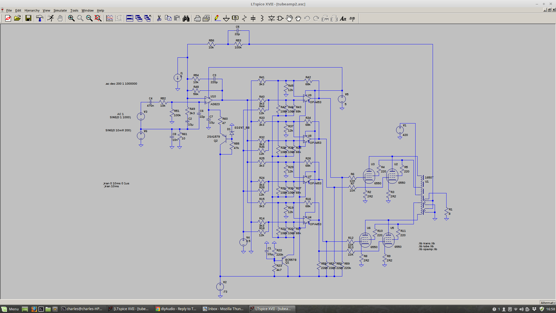

Ouput without caps
Yes its possible if your happy to replace the driver stages with and op-amp. I used an OPA453 which is powered from +5V and -73V which is enough to drive the grids of a 6550. V4 is in fact a 4 channel DAC to bias each 6550 individually. Of course removing the driver with remove that 'Valve' sound caused mainly by slew rate limiting.
