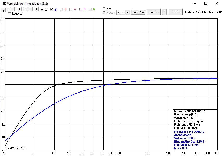

No standing wave at fc? We are talking about rooms with around 25m². If we follow your example and take one dimension with 4m, we have a standing wave at 43Hz (343Hz / 4m / 2). So that we get to the 25m², the other dimension is about 6m, here the standing wave is at 29Hz. Exactly the fc area! In addition, there is the standing wave of the room height at around 65Hz.
Of course there are also standing waves over the three main modes. However, these are not as pronounced and are also weakened by things like sofas etc. In addition, the higher the frequency, the more they overlap.
And now let's look at the simulation of the Mona Kea's woofer, one bass reflex and one closed in the same volume:
attachment.php
The standing wave at 29Hz is served with about 3dB less level, the standing wave at 43Hz with 4dB less and the one at 65Hz with 2dB less. This is a huge advantage in practice.
Closing the ports costs in this case less than 5dB, not 6dB or more. An influence can also be seen above 80Hz.
Again you are talking about 0.5m distance to the wall - but in Lupo's case it is 85cm, 70% more!
In theory, your objections are justified, but in practice the effects are different from what you claimed.
I've heard the Mona Kea very often, both as a bass reflex and as a closed one. On paper, the bass reflex version should have a clear advantage, but I would always prefer the closed one. And almost everyone who has heard and built it so far shares this opinion, including the designer.
