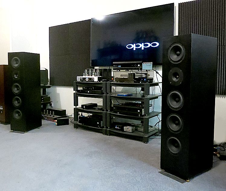

Zaph|Audio - SB12.3 3-Way Tower
Zaph|Audio SB12.3 ~ SB Acoustics 12", Dual Midrange, 3-Way
Another fun option, and 92db sensitivity.
