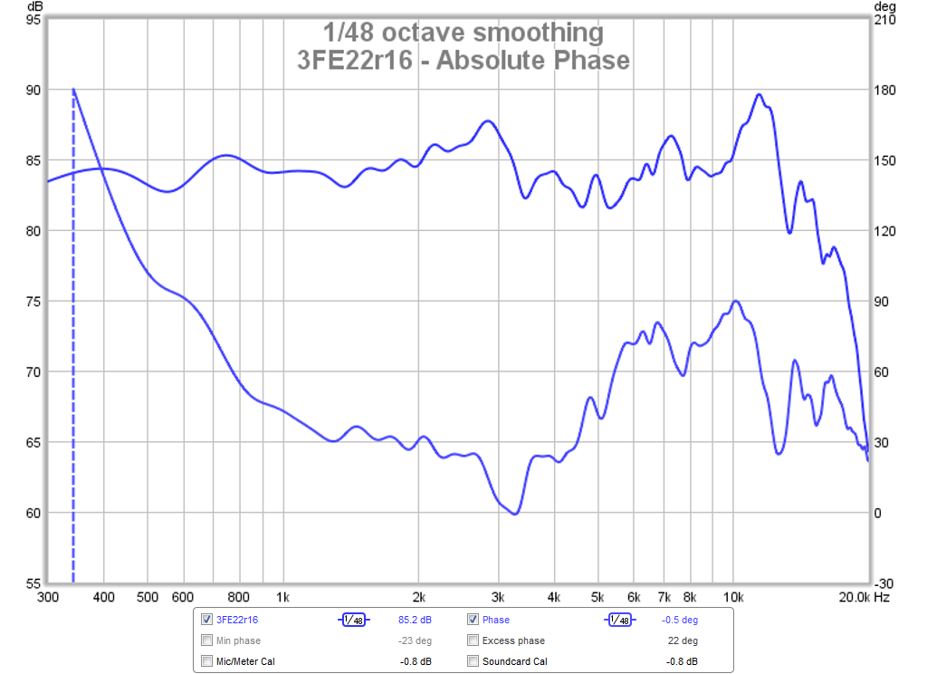

*Maybe* this helps me understand why I didn't like the treble on the 3fe22... I originally attributed its HF harshness to the peak I could hear above 12k, but it the feeling was more broadband than just that peak, but its very hard to imagine 15deg of shift from 3k to 10k (~1.7octaves) would be noticeable...
It's actually more like 90 deg of shift from 3k to 10k. Axis for phase is on the right side and in in 30 deg major increments.
473386d1427134521-subjective-blind-comparison-3in-5in-full-range-drivers-3dfe22r16-absolute-phase.png
Thinking about it a bit more that particular phase shift would noticeably impact the 3rd harmonic of the 750hz region so I can see why I might have thought it was happening down at the fundamental (it was, just relative to).
I'm still a bit skeptical, but I did get a familiar sick feeling in my stomach that tells me phase is broken... Anyone else get that?

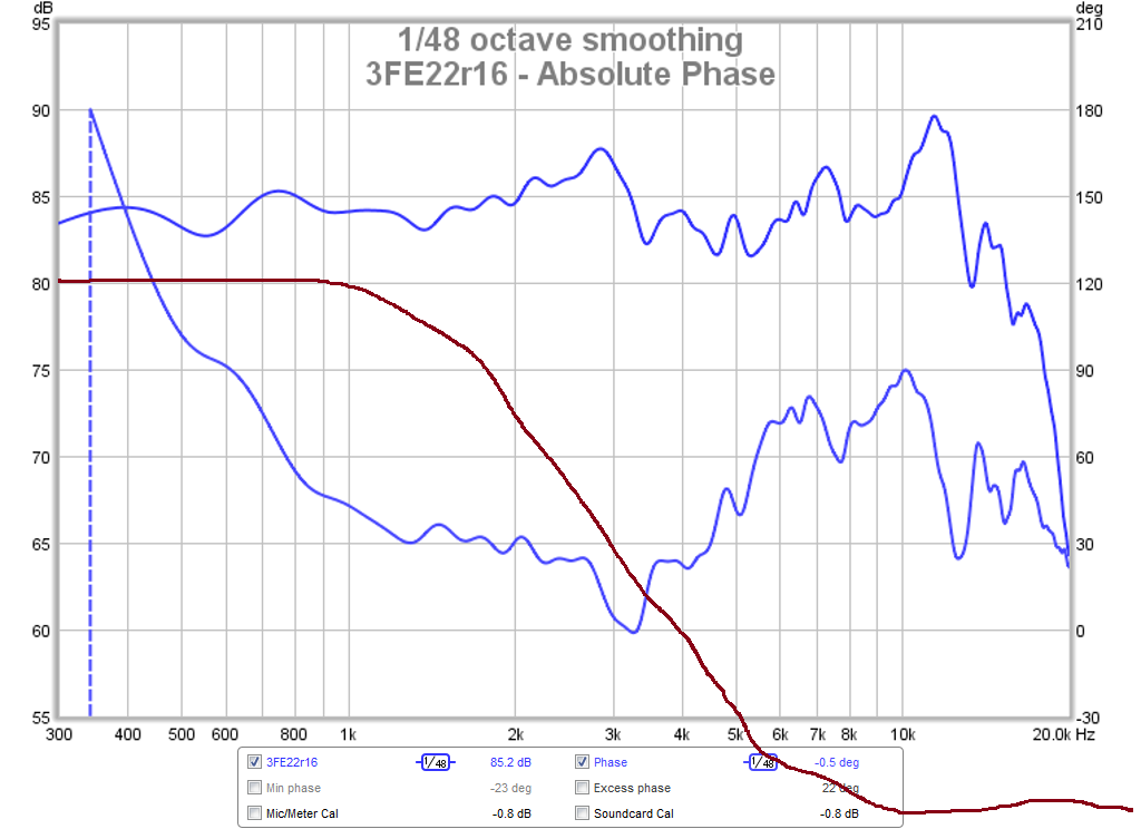

Hand drawing a very rough 4.ordens XO onto 3FE22r16 phase plot, could there be any objective/subjective reason for statistic high votes that driver. If track listened that XO there is some relative phase correction going on in slowing HF area 🙂.
xrk971 not your XO i mean people that use a speaker with XO to audition the sound clips that have a XO point in 1,5-4Khz for 2-3 or 4. order will have phase shift error 180-270 or 360º mening faster HF area, they live with that but it's a distortion. Now because 3FE22r16 actual have slower HF they hear a some relative more linear repaired group delay when listening the tracks that has been thru 3FE22r16 (FIR convolved 🙄).

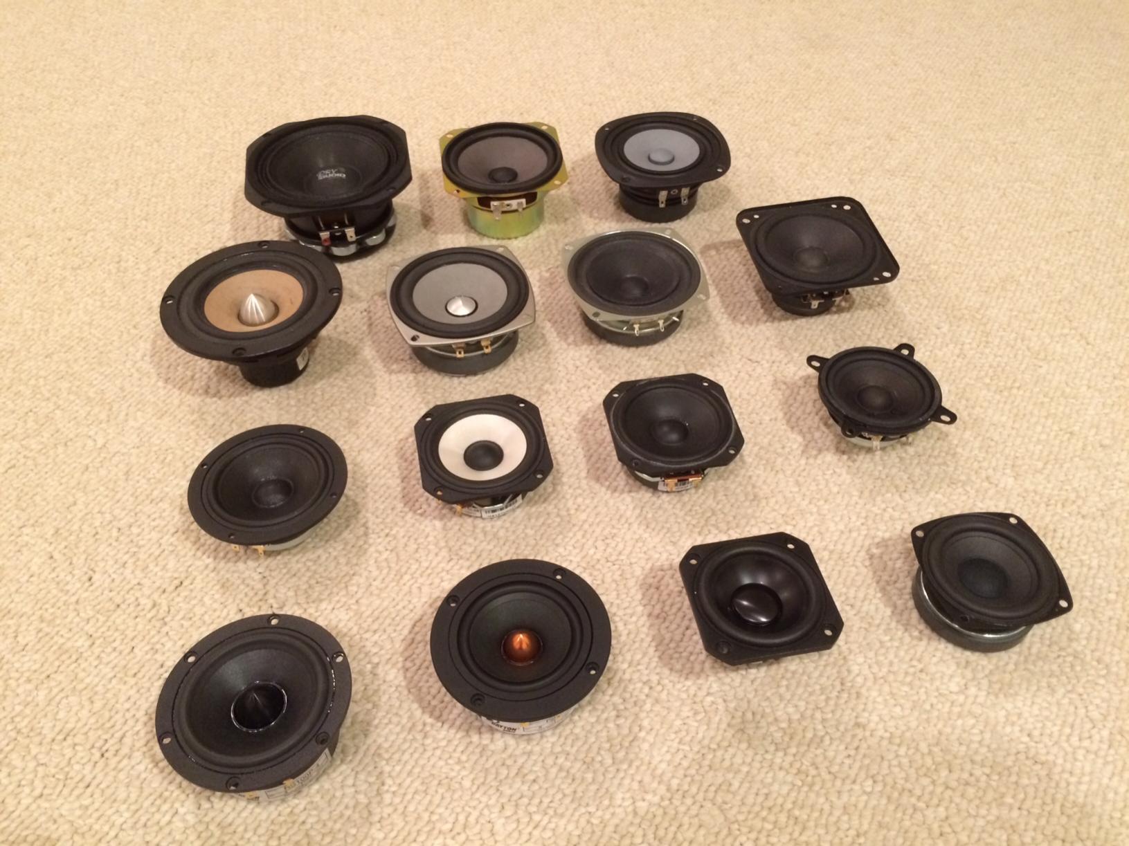

More drivers have arrived and I am still waiting for the Visaton B80, a MA A7.3, and possibly the Kevlar cone Peerless (although I am not getting a good feeling that one will come). Here is the current lineup so far of the ones I have tested and recorded sound clips of:
477906d1429237312-subjective-blind-comparison-3in-5in-full-range-drivers-lineup-drivers-april-16-2015-b.jpg
From bottom left to right: Dayton RS100P-4, Dayton PS95-8, Peerless 830986, AHE7,
second row (from front): Scan Speak 10F/8424, Vifa TG9FD10-8, Vifa TC9FD18-8, Faital Pro 3FE22 r16
third row: Tang Band W4-1320SB, Fostex FF105WK, Radio Shack (Foster FE103) 40-1197, 69 cent wonders
fourth row: PRV 5MR450NDY-8, NSB (no stinkin' badges), Mark Audio CHN-70
If the B80 doesn't show up soon, we may have to go onto Round 2 without it...
Round 2 will include: Scan Speak 10F/8424, Vifa TG9FD10-8, Tang Band W4-1320SB, Fostex FF105WK, Peerless 830986, AHE7, Mark Audio A7.3, Visaton B80, and a surprise entry.
