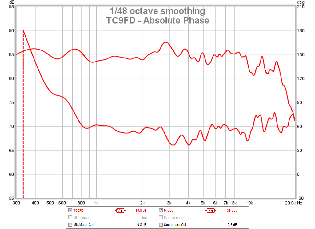

Well, there may actually be something to your super-tuned phase-modulated echo-location bat ears after all...
Here is the absolute phase for TC9FD vs 3FE22r16 (4ms gate):
TC9FD
473385d1427134521-subjective-blind-comparison-3in-5in-full-range-drivers-tc9fd-absolute-phase.png

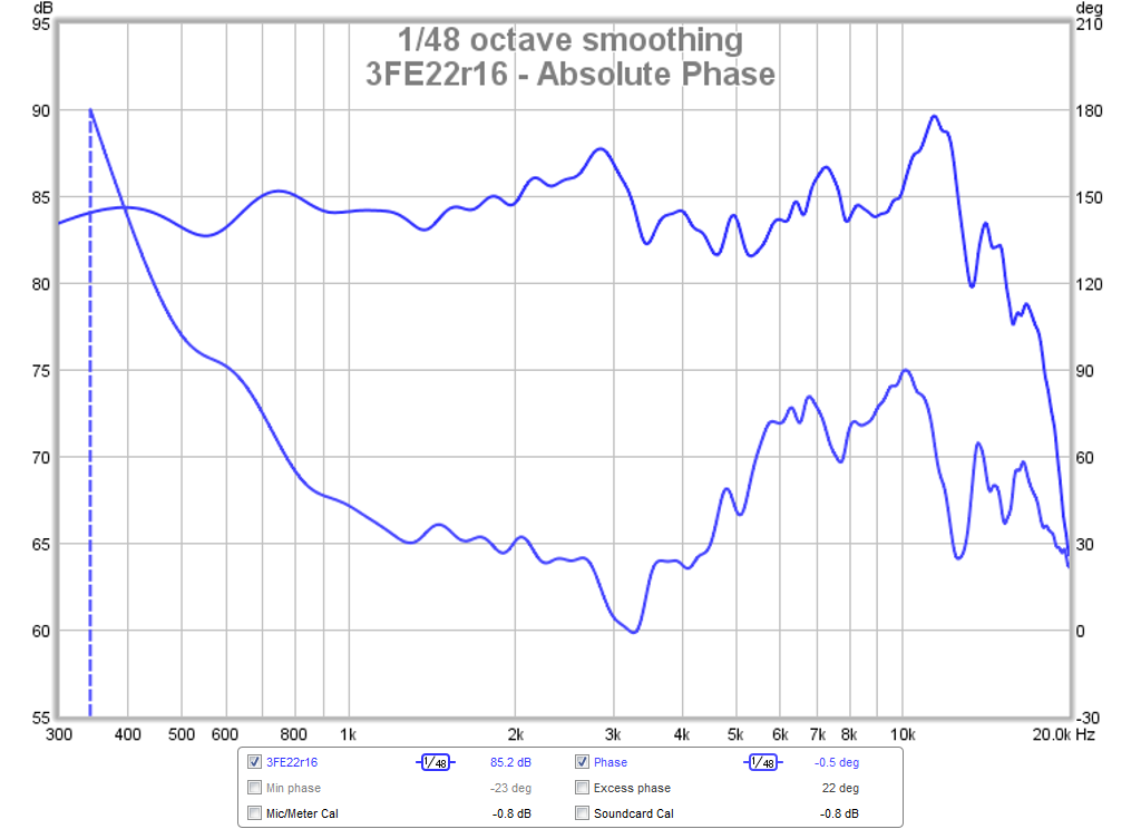

3FE22r16
473386d1427134521-subjective-blind-comparison-3in-5in-full-range-drivers-3dfe22r16-absolute-phase.png
There is sharp phase dip at 3.3kHz followed by a rise to 10kHz with 3FE22 whereas it is relatively flat with TC9FD, but all this would flatten out with some mild EQ I think.

Oh interesting to see... That's not that much shift, is it?
What do the other drivers look like?
*Maybe* this helps me understand why I didn't like the treble on the 3fe22... I originally attributed its HF harshness to the peak I could hear above 12k, but it the feeling was more broadband than just that peak, but its very hard to imagine 15deg of shift from 3k to 10k (~1.7octaves) would be noticeable...
The phase issue I noticed seemed much lower, like 300-700hz and was in comparison of the Mark Audio and 3fe22.
I do think that amount of phase shift might be noticeable when flipping a/b style between sources, if ones acoustic memory is really good, but even so, I can't see how the impression would ghost to lower frequencies...
I haven't done any *serious* experiments with phase, but word on the street is phase shouldn't be much of a discussion point above 4khz since our ability to localize ends up there. So how do we acquire pitch above 4khz then?
