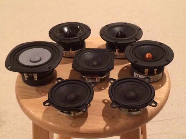

Here are the drivers that will be part of this blind listening test:
- Vifa TC9FD (3.5in paper cone 8 ohm)
- Faital Pro 3FE22 (3in paper cone 16 ohm)
- Dayton Audio RS100-4 (3.5in aluminum cone 4 ohm)
- Dayton Audio RS100P-4 (3.5inpaper cone 4 ohm)
- Dayton Audio PS95-8 (3in paper cone 8 ohm)
- MA CHN-70 (4in paper cone 8 ohm)
- PRV 5MR450NDY (5in 'midrange' pro audio paper cone 8 ohm)
Edit March 21, 2015: Update on poll results - answer key for blind test:
A=5MR450NDY
B=TC9FD
C=PS95-8
D=3FE22r16
E=RS100P-4
F=CHN-70
G=RS100-4
Here is a photo of the palette of cheese, err I mean drivers to taste. (Remember that this is all for fun - like cheese or wine tasting):

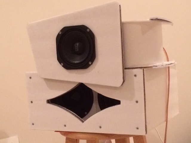

I setup an identical FAST system for the test using an XKi dual driver bass unit and the Nautaloss sealed spiral TL top with a trapezoidal baffle as described previously here:An Objective Comparison of 3in - 4in Class Full Range Drivers - diyAudio
The XO was provided by a miniDSP and set at 225Hz 24dB/oct LR for all cases, a -3dB high-shelf Q=0.7 baffle step correction was applied at 750Hz for all cases (note correction here from previous Q=0.5, 850Hz, -5dB - my mistake). Only level matching between the sub and top was adjusted between cases. The mic is a Zoom H4 recording at 48kHz and 32bits and converted to 192kbit mp3 files in Audacity so that a 40 second clip can fit under the 962kB upload limit. In Audacity, I adjusted the level so that the final output file has a maximum peak at -1dB.
Here is a photo of the Nautaloss-XKi FAST used for this test (shown with PRV 5MR450NDY, not included in above photo):
469027d1425249579-subjective-blind-comparison-3in-5in-full-range-drivers-blind-fast-setup.png

It should be evident that the clips are all only valid in the context of the system & room they are in.
And that they are all 1st convolved by the mic, mic preamp and ADC. Then on the other end by the system that it is played back thru,
Other questions that arrise:
1/ how good is the foam-core baffle?
2/ the baffle is small enuff and the XO low enuff that the sound field will be coloured by the wrap-aroud the baffle.
3/ how much information is lost converting the files to MP3s?
Fun, but of limited applicability.
dave
Founder of XSA-Labs
Joined 2012
Foam core baffle is good enough to support weight and vibration of driver with harnonic distortion and frequency response provided in previous thread. But then that is getting quantitative and objective - which is not the point of this thread.
Wrap around sound field is identical for all drivers tested here - so effect at least is uniformly applied.
True info is lost - I had to make a decision on trade off of having a 5 second long lossless FLAC vs a 40 second long compressed sound clip that has no content above 16kHz. I think most of the differences for these drivers is below 16kHz anyway. I can't judge sonething on a 5 second clip.
