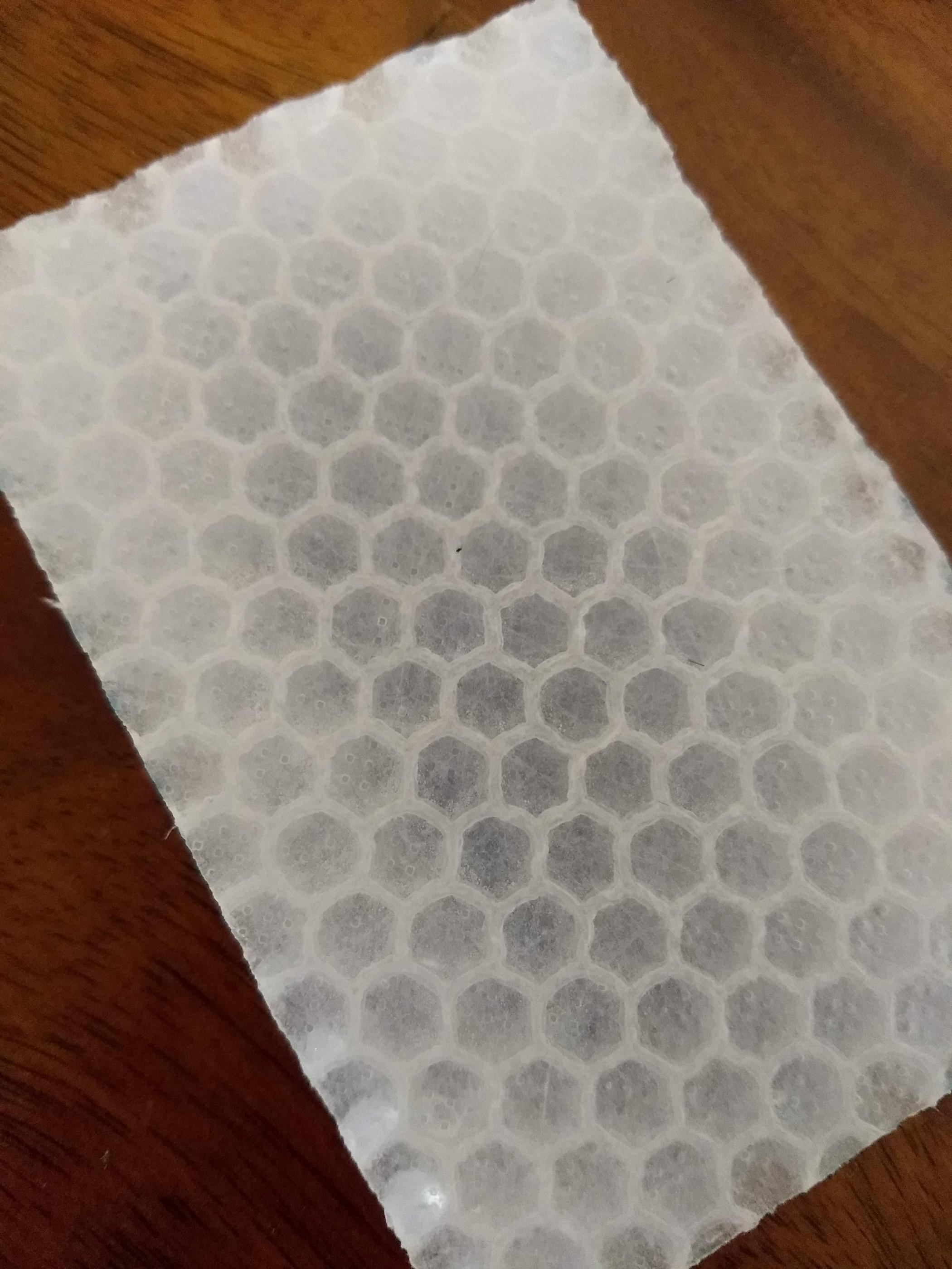

I use the same technique to make double tops in that I put a measured (g/in^2) amount of epoxy on a third surface precisely quantified then set the Nomex in the spread out epoxy. This transfers a minimal amount of epoxy to the Nomex and should keep the contribution of the epoxy to the weight of the panel next to nothing.
I only tried nomex once before and didn't know this technique at that time. I used way too much glue (and wrong kind). I've since seen the technique you described but have not tried it yet. Lately I've been trying CF construction with fabric (not prepreg) which makes using nomex more challenging though not impossible. Something like balsa or foam works better than honeycomb when working with carbon fabric. I'm not sure where I'll end up yet.

I was taught that technique by Alan Dunwell of Dunwell guitars outside of Boulder,Co. I felt his exact g/in^2 was too proprietary to share but the amount I gave should work. Alan is a great and very smart guy. Kudos to him.

I wondered about using the lightest CF weave which is about .1 mm thick or possible random CF cloth and doing a manual setup with epoxy and maybe thicker 4-5 mm Nomex.
It could be laid up on a piece of plate glass with release agent and a vacuum bag. Probably many ways to skin the cat. The trick is keeping costs down so hobby types can play.

Now to go see how the Nomex Mylar panel side one worked out... ...And have a cup of coffee!
