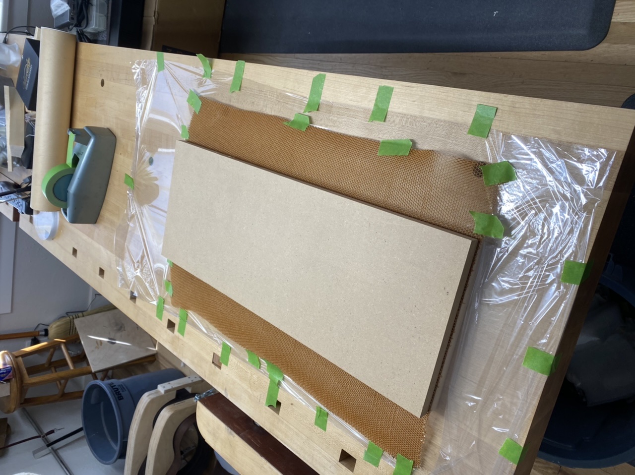

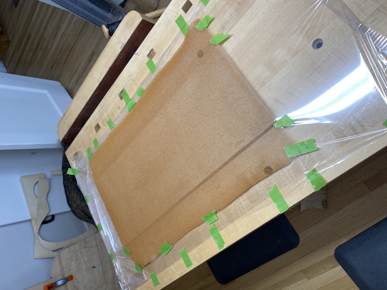

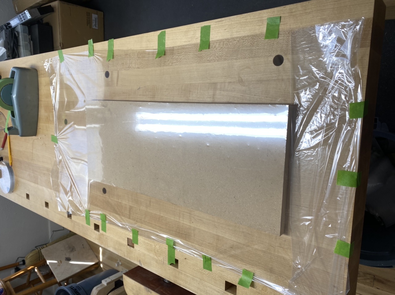

Test Honeycomb Panel
I decided to dive in and get feedback from the forum on the process I am using. If it works I will do a summary process posting
I had a little .25 mil Mylar from my ESL days and some Nomex honeycomb 1.8 lb
I couldn’t find my old ESL Mylar stretching frame so I compromised with tape.
My plan is to make a 1/2 size panel to avoid to much wasted expense if it fails. Two high density MDF plate are used for glue up. Mylar was stretched over the first plate with the goal of removing wrinkles. I didn’t want significant tension on the Mylar to avoid buckling of the panel. The second plate of MDF will be used to clamp.
Now to mix up glue. West’s System 2 two part slow cure epoxy. Will post more after first side is glued and dry. My plan is to use a ink brayer to spread out epoxy onto a piece of glass. Next will be to lay the nomex on the spread out epoxy to transfer “just enough” to the nomex. Finally, I’ll glue up the sandwich.
Feedback is welcome, please!
