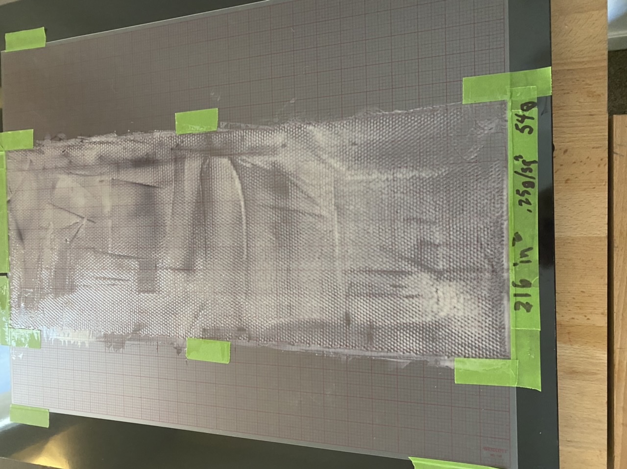

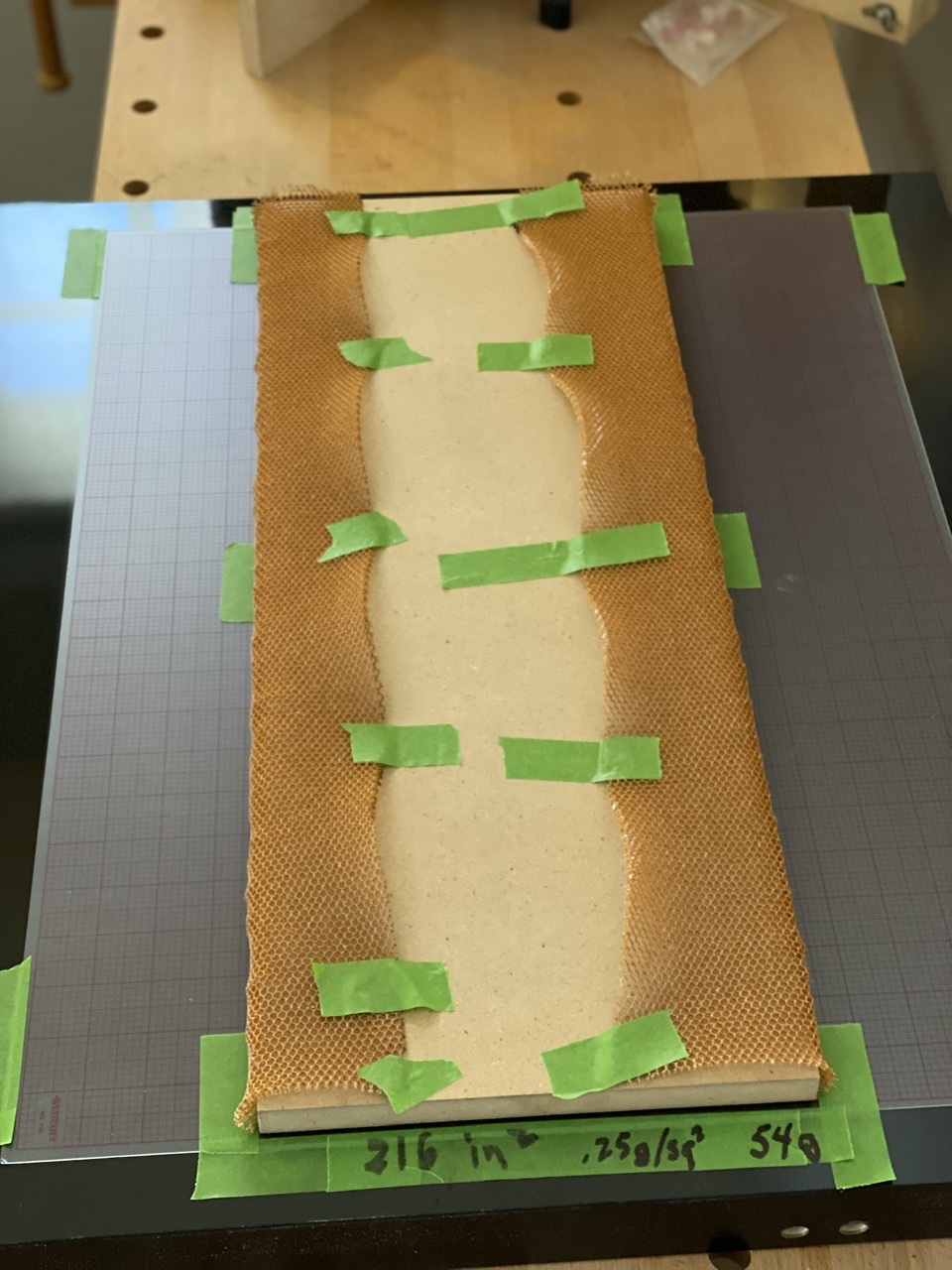

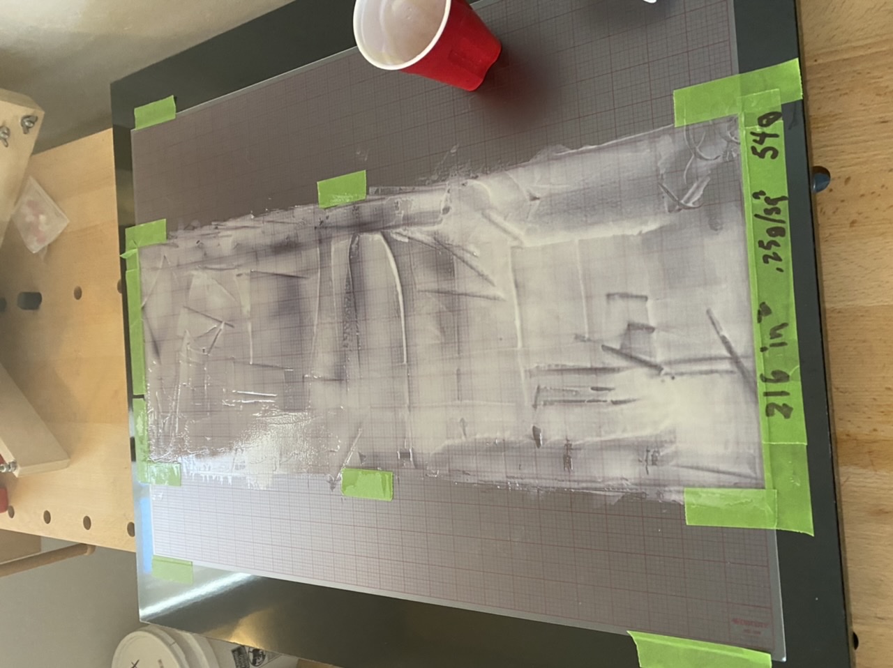

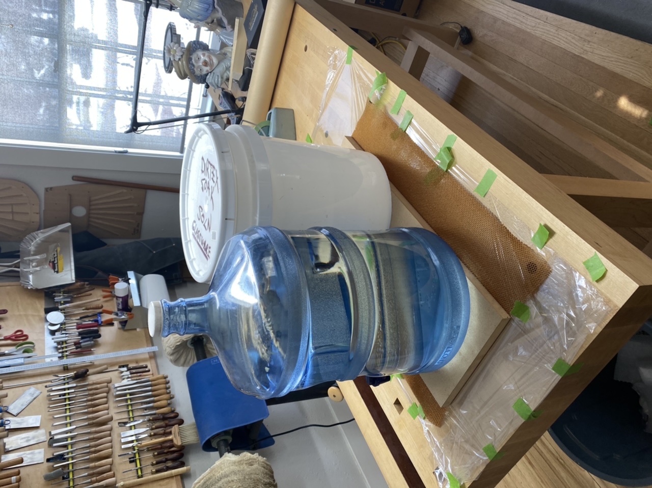

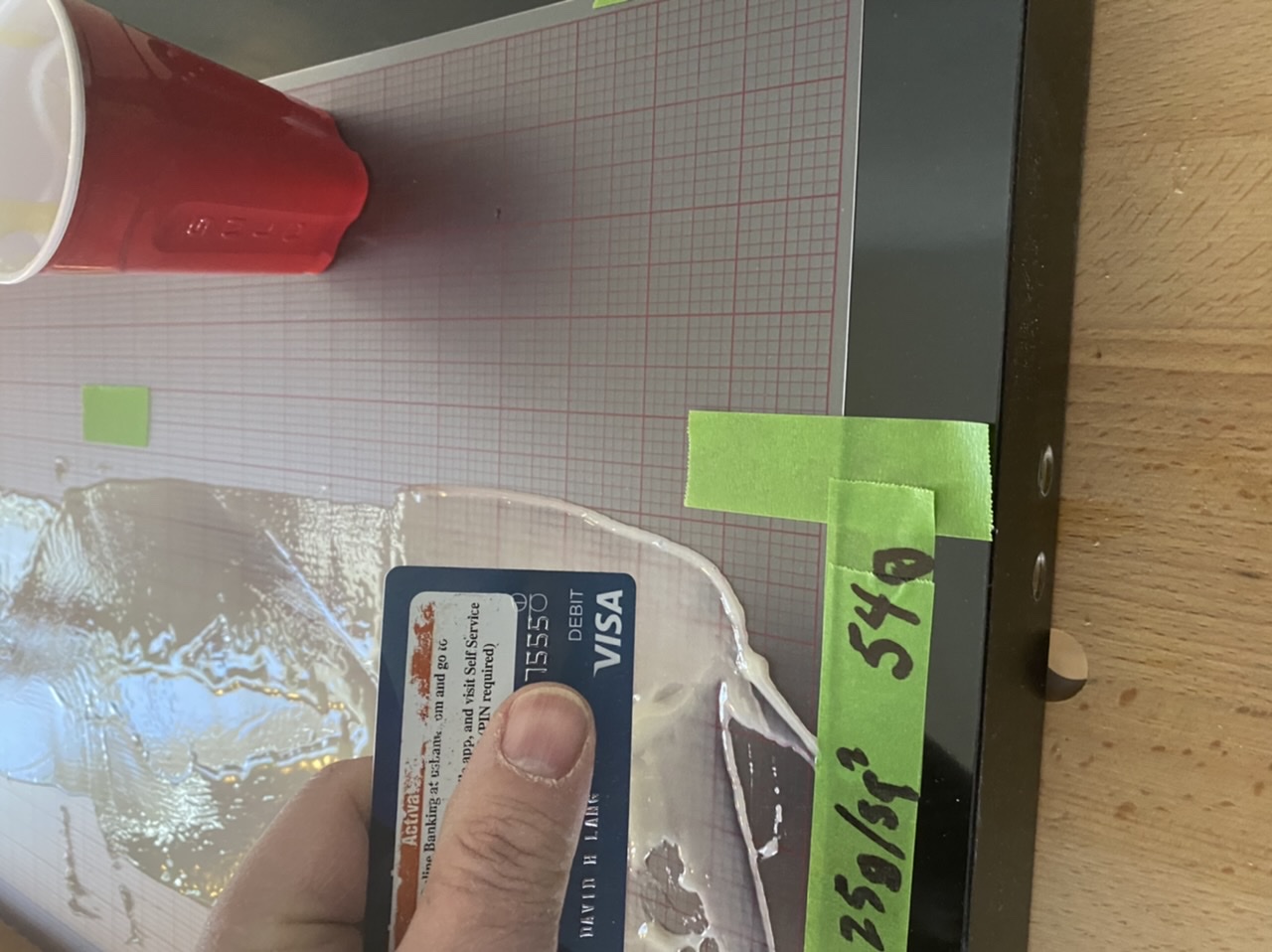

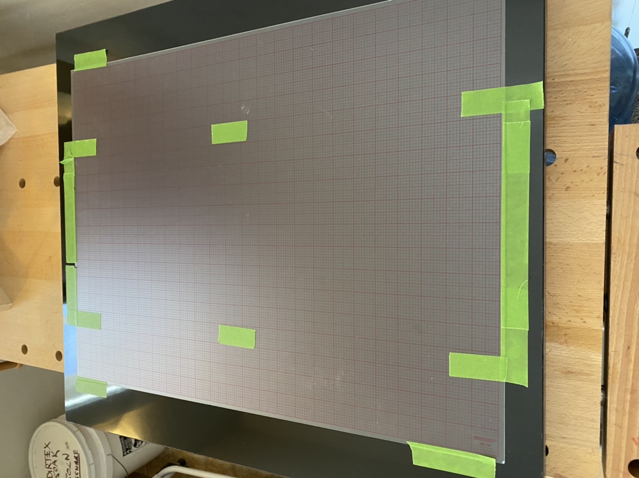

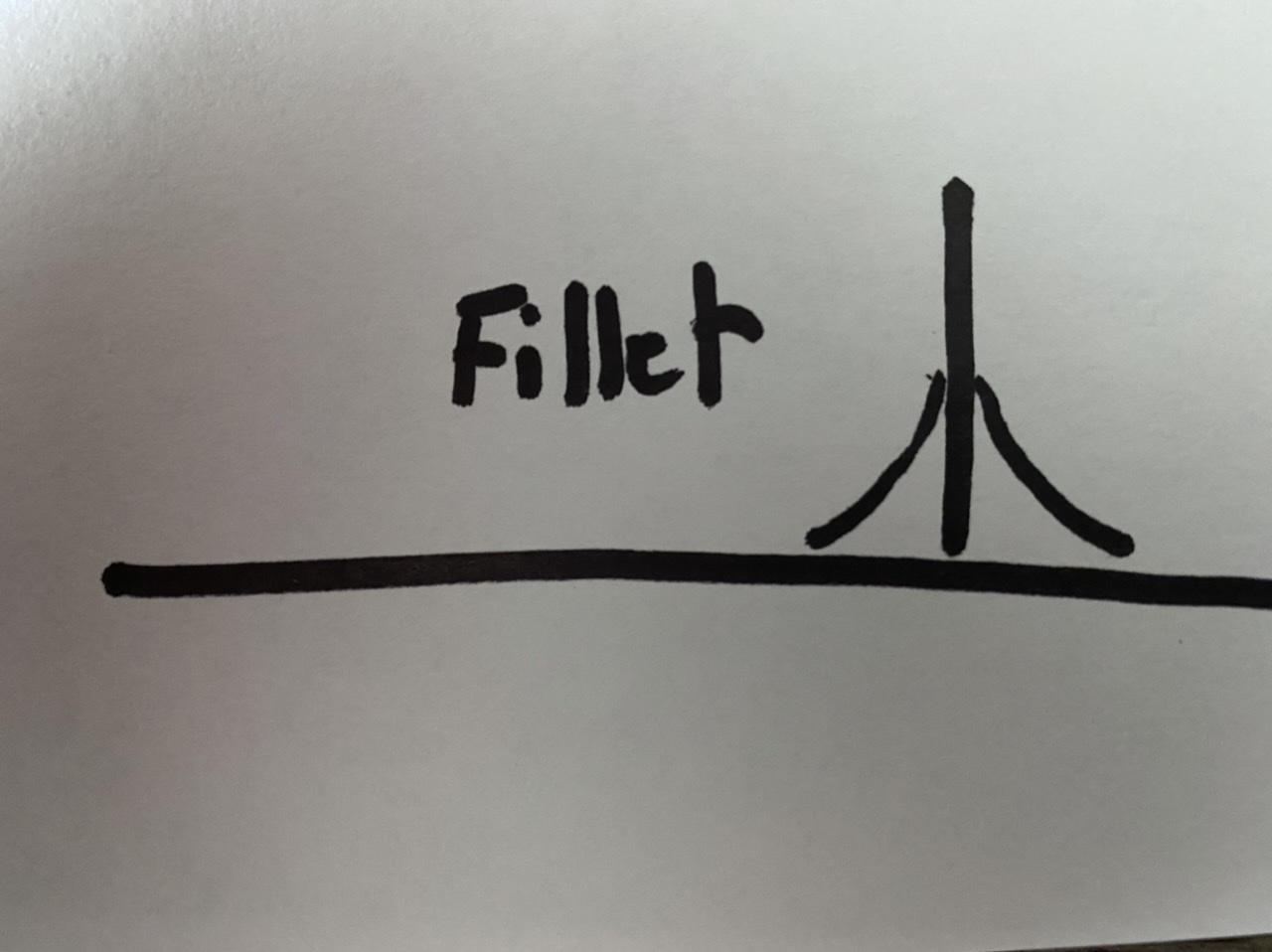

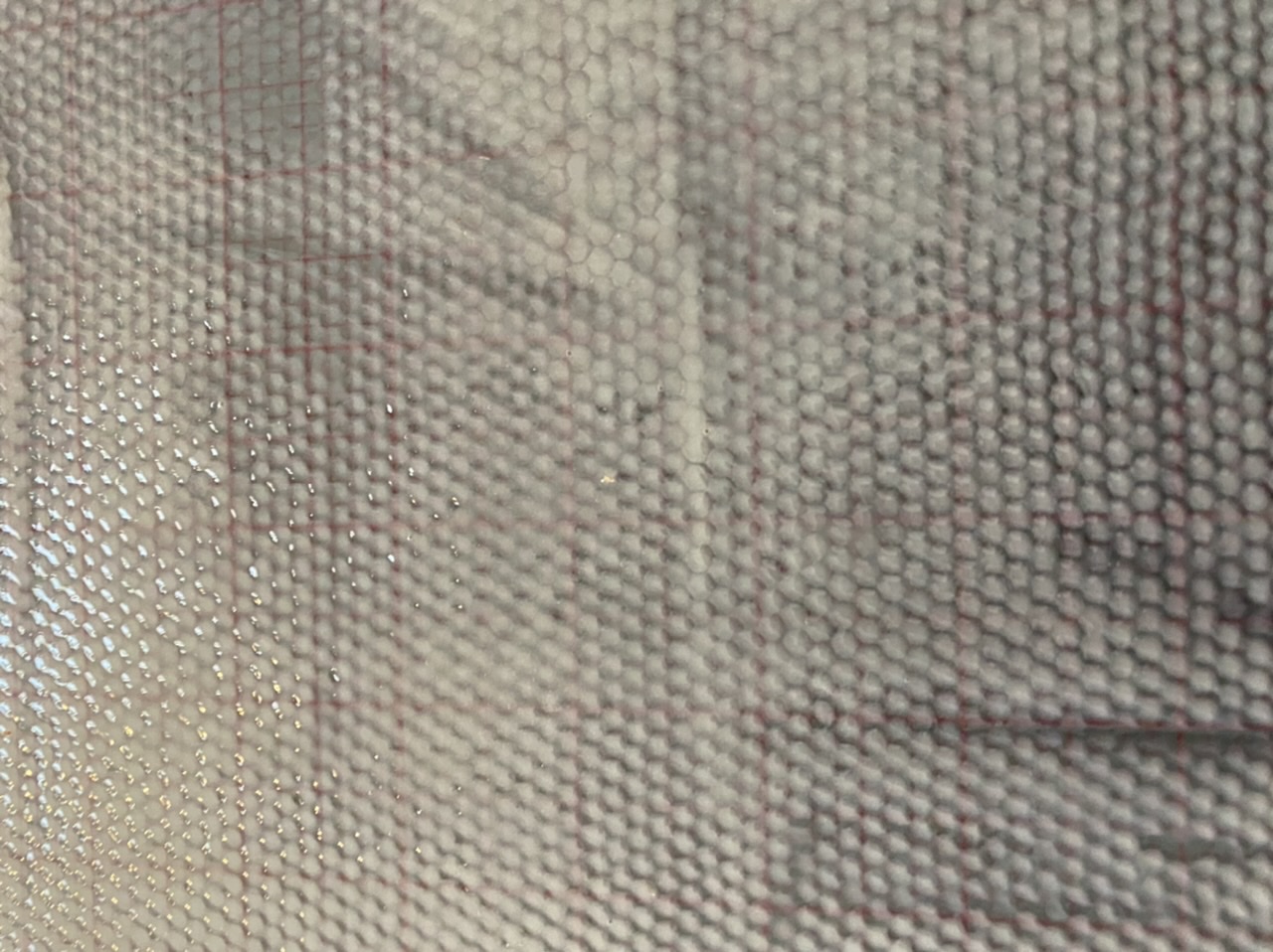

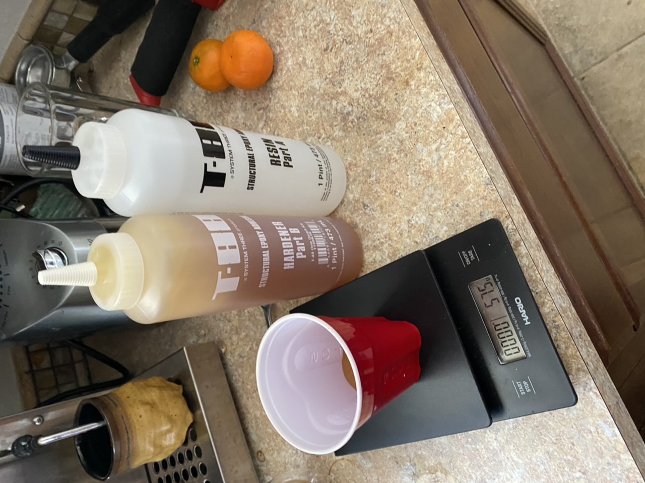

Just finished gluing up first side. I used 56g of epoxy for one side glue up. The panels are 9 x 24 inches. The pattern impressed onto the spread out glue confirms transfer of glue to nomex core. Epoxy is thixotropic so I am hoping ie will form a fillet as illustrated between mylar and nomex. I will let the glue dry 24 hours. Glue vacuum bagging might speed this process. After this side is dry I will repeat on the other side. It is important to spread glue with same credit card that you bought your Nomex, Mylar or CF. Destroy card after use for safety
One concern is that the Mylar might stretch. I really didn’t stretch it I just pulled and smoothed it out flat. It this is a problem the panel can be gently heat shrunk with a heat gun(old ESL trick).
Keep suggestions coming.

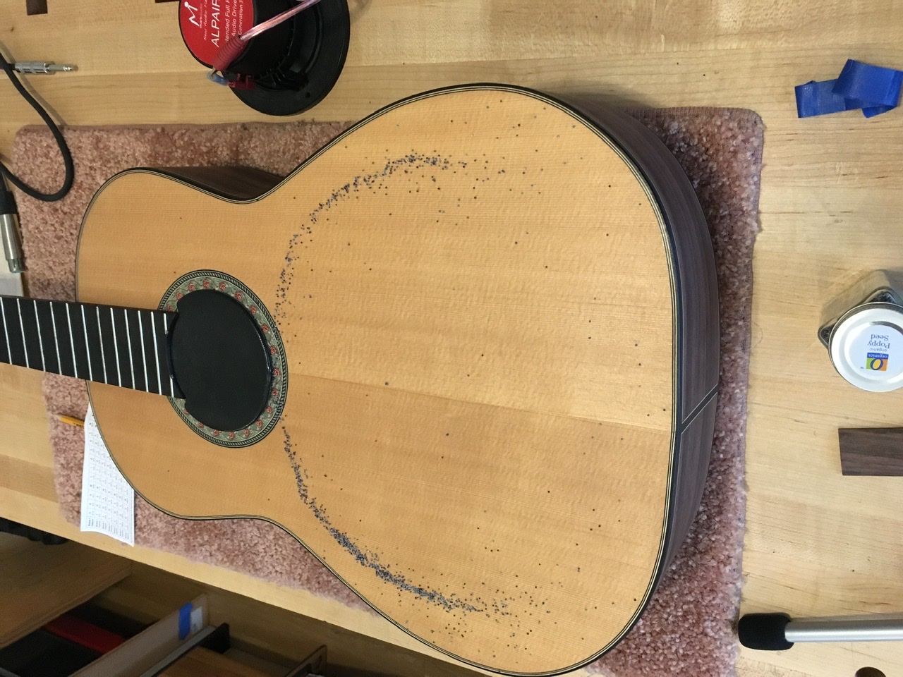

From your pics it looks like you build guitars, yes? Ever built any doubletops? Seems like a lot of the same principles should apply.
Regarding the mylar properties, I think it's the elastic modulus that matters more than the tensile strength. But maybe that's what you meant.
Eric
Yes I build guitars. And yes I build double tops. That is why this topic (DML’s) are of such interest to me. I regularly do modal analysis of guitar tops during construction and I have all the “stuff” for modal analysis and modification as well as some composites and lamination experience. Music, Hi End Audio and everything guitars including building are my hobby loves.

I had a little .25 mil Mylar from my ESL days and some Nomex honeycomb 1.8 lb
Feedback is welcome, please!
Hmm. I must admit I had not thought about using an un-reinforced plastic as the skin for a skin/core/skin DML, but it's worth trying. Mylar (PET) has a modulus comparable to wood (good), while a quite a bit denser than wood (bad), and available much thinner than wood (also good).
But at 0.25 mil, it will probably buckle on the compression side of the panel, and not really provide the stiffness that it otherwise would.
My gut feeling is that you will probably need a Mylar that is more like 5 mils thick to avoid buckling. But I'm eager to hear what you find.
Eric
Yeah I thought of what you said. Might buckle. I am trying to push the beam theory idea to an extreme. We shall see. [emoji28]. I’ll keep posting either way
One time I built a guitar top at .030 thickness. It’s biggest problem, other than fragility, was that it luffed like a sail between the braces when excited. I am afraid that might happen between the cells of the nomex. We shall see. Further, the panel might need some heat treatment to tighten it up.
Wow. Nice. We need you here. Tell us about the stuff you have for modal analysis! Do you mean something for predicting, like finite element, or do you mean something for measuring? I don't know what the "stuff" is but I want to!
Eric
Stuff:
A signal generator with integral amp
A vibrator for stimulating panels
I measure MOE using static and dynamic methods as well as noninvasive ultrasonic methods
Workstation for stimulating Chladni patterns in plates or complete instruments.
Lots of paprika, sand and poppy seeds
This is old school but it works ( No shop scanning laser Interferometer but I do have access to one at the local engineering school)

My NOMEX is 3mm. The Mylar is 1/4 mil. The ultimate weight of this panel won’t be more than a few oz. I use the same technique to make double tops in that I put a measured (g/in^2) amount of epoxy on a third surface precisely quantified then set the Nomex in the spread out epoxy. This transfers a minimal amount of epoxy to the Nomex and should keep the contribution of the epoxy to the weight of the panel next to nothing. Using less epoxy on the spreading table won’t transfer enough epoxy to the Nomex and could result in delamination. I put in a little extra above the known minimum amount.
