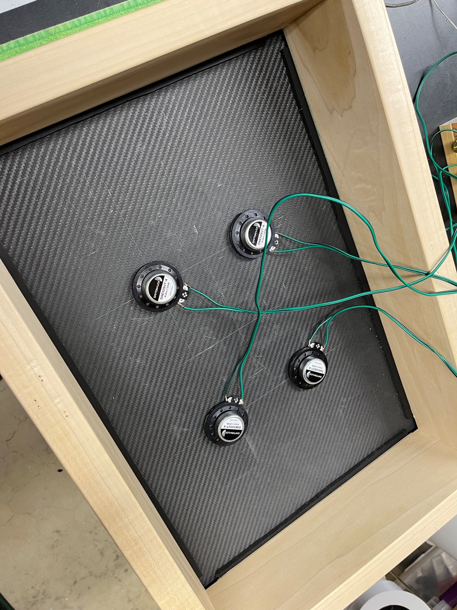

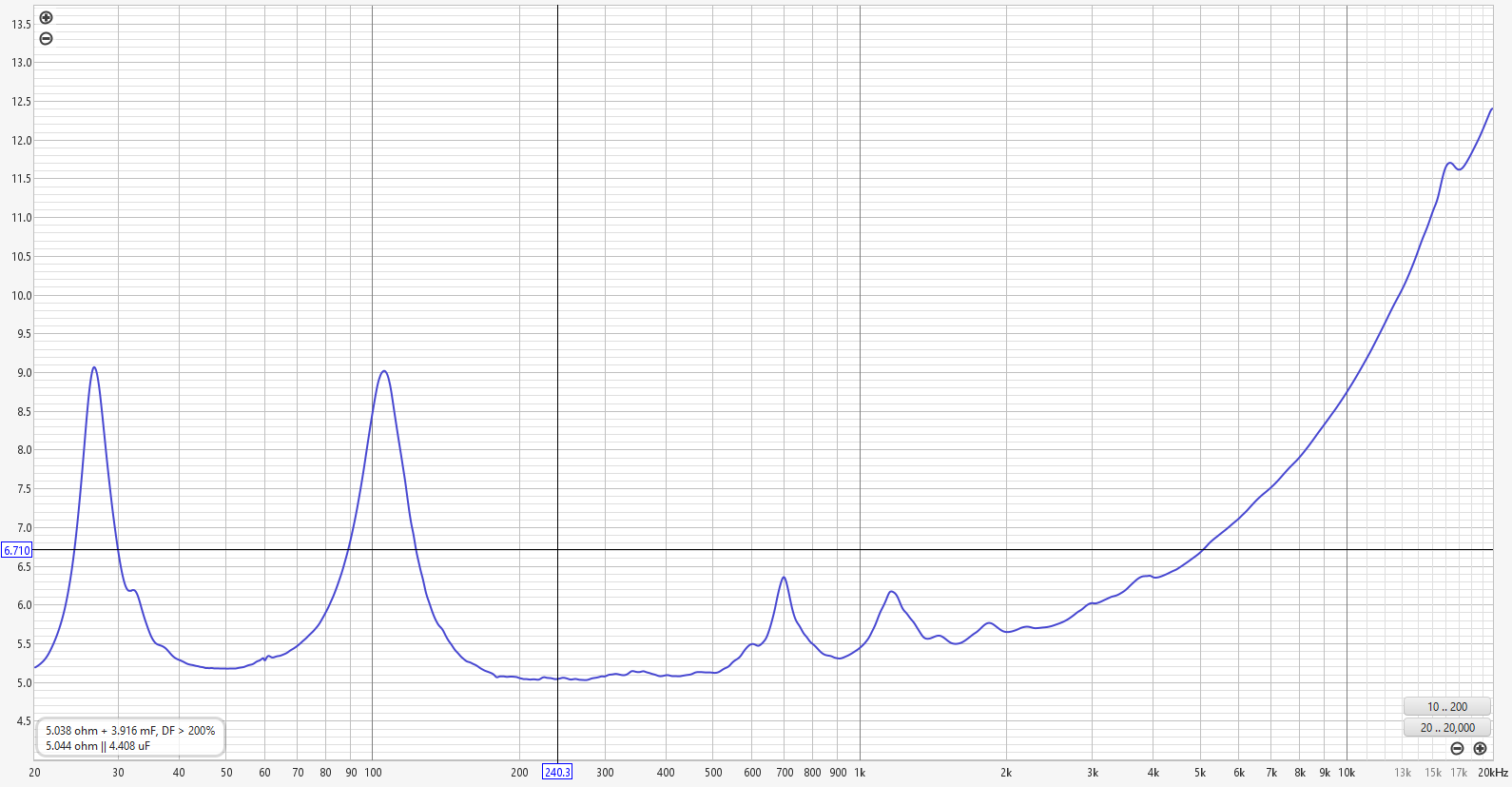

I decided to test a different strategy with respect to exciter placement than I have ever tried before. The idea was to position four identical exciters at the 0.33/0.33 locations of a simply supported panel. The exciters would all be driven in-phase with each other. This arrangement would drive the fundamental (1,1) mode very effectively. However, because the 0.33 positions are at nodes of the (1,3), (3,1) and (3,3) modes, none of those modes should be driven. Also, since all (even, even) and (even, odd) modes are all anti-symmetrical wrt one (or both) axis of the panel axes, none of those modes should be driven either. So, the next mode driven above the (1,1) mode would be the (1,5) mode.
The thought was that in the low frequency region, where the modal density is low and the frequency response is lumpy, driving only the fundamental might result in a smoother frequency response in that region.
For this test I used one of my carbon fiber skin/balsa core panels that is mounted in a frame using Poron 92 foam all around the perimeter. This mounting provides edge constraint that is close to "simple" supports and provides high perimeter damping. The exciters were DAEX25VT-4.

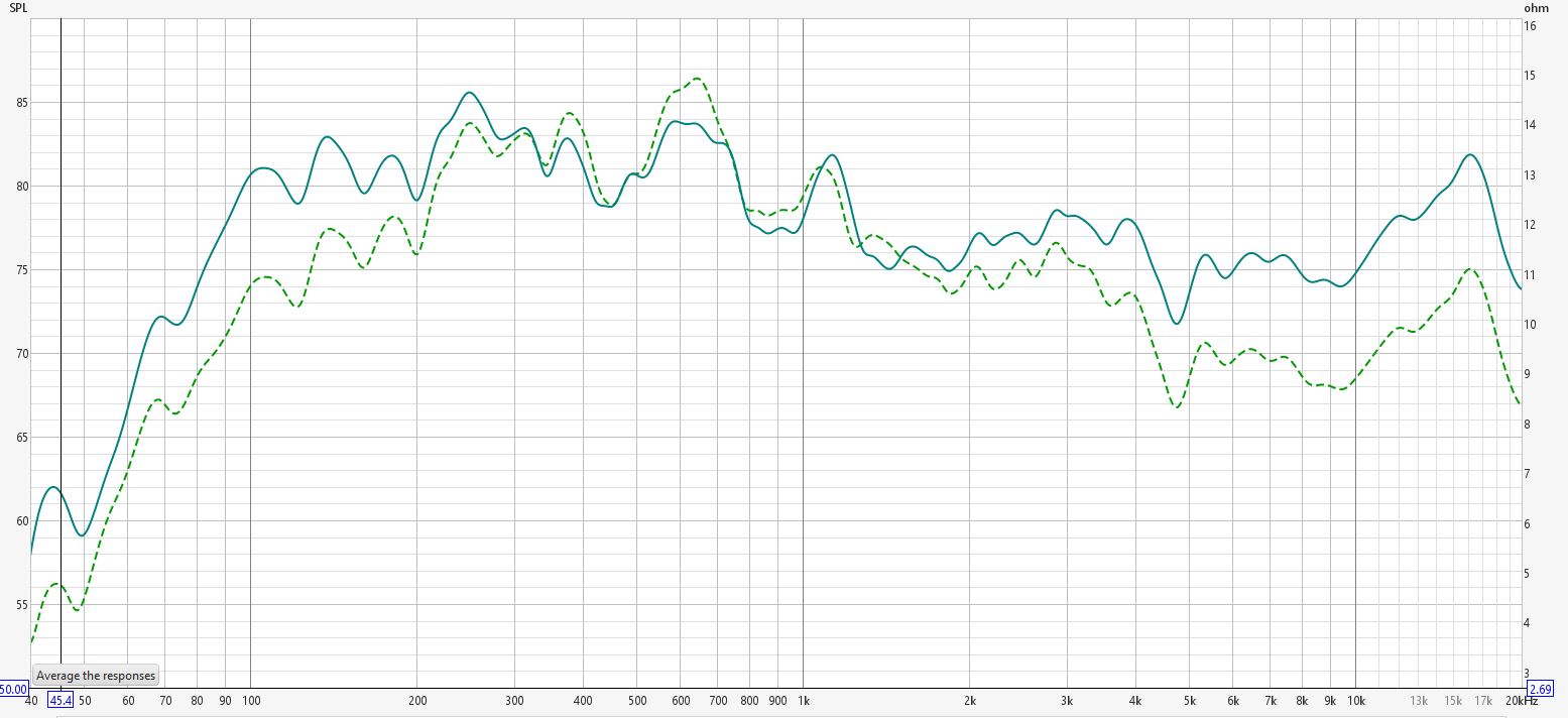

I was happily surprised to find that it actually worked quite well. The impedance plot directly below shows a peak at low frequency (27 Hz) corresponding to the magnet resonance of the exciters. The next peak at just over 100 Hz is the panel fundamental. The big gap between the 100 and 600 Hz confirms that no other mode is substantially driven until about 600 Hz, approximately where the (1,5) ought to be, based on my FEA model of the panel. So this result seems to confirm that my basic objective of driving only the 1,1 mode over the lower frequency range was achieved.

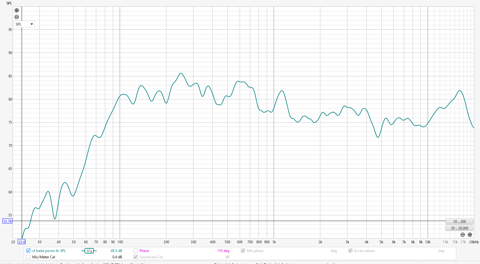

The frequency response was pretty good too. About as good or better than anything else I have built. Sounded great on a live track of the Eagles "Hotel California", and Dire Straits "Telegraph Road" and more. I did boost both the bass and treble a bit to flatten the curve, but response is good from about 80 Hz to 16 kHz.

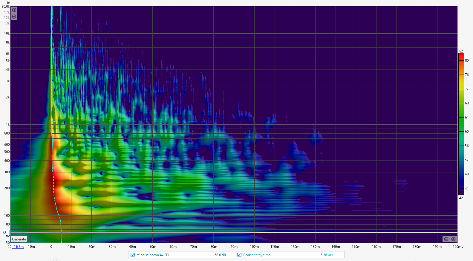

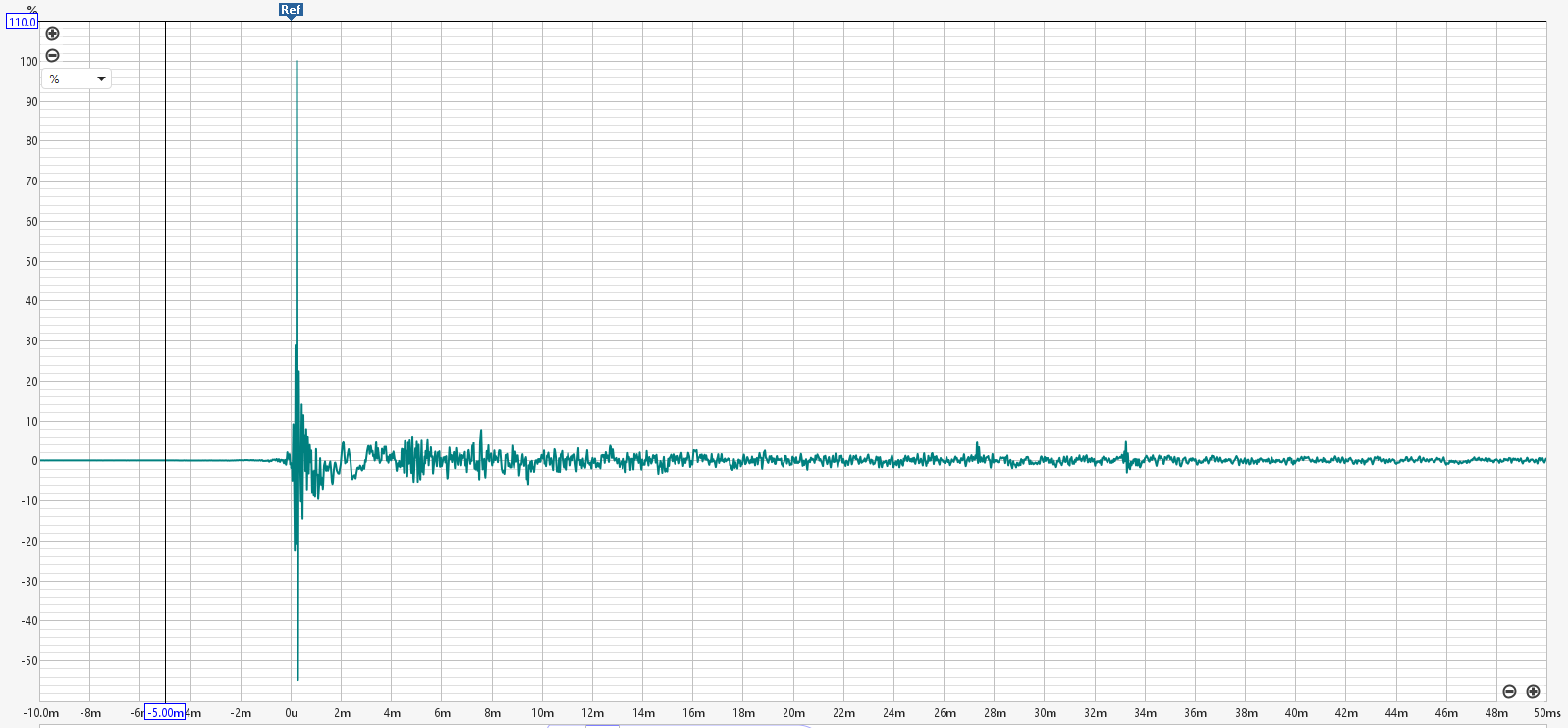

Also shown below are the impulse response and spectrogram plots, both of which are also about as good or better than anything I have built before.

How think was the panel? Size and thickness ? Can you show a FResponse without EQ ?
Hi stereodreieck,
The panel is about 584 mm x 406 mm, and 2.1 mm thick. It has a frame around the perimeter and the panel is attached to the frame around most of the perimeter (except the corners) with Poron foam with very good (i.e. strong) damping properties. The panel has a 1.6 mm thick balsa core with about 0.23 mm carbon fiber epoxy skins. Below is the FR without EQ (dashed line) and with EQ (solid line). To be clear, my EQ is only bass and treble controls, which by chance happened to work pretty well with this panel.
Eric

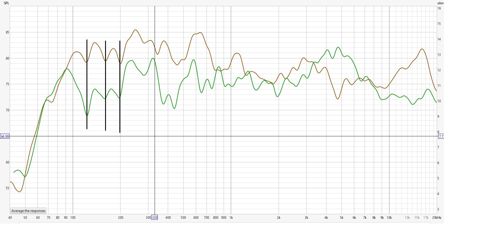

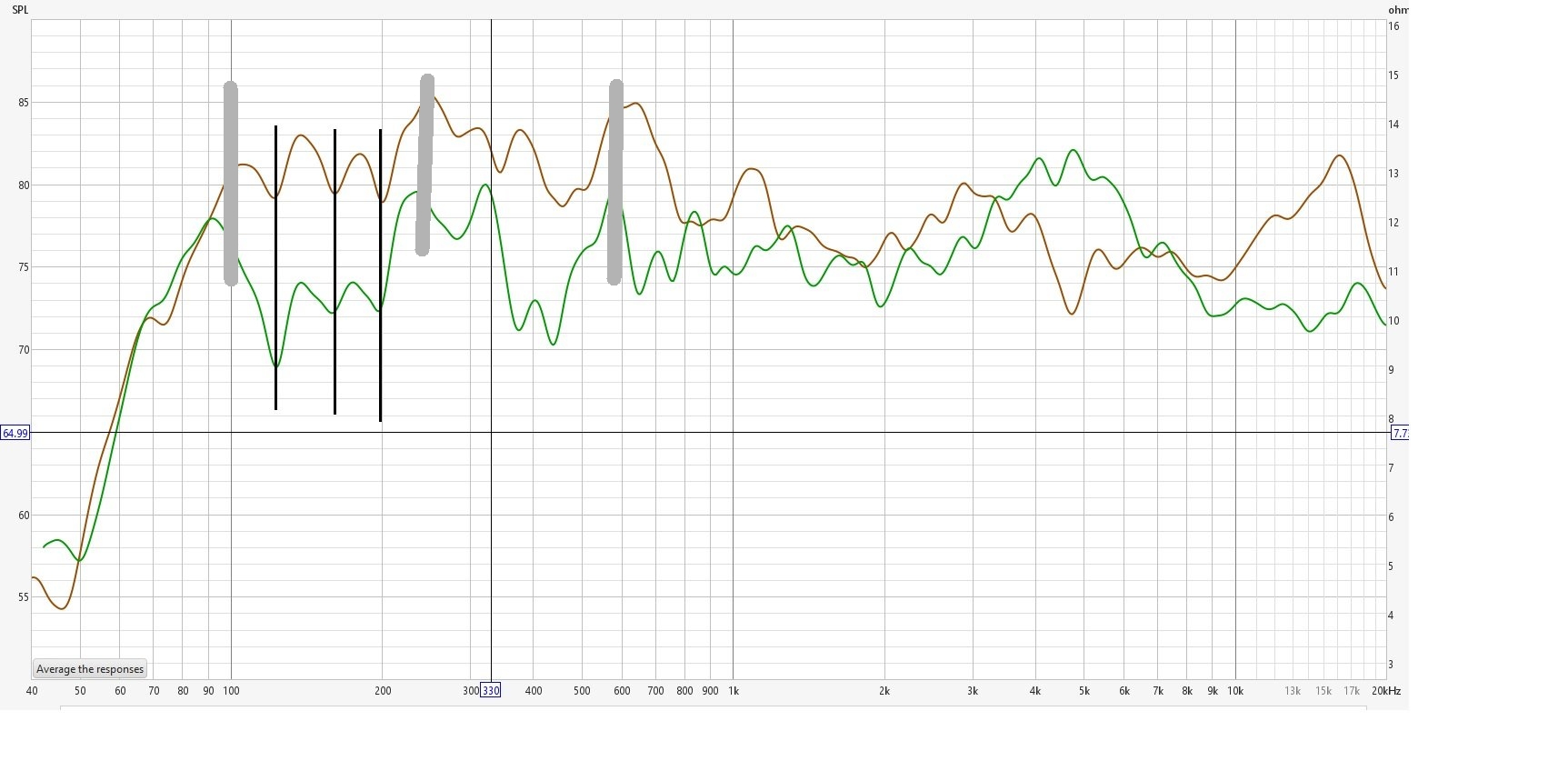

For a long time I have been aware that my "speaker lab" has a room mode that results in a dip in the FR at about 120 Hz. But now I'm starting to be aware of more of them. When I first measured the FR of the "4 exciter" panel in my previous posts (brown curve), I was al little surprised to see the three dips in the FR between 100 and 200 Hz. I was surprised because I expected that since I was only exciting the fundamental mode (up to about 600 Hz), I hoped for pretty smooth response in the 100 to 600 Hz region. As I mentioned, the 120 Hz dip didn't surprise me, but I didn't expect to see the other two dips.
But shortly after, I was looking at another, very different, panel and it had dips at the same 3 frequencies!
One panel is 2.1 mm carbon fiber/balsa, 584 x 406 mm, supported on 4 sides. The other is 5 mm plywood, 355 x 1200 mm and supported on only 2 sides. But the similarities in the FR seem too strong to be a coincidence.
Eric

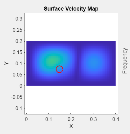

In the surface velocity map. it there a way to distinguish between the situation at low frequencies, where the panel is mostly modal, and at high frequencies where the behavior is more like the "pebble in a pond"?
From a velocity map view, the appearance of both may be similar, but in fact they are quite different, I think.
That is to say, close to the fundamental of the panel, the velocity may be high near the exciter and low at the perimeter as a result of perimeter constraints. While at high frequency the (average) velocity be high near the exciter and low at the perimeter as a result of damping. Is there a way to depict at which frequency traveling waves become dominant over standing waves?

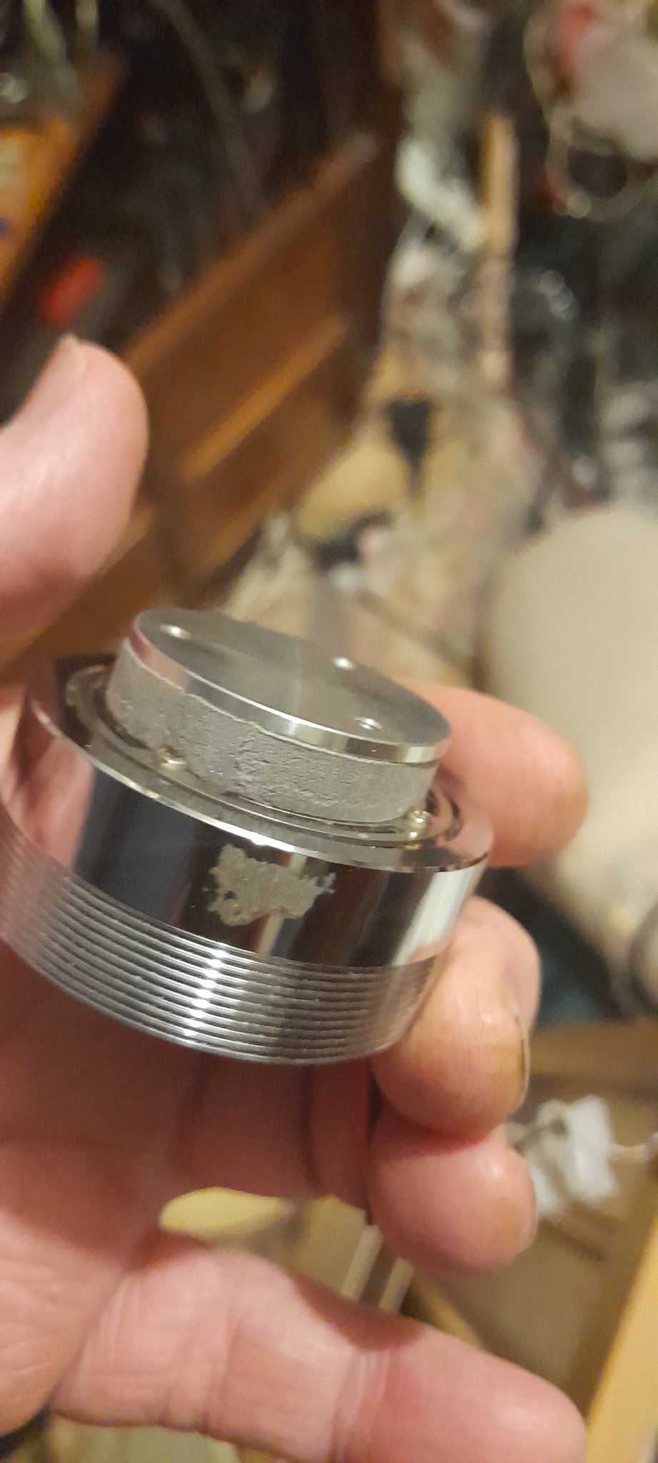

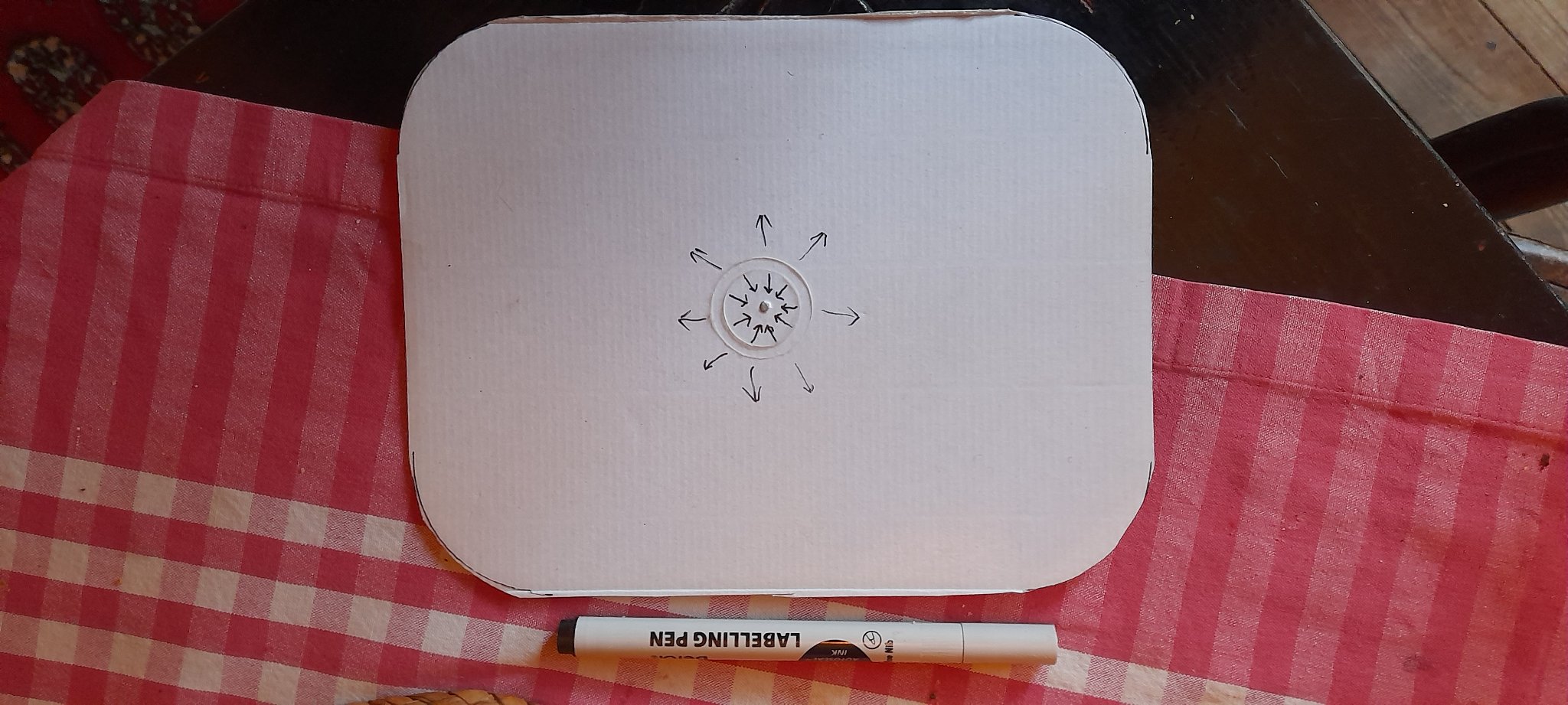

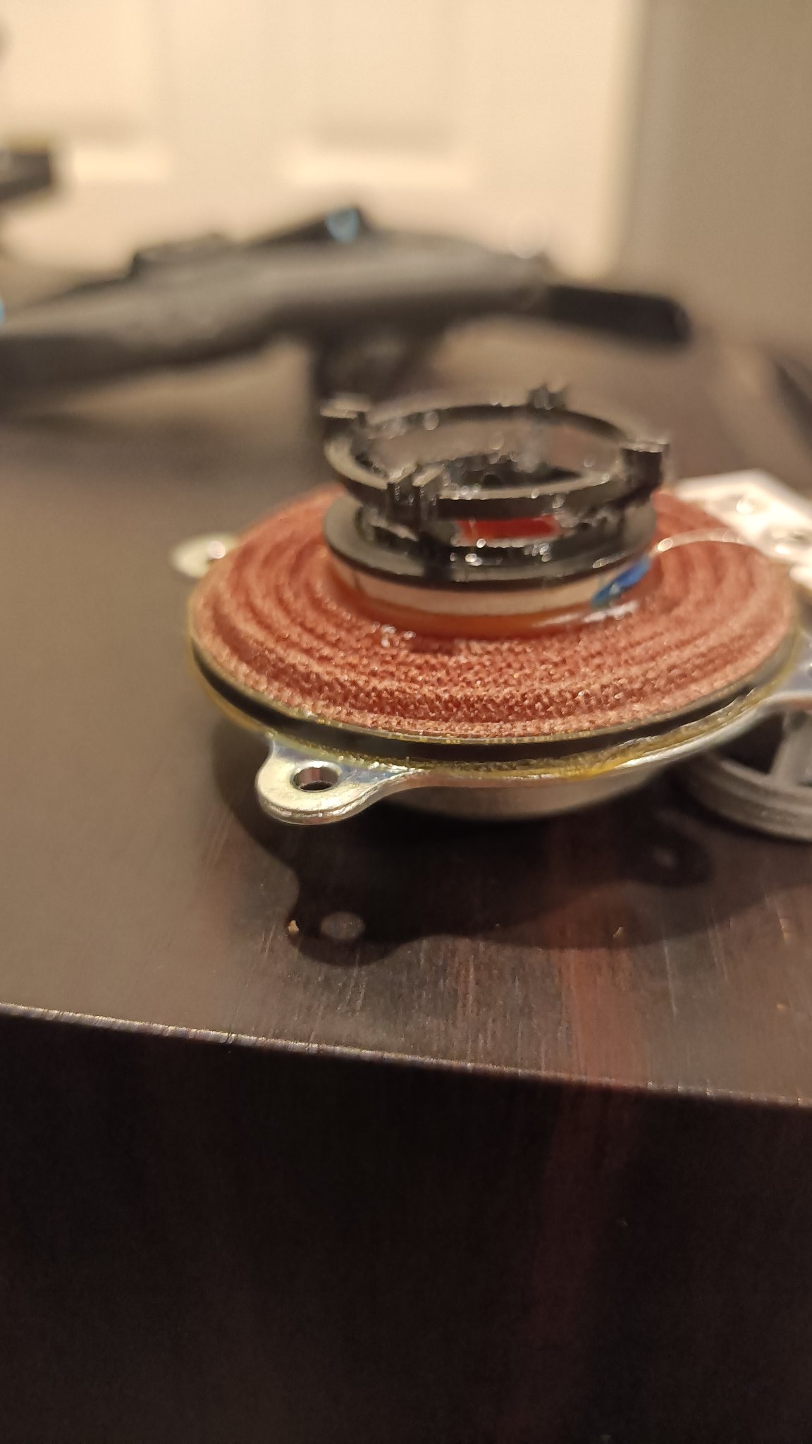

Ok .. So the matter of the concentrator has me exercised. I've made a point contact one, and a reduced size ring.
I don't need to test them because I can HEAR the hf drop. It's all very well to call it a low pass filter, in other words, an hf blocker/chopper, but WHY is this happening?
Ok again.. I tried them against the standard exciter ring and no doubt there's a difference.
What haven't we tried... Going the opposite way!...So I designed, for want of a better term, an expander. I boosted the contact diameter from 25 to about 35/40....
It sounds good... Needs testing, but it's worlds away from the concentrator...
See pic below... Eric, would be good if you could try it..It may not differ from the normal exciter-only mount, but who knows with this stuff... Can't put a screw through this though 😊
PS... My version has 4 point contact only... Not the whole ring, which is there just for structural purposes.
Eucy
Eucy

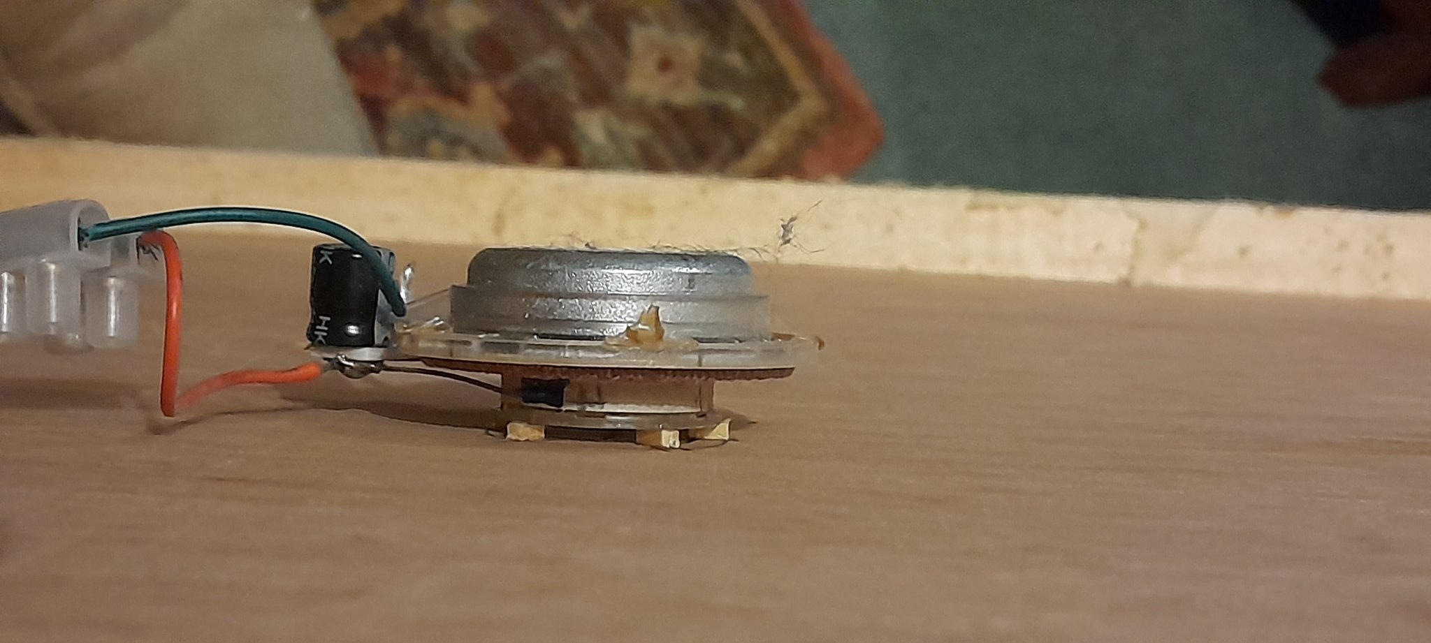

This is similar to my 5 matchstick mountings.
The idea was to vent the coil area and minimise the problem of inwards firing high frequencies as shown in the second photo.
I did not follow on with this with measurements.
Maybe one day.
Steve.

Hi Christian
Yes and yes. But... We also empirically considered that a 32mm exciter had a worse hf performance than a 25mm one.
Is that the case in your experience/tests? And Eric's vented concentrator actually made the 5k peak worse, but that was a frontal measurement I guess
The 8x8 mm contact concentrator has a distinct deadening effect on the hf, and it could be considered rigid in this zone, so increasing the rigidity appears to be an invalid protocol.
As the driven diameter increases, or the panel thickness decreases in the coil zone, I can envisage more of a pistonic tweeter action occuring, so the beaming does not surprise me, and it may not be deleterious to the overall panel performance.
It will be interesting to test the point contact vs a ring.
In parallel to that, we have had the information from Dave that the exciter ring acts as a low pass filter
ie: a high cut filter. ..I would like to hear/see a theory as to why this happens. And what may happen if I make an even larger point contact connector.
Eucy

It might be floor and/or wall reflection cancellations.
https://mehlau.net/audio/floorbounce/
Thomas
Thanks,
Eric
Indeed there is! And I wrote a paper about it back in the day. It's based on the idea of modal overlap - at low frequencies, modes are highly discrete, where at one frequency only one mode is contributing to the panel's velocity profile. At high frequencies, where no one mode has a majority influence over the velocity profile, we say that the panel has entered the "statistical" region, where the velocity profile looks like a pebble in a pond. This is usually good for omnidirectional radiation, but still doesn't save you from the coincidence frequency, unfortunately. I can probably add in a marker for that frequency as well. So now there will be three markers - coincidence frequency, unnamed cutoff frequency for the exciter ring/disc, and modal/statistical cutoff frequency.

I used the grey foam to dampen the coil former area that the mounting central bolt is joined to.
In the past I have described how to minimise the coil area surface problems on various panel material types.
But this only cures the problem within the inner surface of the coil and not always on the outer surface
Steve.

I think you guys are onto something with the expansion of the contact area. It’s making a smaller diameter “tweeter/midrange” membrane in the middle. This smaller membrane has higher frequency modes. It would be good if the central membrane area was thinner - like doped fabric or maybe like a thin paper cone.
One could take this a step farther and use a commercially available full range driver that’s designed for backside mounting like a Vifa TC9FD and mount that to a panel with a 3in cutout hole. Then mount a bass exciter by double sided adhesive to drive the magnet and basket frame assembly of the TC9 so that it drives the main panel. What this will make is a coaxial 2-way DML. Probably XO will be needed but a quick test with see if this works could be easily done. The decoupling of function of the midtweeter and the main DML panel will free up the highs.
