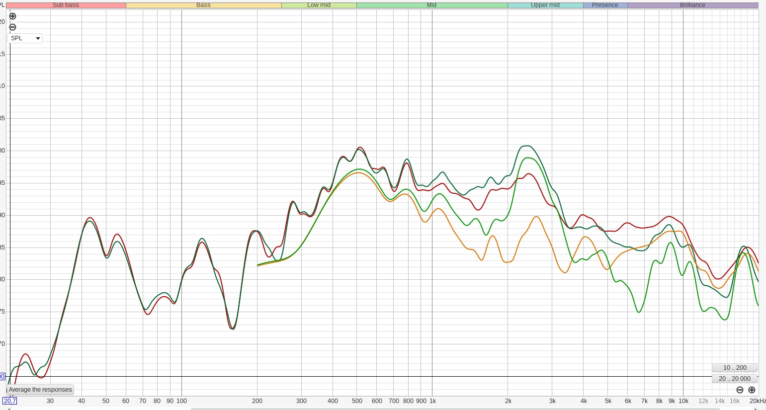

Hello Eric,I did see a difference between the front and back at 2-3kHz, but not more than about 5 dB in any case. Are you seeing more difference than that?
Eric
Having a new look to measurements (after a good night!), the difference in SPL for the cavity resonance might come from REW, how the IR is windowed or not.
In the FR I posted yesterday, the IRs are windowed (gated) at 5ms in order to collect almost only the direct sound and rejecting the room reflections.
Today, I have opened the same files of the clear polystyrene panel (see below) this time with default window settings of REW (left 125ms, right 500ms). the difference in SPL is around 5dB
In the plot below, I have duplicated the 2 FR above to show them with a long and a short window.
Front : 500ms window in dark red, 5ms window in orange
Rear : 500ms window in dark green, 5ms window in light green
In the 2/3k range, it is the front which has the most important influence of the window duration which makes sense as the main sound source is from the rear. Part of the sound from the rear is "added" to the front one thanks to the reflections (long observation time).
Christian

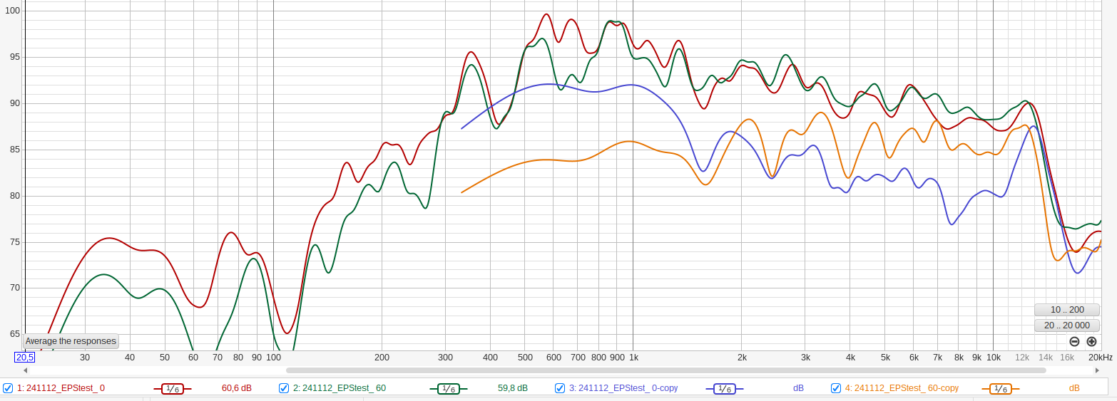

Humm... Just thinking loud after the post to try to answer to Eric about the influence of the IR window on the visibility of the cavity resonance peak...it looks like a hole in the panel does not solve the issue, but instead creates a bigger one.
It might be that making a hole solves the cavity resonance problem (= a strong wild source from the rear side) but then makes appear another problem. It makes sense seeing the level of the cavity resonance and the fact the power response are almost flat despite this additional source...
Using a common expression : "plague or cholera?" or FR : "du moindre mal, il faut choisir" translated by Deepl in EN "the lesser of two evils"

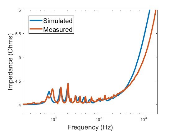

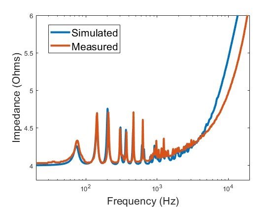

Hi all -I have suspected the same effect at times also.

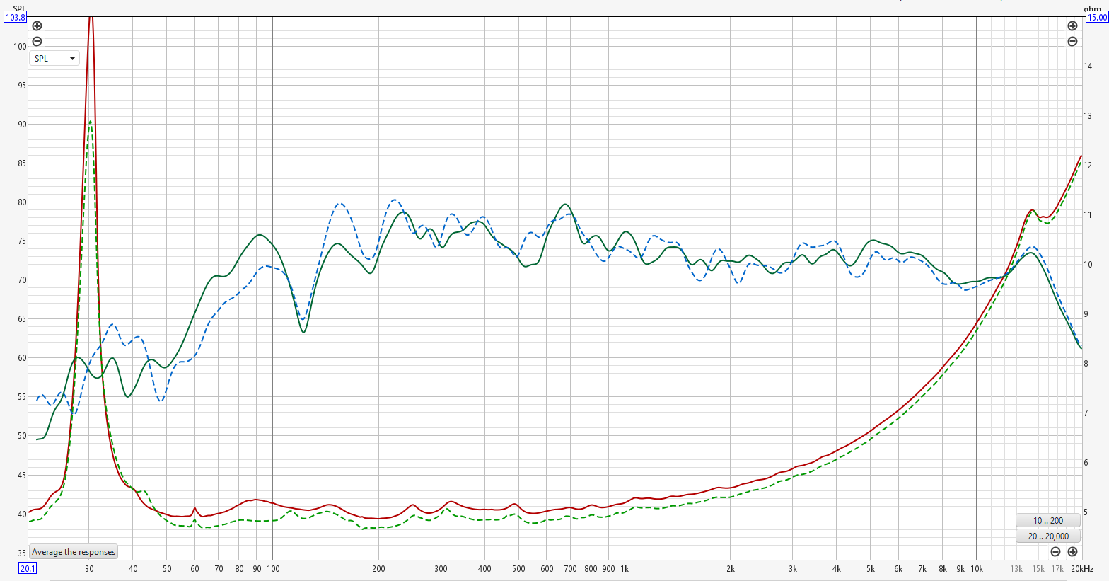

Impedance looks much better.
Two thoughts:
Eric
- It would be interesting to see what it looks like with a heavier exciter, like the 25FHE or 25VT. Those would separate the magnet resonance from the panel resonance.
- I'm assuming that your test case is with "fixed" edges, as in your recent paper, but I wonder if it wouldn't be better to evaluate the impedance model performance using free edges, rather than fixed. IME it's really hard to get truly fixed edges. First, there is really no perfect clamp, so the panel dimensions are not really well defined. Second, the clamp itself always adds a little damping, but how much? But hanging a panel with a pair of long masking tape strips comes really close to "free" edges, and you don't have to worry about having introducing damping at the perimeter.
Two new pictures of impedance simulated in my PETTaLS model with an updated, more advanced electromechanical model for the exciters. First one is for the same acrylic panel as before, Second one is for an aluminum panel. Results match much better than previously.
I'm working to incorporate more exciters into the model now that this is sorted out. I was actually developing this with the primary intent of giving designers a tool to choice between exciter models, hence why it's called "exciter and tactile transducer loudspeaker simulator." So my first big goal is to incorporate as many exciter models as possible.
I'll also do some measurements with free panels as soon as I'm able!
Some people had questions about free magnet vs. magnet attached to a spine - I'm planning to make another video soon, and I'll include that as a discussion point.
Still some things to clean up in the UI before it can be available as a download, but hopefully that won't take long.

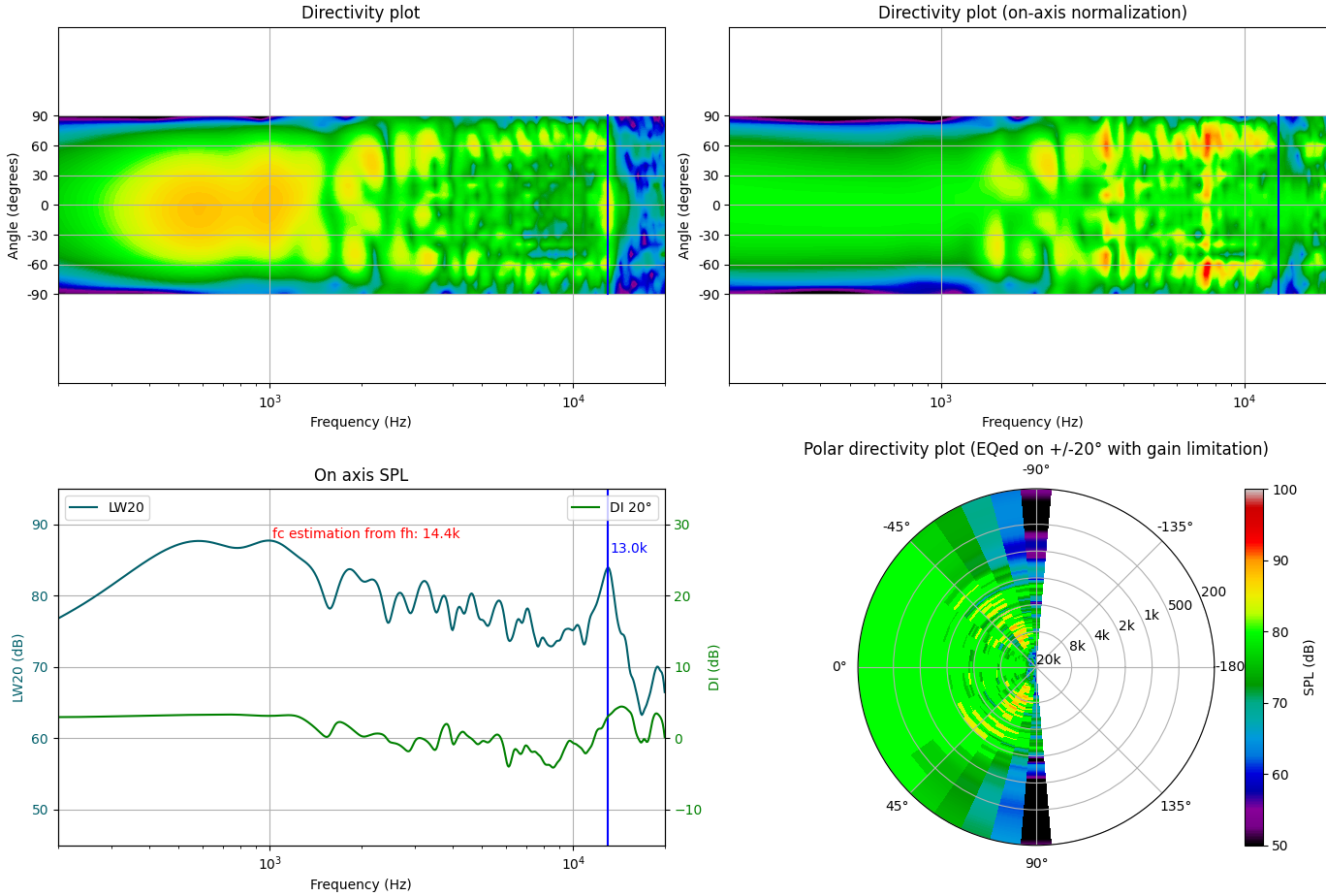

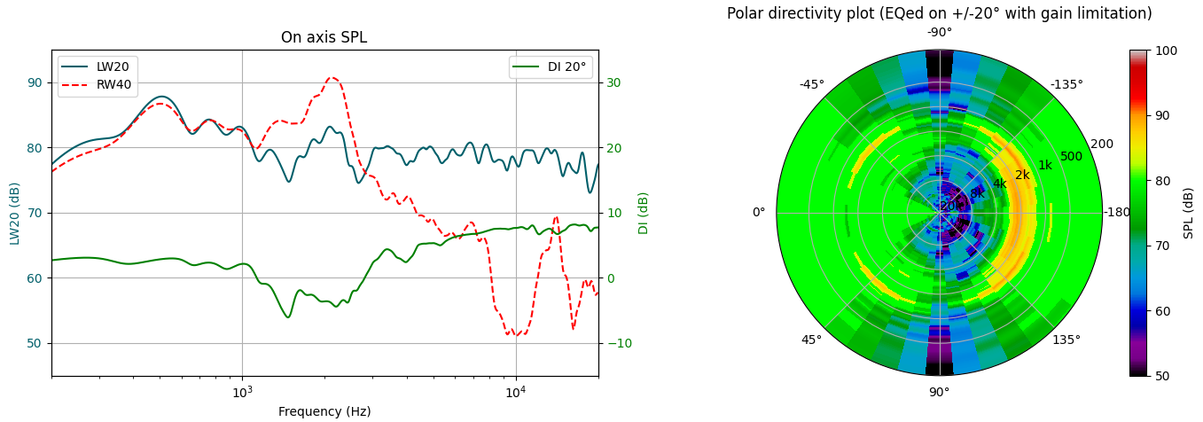

Below are 2 polar plots of the same panel I use for test (30x40cm clear polystyrene, I think close to acrylyc). There is a peripheral suspension and a frame.
It is plotted with and equalization of the +/-20° listening window (on axis).
In the left, it is in the open back conditions. The null at 90° is clearly visible (also some 30 to 50° lobes and the cavity noise at the rear)
Right is the same with a thick absorber on the rear and then a plate. It is not a closed box, the sound can probably escape from the sides of the absorber. Nevertheless, it seems the sound is able to go more than 90° when the frequency decreases. The cavity noise is absorbed, the front lobes are reduced also (is it their DML part remaining?).
Nothing say it is better or not for music! It was just a measurement to get an idea to what change when the rear wave is attenuated.

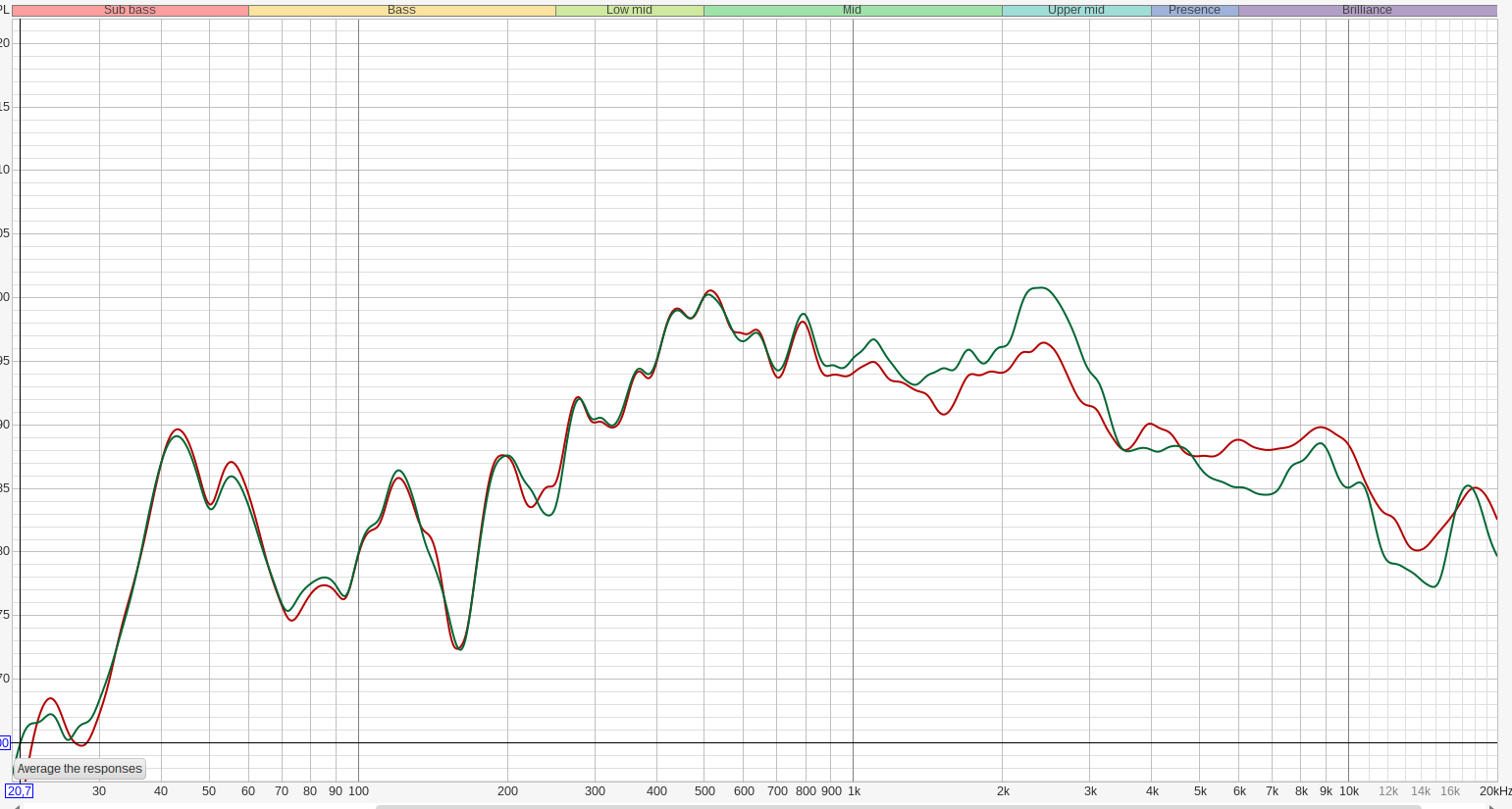

Christian,Today, I have opened the same files of the clear polystyrene panel (see below) this time with default window settings of REW (left 125ms, right 500ms). the difference in SPL is around 5dB
That plot looks a lot more line what I am seeing.

Hello Eric,Christian,
Eric
Could you confirm it is a matter of IR window setting? What is the IR window you used? If you have time what change coming to a short one (3 or better 5ms?)

A remark that I hope won't create a new entropy... I just linked what I shared in the previous post to answer to Steve (@spedge ) and the remark from @twocents before with @BurntCoil listening the DML at high angles.
I have extract below the FR at 0° and 60° of this EPS test panel
The 2 upper FR (red and green) are the FR at 0° and 60° windowed at 100ms so including the room reflections. Kind of energy response. They are very similar the panel was turned by 60° (the mic has a fixed position in the room) showing the angles effect can be seen, hides by the room reflections.
The 2 lower FR are in blue 0° and orange 60° with a 3ms window so a rejection of the room reflections to get the direct sound (before reflections)
The FR at 60° is almost flat compare to the 0°...
A flat anechoic (reflection free) FR with a smooth decreasing power response is a target in my understanding.
Might it be this panel more pleasant at 60°?
If we imagine a equilateral stereo triangle so 60° between the listener to the left source direction and the listener to the right source, then to listen according to the 60° direction of the panels, they are parallel to the side walls, perpendicular to the front wall...
Who is ready to test after this strange (in first approach, silly after?) remark?
Note that but I have almost no experience in the domain, EQing this panel on axis to get it flat leads to too high SPL at 60° (what the polar plot before shows) and probably an almost flat power response which from comments here or from what we can read about equalization is not the target (see down sloping house curves used with EQ).
Christian
