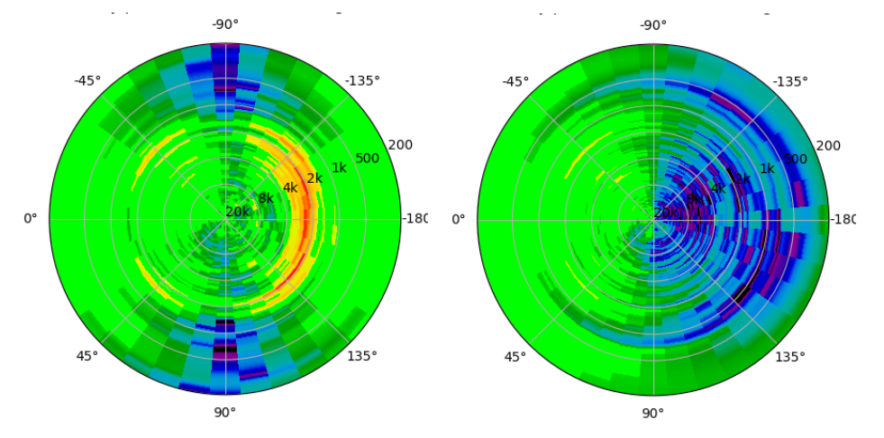

Below are 2 polar plots of the same panel I use for test (30x40cm clear polystyrene, I think close to acrylyc). There is a peripheral suspension and a frame.And I also think that the edges of a panel reveal an acoustic null because the surface waves cannot project in-line with the plane of the panel, and maybe because the individual micro-dipoles do short-circuit at the edges? Also, the relevant micro-dipoles might only be active closer to the exciter than they are to the edges anyway, depending on the damping factor of the panel itself.
It is plotted with and equalization of the +/-20° listening window (on axis).
In the left, it is in the open back conditions. The null at 90° is clearly visible (also some 30 to 50° lobes and the cavity noise at the rear)
Right is the same with a thick absorber on the rear and then a plate. It is not a closed box, the sound can probably escape from the sides of the absorber. Nevertheless, it seems the sound is able to go more than 90° when the frequency decreases. The cavity noise is absorbed, the front lobes are reduced also (is it their DML part remaining?).
Nothing say it is better or not for music! It was just a measurement to get an idea to what change when the rear wave is attenuated.

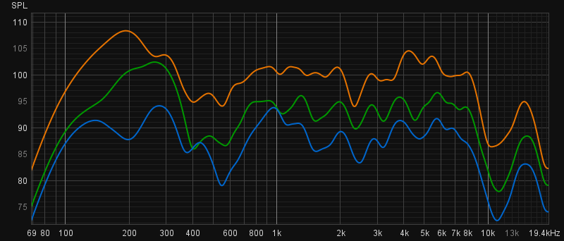

Here are the of axis measurements from my first revision at 1,2 and 4m. Not a great response, and with exactly the problem around 10k that Andre mentioned. I took the off axis response since it is more even and easier to compare relative amplitude:
Comparing the 1 and 4m curves, it looks like to me that in most of the spectrum the difference is around 10dB instead of the expected 12dB. If that holds true for the next doubling as well, that would mean 4dB more from the speaker in the middle of the dancefloor if it is 16x16m, which I guess would be quite significant. Surely someone must have made better measurements that can confirm if it is really the case?
But for HF decay over distance, apart from needing a plate that actually has decent HF reproduction, I would need to measure from much further away since at 4m the difference would be fractions of a dB anyway.

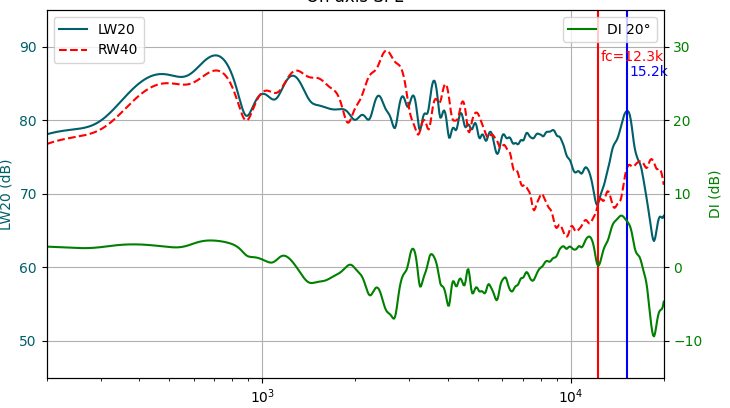

Christian,In the left, it is in the open back conditions. The null at 90° is clearly visible (also some 30 to 50° lobes and the cavity noise at the rear)
Can you share the on-axis front and back measurements (i.e. 0 deg and 180 deg) for the acrylic panel shown in your open back measurements? I'd like to get a better sense of the magnitude of the "cavity noise" you are seeing. I presume that what you are calling "cavity noise" is the red at 3 kHz, is that correct?
I have not made a lot of back measurements, but just yesterday I made several on various panels (not acrylic) with the 25FHE exciter. In those measurements, I did see a difference between the front and back at 2-3kHz, but not more than about 5 dB in any case. Are you seeing more difference than that?
Eric

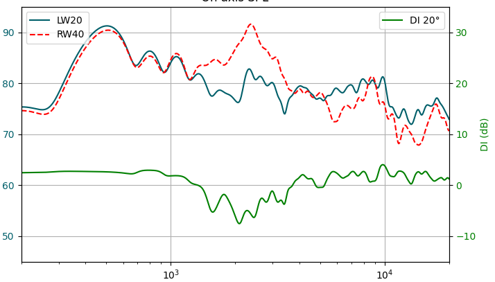

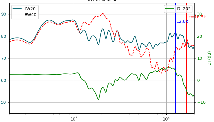

I have added a "feature" in the plots from the directivity measurement which shows the frequency response from the rear side along with the FR of the listening window and the directivity index. It is the mean SPL value over +/-40°. Below is the clear polystyrene (close to acrylic), below is the 2mm plywood and next is a 20mm EPS.
The red dashed line is the rear.
The amplitude of the "cavity noise" is here about +10dB. It is from exports of REW smoothed at 1/24 of octave, at 1m. The FR is gated at 5ms. After a quick check, the amplitude difference seems not change a lot with the smoothing... This amplitude is in the FR 180° compare to 0°.
I don't have 360° measurement for the poplar plywood 3mm (test panel) but I have the front and rear of my current 3mm poplar plywood panel made 2 years ago. They show also a peak 2kHz/10dB.
It seems there is a constant here at about +10dB with some difference in frequency according to the material.

Something I haven't notice yet from those plots, o the rear, above the 2/3k peak, in the 5 to 10kHz, there are differences... for the clear polystyrene (let me know is there is a more appropriate name for it) there is no spine, for the plywood there is a vertical spine about 5cm wide in contact with the exciter, for the EPS is a 2cm vertical tube but maybe 5cm behind the exciter. For the 2 last one it is like they created a mask...
The shape, the position of the spine might be to consider.
Clear (glass) polystyrene
Basswood 2mm plywood
EPS 20mm

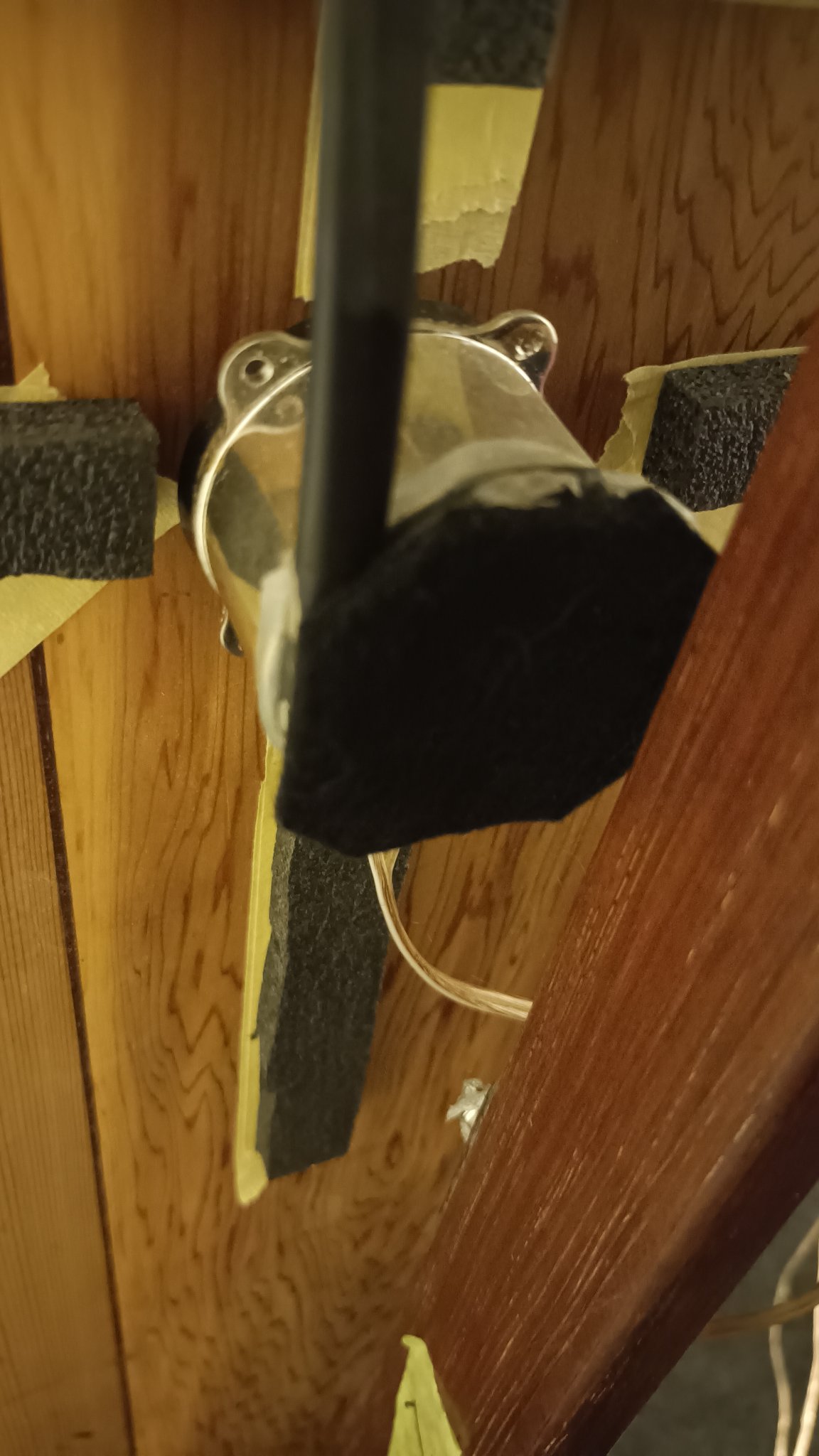

Christian, if you think the noise is emanating from the exciter, how about trying a cup type device stuffed with sound absorbing material immediately surrounding the exciter to see if it reduces/ eliminates the problem
Harking back to an old post of mine, I used a felt flap to do the same thing.
Also, venting the connection of the exciter to the panel will reduce/eliminate pistonic pulsing within the coil area which may be causing the noise through the magnet vent.
Eucy
Eucy
Hello Eucy. Yes it is the source. This solution is in my listChristian, if you think the noise is emanating from the exciter, how about trying a cup type device stuffed with sound absorbing material immediately surrounding the exciter to see if it reduces/ eliminates the problem
This one also. I remember your post about that. For now I was testing more at the source like with a concentrator with holes.Harking back to an old post of mine, I used a felt flap to do the same thing.
I don't understand "venting the connection...". Could you explain a bit more or differently please?Also, venting the connection of the exciter to the panel will reduce/eliminate pistonic pulsing within the coil area which may be causing the noise through the magnet vent.

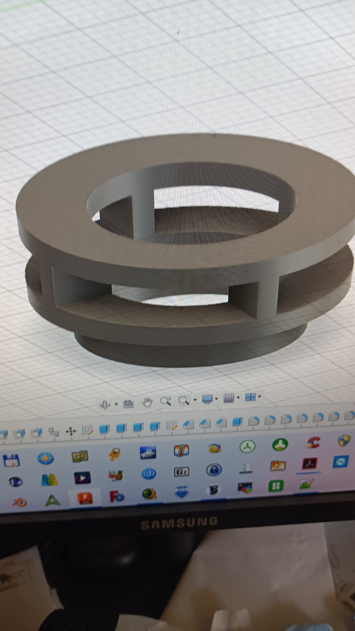

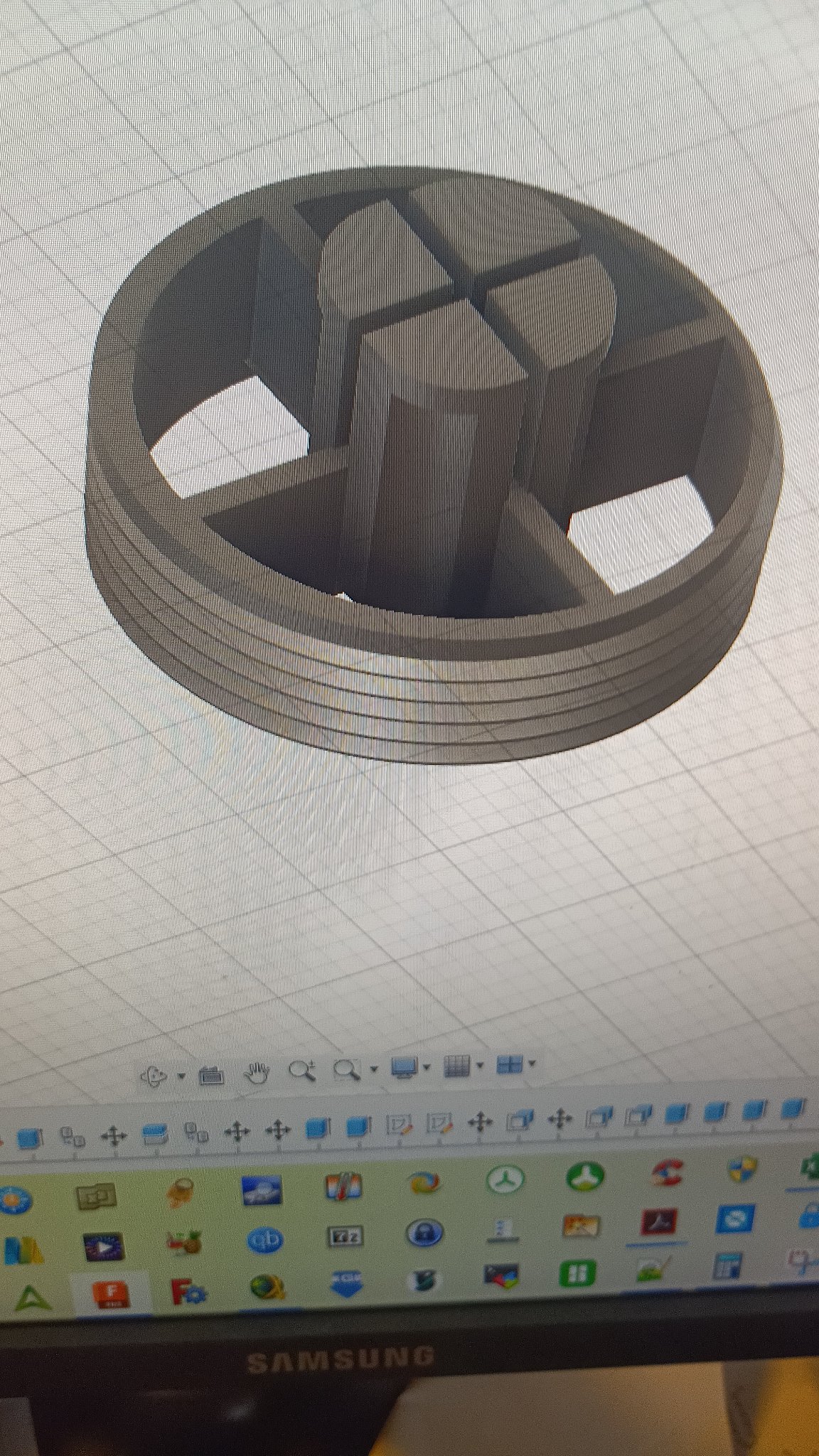

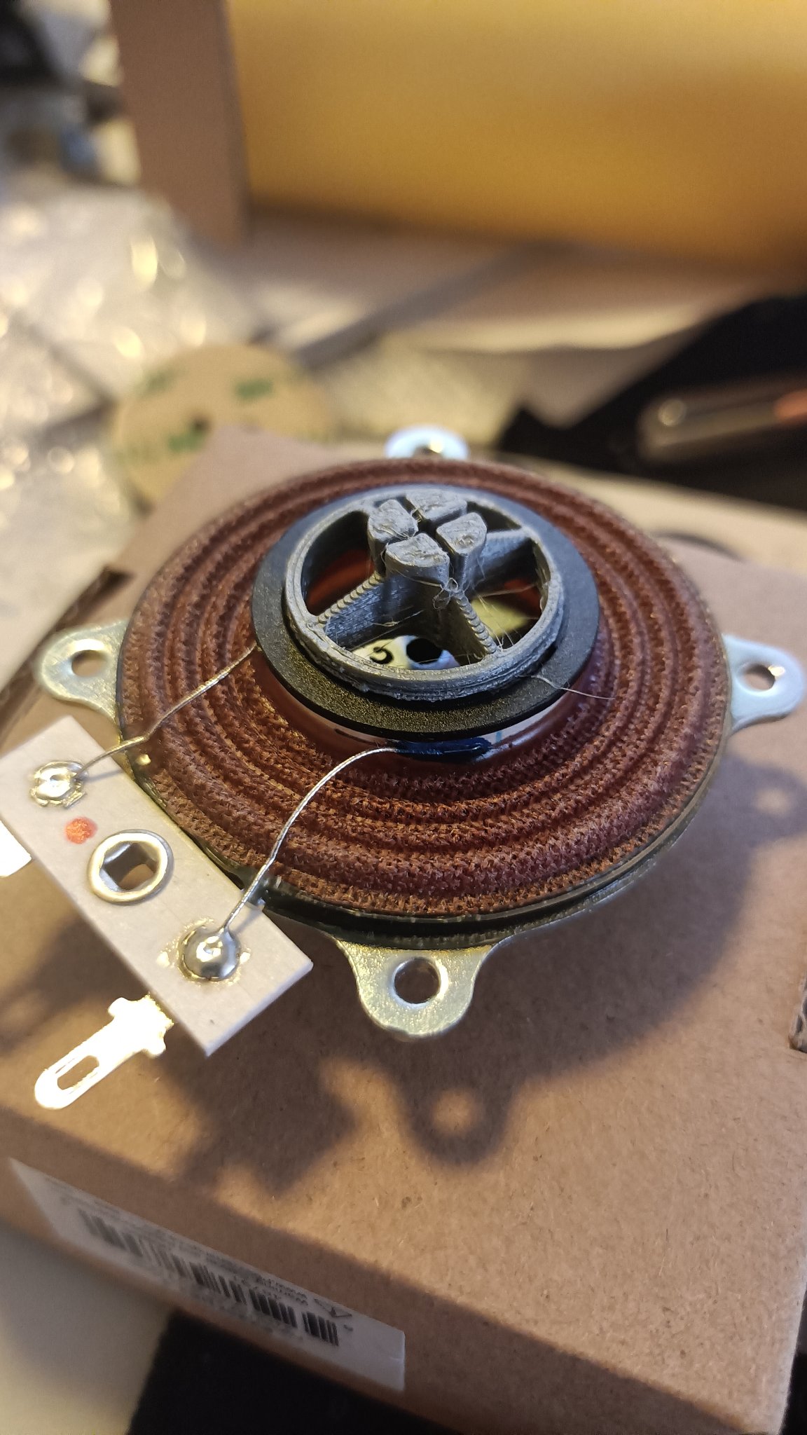

Hello Eucy,Threaded concentrator. Contact area 8x8mm
Modified from previous pic
Now down to 0.79g.
I need to remove the fine stringy bits 😊. It is printed in PETg which is prone to stringing, but it's not an issue.
Eucy
For now, I haven't posted the results from the concentrators I tested because I would like to give a picture as clear as possible... not easy.
Anyway, it seems 2 directions appear :
- A contact area in the 10mm range is a bit small from the mechanical resistance point of view (mainly for testing). From the directivity point of view, 15mm or even 20mm might be correct. At this step, the only advantage I see for a 10mm contact area is to help in creating the venting section. Not sure it really works.
- To limit the weight seems a good idea. It seems to have an influence on the 5 to 10k range.
Christian
