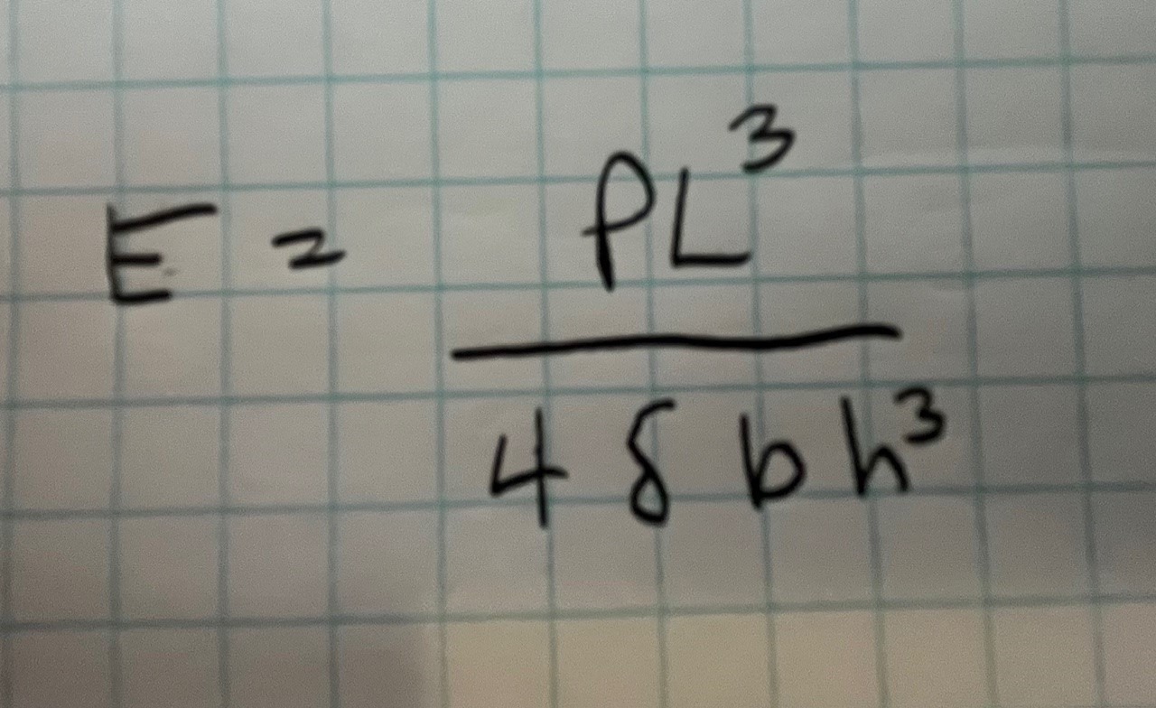

Sure can. In words, Elastic modulus is essentially the intrinsic resistance of a material to small tensile and compressive deformations. By "intrinsic" I mean that it is a property of the material itself, normalized for its dimensions. So Elastic modulus is a material property like density, that is, a material's elastic modulus is the same, regardless of how wide, or long, or thick the piece in your hand is.
Confusingly, engineers use a lot of different terms that essentially mean the same thing. Elastic modulus, Young's modulus, tensile modulus, flexural modulus all actually mean virtually the same thing. All are referred to as "E" and the dimensions will be in Pa or psi (or more commonly as GPa or mpsi because they are awkwardly large numbers otherwise). And you can use any of these in the equations I shared above.
So yes, we are talking about Young's modulus. And, while the Young's (i.e. Elastic) modulus can come from the same test that tests a sample to destruction, the Young's modulus actually comes from the very beginning of that test, long before there is any permanent deformation of the material, let alone outright failure. In "engineer-speak" the Modulus is the slope of the stress/strain curve.
The simplest practical way to measure Elastic Modulus is in a three point point bend test. This anyone can do at least a crude version of in their own home.
Support a long narrow and skinny beam of the material across two points of support, near the ends. Apply a weight (P) to the center, and measure how far the center of the beam deflects down due to the addition of the weight.
Calculate the Elastic Modulus (E) using the equation below, where b is the beam width and t is the beam thickness. The deflection (small greek delta), is the deflection in the center with the applied load small load (P).
The trick is to use a small enough weight that you don't come close to breaking your beam, but heavy enough that the deflection can be measured. Without lab equipment, it's hard to get great measurements, but you can get in the ballpark.

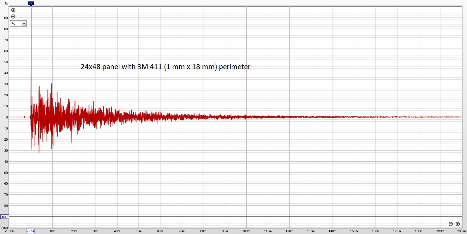

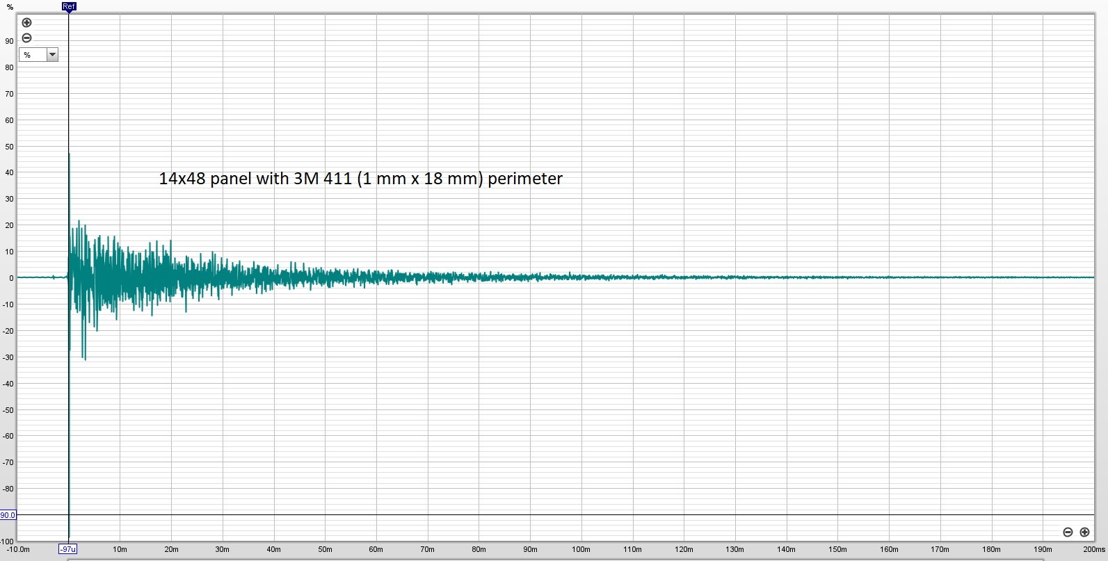

Can you explain why you have a peak at about 14k on the poron and a massive downwards slope on the other material.Loeb,
Indeed, it looks like the narrower panel has a bit better impulse response. See below the impulse responses I measured for the 24" wide panel, the 14" wide panel. and finally the same exact 14" wide panel, but with better damping (Poron 92 foam) on the perimeter, in place of the original 3M 411 double sided tape. The IR of the 24" wide panel is poor, while the the 14" wide panel is slightly better. But improving the perimeter damping made a much bigger improvement in IR than narrowing the panel did.
The 3M 411 is actually a decent perimeter material, but I hadn't learned to optimize it yet. Using a narrower strip (and 2 or 3 layers thick), would likely have given results closer to the Poron 92.
View attachment 1254113View attachment 1254114View attachment 1254115
Also, a nice secondary effect of using the Poron perimeter was a slight extension of the low end frequency range. The much softer, thicker Poron constrains the edges less than the 3M 411 did, shifting the natural frequencies a bit lower and hence extending the low end by maybe 10 Hz.

What distance were these measurements made.
For a dml to work properly you need the panel to vibrate freely, so surly a longer impulse response is expected.
If you can hear this delayed response, you have a problem.

Not for certain. That peak is fickle. It will show up in some measurements, and then not in others. It's not an effect of the Poron, as the same peak shows up in some measurements on other panels without Poron. Probably the biggest clue is that it coincides with a peak in the impedance curve of the exciter, no matter what it's mounted to. DAEX25FHE and DEAX25VT exciters both show the same peak in impedance. So my best guess is that this is the break up of the exciter voice coil. It may be that this peak has strong lobing, and shows up (or not) depending on the exact location of the mic. My hearing only goes up to about 11k, like most people of my age, so it's a curiosity for me, but of no real significance.Can you explain why you have a peak at about 14k on the poron and a massive downwards slope on the other material.
All those measurements were taken at 1 meter.
We disagree on that point. Free vibration without damping is a recipe for spikes and dips in the frequency response, along with ringing at random resonance frequencies. Luckily, most materials have some internal damping, and the viscous resistance of the air provides a bit of damping too, so some seemingly "free" panels can have tolerable (though far from ideal) levels of it.For a dml to work properly you need the panel to vibrate freely,
Expected, yes, but that doesn't make it a good thing.so surly a longer impulse response is expected.
I am interested to know what those methods are.There are ways to reduce the panels resonance without damping.
I've not heard evidence of that. Do you have any to share?damping by itself just causes problems, mainly to the sound of the panel, heavy panels are already restrained in dynamics, damping just makes it worse.

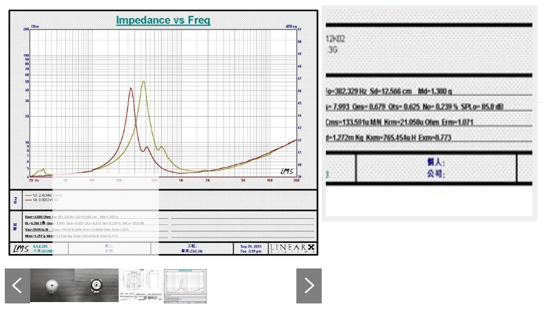

Dayton's most efficient exciter might give an indication but going on an amazon.uk review it's weight makes it difficult to use. Weight is almost bound to figure.Quick, rabbit-trail question:
What are the main TS parameters that determine the ultimate efficiency of a driver given the same panel parameters across different drivers?
I would assume Re, BL and Cms.
Comments?
https://www.daytonaudio.com/product/1184/daex25shf-4-steered-high-flux-25mm-exciter-20w
There's a lot wrong with the Amazon description (this driver is certainly not the "most powerful" of the range. It's only 20W!)Dayton's most efficient exciter might give an indication but going on an amazon.uk review it's weight makes it difficult to use. Weight is almost bound to figure.

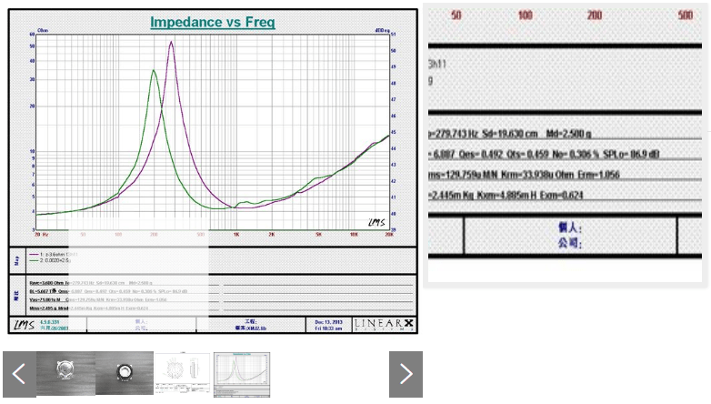

And the Dayton factory also seems to get it wrong. The factory curves show an SPL response that's 20dB higher than any other driver! That cannot be correct. The driver itself weighs in at around 270grams, vs the 30HESF-4 which is the next heaviest at around 180grams. But if the 25SHF has such an extremely heavy motor, and an Re of 4.3ohm (which is rather average) then why does it have a BL of only 4.29Tm?? In addition, with an Re of 4.3r, and a Bl of only 4.29Tm how is it possible to have a sensitivity 20db higher than all the others?
Maybe it's so heavy because it uses a ferrite magnet instead of neodymium like all the others? But this does not explain all the other apparent errors in this driver's specs.
Oh... Edit: Bottom line is that efficiency primarily depends on BL and Re. And BL depends on magnetic flux density and the length of coil wire inside that magnetic field (and the length of wire, of a certain gauge, determines Re and Pmax). So one can have a large, heavy magnet, but if it's a ferrite magnet, then it will have much much lower flux density than a neo magnet of the same weight.
But that's not all... if you have a wide pole gap then the flux density will be lower than a narrow pole gap. So looking at the magnet weight and material alone will not tell the whole story. That's why BL is the go-to parameter.
Another thing that makes me doubt the Dayton spec... The BillionSound OEM, who are the suppliers of these drivers to Dayton, specify the 30HESF-4 (rebranded equivalent?) as having a sensitivity of around 86.9db/W. This figure is derived from double-mass TS parameter tests and not from panel tests.
The 25SHF-4 (rebranded equivalent?) under discussion comes out at 85.8db/W.
This is much more in line with what I would expect given the other numbers.
